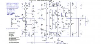

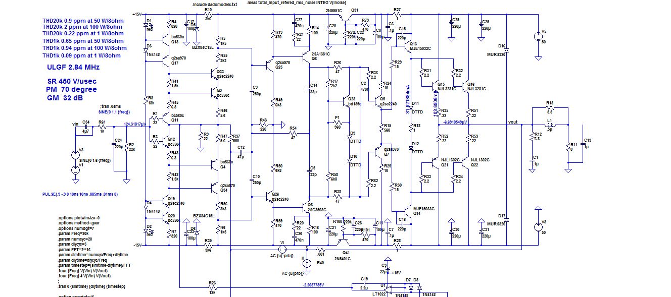

R27/c6 and R28/C7 provide HF isolation between the pre-driver and driver stages. If you layout is very good (short low inductance tracks etc) you can possibly get away without these devices. If the track inductances are high, the pre-driver and driver can form a Colpitts oscillator structure and you get instability. I did a lot of testing on my e-amp (EF3 OPS) on this subject and concluded this network gave important benefits.

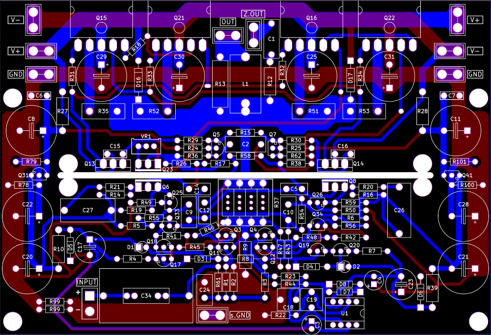

I'm nearly done with the PCB. I plan to bring it to PCB company at Monday next week.

It looks very good. It is not easy to follow the connection on a double sides board and I can't say if there could be some improvement, but if I can suggest to make possible for different dimension(footprint 15 mm and 20 mm at least) caps C26 and C27. Not every body will find the same caps.

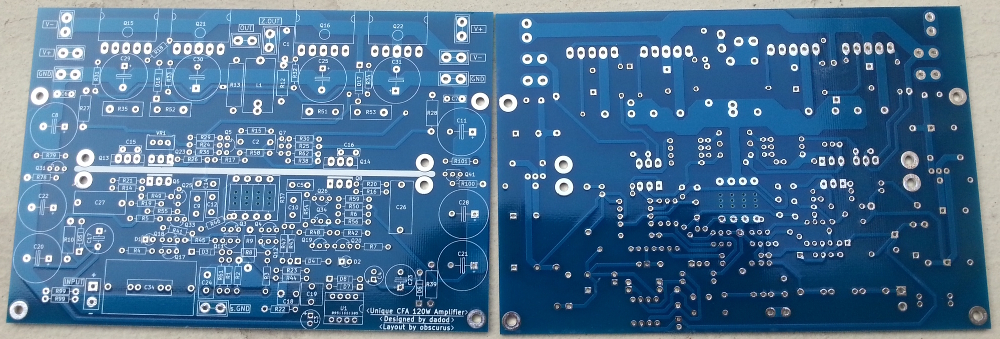

My boards come today. Finally, I can start working on the design.
Also have some questions.
- I only have R12 = 10 / 8.2 ohms. Could I use them or I need to change value of C1?
- Could I use L1 = 1uH ?

You can use R12 = 8.2 ohm, but I prefer 6.8 ohm, no need to change C1.
You can use 1 uH, but 0.5 uH is more then enough and has less on sound influence.
By the way, nice boards.

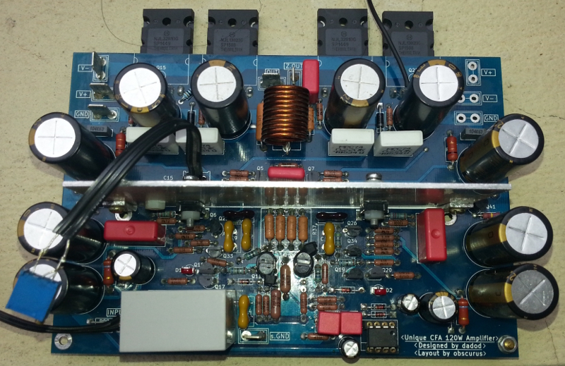

Hi, I'm slowly working on the project. My speaker was not so good but after listening to this CFA amp, I found my old amps lacking something. This CFA sounded very details with really big soundstage, doesnt have some kind of micro delay in sound like my other amps, but the sound was a bit raw, I suppect it is may be because of the input capacitor. I plan to buy some jantzen superior-z cap to replace the current capacitor. But it definity the most music sounding amp in my collection. My wife liked it, too. I'm happy that I decided to build this amp.
I will have change to test it one better speaker and vs some diy amp in the close future. So please wait for my next listening impression.
