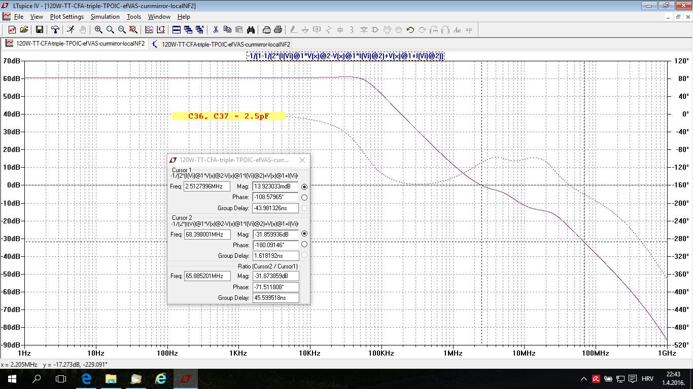

Hi Guys
With just 2p5 as part of the nested loop value, it seems like this would be competing with stray capacitances of the layout? Is this a concern or is the value not too critical?
Have fun
Not to critical. With 5pF THD at 20kHz will increase by 3dB.
Attached LG with 2.5pF and 5pF, 100% increase.

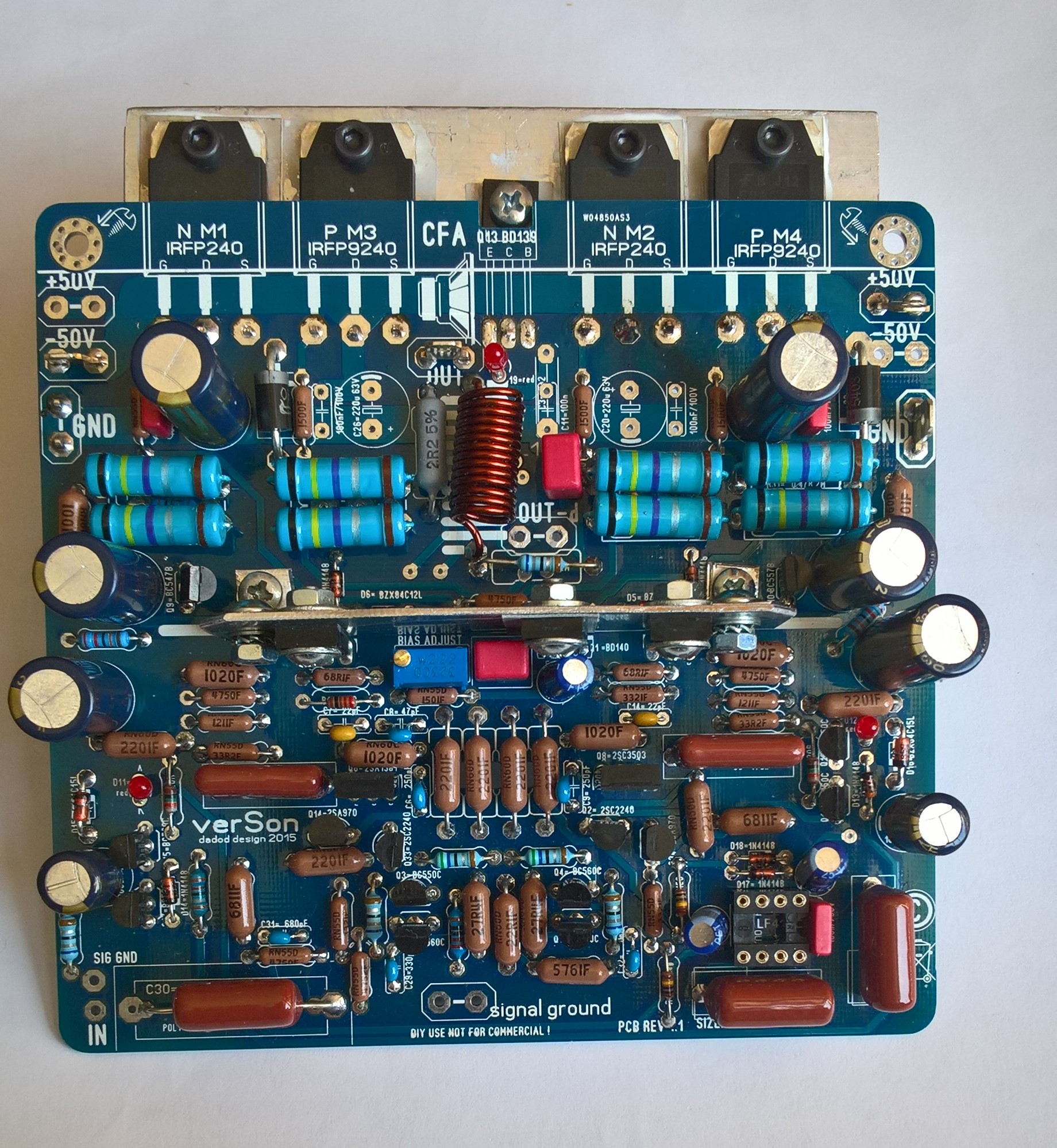

As you could see in my previous post I am not using IRFP(9)240 since I do not have sufficiently matched pairs. I use FQA12N(P)20 mosfes instead. I have these matched very well. I intended to use them in PASS F5, bud finaly I decided not to make it. I am finishing my period of A class amps 😀

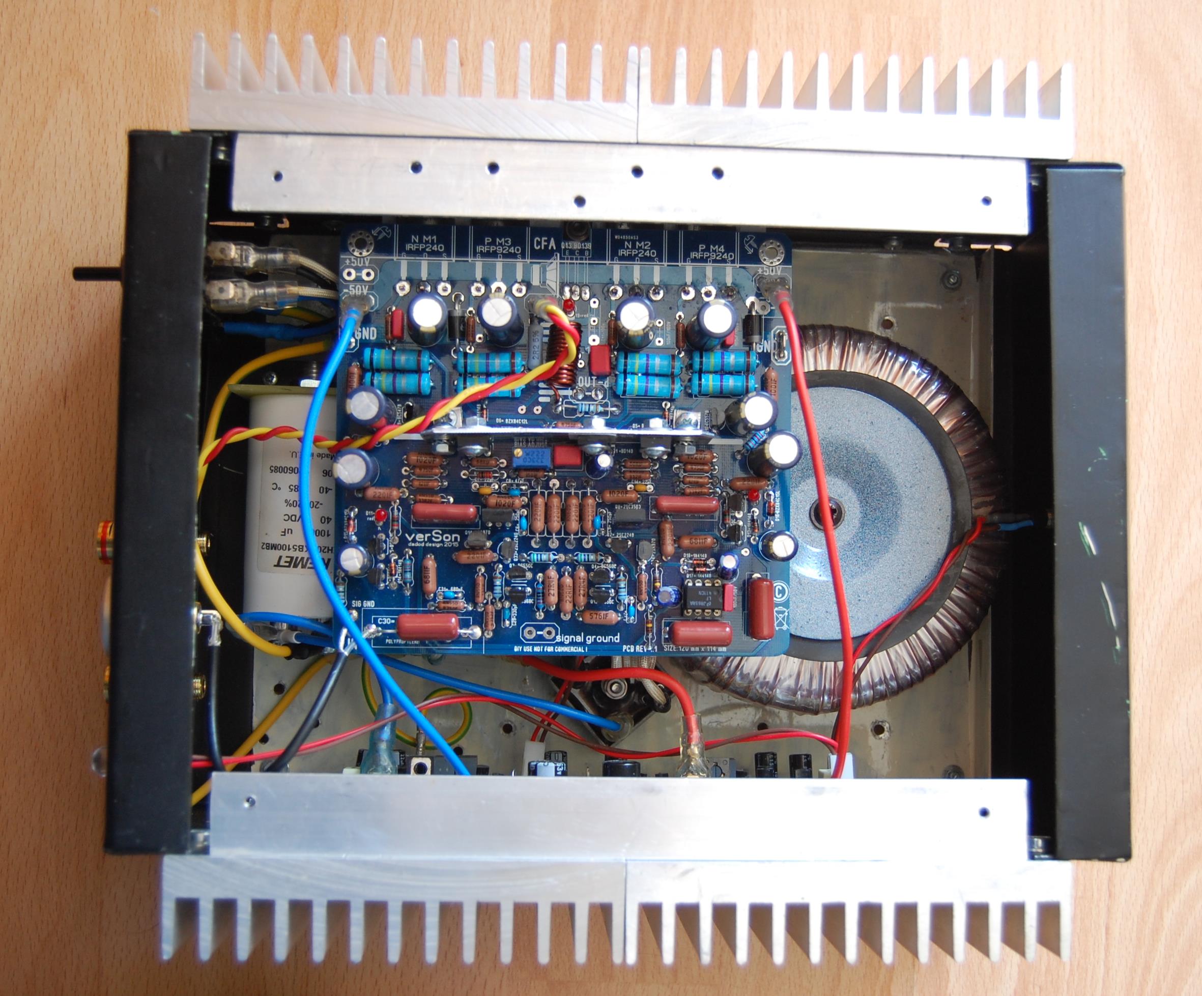

Here is picture of progress with these boards. I used older boxes from Pass A class monoblocks. At this moment the first one is working properly. It has 42 mV offset at the output and the current through output devices is approximately 70 mA pre device - 140 mA in total.
One monoblock was already tested with speaker, everything was working properly. When I will finish the other one I will post some listening tests.

I am glad that it's working even with different mosfet. I hope you have 42 mV of DC offset with no DC servo inserted.
If you pass via Zagreb you can visit me, I will PM you my mobile number if you do.
Damir
PS. You used wrong thread for this one, it should be in 200W CFA, this one is
for bipolar output.

The offset is higher due to bigger difference between N and P devices. According to Nelson it is better matched in parasitic capacitances, however it it worse in gate to source voltage. In my case the difference between Vgs is 1,8V i.e. 3,9V vs. 5,7V. Without LF411 the offset is 1,2V.
