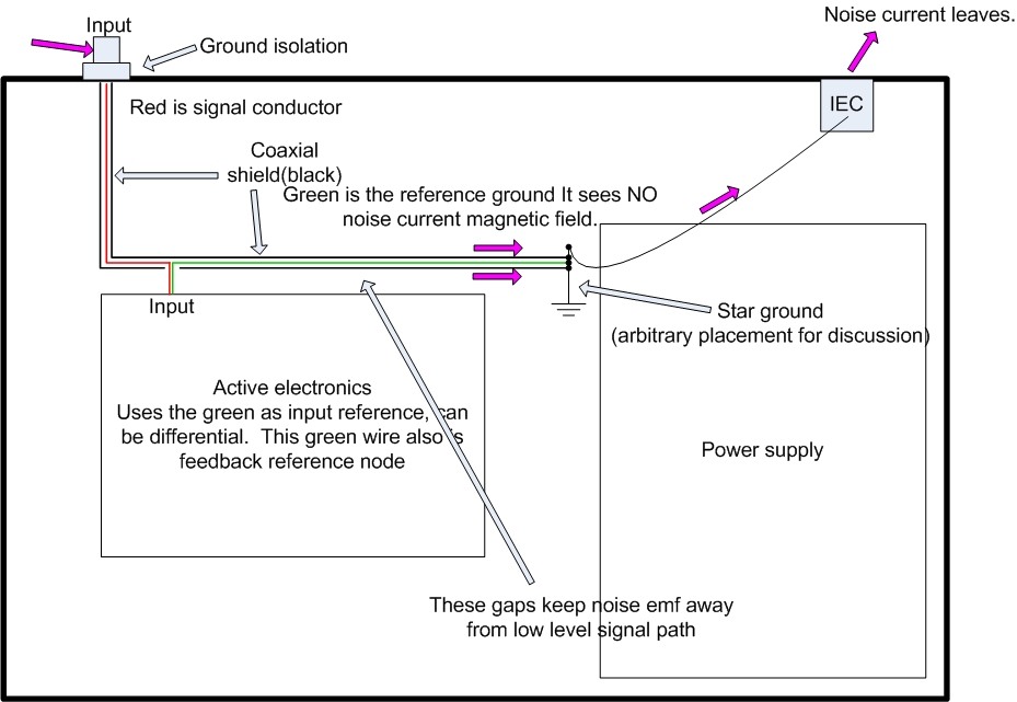

ALWAYS maintain safety ground integrity.
Configure the input ground to prevent coupling of the ground current with the input.
Remember, current flowing through an outer braid shield DOES NOT CREATE AN INTERNAL MAGNETIC FIELD.
This setup allows you to reference the input ground and prevents magnetic coupling from the input ground loop current to the input ground reference..
Cheers, John

As an add on note:
I stated ""current flowing through an outer braid shield DOES NOT CREATE AN INTERNAL MAGNETIC FIELD""
I have to clarify that.
A hollow cylindrical conductor does not have any magnetic field inside the inner surface of the cylinder. If you put any current at all into a copper pipe for example, there will be external field which falls off as 1/r...and there will be some field between the inner surface and the outer surface (within the copper), this field increases linearly from the inner surface (zero field) to the outer surface (max field).
Any wire that is within that copper pipe (or shield braid) will not "know" that the pipe is carrying current. This condition is NOT just limited to the geometric center of the pipe...everywhere within that pipe has no field. So for a twisted pair inside a pipe, both will see no induced field. For a twisted pair with a shield, this is not a given however... Zerofield is ONLY for a cylindrical cross section, so for a twisted pair cable, there must be additional filler material with the pair to force the braid to maintain a cylindrical cross section. Some mike cables do indeed do that..
For my previous post showing a mono setup, I force the ground current to travel on that braid shield to the chassis star ground. I then take advantage of the LACK of magnetic field within the braid to get the green wire to connect to the star ground. Any attempt to connect to that star ground OUTSIDE of the braid will see the magnetic field around the braid..the only way to get to that node is to get to the node via a zero magnetic field path..the braid or pipe..
This does not compensate for IR drop of course.
Cheers, John

What happens to the twisted pair if it is located near the middle of an elliptical shield?jneutron said:............A hollow cylindrical conductor does not have any magnetic field inside the inner surface of the cylinder. ............................................ Zerofield is ONLY for a cylindrical cross section, so for a twisted pair cable, there must be additional filler material with the pair to force the braid to maintain a cylindrical cross section.
While reduced, it will not zero. If the ellipse is a result of the wires themselves, then the wires are also following the twisted ellipse..not good.
That is why filler is needed within a twisted pair cable, as it has to round the cross section.
ah...to answer your question...any non cylindrical shape has the possibility of a zero net field location, but the cylinder is the only shape which guarantees zero field within the entire inner volume.. A twisted pair means that there is a possibility that one of them is in the spot of no field, but not both.
Cheers, John

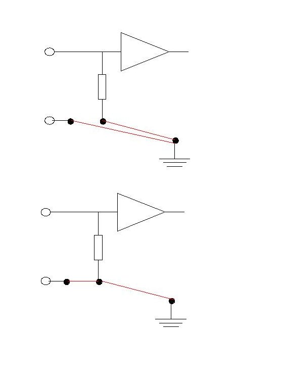

Hopefully not pulling things off topic here...
If I'm looking at the inputs of a preamp (lets assume a phono preamp for the toughest input signal), and I've got a input resistor as you would normally have with one side connected to the +ve input signal and the base/input of a transistor/op-amp and the other to 0v, What would be the best way of connecting the grounds of the input signal and resistor?
Would you have separate spurs from each going to a star point somewhere (where?)? Or, would you connect the ground side of the resistor directly (and as short as possible) to the input ground, then connect this ground to a star point?
I've tried to scribble this in the diagram.

If you use Neutral as star-ground, the ground loop issue will become worse.d1983 said:-common neutral point, so there's no ground loops
So what happens, if you connect a tuner to your neutral-star-grounded amp? The audio ground in that tuner is connected to earth through the antenna cable. Or a PC? Its SMPS is earthed and the soundcard is grounded to the same earthed chassis.d1983 said:There is no perfect conductor so depending on the amount of load your house is using and how close that outlet is to the panel, there will be a voltage on that chassis compared to true earth.
