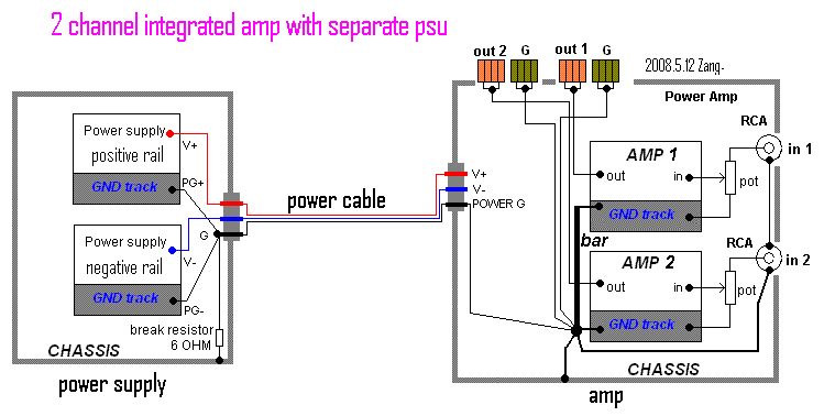

In the connection of post #5 the supply currents to channel 2 and 3 combined with the resistance in the ground wires to channel 1 should give rise to (or am I wrong?) a voltage on the inputs 2 and 3 (referred to their grounds). Will this be significant?
fluckscapacitor said:
If this grounding scheme is used, but the power supply is in a separate chassis (6 foot cable between the two), should the break resistor be put in the amplifier or power supply chassis?
here you go🙂
if you do not like break resistor you can use the other kinds of disconnect network or connect the power g to the chassis.
Zang
the start point of #5 is basis on you do not use the other ground bar.you have to connect all ground wires to a reference 0V point(circuit GND).
Zang

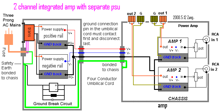

all these recent diagrams omit the Safety Earth.
These will completely mislead any newbie and even more experienced builders, into thinking that what is on the diagram is sufficient.
I suggest that all these diagrams that have a dangerous layout, by omitting the Safety Earth, be removed from this thread, before someone gets killed.

Why not just modify his diagram to reflect the safeway to implement his suggestions/ideas?
Hi Gni,
can you add the label "Safety Earth" to your diagram.
Can you add a note stating " the ground connection pin in the umbilical cord must contact first and disconnect last to ensure the Safety Earth is in place in the amplifier before the PSU power poles connect".

Your diagram shows, excellently, just how the RCA input barrels and the speaker terminals are Safety Earthed via the PSU. That complies with the rules that Gareth insists are impractical/impossible to meet.
I hope this fixes some problems of previous diagrams. . .such an
important issue. . . .some sort of standardized diagram for all
instances is needed. . . .

Seems there must be four conductors to allow for a safety earth connection
to both boxes. . .then a power supply return (ground). . .
The new diagram hopefully addresses both AndrewT and fluckscapacitor concerns. . .

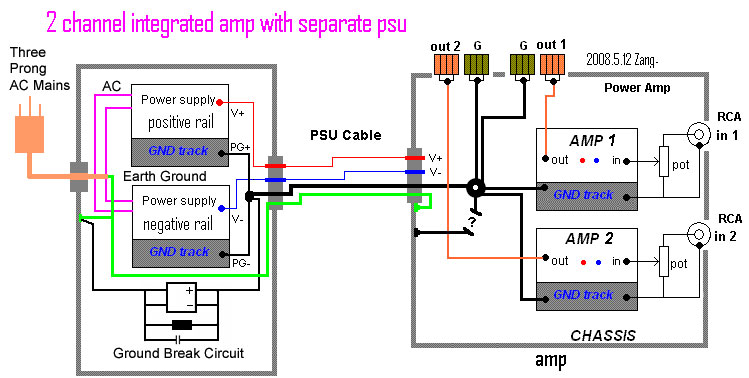

Hi Gni,
your last diagram addresses all the issues I had. Excellent.
Does anyone else see any problem?
Do we need a dedicated fourth conductor between the chassis?
Can the audio ground lead going to the disconnecting network do the duty of carrying fault current back to the PSU?
If we get agreement on your diagram, then I suggest it becomes the Wiki standard for two box amp/PSU.

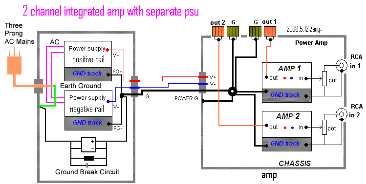

BTW,
your diagram can become a single box amp/PSU with just the removal of the extra box and the short length of surplus Earthing wire.
How about posting that once we see others' comments.
