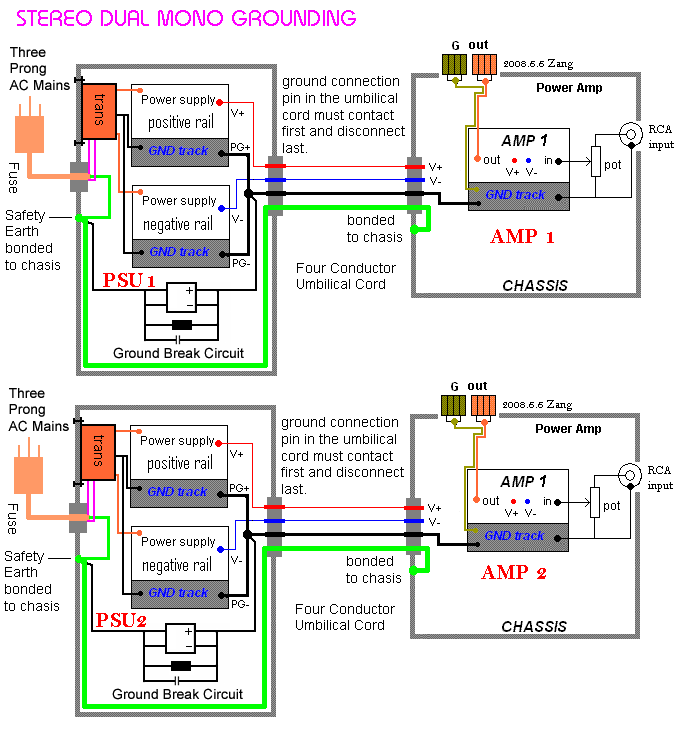

AndrewT said:Hi Gni,
your last diagram addresses all the issues I had. Excellent.
Does anyone else see any problem?
Do we need a dedicated fourth conductor between the chassis?
Can the audio ground lead going to the disconnecting network do the duty of carrying fault current back to the PSU?
If we get agreement on your diagram, then I suggest it becomes the Wiki standard for two box amp/PSU.
BTW,
your diagram can become a single box amp/PSU with just the removal of the extra box and the short length of surplus Earthing wire.
How about posting that once we see others' comments.
Andrew,
I think that the 4th wire for safety earth should go to both enclosures, if "the audio ground lead going to the disconnecting network does the duty of carrying fault current back to the PSU" then you could momentarily get a voltage difference between the 2 chassis, which would result in the bad kind of shock using 2 hands. Or, if the 2 enclosures were stacked or side by side and touching, you'd be shorting the disconnect network.
Questions I still have are if there should be any kind of connection between the amp chassis (safety earth) and audio ground in the amplifier, for example capacitors to the chassis from the shell of an RCA jack

How would you suggest to ground dual mono Amps, two channels each with its own psu? One "global" starground for both channels or one starground for each channel with its own gorund loop breaker?

Now, to put some values to parts mentioned, I put forward Rod Elliott's article for comment, which would apply to Australia and the UK; a parallel combination of
- 35A back-to-back diodes (using a 35A bridge)
- 10-ohm 5W resistor
- 100nF capacitor (X2?)
to Floric,
the attached is a dual mono grounding.
