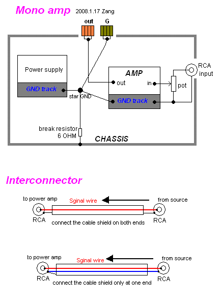

1,star grounding is not problem with mono system,as a result it can avoid inner ground loops.surely it is not problem with dual mono stereo amp.
Ok then how about when the equipments are interconnected?
Notice,there are two way to make interconnector cables,connect the cable shield on both ends or connect the cable shield only at one end.whatever there are still no loops between the source and power amp.
Zang

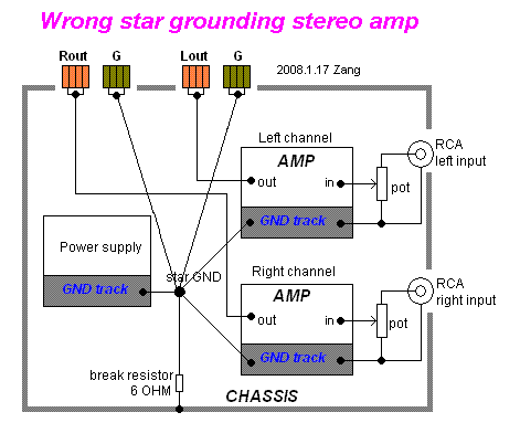

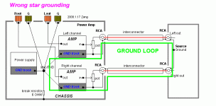

2,be careful star grounding the integrated stereo amp and multi channel amp.
example:
when you install two power units in a single chassis.there are two common ground on each power unit.if you do star grounding,there are latent loops.
Interesting. I am currently fighting this ground hum. If I put a pair of amp (L+R) no hum. But once I put additional pair (to make it 4-channel) I hear hum.
At the end I had "all grounds connected everywhere" to obtain minimal hum - still audible on very quiet night.
What is the correct grounding for stereo amps then ?

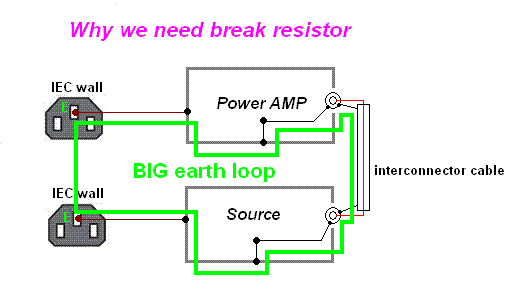

continue the case 2,
when the equipments are interconnected,whatever what kinds of the cable shield way you are using.there a big loop between the source and power stage.the interconnector is a pair of antenna:xeye:
this can explain why you amp is quiet but when connected the source,the hum coming.

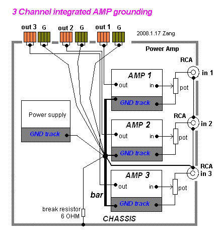

to prevent ground loops,i do works below:
connect all signal grounds (RCA plate terminal) to one common point,
choice one power unit's ground as common ground.the common may be a wire,a track on a pcb,
assemblied the power units as compact as possible.
P.S.
when do air wring,use strong wire or big copper as common ground.
when you design a pcb board,you have to be smart address the specific factual situations of grounding.lay out enough grounding pads on your board.
to design a circuit board for integrated amp,layout multi-channel amp in one board with star ground concept.
star ground is talk about pcb layout technology.star grounding is talk about wire connecting technology.do not mix up.
the attached is a example of grounding 3 channel amp in a single chassis.
Zang

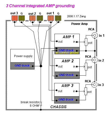

the attached is another idea.
it is useful when you build an integrated amp with pieces single channel pcbs.
connecting all pcb's ground track via a strong wire.i use 4mm diameter copper wire.this wire is your amp's common ground.then connecting all RCA plate together to this common ground.
again,
assemblied the amp units as compact as possible.
Zang

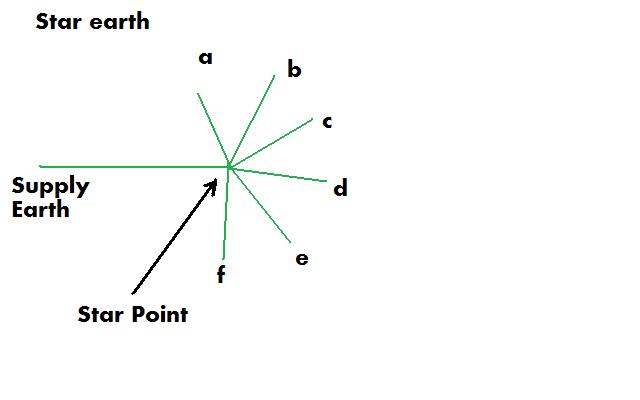

fluckscapacitor said:
The appropriate way to do star grounding (which may or may not include the disconnect network) with a stereo amplifier that has a power supply in a separate chassis and a long cable between them
Perhaps this will help. Also pay attention to where your equipment is supplied from. I do not connect mine from different outlets and I also use a radial supply and I have never had any ground hum loops.
Gareth
PS..I think I should state again that you should not put any sort of resistance on your supply earth, you will be asking for trouble under fault conditions. Apply ohms law with some figures and see what you come up with to support this
