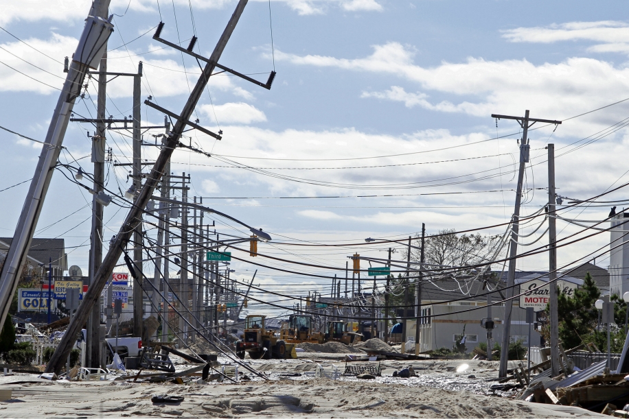

Lets see, scary ****....
Bootleg 'grounds' (Connecting ground and neutral at the outlet because you don't have a real ground available, what could possibly go wrong, and yes this is a thing)!
Locally grounded medium voltage neutrals (as in the primary side of pole pigs), makes life 'interesting' when the upstream neutral comes adrift, and particularly in rural areas there is lots of medium voltage distro running single phase (Worst case for this).
'Wire Nuts'.
An extreme reluctance to upgrade stupidly old installations (Knob and tube should have been ripped out 30 odd years back, everywhere).
The fact that the 'Cheater plug' is a thing (And that by implication ungrounded outlets have not been ripped out during a routine upgrade in the last 30 odd years exist in enough locations to make selling them at home depot worthwhile).
Clothes driers and similar loads running from two legs of a split phase supply, with the ancillary 120V loads returned to the GROUND pin because neutral was not available, this was broken when it was first done, and should just be illegal.
None of these things would come even close to passing the sniff test in the UK.
Also, what is it with the fondness for overhead distro in cities (It makes sense in low density rural areas), it is visually a mess, prone to pick up any thunderstorm going, and probably materially less reliable then putting it underground (Which I will grant is a higher capital cost option).
All this, and you still cannot get enough juice out of a kitchen socket to boil a kettle in reasonable time (UK kettles are typically 2.5 or 3KW, we likes our tea!).

The coastal regions have other issues as well. One storm surge would have taken our village's power out for months. Hurricane Sandy was 11 foot over high tide, we had 4 feet of saltwater in the center of our village. At this time, they are considering an independent backup system for emergencies, and some "person" tried to piggyback underground installation of both primary and backup systems for "visual appeal". I went ballistic, it was not pretty. With hundreds of branches underground to buildings, all it takes is one hydraulic break to flood everything and send us back to the stone age. And they had the "bright idea" to put the backup system in the SAME underground setup as the primary!! 12 dozen eggs, one basket.... sheesh.Also, what is it with the fondness for overhead distro in cities (It makes sense in low density rural areas), it is visually a mess, prone to pick up any thunderstorm going, and probably materially less reliable then putting it underground (Which I will grant is a higher capital cost option).

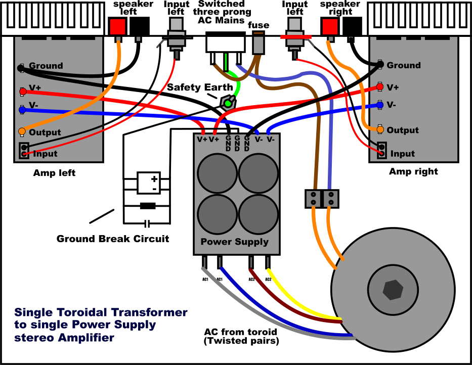

Thank you very much Zang and all the others that contributed to this topic. The subject of grounding and pretty much everything about diy audio is all very new to me. The rewards are very satisfying and I have had a grin from ear to ear for the last few hours. I built the amp using the chinese Quad 404 clone boards in kit form. I am using a 300va dual 36volt toroidal transformer. I wired it up as per the above image and used the light bulb tester first and was pleased to see the bulb go out without any smoke from the amp. I have listened for a few hours after removing the bulb tester and am very pleased with the result. There is absolutely no audible hum and the sound is good, although I thought it would have a little more bass. I am feeling confident to try my hand at a few gainclones next. Thanks again to all of those who take time out to contribute to this very helpful forum.
Martin
Martin
What you show looks ok, as always the devil is in the detail. Have you twisted all the signal and power pairs/triplets (or used screened cable for the inputs)? Congratulations, it sounds like you've done a good job.
I would avoid to place the mains socket between the RCA sockets.It would put it at the right side of the case, as well as the trafo and the power supply.View attachment 659558The latter part of this thread has become somewhat confusing. Here is a diagram of what I understand based on previous posts and related to my application. Have I understood this correctly and will this work?
I would move the RCA sockets as well as the amp boards close to each other.
For me, the ideal location of the heatsinks is on the front plate of the case, a la Quad 405.
