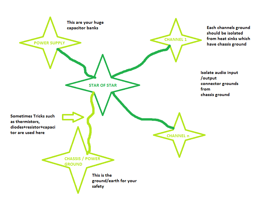

A good aluminum heatsink has a flat surface and the thickness is 3mm or more so that makes a ground bar of 3mm times its height so say 50mm which gives a ground bar of 150 mm2 or more . Does anything speak against drilling and tapping a few holes into that below the pcbs and then using the heatsink as the central point of a ground star ? Take the central point of the power supply to that heatsink as well and it will give you the chassis ground as too as it is screwed on to that. This is assuming you have a common heatsink for the chipamps and that those are electrically isolated from the heatsink.
The bigger the heatsink the bigger the groung bar. This way there can be no ground voltages between the different amps grounds ever. Right or wrong? If wrong please explain why.

What about the resistance of the wires? A "T" at the main smoothing caps is best and allows control of the ground currentsThe bigger the heatsink the bigger the groung bar. This way there can be no ground voltages between the different amps grounds ever. Right or wrong? If wrong please explain why.
The groundwires go from the pcbs to the heatsink so should be 2 inches or less. Cant be any shorter. Plus one can solder them to the pcb as close as possble , say from the point where de decoupling caps of the pcb are joined. The 3 wires from the caps of the power supply, ground of that and rails, can be twisted together tightly so cancel any radiation and that ground goes to the heatsink as well so we get the rails to where the pcbs without any loops too. There can , this way , be no measurable voltage differences within the heatsink and whatever difference there is in the 2 inches or so of wire connecting the ground of the pcbs in question will only affect the pcb which causes it but never the others as the heatsink which can not develop any measurable voltages within itself is the common ground then. It does not matter if there are 2 or 4 or more pcbs either. The heatsink even being aluminium instead of copper is the biggest most solid ground bar in the system and as it has to be there anyways it is a free ground bar. It doesnt cost any extra.

You would want the heatsink to be isolated
From everything. The last piece of the puzzle is a ground loop breaker between power ground and chassis/PE.

Wrong - you don't want chassis ground (ie. mains earth) to connect to signal ground ... which is the central ground star.
Andy
As a general rule the star ground (if used) should not be mounted on the chassis, although this mistake seems surprisingly popular. It may be connected to the chassis by a single wire.

I believe Douglas Self advises to connect the input ground to the chassis ground from the input connector. And then again from the input connector to the star ground. He discusses this in his "Audio Power Amplifier Design" book in chapter 25. There is a graphic of it in Figure 25.1 and a description of the rational for this in the "Amplifier Grounding" section. I am hesitant to post the graphic from the book as it is copyrighted material.
I have to give an additional explanation here.I am talking and consulting all this for a special case : I am building two active 4-way speakerboxes in which the radiator is not in any contact with a grounded casing. The whole electronics are mounted inside a wooden compartment at the base of the box which is insulated and well ventilated as well. The inside of the wooden compartment will be screened with aluminum foil but there is no metal casing as in an amplifier. In addition the signal to these boxes will be by streaming using a high bandwidth wlan connection so their only connection to the outside world will be the mains-cable
