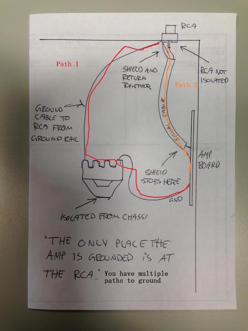

You need to star ground the power amp. You have multiple paths to ground in your setup see pic 2.
If this was me I would connect the ground bar to the chassis and wire like in picture 1
PE can be return for signal but I never said this was ideal. In fact it causes noise.
Back to the original question.

Hi
Tanx for the interest ( :
Im not gone use the PE, only using two wire powercable.
The signalcable is a two wire connection, signal and return connected at the amp PCB.
On the RCA, signal connected to centerpin. Return and shield connected together at RCA chassi.
Cut one wire and there will be no sound.
So what I ask is.
Must I isolate RCA?
Must I have stargrounding?
If so, the one and only chassi connection will be at the stargrounding?
Can I disconnect the cable that goes from groundrail to RCA chassi?
I have rerouted the amp GND cable to groundrail, before it was connected to the zero volt on the capicitors, this helped reduse the hum by say 25% at left canal and 50% at right canal ( listen at the speakers with zero volume ).

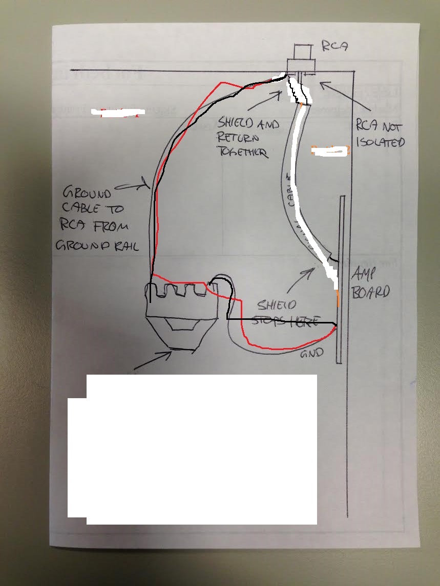

Looking at your pictures now. See it now, dont use the return in signalcable. Let the return go from amp PCB then to groundrail and then RCA.
Frank
Maybe same questions been asked again and again, Im a slow learner 😕

Shield not connected at amp is good, the shield should only be connected at the ground end. This then acts as a guard to reduce induced noise into the signal.
It does not matter too much if ground is at RCA or grounding block as long as you DO NOT have multiple paths.
Also make sure you do not have AC power cables near signal or DC cables. If they have to cross make sure it is at near 90°

SIGNAL Flow and Return must be a close coupled pair all the way from the Source to the Receiver.
Thanks for coming back and reinforcing the message.
