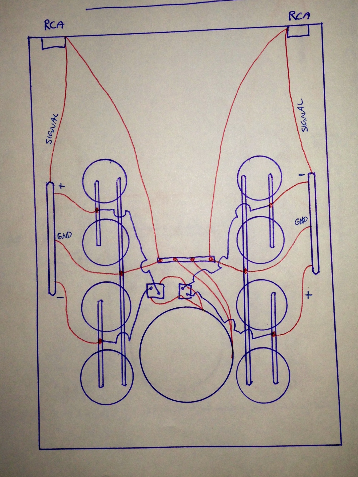

Hello!!!
This is my latest drawing,i think i got it.
Red lines are signal hot,black signal return.Lm3886 and two of 1875 are on separate borads.All signal returns are seperate on amplifier boards and then connecting together on Preamplifier board and from here go to main audio ground.Now all signals having it's own return wire close coupled.....Is this correct?
You also need to include the power grounds in your diagram this is where problems lie when you have multiple grounds from a single component.
This is power and speaker grounding(top layer of the board power traces are at bottom) ignore the signal grounding they will be connected as i draw in my previous post.
No, the long commoned wires to your star ground will introduce interchannel crosstalk. The important thing about a star ground should be that it is a star, not that it is ground.basi said:Is this correct?

If EVERY circuit has close coupled Flow and Return PAIRS, them you are correct.Hello!!!
This is my latest drawing,i think i got it...................Now all signals having it's own return wire close coupled.....Is this correct?
Your drawing does NOT show close coupled PAIRS.

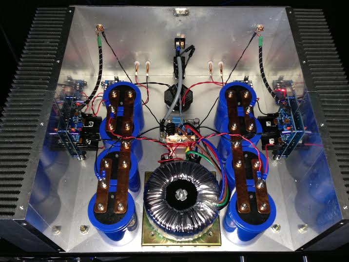

Probably an external hum loop due to mains earth. You don't show the chassis grounding and the mains protective earth grounding arrangement.
Best to make a single point connection of PT CT wires and cap 0V wires - as all the references remind you - and not spread them over a 0V busbar.
Take the amp module 0V lines to the main earth bar (not the main caps 0V).
