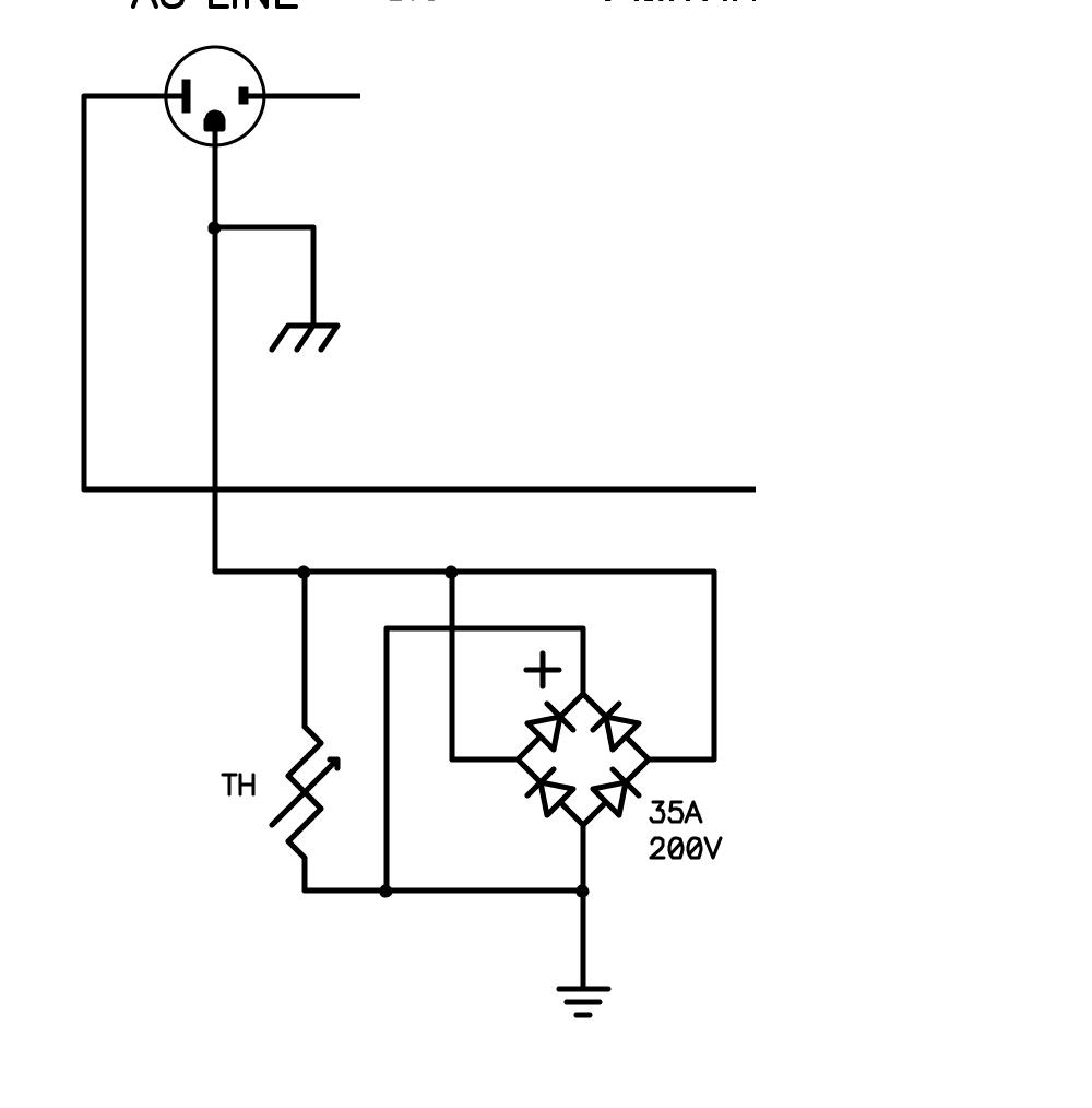

What is SLB that you and Davenport refer to?
My impression of the SLB in the diagram I posted is what is referred to "ground break circuit". I assume Davenport is referring to the same thing.
However, realistically I'm planning to implement the system Nelson Pass uses in the F5T

read posts 1 to 10.
in post 7 it is shown how to wire the input sockets, which must be isolated from the casework.
if this dont work, i would rewire your whole amp using a central star bolt, because in your picture and diagram this does not seem to be the case, connect up the ov's in order of the magnetude of the currents ie main tx ov, main caps ov, pa hi current ov, speaker ov, pa low current ov, input socket ov.
if you decide to rewire, consider to re-arrange the mains tx to be far from the pa pcbs, dont mount pcbs on the txmr.
good luck.

it is all about current loops. You must understand where is the loop for particular signal and try to make it short as possible. All this STAR nonsense only confuses people. They are looking for "stars" , try this and that and at the end of the day connect it somehow just to get minimum noise =)
But, if you understand where high current loop goes, and low current loop goes, you can make them separate physically or placing coupling HF and LF capacitors =) But you have to look into the drawing.
