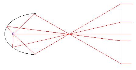

This is a bit trickier than measuring a parabola, since an ellipse has two focal points. You could successively trim a piece of cardboard until it fits into your reflector perfectly, and then use that template to find a graphical solution to the ellipse equation. That would consist of tracing the ellipse cross section curve onto a piece of paper, and finding a length of string and two focal point pins on the central axis that give you the same curve. Pretty tedious!
Or you could precisely measure the diameter at two different distances from the center of the reflector, and plug those values into the general ellipse equation to find the parameters of the equation for your ellipse. That would give you the location of the two focal points.
I would just use the experimental approach: Move a small point source lamp (ie. a flashlight bulb) along the central axis. At each position of the lamp, use a small piece of white paper to see if you can find a point on the axis where an image of the lamp filament is formed. When you do find it, the lamp position and the image position are your two focal points.
To use an elliptical reflector in a projector, you still have to make the fresnel "see" it as coming from the fresnel's focal point. So the fresnel's focal point has to coincide with the reflector's second focal point. The reflector has to be wide enough to send light to the fresnel's corners.

You can get even more efficient if you add a large spherical reflector (red in the drawing below) with a hole in the center. This reflector sends most of the rays that missed the elliptical reflector back through the lamp arc and into the elliptical reflector.
The amount of added light depends on the shape and reflectivity of the reflectors, but without the spherical reflector most of the light getting to the fresnel directly from the lamp would be wasted, since it would not get to the projection lens.
