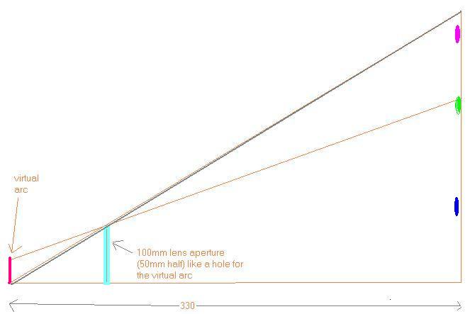

Check this attached guy;
if we place the pre-cond lens where intersets the focalpoint-lcd triangle with the lens diameter exactly, and then ensure the virtual arc is at rear fresnell focal point, then there is an issue;
the full arc lengh is not being seen from every point of the lcd (the corner does see only half arc lengh and the green pixel is the critical point where full arc lenght is seen, so it could be the cause of dim edges.

wrong place for arc
If you use a pre-condensor lens, then you can't put the arc at the focal length of the fresnel and still get parallel rays from the fresnel. You have to move the arc closer to the lens.
But aside from that, I agree with your premise: If the light from only part of the arc gets to the corners of the fresnel, then they will be much dimmer.
I think the best procedure is to place the pre-condensor lens at the right distance from the fresnel, so it would intersect the cone of light coming from a point-source at the focal length from the fresnel. Start with the lamp arc at that point, but then move it towards the pre-condensor lens until the cone of light expands to light the fresnel evenly.

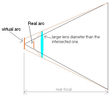

the picture i post is not the real arc at the rear fresnell's focalpoint. It is the virtual arc (real arc is somewhere between virtual arc ant the pre-cond lens, it depends on the focal lengh of the pre-cond lens, but now forget the real arc, think about the virtual arc at rear fresnells focal point)
The intersection of the lcd size and rear fresnells focal point triangle with the diameter of the pre-cond lens to determine the lens placement will never work if we place the virtual arc at rear fresnells focal point.
I sugest a larger diameter precondenser lens so full virtual arc will be seen from every point of the lcd. (the diameter of the precondenser lens is like a window if we consider the virtual arc, mean there wont be refraction for the ligh of the virtual arc)

And Rox, regarding post 51: I thought your picture might confuse some other people, which is why I mentioned the real arc placement. But I was also agreeing with your statement: "If the light from only part of the arc gets to the corners of the fresnel, then they will be much dimmer."
I think the cone of light from a pre-condensor lens will have a lux level that falls very rapidly toward the edge, because of the effect you explained. The best way to avoid using that part of the light cone, is to adjust the lamp arc to pre-condensor lens distance with the projector on. Then you can look at a mostly-white test image, and adjust the distance to get the light levels more uniform over the whole image. Most overhead projectors have a condensor adjustment, just for this purpose.

What i mean with my picture is that if we make the virtual arc be at rear fresenlls focal point, and also do the precondensor lens diameter intersect with the fresenlls, triangle (the triangle with the focal point and the lcd diagonal) then we allways will have dimer corners, because there is no way to see full arc from all lcd points.
I think making the virtual arc come from the rear fresnells focal point is a good idea (so parallel light will go throw the lcd), but the lens placement is not correct, we need a larger diameter lens than what you sugested or a closer placement for this lens diameter you talk about.
the goal is making a virtual arc at rear fresnells focal and ensuring this arc will be seen from every point of the lcd. Do you agree?

Yes, I do agree. We really need to put the virtual lamp arc at the position where it intersects the cone of light that would come from a true point source. That way light from all parts of the arc can get through the pre-condensor lens.
If you miss one end of the arc, you lose quite a lot of the available light. (The brightest parts of a MH arc are at the ends.)
