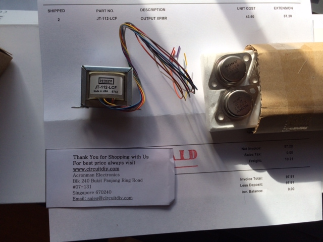

Maybe this will reveal a few questions about $ and scale.
I may lose these to extortion's from a certain Duetschlander guy.
