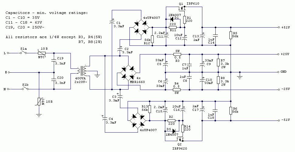

Is anyone considering working on a PCB for the bias sections? I'm thinking I might tackle it since it would be a nice add-on to the diyAudio PCB board. In order to have some adjustment to the output voltage, R1/R11 and R2/R14 would be a potentiometer with D1/D5 connected to the wiper, right? It also looks like Elna RFS 100V caps could be used all around.
