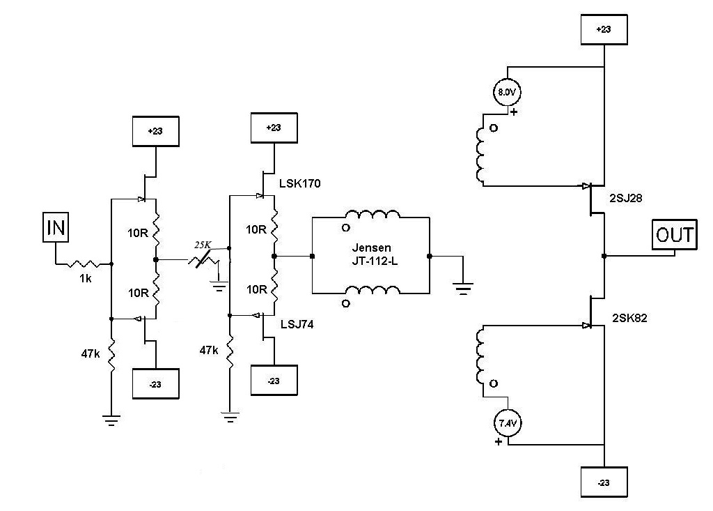

OK two more greedy questions...
What is the estimated power output for 8 and 4 ohms?
And could we use both secondaries in parallel and use only the top output device for a SET topology?
I think Michael investigated using one of the old SITs as a current source in the l amp simple sit which is very similar to this one but dismissed it due to having little transconductance and didn't work well as a ccs in the circuit. http://www.audiohobby.com/pdf/lamp ccs.pdf
top as SE...... means two things -
- waste of (lower) SIT as (poor)* CCS
- waste of upper SIT ....... as (poor)* source follower
*there are better parts for task , and much cheaper

yup
first buffer is pretty much redundant

those are so called 600:600 repeater coils
both primary and secondary comprised of two independent windings , that's more like 150+150:150+150 , tranlsated as 1+1:1+1 , while Papa is using them as 1:1+1
note : when writing ratio ("1" to "something" ) , "+" is not used to represent fashion of connection in actual circuit
Repeater Coils
Hi, I have some 600:600 coils but they have only one primary and one secondary winding. Can I use two coils by putting the primary in parallel ?
Thanks.
Sidney
yes , you can ; be sure to take care of polarity , to have what's needed for F6
if I understood ya corectly that you want to use two xformers per channel - paraleled primaries , secondaries per schmtc .......
