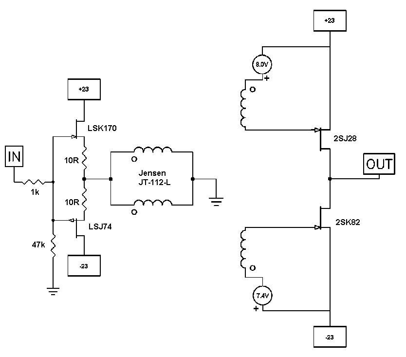

Is it just me or does the pitcure of the working amp have very little parts count?
I see 4 SIT TO-3s, two Jensen transformers and 4 lab power supplies. What's the catch?
Or, is that just it: small parts count?

Dont you want the flexiblity of 4 power supplies? 😀
I do not know the answer; but maybe minimize the number of PSUs. Most important with any # of PSUs is to protect the SITs. Vgs for each SIT must be on before applying its Vds.Dont you want the flexiblity of 4 power supplies? 😀
simple biasing PSUs ......... to quote Mighty ZM (post #11) - Juma already made that conveniently for ya
How about a soft-start for the SIT 23v power supply to slow them down?Vgs for each SIT must be on before applying its Vds.

CL60s may cause big dc in this citcuit on dual rail supply if they warm or settle at different rates. Timed or sensing relays would be better.
One dual power supply for pp SIT amp
I agree that a delay or a soft start is needed. The attached picture is the concept circuit to bias the SITs. Note the following
- One dual plus and minus ~33 V PSU is used.
- The source of each SIT is connected to its attendant power rail with a 10 Ohm power rheostat.
- At time zero [before applying power], the large decouple electrolytic cap is fully discharged, and the delay switch is open so as to put the soft start resistor in series with it.
- At power turn on, ~1 Ampere rushes through each 10 Ohm and generates a 10 V voltage drop riding on top of that of each source port which is +/-23 V.
- Simultaneously, the wiper of the 10 Ohm rheostat applies the prescibed Vgs. For example, the gate of the P-channel SIT sits at the target plus 8.4 V above its source voltage of 23 V.
- Once the voltage across the decouple capacitor reaches 9 V, it is safe to short [with shorting switch] across the resistor in series with the cap. The safety scheme like that shown by Zen Mod [#11] will be adaptable and/or applicable here.
- The full effect of "decoupling" the source resistors is fully enabled. The amp is ready to play music.

why not some 7908, similar to Mike R's LAMP hookup.

Tea-Bag: Juma used two PSUs; +/-51 V for the front end which also developed the complementary +/-Vgs for SITs. The second +/- 25 V PSU was their Vds. Zen Mod maybe emphasizing the best approach is to adopt 2 PSUs like he and Juma used [Post #11]. Rothacher's SIT amp used two PSUs, and that works. 7908 for the N-SIT and the complement of 7908 for the P-SIT will work.why not some 7908, similar to Mike R's LAMP hookup.

really whatever is warming ya heart ........ but 8V from 7x08 isn't enough
it demands something as zenner in gnd tail , to elevate output voltage to , at least , 15V or so
in that case - 7x15 or 7x18 or , even better , 7x24 is way to go
though - be sure to (additionally) load output of that reg with at least 15mA (led string or resistor )
in my sketch I drew 30V biasing nets , just to cover all possible Sony SIT ranks ( can't remember which ones I have at home ; most probably the same as Juma have , being from same purchase )

My mistake Zen Mod I was not clear. The PSUs I described for Tea-Bag are referenced to the power rails and not to ground. They float on the rails as shown in the amp's schematic. Although 7909 is called a fixed negative voltage regular it still can be configured to have an adjustable output to tweak Vgs.really whatever is warming ya heart ........ but 8V from 7x08 isn't enough

you were clear ; I'm just contemplating about voltage needed for these two additional stacked rails
Your thoughts are right on, as you recommend 30-40 V.you were clear ; I'm just contemplating about voltage needed for these two additional stacked rails

Shouldn t the transformer secondary phase be the same on both push and pull sides? Since the power devices are complementary?
BTW how is that different than an F6 with Sony output devices? Sorry if I am missing something huge because of my ignorance.
