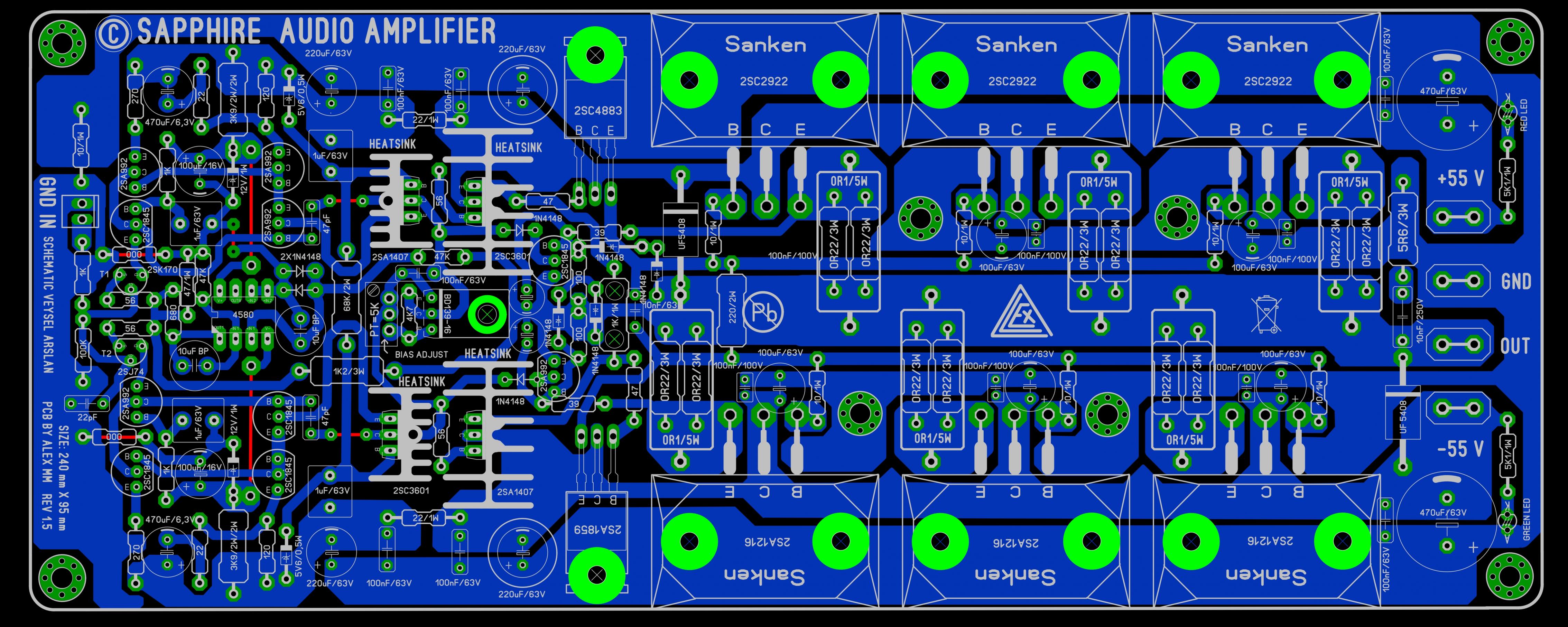

While is beyond the scope of an average DIY project here, I would welcome a well-thought and transparent protection circuitry in an amp which already possess very good characteristics.
We haven't seen the real world performance nor stability of this amp so maybe it's a little early to put them in the pcb 🙂

The most popular source is Ebay shops, but better for your location, would be to drop into Douglas Self's The Signal Transfer Company site and take a look at what's on the amp module boards Gareth Connor and He offer there. Apart from rail fuses?....there's only VI limiter options and they will be used by how many builders?
However, a separate, comprehensive protection card is offered below the Blameless and Load-Invariant modules and that is how most of us, who are too lazy to work a project through from the ground up, usually build amplifiers for our own domestic or general use.

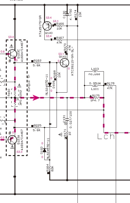

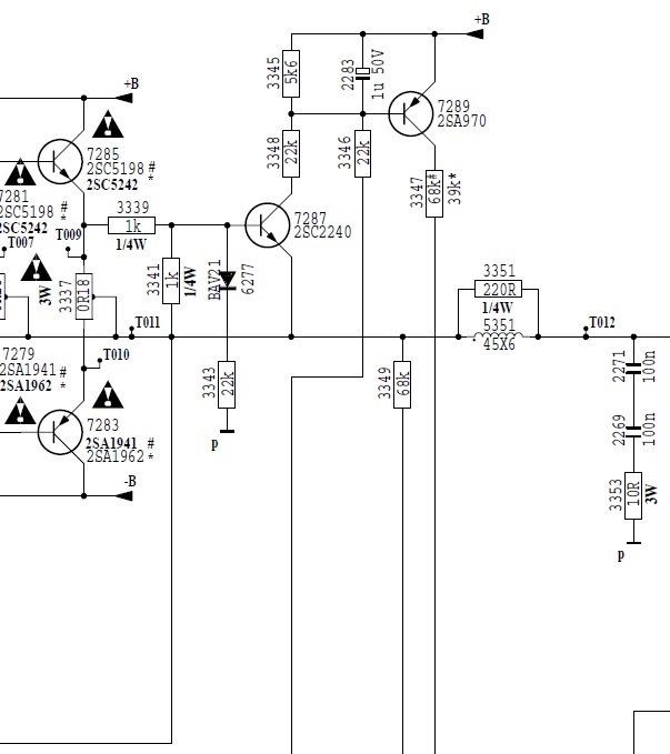

Hi, what's your opinion on this type of protection, its more common than VI limiters in Hifi amps I've dealt with, can also add DC offset protection.
Will need supply circuit to match.
Samples are from Marantz and Yamaha.

Hmm.. They appear to only sense current. It would help to make the operation clearer by having a little more of the schematics that show what the output of those current sense circuits (the collectors of Q140 and 7289 resp.) are connected to. Are they conneced to a protection chip/relay control like uPC 1237 or a MCU?
Yes it's connected to protection chip, such as uPC1237, or TA7317. Personally I don't like to use this chip, because now it's not easy to get them.
I have a full function protection, with transistors. It's easy to build well working protection, with low price devices.
Sajti
Thanks, Sajti. I had seen this on several schematics and seen some of them fail to work properly too, probably because there is an assumption that current alone will be sufficient to define safe operation. Anyway, this short article by Mike Renardson has some interesting thoughts on protection schemes for smaller domestic amplifiers.
The OP design is probably at the power level where more sophisticated schemes are necessary and this means making a proper analysis of the output stage load lines to derive the correct value resistors etc. Unfortunately, it won't be ultra-performance any more with those limiters affecting signal transients, even at moderate output levels.
It works quite good, if properly designed. The diode+resistor network can help to make it different then simple current limiter. Simulation is big help to optimize it.
