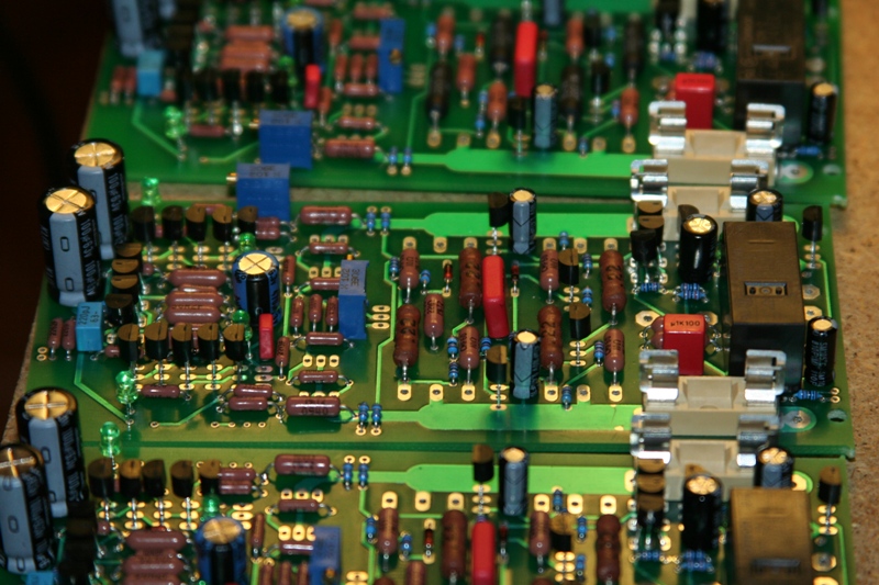

Alex, your PCB is excellent. I'm not able to do such a complicated amplifier with single sided PCB. I have to use double sided...
My point of view that the protection, - especially the switch on delay, and the DC protection - is very important, so I usually put it on the amplifier PCB. This save up some cabling work too.
Sajti
Sajti

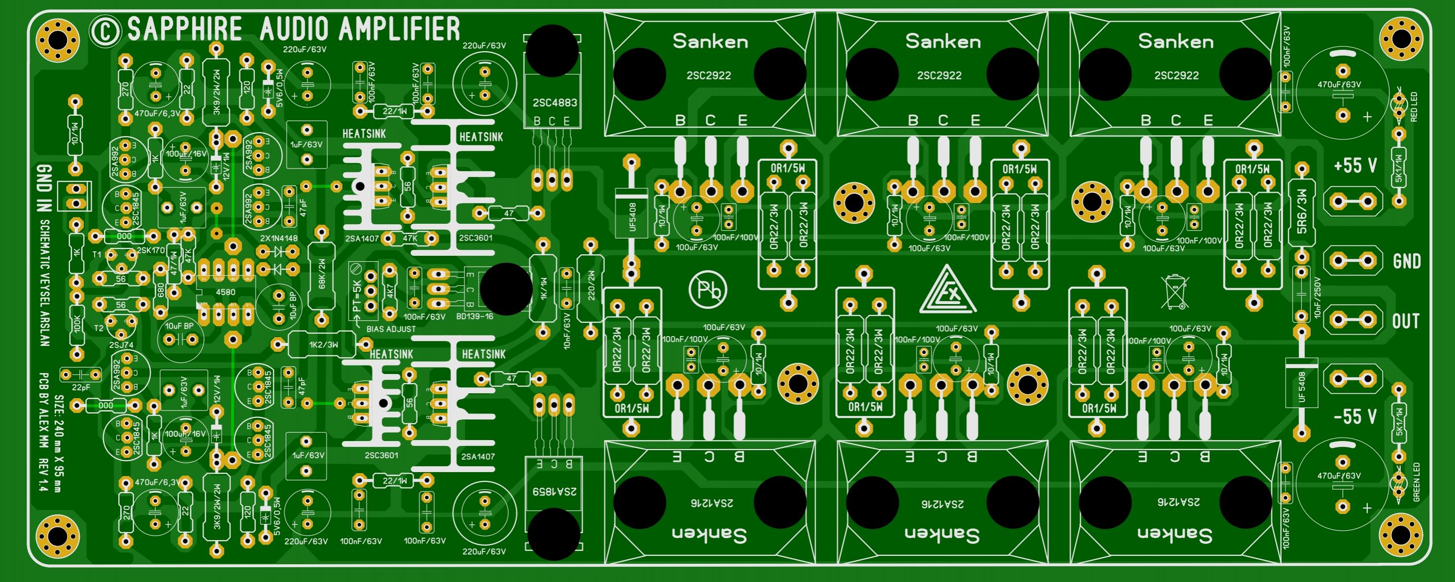

@400kg
Did you build and test actual circuit in diagram? Your prototype uses single pair and different output devices (2SA1943/2SC5200 I think). Could you post some o'scope screens that proves physical circuit in diagram is not oscillating. I know 2SA1216/2SC2922 aren't cheap devices but you have to provide reliable information about your actual circuit.
Thanks.
Thanks.

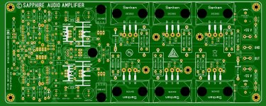

PCB rev 1.4
@ sajti
I'm agree protection is missing but I designed only PCB not schematic , maybe will be updated once . BTW your PCB's are nice designed .
Today I made some cosmetics on my board , resized components ....🙂
Regards Alex.
@ sajti
Regards Alex.
final update
Where is the ssafe operating area protection and DC offset protection?🙁
There has been a long tradition among DIYs generally, to construct amplifiers and related devices in modular form which permits simple, inexpensive changes, upgrades and whole safety systems of the constructor's choice as time, expertise and money permits. These are not commercial products, don't have to meet commercial standards and we are quite free to burn down our homes as a result of any shortcomings.Where is the ssafe operating area protection and DC offset protection?🙁
When it comes to choosing the lesser of several evils in protection schemes, it seems everyone holds a different view and for the designer to add his choice of protection or any other auxiliary circuitry is more likely to deter than encourage others to share the project. Recent interest in fast Mosfet switches as electromechanical relay replacements is a good case in point for choice.
There is also a considerable support trade in selling the components, PCBs and assemblies based on the simple modular approach that permits individual choice and reuse of the modules in subsequent projects. The coverage of commercial websites, print and electronic publications, Forums, Ebay etc. that have all catered to this particular style of DIY construction is pretty firmly established now and over time, it has proven the most popular, low cost and accessible approach to DIY construction for the average enthusiast.
