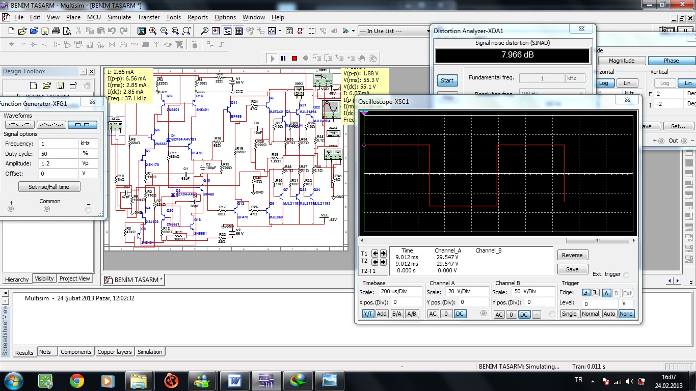

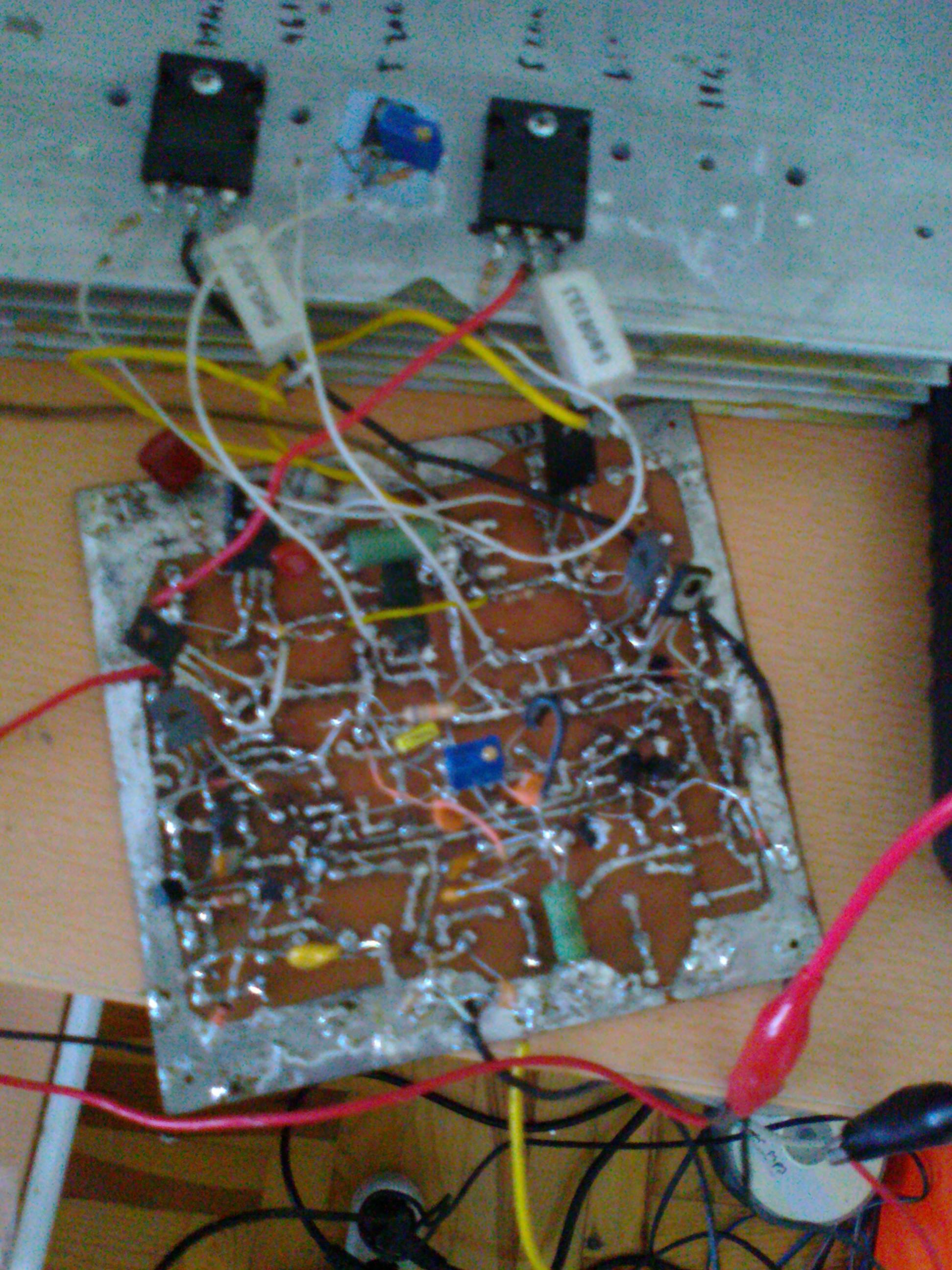

hi Mr. AndrewWhy square way at maximum power?
Why don't you try at half max and/or at 1/10 of max?
There is no much difference.
Final diagram EXCELINEAR
slewrate>180v/us
dc offset 4mv
slewrate>180v/us
dc offset 4mv
400kg I see you using Multisim,
Do you mind posting AC analysis 10Hz to 100Mhz
(Simulate > Analysis > AC Analysis... )

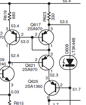

Looks good, I like this type of amp. Did you try hawksford type cascodes for the vas. A little performance gain can be obtained.
