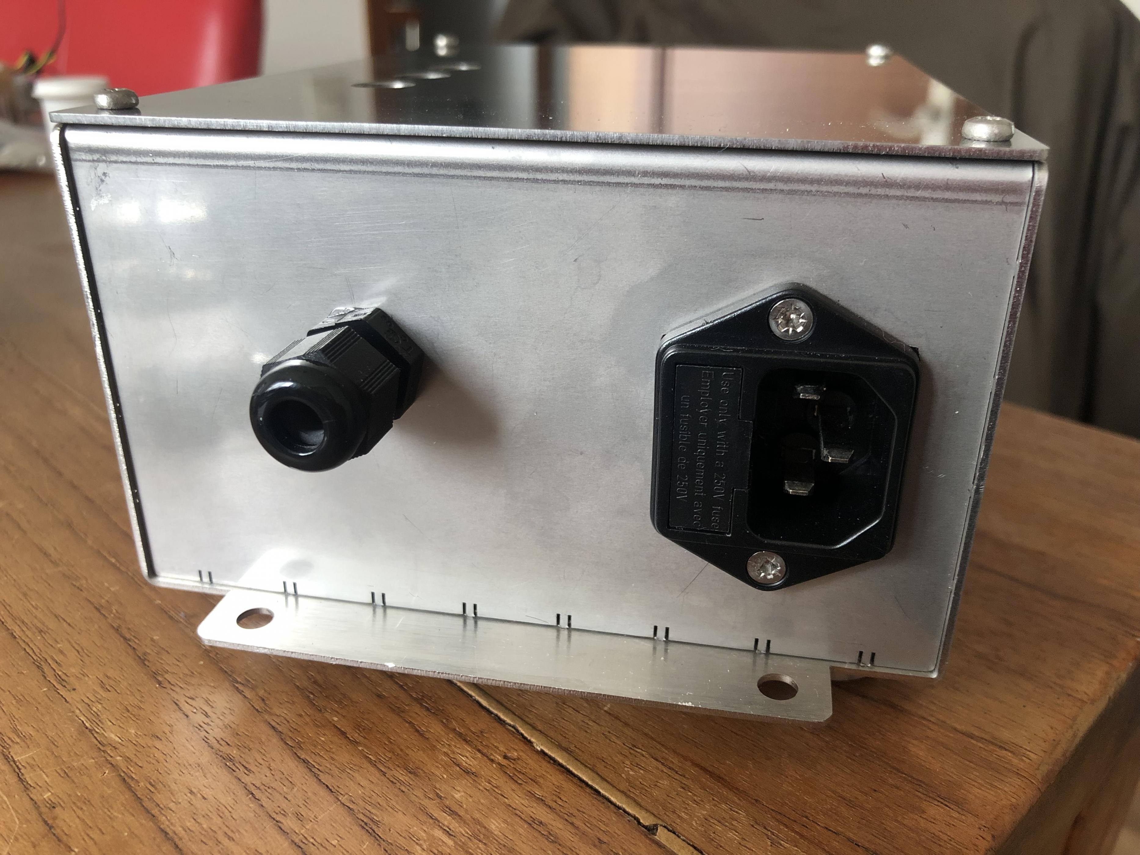

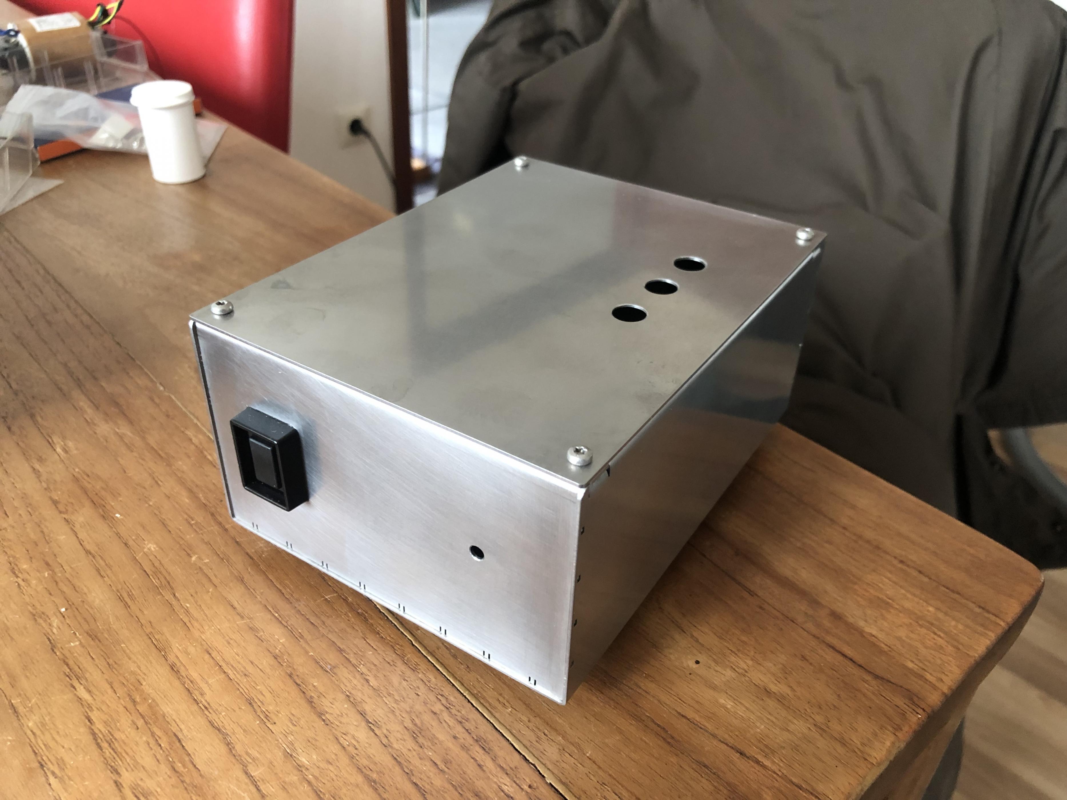

My latest attempt on a classic industrial looking PSU. One forgets stainless steel is a dog to work with unless one tries again after having forgotten.

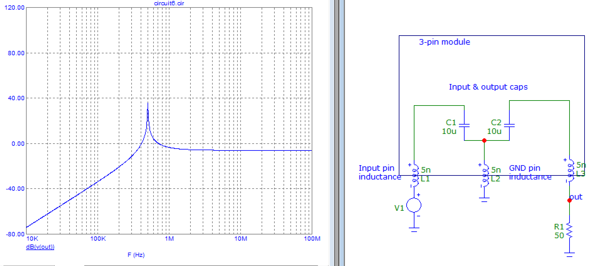

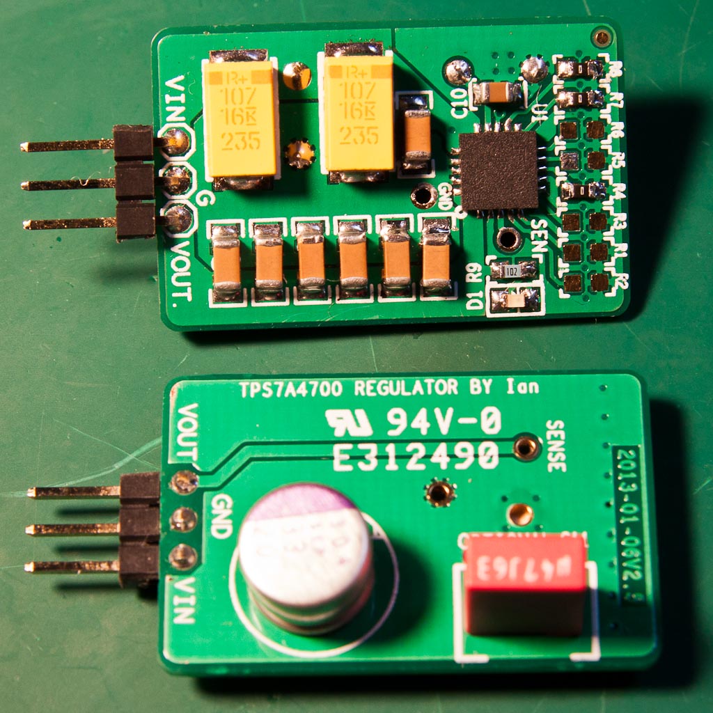

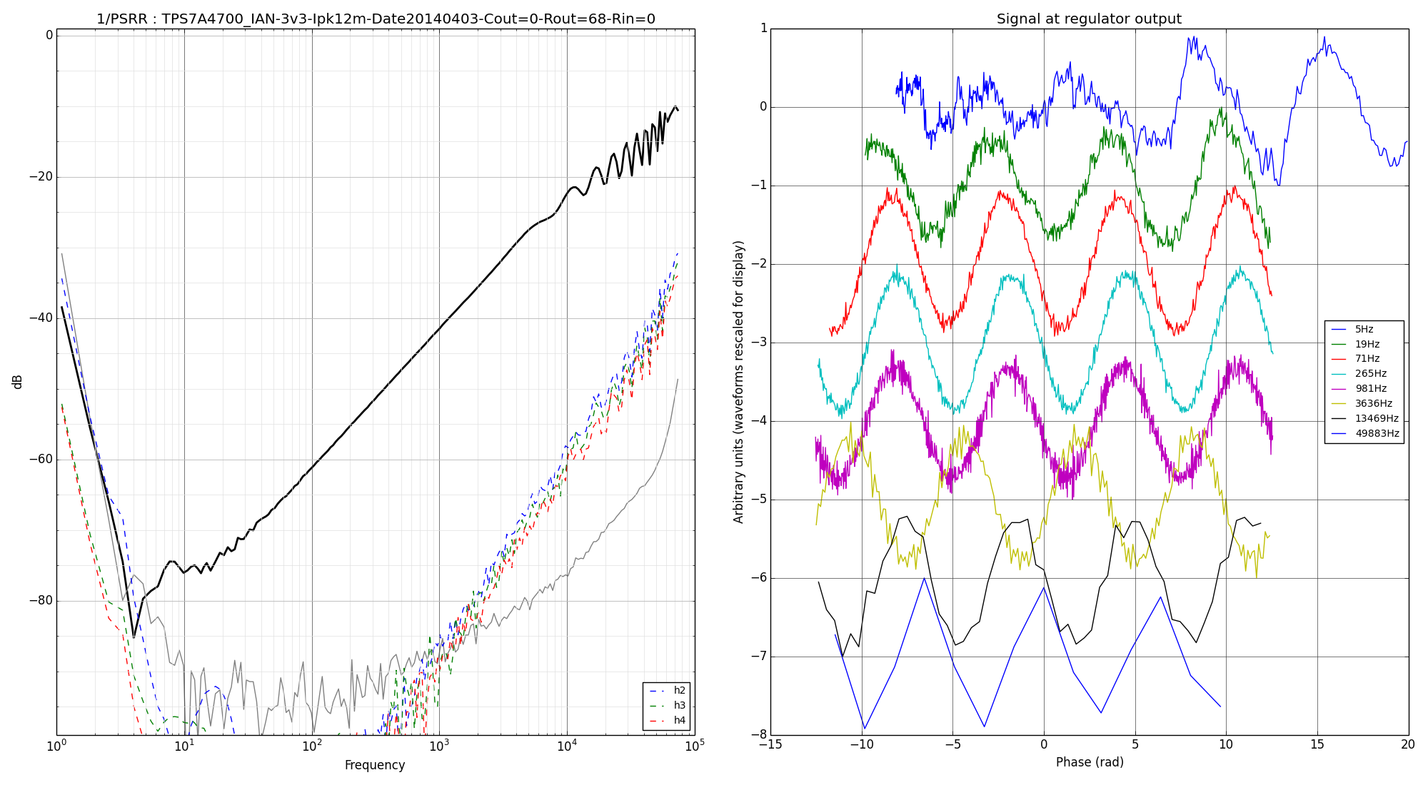

OK, I asked if they were in 3 pin module format (like this) because in this format when there are input and output caps on the module, due to the high inductance of the ground pin, input HF noise goes straight through the input cap, it ignores the ground pin, goes straight through the output caps into the output, so it has 0dB PSRR above a few hundred kHz lol. I've measured a 3-pin module with the high-end TPS ultra-everything regulator on it, and the PSRR curve was exactly like that.
It's intriguing that these two regs sound different... Have you tried to check the power supply while the device plays music or signal? Maybe cap-couple it into the input of a preamp and FFT the result, or even listen to it...
The ones as sold by also much criticized LDOVR are fine AFAIK. I am surprised by the design errors by Ian, thought his designs were measured and tested....
