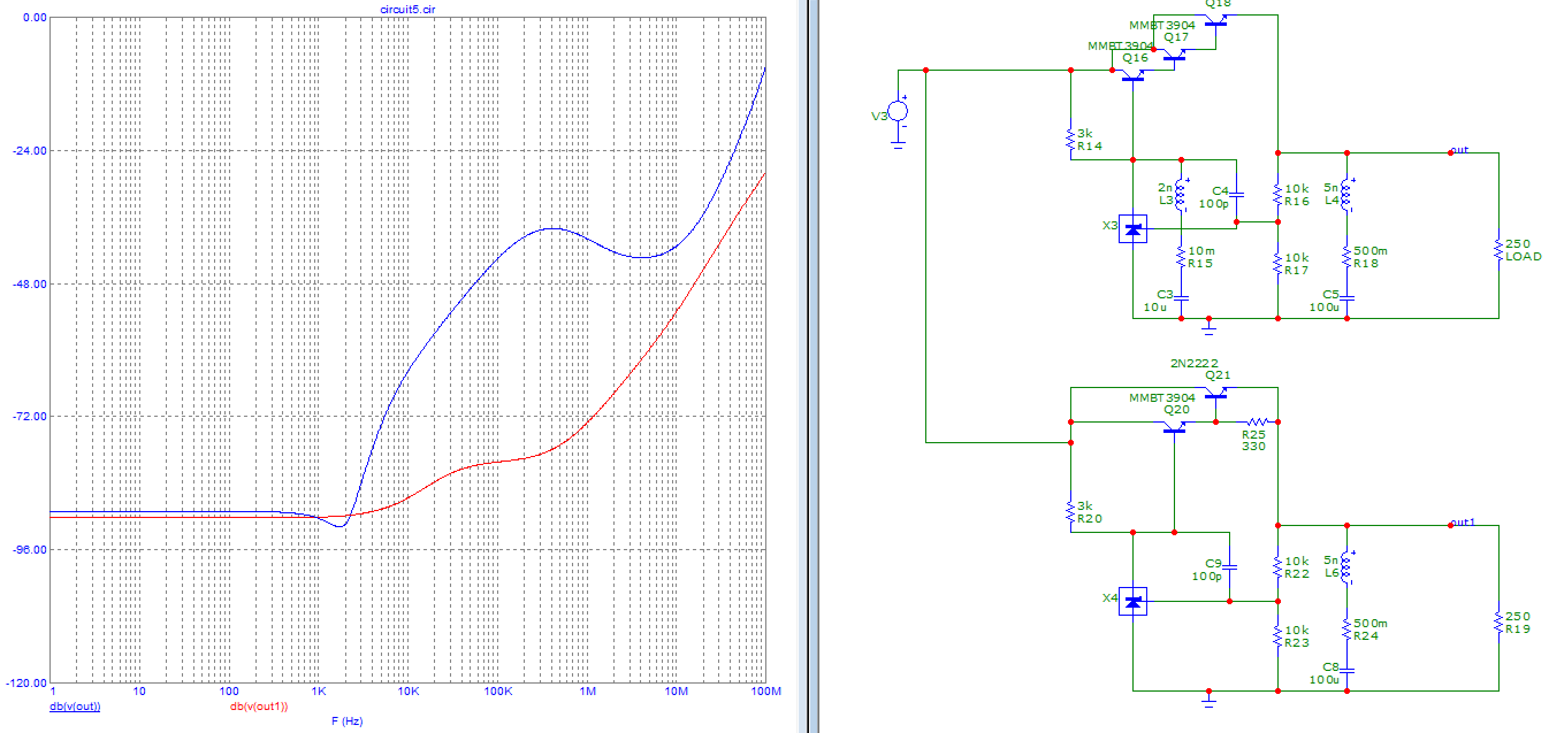

The original chinese reg can be improved: making the triple darlington into a double and biasing its driving transistor with some current (via a resistor) ; also the 10µF cap across the TL431 doesn't do anything so it goes away. This won't change the TL431 noise but it gets better PSRR.

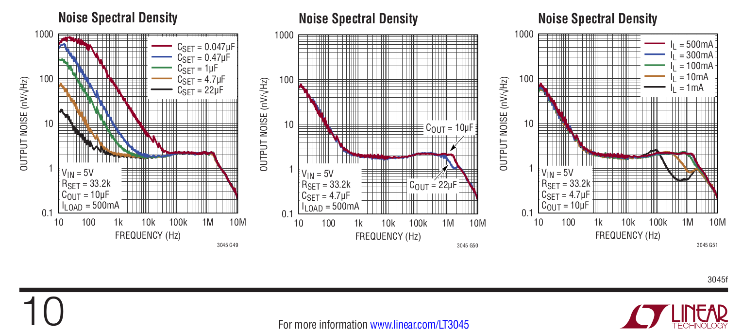

Before I forget, also suitable till 36V. They are allowed to give it a name with a "X" in it, call it "for audio" and charge the double price. I would buy the LT3046 Evolution X "for audio" without blinking an eye

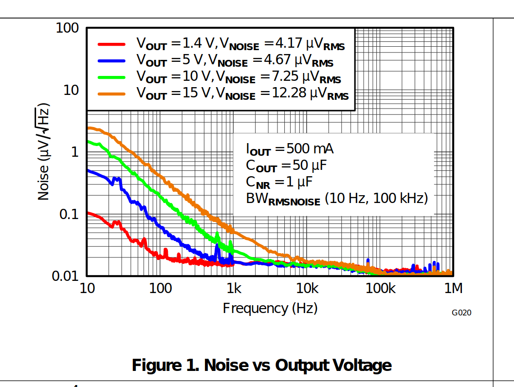

FWIW I judge both to be cream of the crop and in my PSU's the TPS7A4700 measures worse (as in : still very good) but sounds better... I should not say this as it is common in wrong circles to judge by ear and IMO often the most distorting stuff is then preferred but it was something I noticed anyway. Both are superior to anything I tried before except for discrete solutions in high(er) power designs. Even LM723 based dinosaurs in high(er) power designs are quite OK but they're not uLDO of course. My experiments with LM723 are not over yet as it can compete with 99% of SMPS in audio and is superior still.
Nice thing of TPS7A4700 is that it does do 36V 1A. Both IC's offer close to the max in current uLDO technology and haven't been beat by any switcher in whatever form with whatever guru filter in my setup. After many many tests I discarded all SMPS that I have either built or polished and haven't looked back. Even if one can get them silent at the output there is still the input section polluting mains voltage...

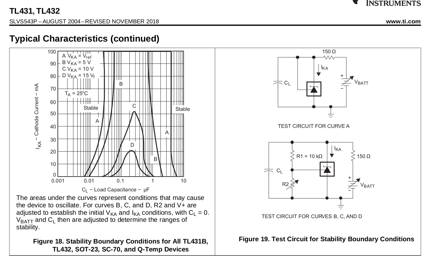

The 10u guarantee stability according to the TI data sheet.also the 10µF cap across the TL431 doesn't do anything so it goes away. This won't change the TL431 noise but it gets better PSRR.

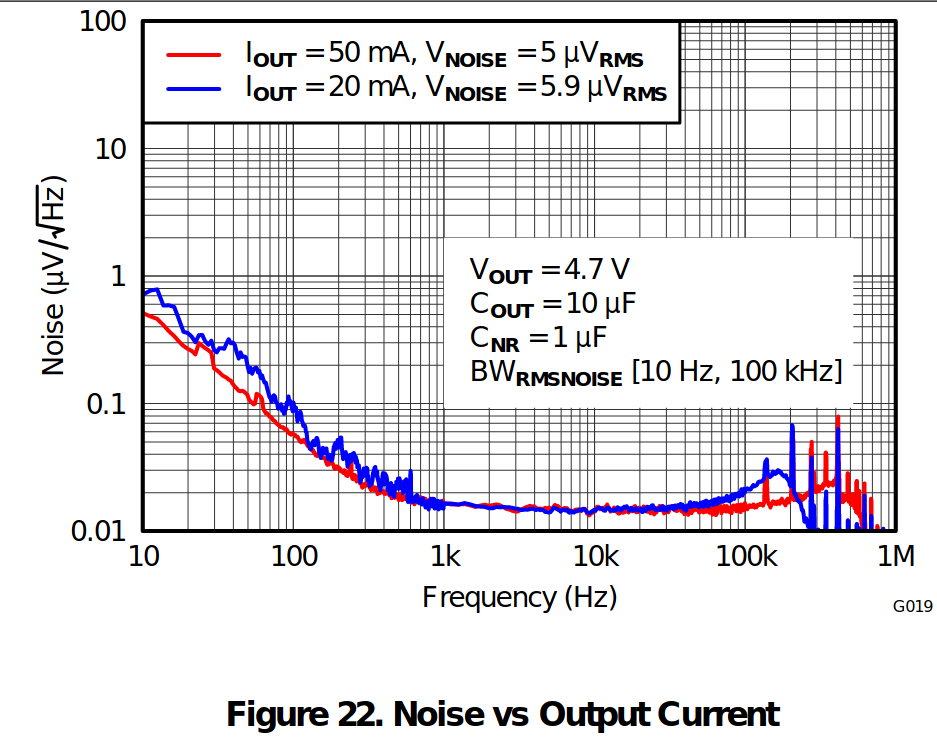

thanx for the tip, in fact, I don't have lt3045 on hand, I have tps7a4700 instead,
they seem to be very similar and perhaps tps7a4700 is even better.
No, not really. 1nV != 1uV.
As said, for some reason it sounds a very small tad better. Both my test winners in max. 25VA range are still here and I can not decide which one to keep. I know the LT3045 measures absolute best. As many audio guys only have their ears to judge I had the PSU's tested by them and they also preferred the TPS7A4700 (FWIW, thin ice etc.).
That's for a simple circuit with TL431 acting as shunt reg in parallel with the cap. This has nothing to do with the circuit posted above.

i Did try TPS7A4700 instead of my tweaked Chinese supply with tl431 and the noise/ripple is much lower with TPS7A4700 but the sound isn't as good as with tl431.As said, for some reason it sounds a very small tad better. Both my test winners in max. 25VA range are still here and I can not decide which one to keep. I know the LT3045 measures absolute best. As many audio guys only have their ears to judge I had the PSU's tested by them and they also preferred the TPS7A4700 (FWIW, thin ice etc.).
what I mean by 'not as good ...it seems to be flatter and not in terms of being less 3D but it's a little lifeless and it lacks the energy I get with tl431.
definitely measures better.
I will have to try the suggested tl432 design.
