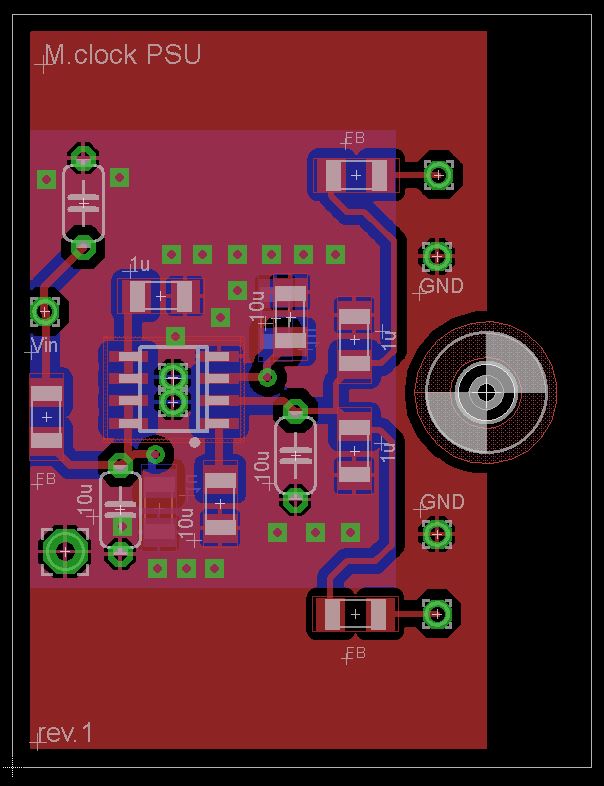

i have just designed a PCB for ADM7150 regulator and already sent it to a PCB factory so it's in making and I have ordered all the parts from Digikey, ...will have it all on Tuesday latest and I will test it and measure it.
i will get back.

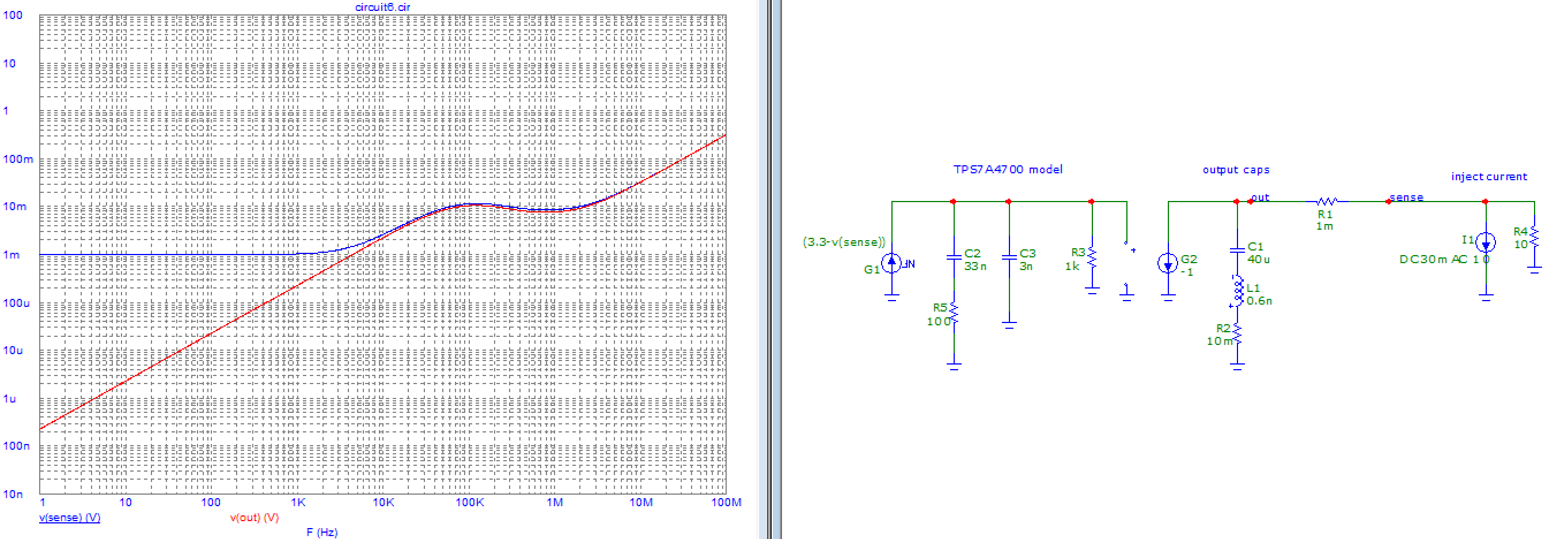

First, because he gets 0.4 mOhm at 100 kHz, which is 0.6 nH, which is unrealistic.
Second, TPS7A4700 has a "sense" input which is wired to the output connector, as you'd expect. I guess he injects current into the output connector, and TPS7A4700 regulates voltage at this point. However, he measures output voltage at the output of TPS7A4700, not at the output connector. This means the impedance of the PCB trace between the output of TPS7A4700 is not added, but substracted from the measurement.
Example:
R1 is the trace impedance.
Current source I1 is the load, it draws AC current from the output connector, which I labeled "sense". The regulator controls voltage at point "sense": to do so it outputs current that goes through the trace modeled by R1. This creates a voltage across R1.
If I1 draws positive current then voltage at point "sense" goes down. But voltage between regulator output "out" and "sense" goes UP due to the load current flowing through R1. If these compensate almost exactly, you get a false measurement of zero ohm. But if R1 is a bit larger than the LDO's output impedance, you can also get a false measurement of a negative resistance... hence it's important to look at phase too...
This stuff is very sensitive to the setup. And just wiggling the wires will change inductive coupling.
When I tested the LDOs, I made a series of little boards to carry them, with 0.1" headers to the measurement setup. One pin to inject current, one to read the voltage back, both for input and output, and about 20 ground pins, with balanced inputs to read the voltage. With the connector I'd be sure there was no change in inductive coupling between measurements because nothing moved. Then I calibrated it with open-short-load, and the "short" calibration standard was a chunk of copper clad PCB. So at any time I could unplug the LDO and measure the short again to check the measurement floor. I also measured a LDO carrier board with the output caps replaced with wires, etc. It's a bit of work to ensure it's measuring what you think it is...
I have zero trust in the 0.1 mOhm output impedance measurement.

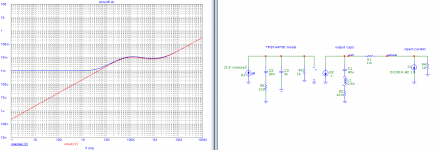

I guess you are referring to the sense-line measurements further down the page as in the first diagram the output impedance is 20mOhms@100kHz.
Anyhow the lower output impedance of TPS7A47 vs. LT3045 is quite apparent also in the load transient diagrams in the datasheets.

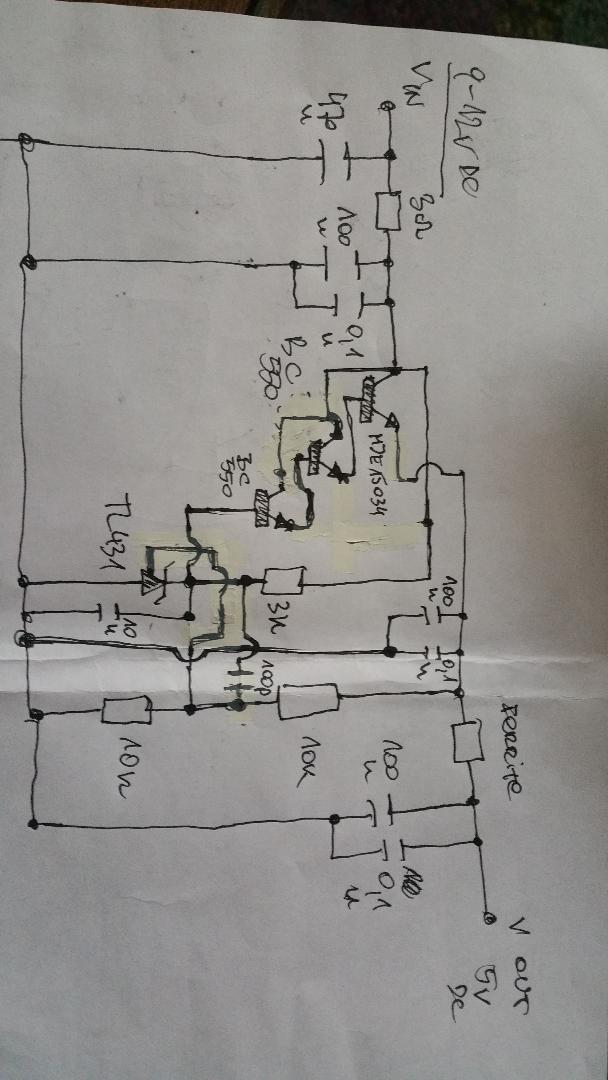

Peufeu, thanks a lot for your verdict on an old PSU design by me. I just found it here and had a smile on my face when I read it was the winner.
https://www.diyaudio.com/forums/power-supplies/371849-power-supply-tests-archives.html#post6642040
Like you already stated, when stuff is good feedback is rare. Contrary to other devices I use this design myself for ethernet switches and routers and it still is competitive with regards to results. Enough egotripping, back to now.
