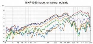

I'm also on an active 4-way system, with sealed subs below 65Hz, 18" baffleless midbasses on a swing up to 275Hz (I agree the swing does not transmit vibrations to the holding structure), lately twin 8" in OB MTM up to 1600Hz, and a Beyma TPL-150H with open back and a DIY waveguide to achieve dipole pattern (which works well up to about 7kHz).
It's still a prototype in development. Earlier I had the naked 18" going up to 400Hz because a single naked 8" (also on a swing) didn't like going lower. Folks with a lot more experience on OB recommended bringing the 18" xo lower (a naked 18" dipole peak is at 350Hz) and I added a baffle for mids and a 2nd 8" and in fact added wings around the lower 8" (plan is to make it a 0.5 config with an inductor in between). This allowed me to limit the 18" to 275Hz, which I find sounds much better.
You might want to consider testing a woofer in between your 15" and the existing midrange? The naked 15" dipole peak is likely lower than where your xo is at, and the 15" is probably "heavy" at those frequencies. Maybe a passive xo between Neo 6 and 3, and use the channel/amp for a smaller woofer?
BTW, I guess the steel frame implies the validation that magnetic fields of the drivers aren't affected by it. I remember years ago on Audiogon having discussions about whether steel bolts holding drivers to the box impacted sonics. I've been using wood for my frames, but maybe I should consider steel.
