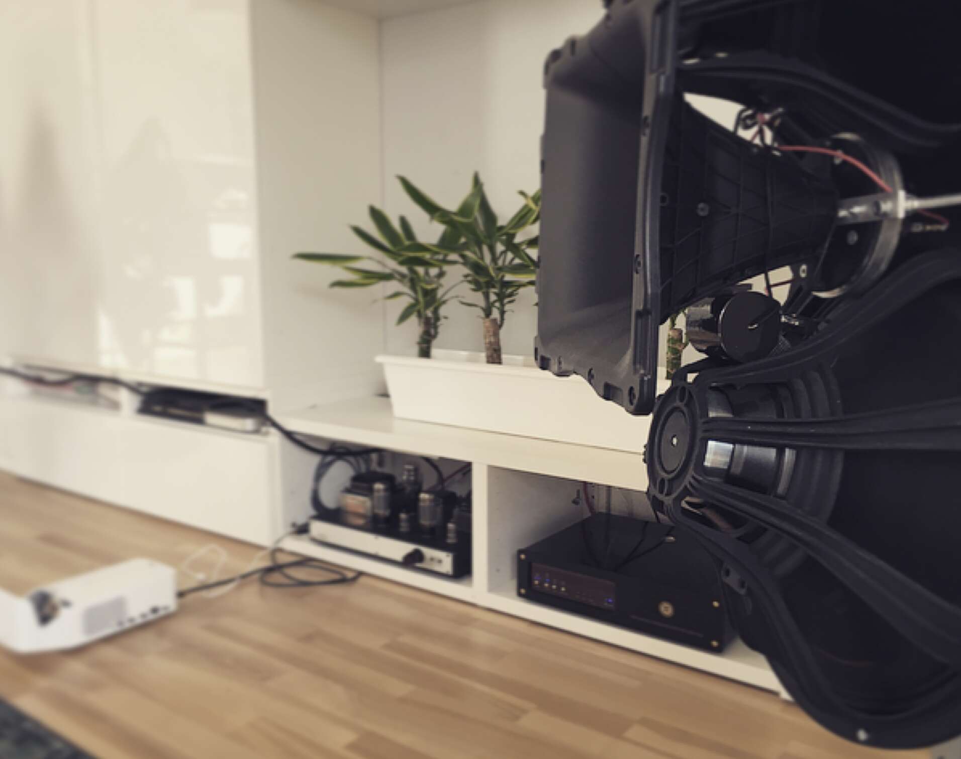

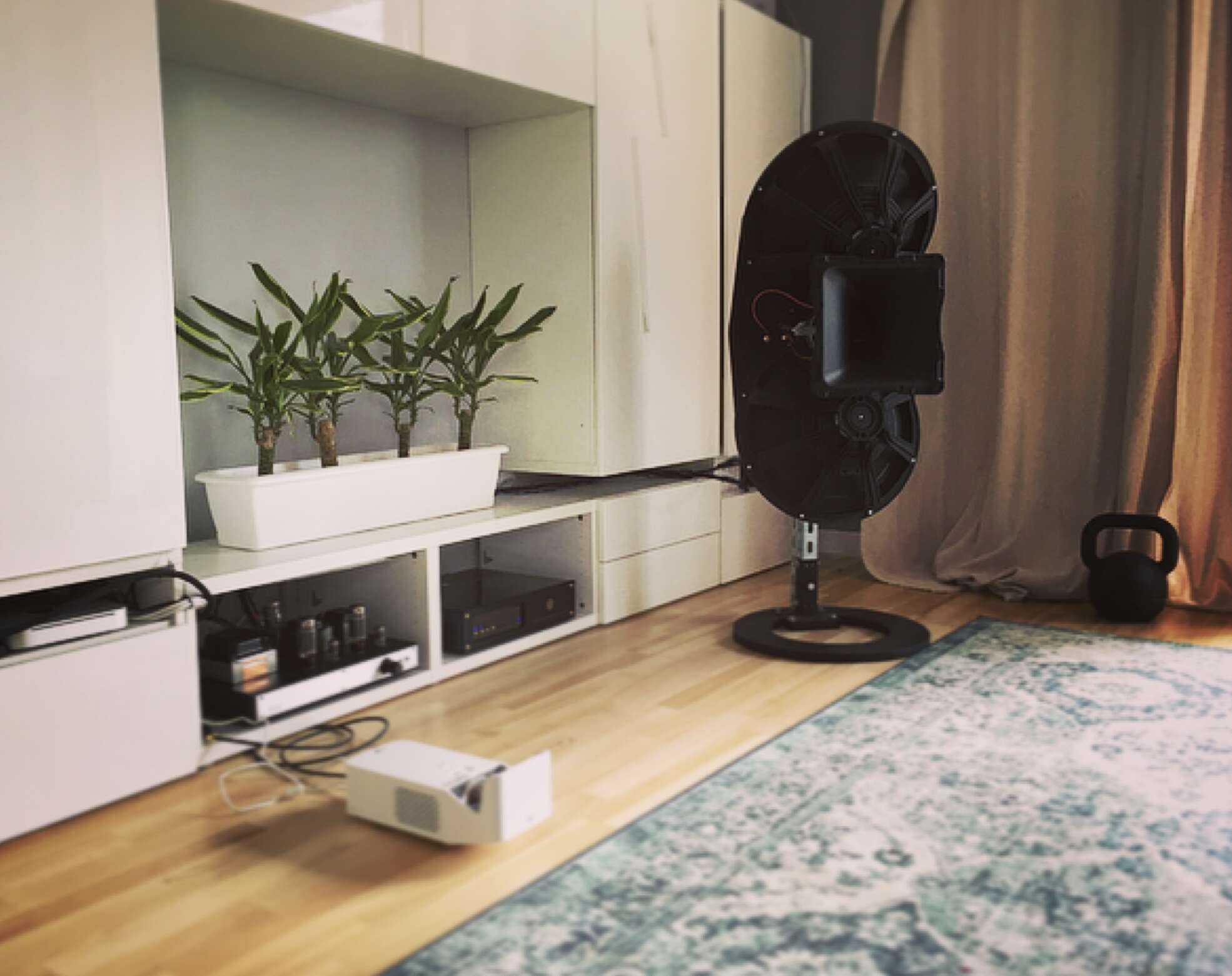

I call them TIE Brute, they look like heavy starfighter from Starwars 🙂
TIE Brute: open-baffle + driver in CD horn

I use my wife to see if I'm doing everything right in common. She was impressed by several systems at Munich and Warsaw exhibitions, and wants to hear the same at home. I'm getting close! 🙄 As she says 🙂
My TIE fighters a special, and they attack, so \|/ 😀
~ 800 and 35 now.

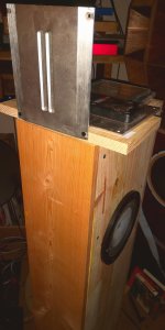

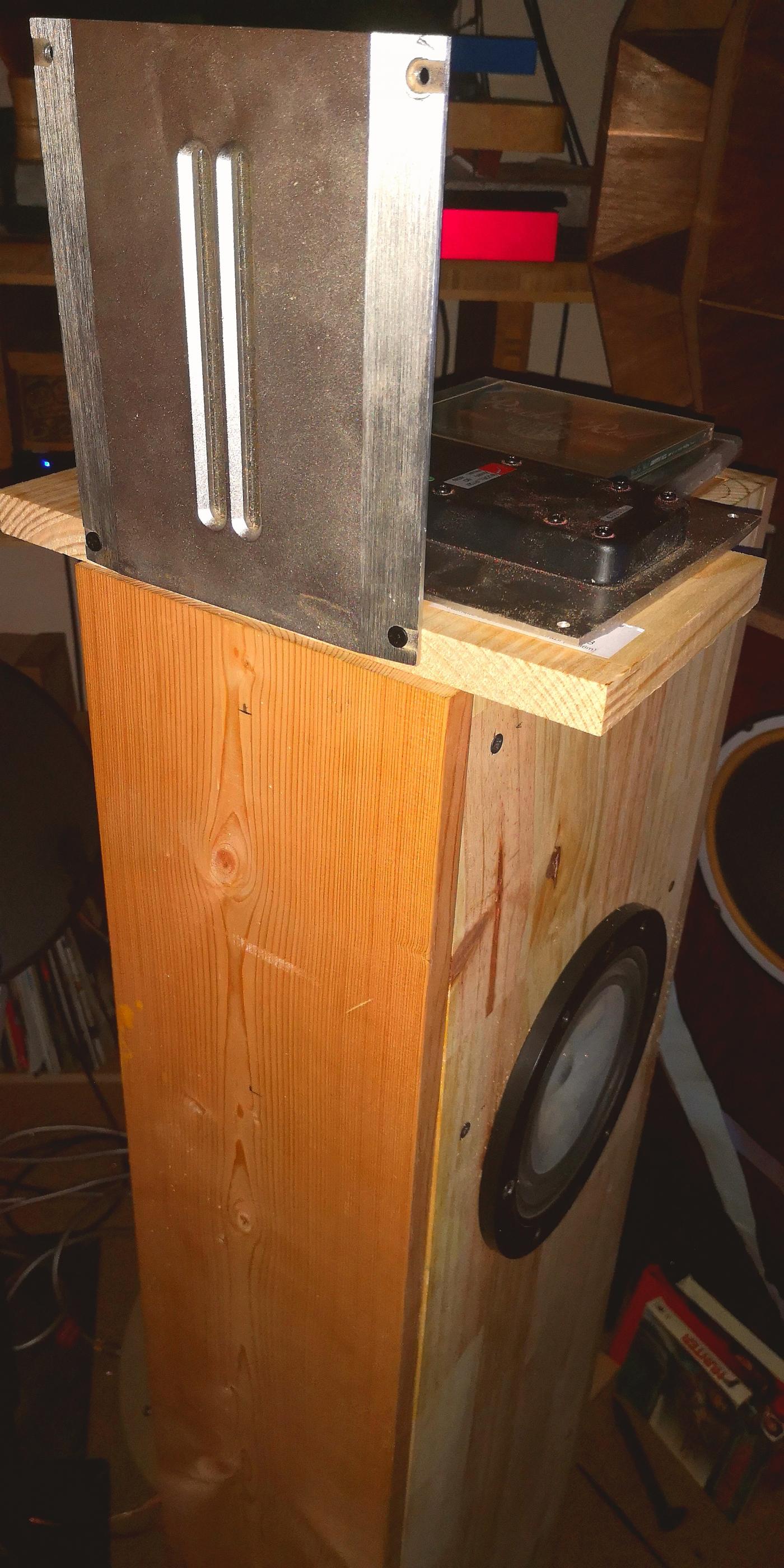

I've been enjoying my open baffles for some time now, paired with monopole horns.
I wanted to try something very small in comparison, and have gone with each sealed floorstanders using sidefiring MarkAudio 12P and 12PW in dipole use. Better bass from a sealed cabinet, using room reflections to fill it, along with a tweeter aimed at the listener from the null, using a very high knee and a shallow slope to provide location cues.
It's daft, but it works. Decent bass and no noticeable cabinet resonances, even before internal damping.
It becomes very impressive when crossed to a single sealed sub.
I like your ideas here too. It's fun to go outside the norm. This is the first time I took advantage of room reflections instead of trying to treat them or mostly work around them. My only concession is using a tall planar tweeter to limit vertical directivity, which in this case I like better than dome domed and a ring radiator tried in this experiment.
It's not open baffle, but is conceived from wondering how to make my dipole pair better.

Thanks. Still trying out tweeters so none installed as yet on on this roughed out try . No crossover on the fullrangers which are wired with the 3db more efficient 12P pair facing each other. Nearly all sound is from room reflections, with treble assisted I guess from some diffraction from not flush mounting the thick driver flanges . The treble and localization is assisted by the 20000 hertz Butterworth 1st order slope on the tweeters, basically all there at 20000, where the maximum help is needed, and fading to no treble at the bottom of its range.
No measurements, but it is at the least equal to my open baffles in sound quality, subjectively.
I added a sealed sub yesterday, using an active EQ crossing 4th order at 120 hertz, and rolled the plate amplifier for the sub off at about 80 hertz, also 4th order.
Edit: it's a thus far undamped 1.73ft3 sealed cabinet, lightly braced.
