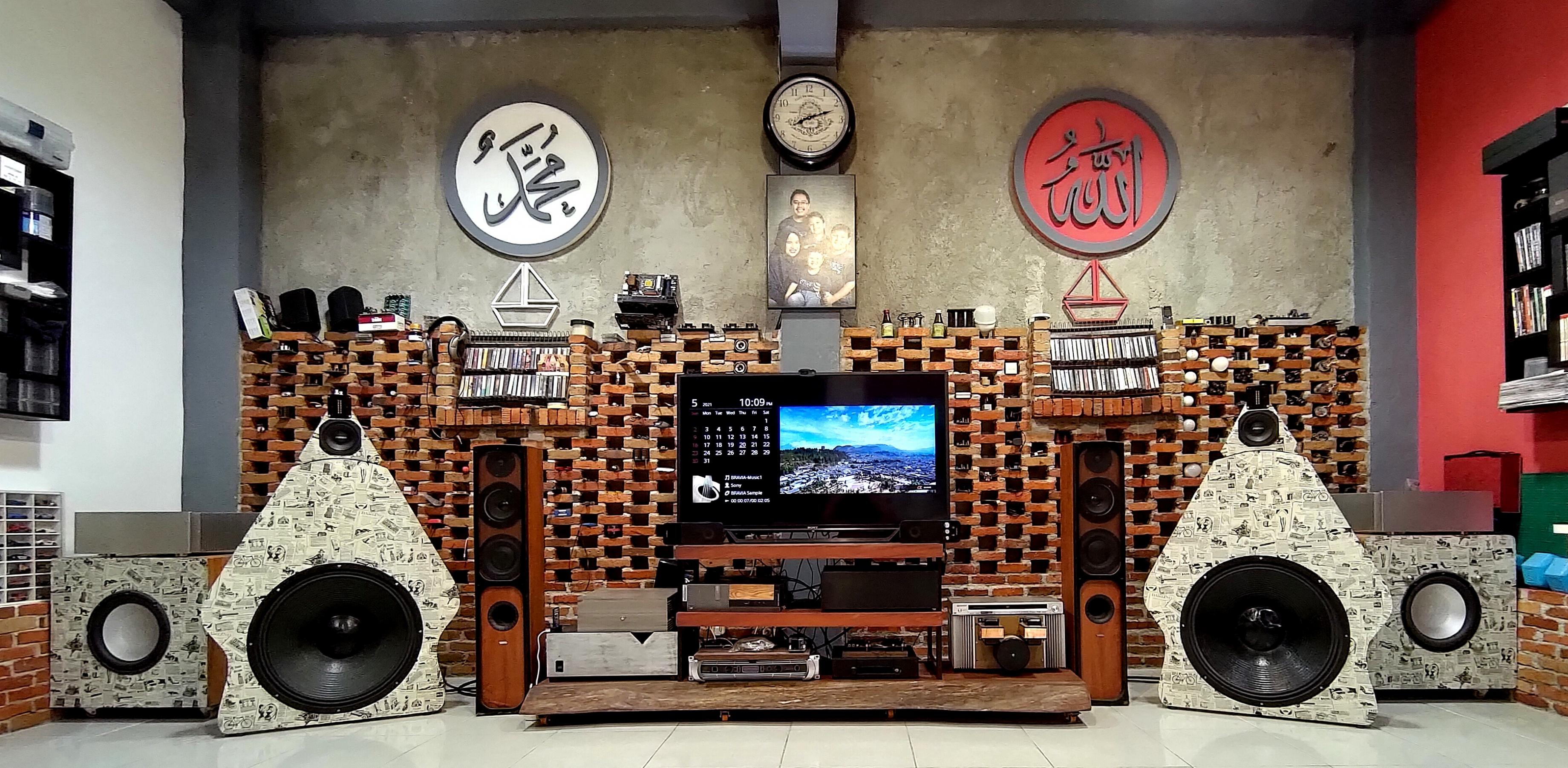

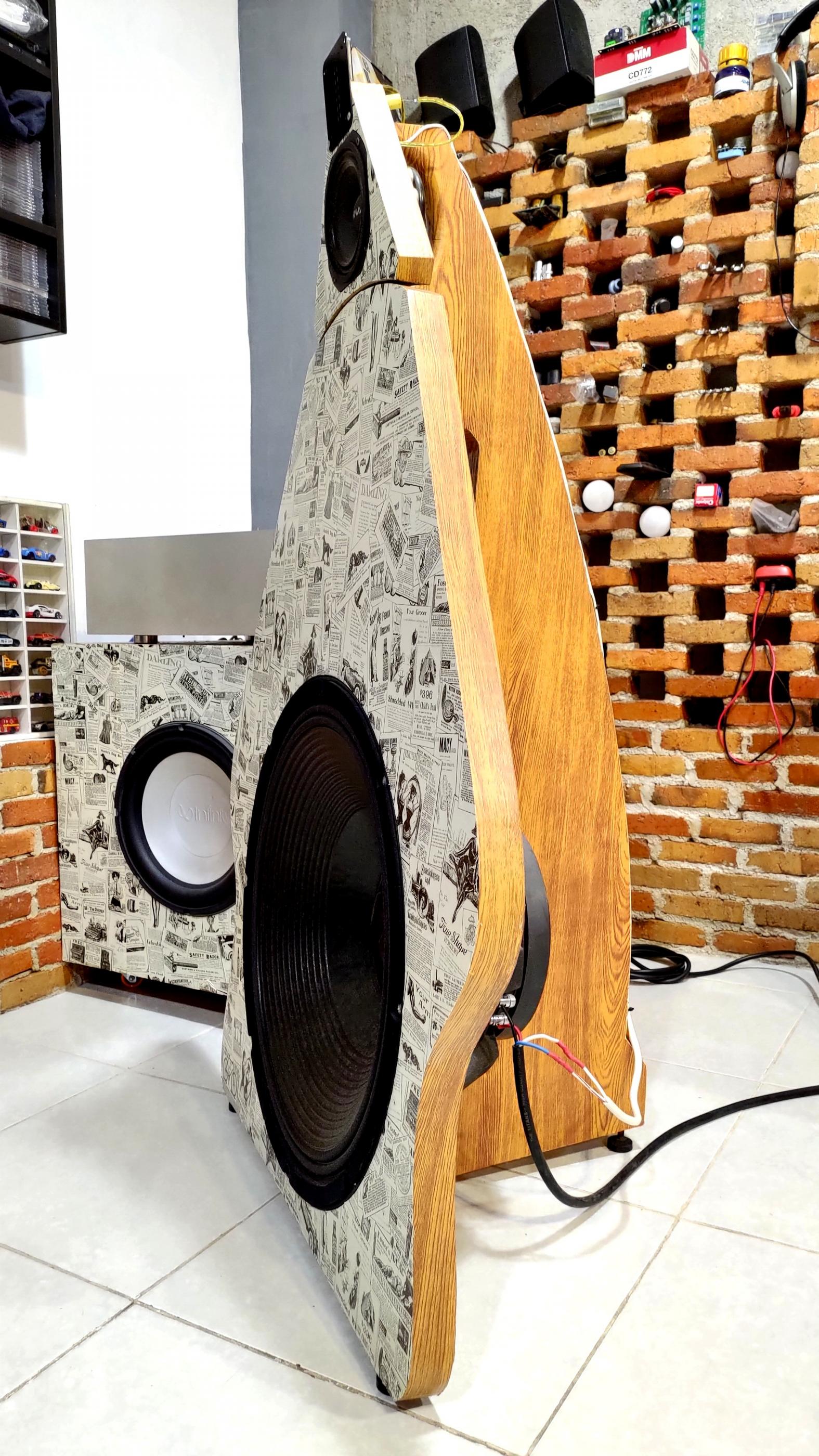

my 2way OB with ribbon helper, hopefully this is the final iteration. use harsch xo @240Hz
source : dell optiplex playing loseless with foobar2000 or deezer hifi, vlc player for bluray collection
- AD1865 dac with dcb1 preamp
- minidsp 2x4HD to : aragon2004 for 21" woofer and mauropenasa gainclone drives PRV 5mr450-ndy + beston rt002 ribbon tweeter with 3.3uf filter
- behringer nu3000dsp get mono signal from summing opamp after dcb1, then drives 2 dual-opposed sealed subwoofer 4th order @40Hz
in my relatively big room 5x6m with 3.3m concrete ceiling, eventhough my 21" subwoofer have 7mm xmax, it still can't fill the room especially for deep bass. that's where the subwoofer really help, it's mandatory during bluray movie
OB woofer + multiple sealed subwoofer :
my wide lens phone is not good enough, bad vignette can be noticed easily

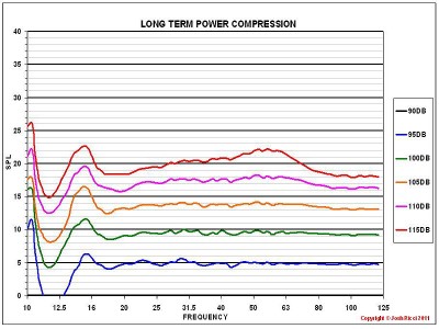

Some OB dynamic consideration(s)
If an OB – cardioid system has sufficient displacement, you can equal, and in some cases exceed dynamics of nearly all box systems with the possible exception of quality very large horn loaded designs.
Where many OB’s get in dynamic trouble below 70 Hz or so is usually due to not enough cone area and Xmax. (VD - Total Volume Displacement)
A pair of 18” woofers on a 24” wide baffle with an effective wing depth of 12”, assuming an xmax of 10 mm or more peak, is a bit more than a single 15” with the same xmax in a correctly designed B4 enclosure. This is a rough comparison, but close enough.
I am assuming either system has an in room F3 around 30 – 34 Hz with correct crossover. If you run the displacement numbers, the twin 18’s provide VD of 2,400 CC. A single 15” will be around 875 CC. My rule of thumb is an OB requires around 2.4 to 2.6 times the VD compared to a correctly designed ported enclosure to equal or exceed the ported enclosure in terms of dynamics and net output. Cardioid systems will fair better and can have a 1.75 to 2.25 times yield requirement. Again, this is a general value based on many years of experimentation. YMMV!
OB cancellation loses are what we are dealing with. And ported enclosures are notorious interacting with room nodes providing added slam at certain frequencies. Take both outside and the box slam usually goes away and or is greatly attenuated.
So, it gets back to the OB has to be large to compete dynamics wise. But on an equal footing it can compete without the non- linear (room – boom box) penalties.
