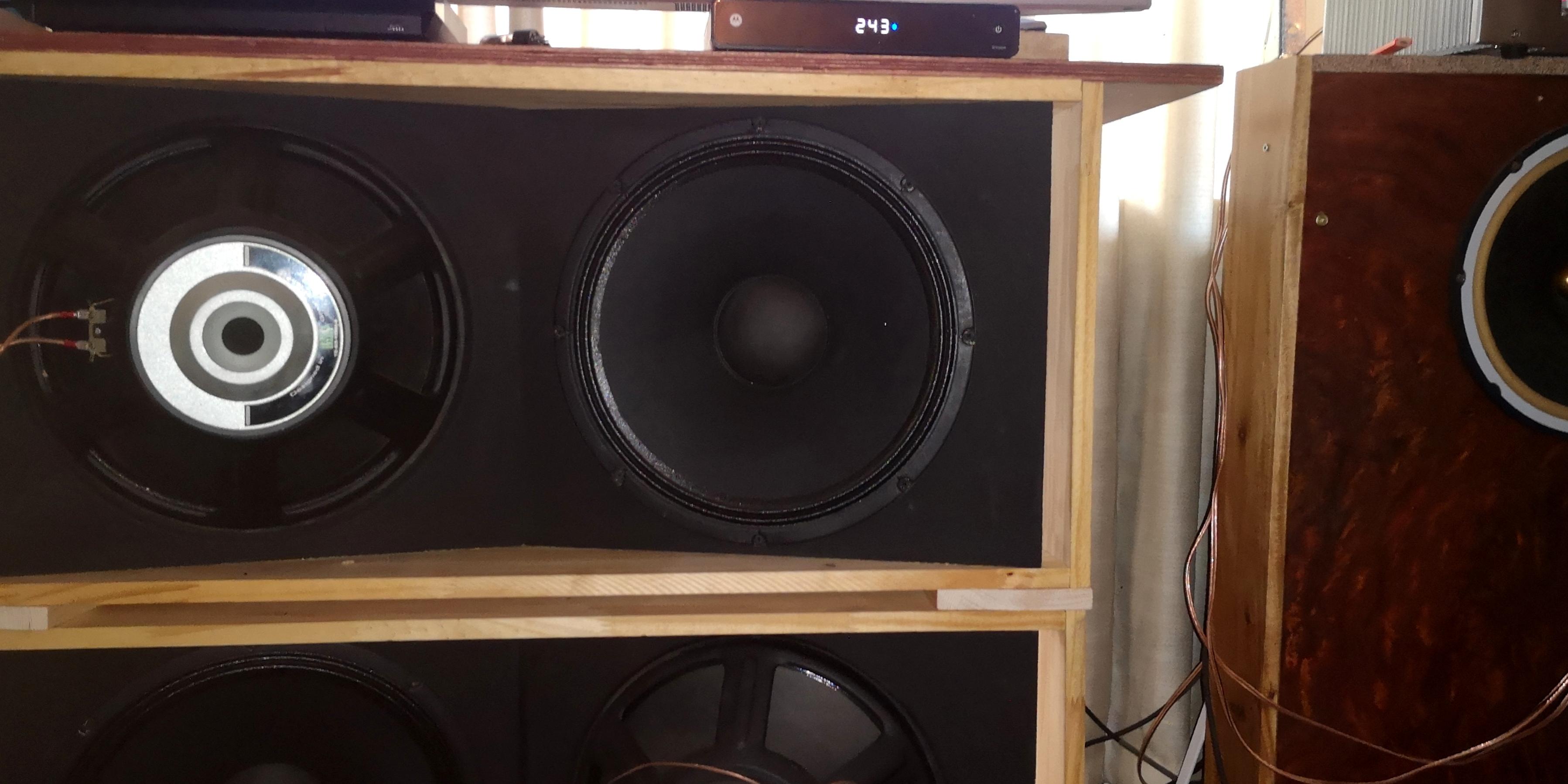

After almost a year, I finished this open baffle project with AE and Beyma speakers. Now comes the hardest part for me, the crossover settings. I don't have much experience (practically zero), but ...I hope to be able to get a good result.
I wanted to get some advice, please. If I still have an OCTO DAC8 PRO with 8 channels, it would be an advantage if a Dipole 15 bass speaker (two 16R coil) would go up to about 80 Hz, and another Dipole 15 (two 16 R coil) would go from at 80 Htz to 250 Htz?
That is to make a separation for 4 bands:
80 Htz
80--250 Htz
250--2500 Htz
2500 --20000 Htz
Or is it better to use both speakers in parallel for frequencies up to 250 Htz?
Thank you very much for your help🙂

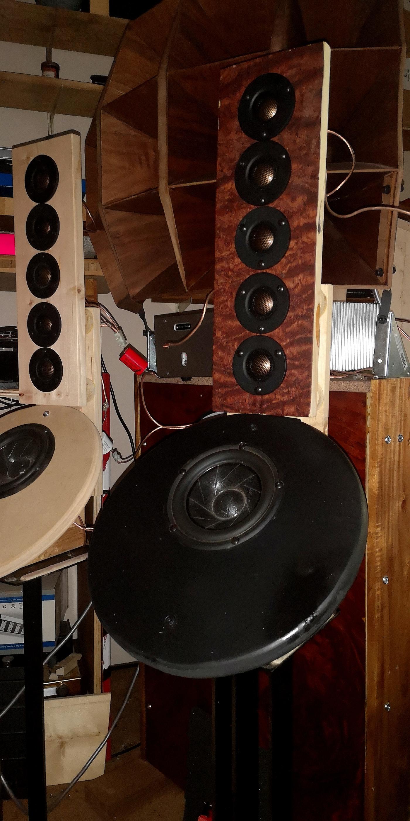

I do love the horn-dipole hybrids I built some time ago, but now wanted something smaller and different.
Despite appearances, these are not regular line arrays in practice. They are MMTMM arrays, a single tweeter passively highpassed at 3000 hertz,- 6db, to two pair of tweeters passively lowpassed at -3db to the tweeter, also first order. The woofers paired with these are 4th order band passed at 900 hertz and 120 hertz.
The two W Frames are 4th order lowpassed at 120 hertz, with some slight adjustment to 90 hertz on the plated amplifier powering them, to compensate for the semi enclosed resonances.
It's vastly improved in playback compared to the box subs for these, and the extra reflections allowed through by the small woofer baffles is a treat. The longer height of the upper mid-treble baffle supports and manages the frequencies as a few mock ups indicated, and the array allows wide horizontal dispersion, while limiting ceiling and floor reflections.
The crossover points chosen eliminate interdriver comb filtering, except for the transition between the one true tweeter, and the ones used as upper mids. Not sure how to get less than a three inch centre to centre spacing for this, and still match the dispersion requirements I was after.
It works better than I'd hoped. Sweet smooth sound at all listening positions in the room, while the angled baffle limits front wall reflections without eliminating them.
The centre fill of the open backed bass non cabinets seems perfect for me.

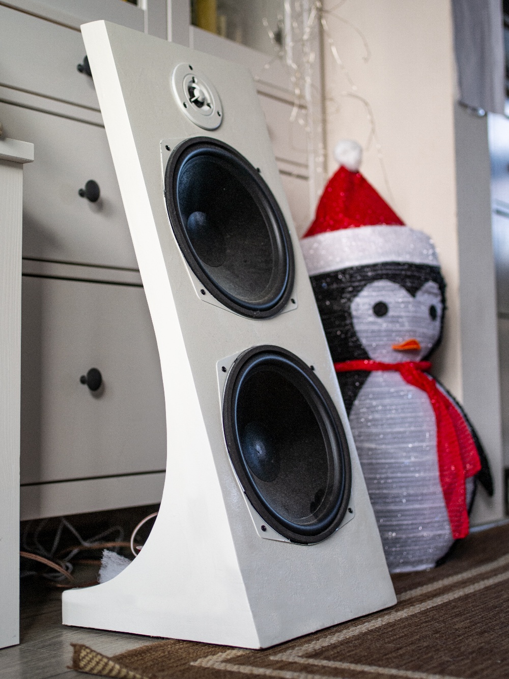

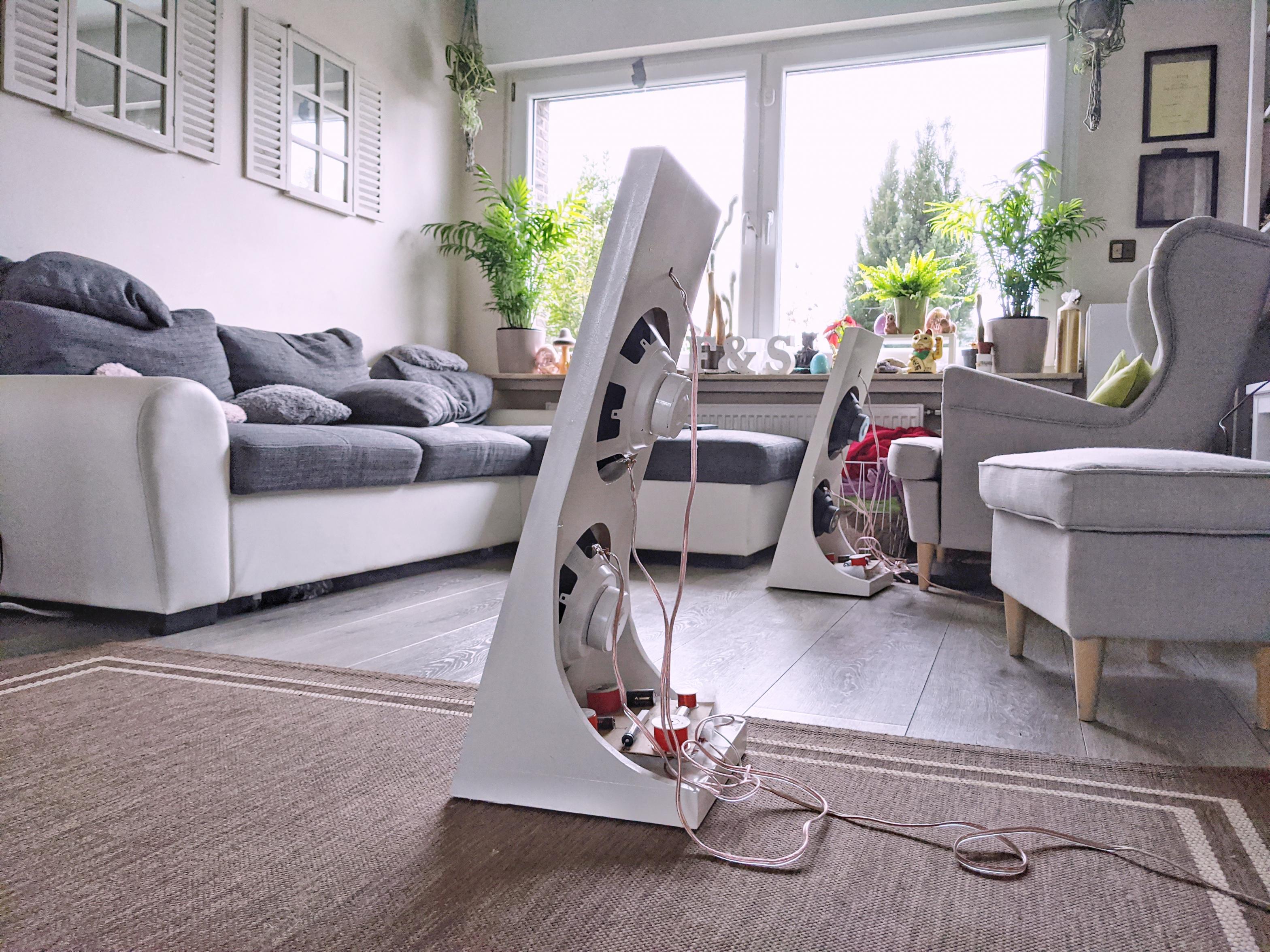

Hey there, I'm new to the forum and the first topic I searched for was open baffle. I just love open baffle speakers, especially when it comes to bass and mid rang. I'd love to share my latest speakers with you. Currently, I configured them as a passive 2.5-way system (2nd crossover prototype). Response wise they look pretty ok and sound wise they perform more than satisfying. Soundstage is just awesome. However, I'll do at least one more crossover iteration to optimize the respone. Cable management and crossover placement is still in test bench phase.
PS: I hope I got this thread right and posted appropriately.

simple and beautiful, congrats!
and more details about the units used? have you measured or calculated impedance and sensitivity?
I'll post an old response curve when I'm back on my laptop. Currently I have some problems with REW under Linux. I can't get the output to work. I'd like to present a more controlled response, impedance, and waterfall plot here.
For the build I used two Visaton WS 25 E woofers and a Visaton DT 94 tweeter. Both woofer play from bottem up, one rolls off at about 100 Hz, the other one crosses over wirh the tweeter. There is a small gap at the crossover point since the tweeter doesn't reach that low. Subjectively, I like this coloration, however, I'll swap the tweeter sooner or later. As I said, it's not that noticable and I'd rather have a dip at this frequency than a unpleasant peak. Personal preferences.
The current crossover layout is rather simple. The bass filling woofer rolls off with a 2nd order low pass, the broader range woofer rolls off steaper with a 3rd order low pass and a notch filter to grount to handle a hump at higher frequencies (I guess, it's due to the cone properties of the woofer), and the tweeter is brought in with a simple first order high pass and is brought down bit with a resistor.
