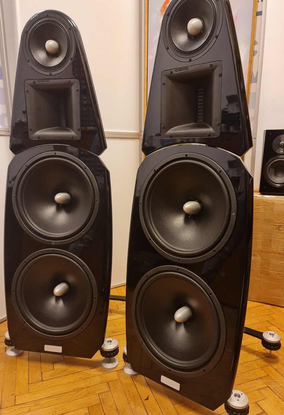

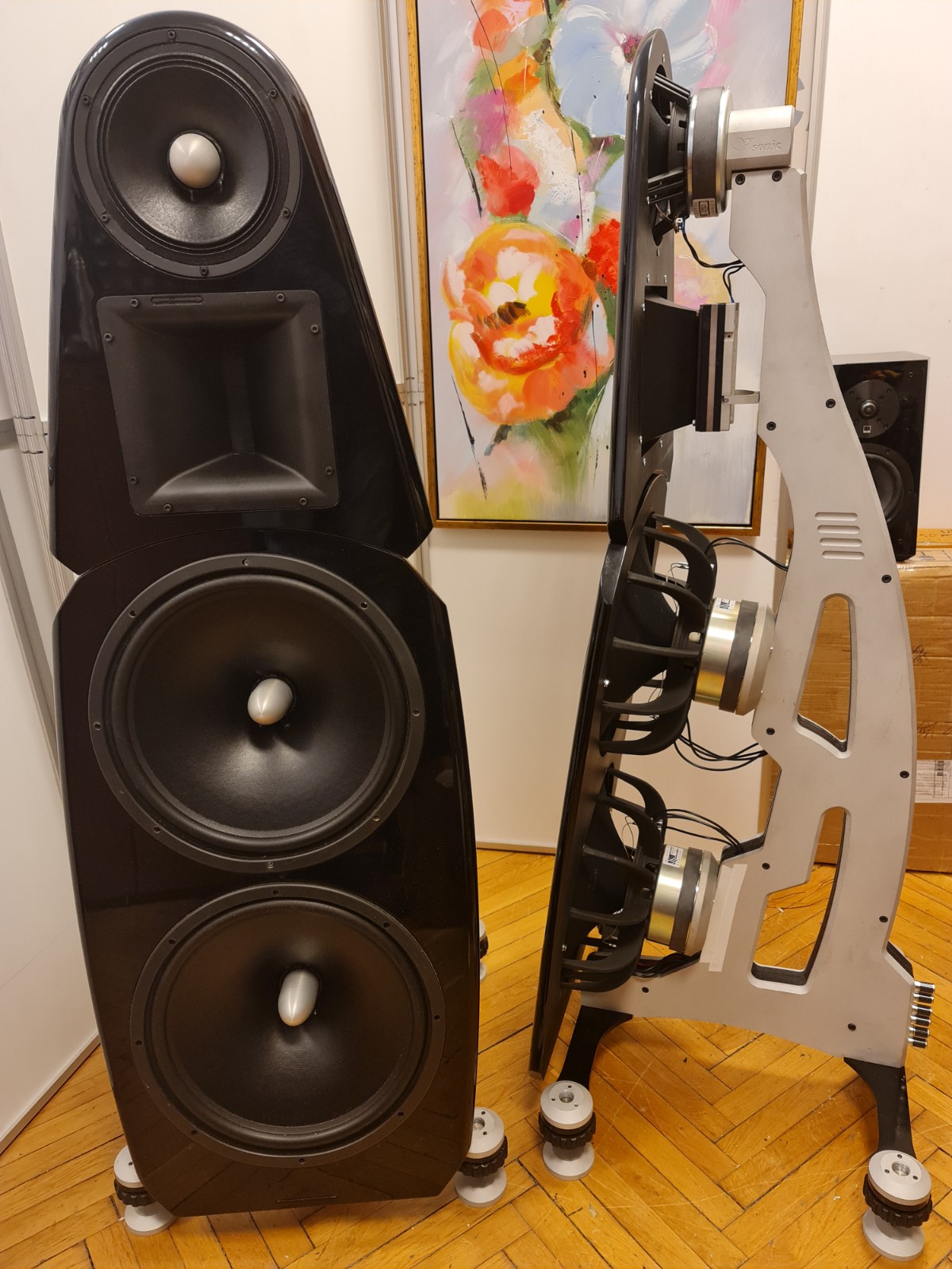

After almost a year, I finished this open baffle project with AE and Beyma speakers. Now comes the hardest part for me, the crossover settings. I don't have much experience (practically zero), but ...I hope to be able to get a good result.
I wanted to get some advice, please. If I still have an OCTO DAC8 PRO with 8 channels, it would be an advantage if a Dipole 15 bass speaker (two 16R coil) would go up to about 80 Hz, and another Dipole 15 (two 16 R coil) would go from at 80 Htz to 250 Htz?
That is to make a separation for 4 bands:
80 Htz
80--250 Htz
250--2500 Htz
2500 --20000 Htz
Or is it better to use both speakers in parallel for frequencies up to 250 Htz?
Thank you very much for your help🙂

There’s another option. I have plans for a hybrid OB / horns speaker and I’m going to use 4 x AE12 Dipoles per side. My plan is to use 2 from 20hz to 600hz and the other 2 just up to 100hz to compensate for the low frequency roll off. Perhaps you could try a similar approach?
If you have the power amps, I would try 4 way. One driver can easily cover the 80-250Hz, so leave the lowest to play the 80Hz only. I did not do the math, but you will get less interference (comb filtering) around the 250Hz region. If one can hear it, don't know 🙂
As written by Baffless, do indeed use both to play below 80Hz, and only to play until 250Hz.
Very nice looking ! Congratulations. You don't have luxury to use only one driver below 80Hz for dipole. So you have to use both. But that doesn't mean you have to go 3way. If you have spare amp you can do like this.

Anyway use both below 80hz !!

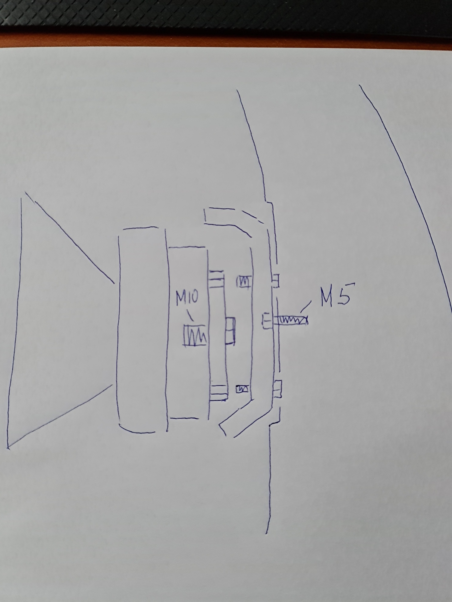

^ Beautiful result! How have you attached the driver magnets to the frame?
I would use the 15s in parallel – it also means one less stereo amp.

Dipole 15 magnets have an M10 thread in the middle.
To this thread I fixed a round metal plate, which has four M4 threads on the side.
The "plate" that holds the magnet is attached to the frame with a screw in the middle of the M5.
There are four holes in it on the side, through which I screw the M4 screws into the round metal plate.
For me the number of amplifiers would not be a problem, I have enough 🙂

Thanks a lot for the appreciation 🙂
My english is not perfect, but I reread your message several times and now I hope I understood, I don't have to go with 20 (theoretically) - 80 Htz and 80--250 Htz, but with 20-80 Htz if 20-250 Htz. Correct ?
My english also not perfect🙂 Yes you understood correct. Whatever way you choose, make sure both drivers moves air below 80hz. You need lots of volume moved. Your baffle is not wide, path difference small.
