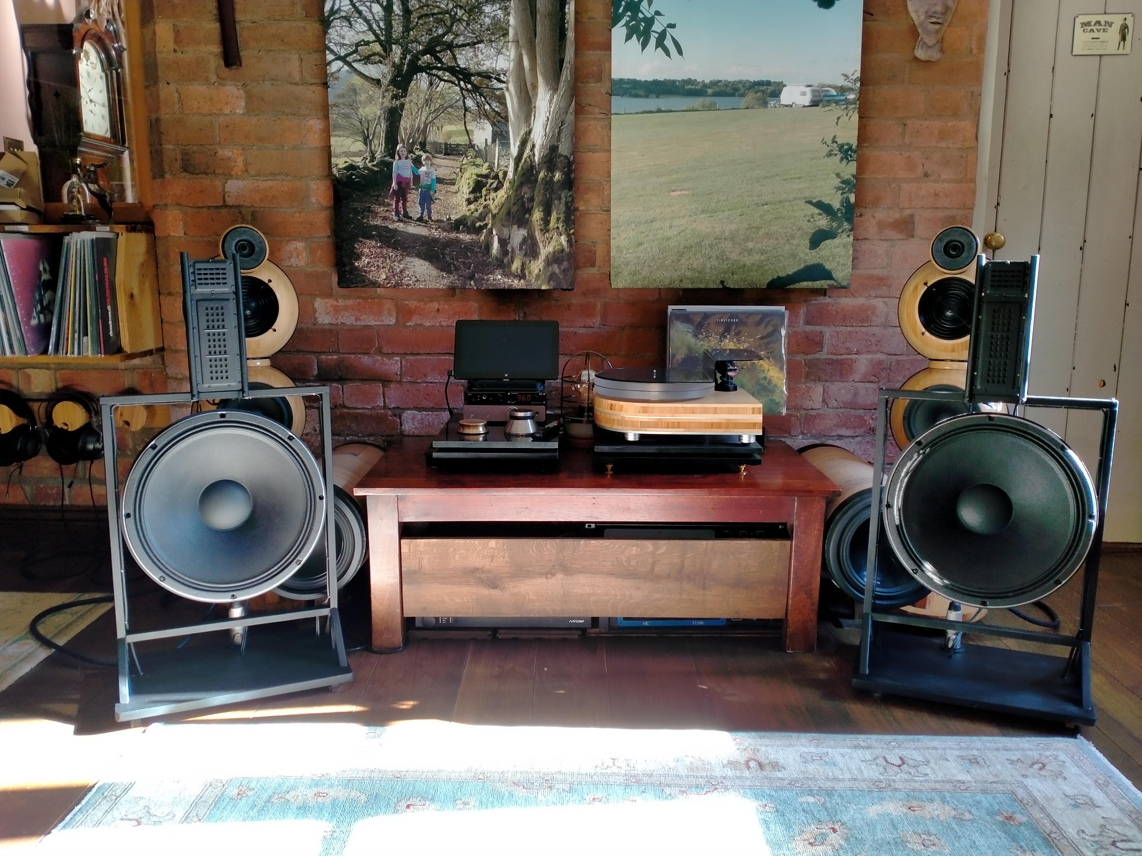

Celestion TF1225CX and Eminence Delta 15LFA. Hybrid XO with MiniDSP 2x4HD between bass and coaxial. Coaxial mid/CD xo is passive. Bass to mid xo at 200Hz LR2.

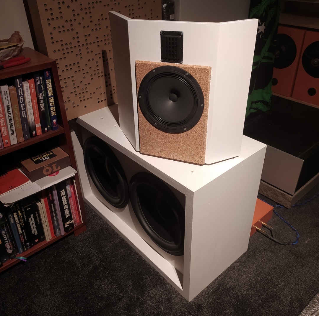

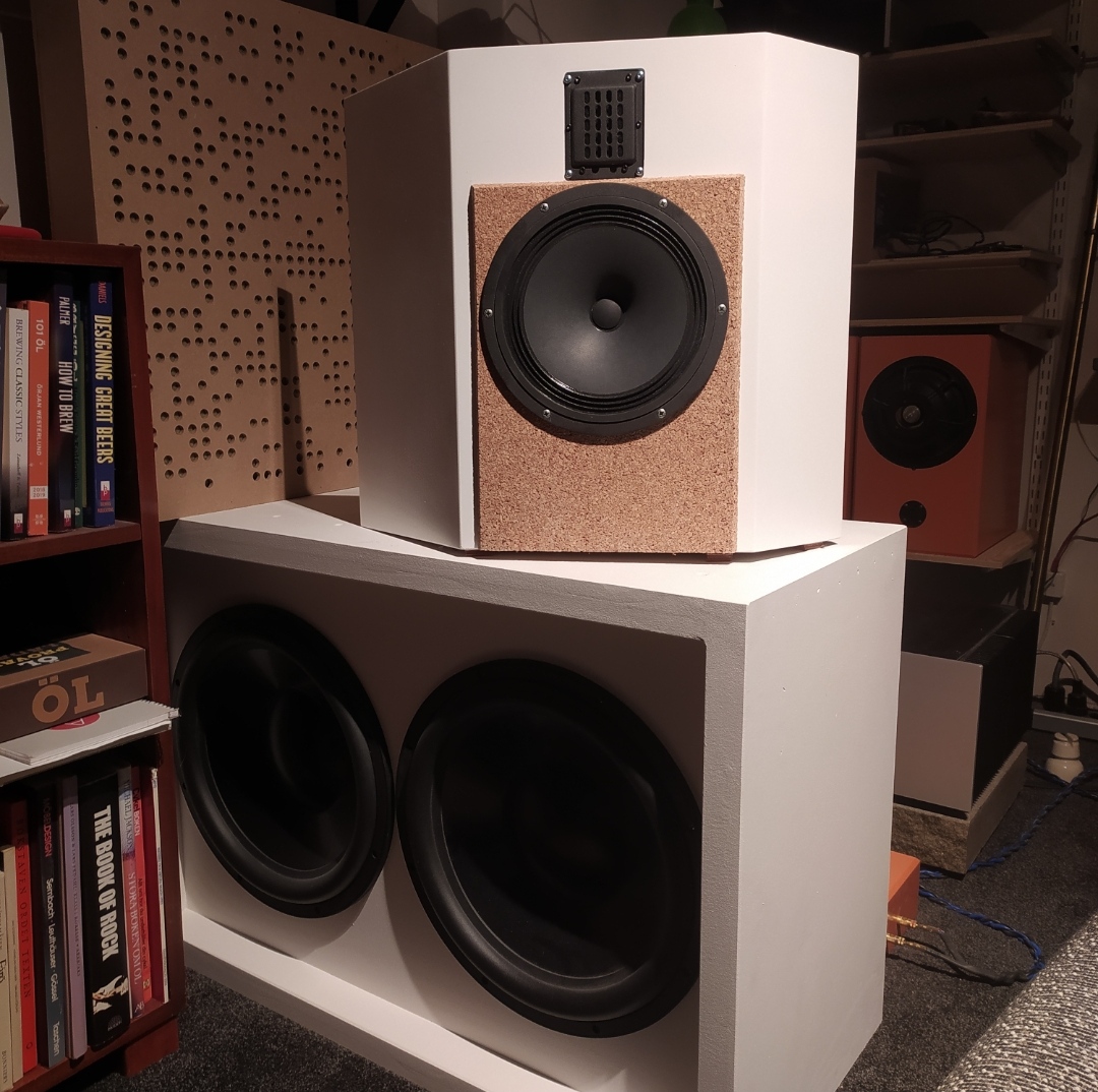

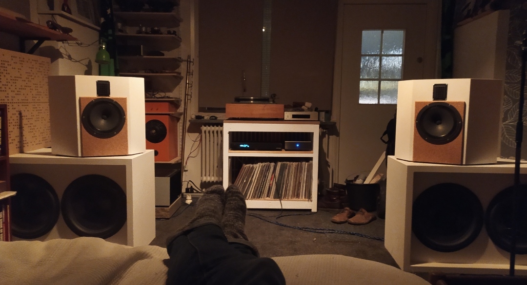

My latest
Maybe it's time to post something for once. Here's my latest iteration of my speakers.
All open baffles/dipoles.
Tweeters: GRS PT2522-4,
Mids: Visaton B200
Woofers: 2x Dayton Audio RSS390HF-4
Tweeters and mids are crossed passively
Subs actively using miniDSP SHD.
All are, or just the subs are DSPed using Dirac although the top/mids work really fine on their own as well. They go surprisingly low. I wouldn't miss the subs too much if I didn't have them in a small room like mine. With that said, using the subs, they go really low when asked, without almost moving a millimeter.

I had a pair of B200 that used a pair of Dave's phase plugs. Never heard them without, but they definitely worked great and never even bothered to try them with a tweeter. Using 18" Hframes for bass, I was able to go stupid loud and they kept their composure. I miss those lil fellas and would rather have those than what I replaced them with.
Even had em ductsealed and everything. Dunno if they needed or benefitted, but the plugs worked so well, I tried more of Dave's tricks
Where's the beef? The meat and potatoes is that Phase Plugs are a no brainer. Just do it. It's what's for dinner.
Phase plugs in those B200s, you might well be able to lose the tweeter (and the XO).
I look at stiock B200s and think about how much better they can be.
dave
Yes, I've been looking at your site and have been thinking about it. Just adding the phaseplugs won't give the backwards high frequencies, I think mine actually does good, not only forwards and compensating the b200s stock spectrum.
@Planet10. How much is the postage for Sweden? I don't have a lathe
Yes. The 2x15" woofers doesn't even need dipole compensation to go in the singel digits without falling of (thanks to room gain and placing the woofers without airgap between the subs and the floor).
I didn't get any phaseplugs due to not having any lathe and Dave being on the opposite side of the world).
But as I wrote in the previous post. Just having phaseplugs won't solve dipole in the highs.
Dipole highs are tricky. I've never found the juice worth the squeeze yet. How do you like those GRS tweeters? They make a few interesting ones!
