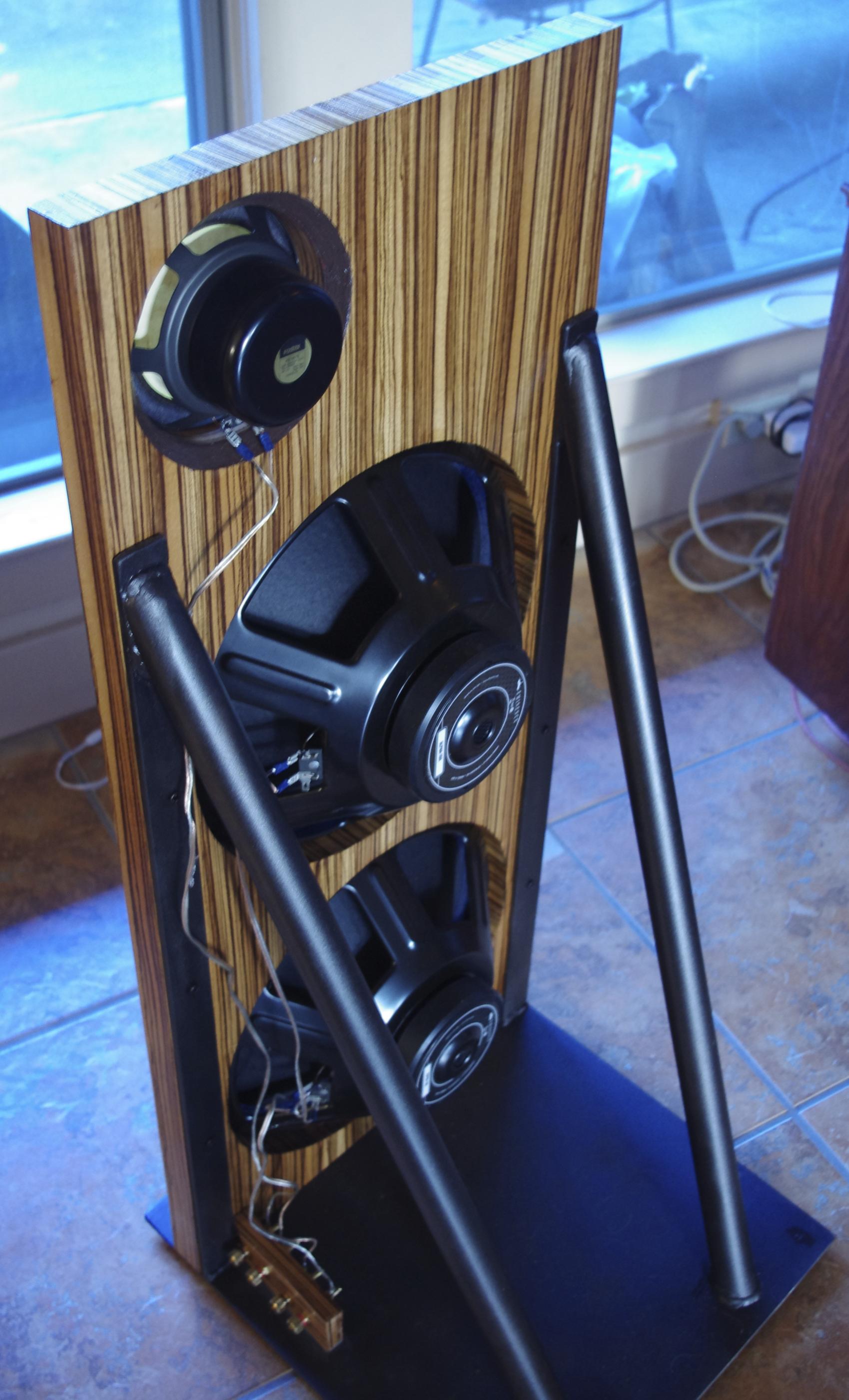

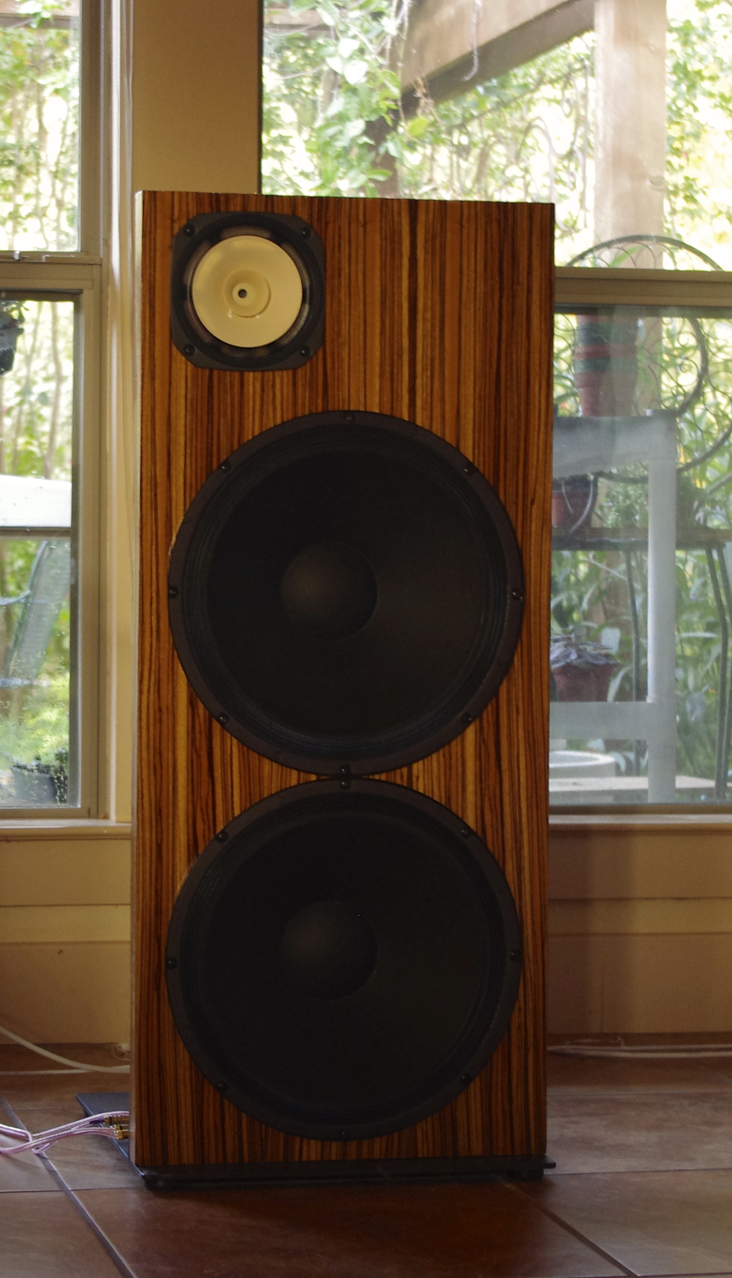

My build of an MJK OB design with a Fostex FE167E and 2 Eminence Alpha 15a per side. 1.5" oak ply with Zebrawood veneer for baffles, found a man in town to custom build a base with ¼” steel plate and ½” pipe bracing to hold baffles, then painted with Rustoleum spray.
Each baffle started at 20”X40” per spec but knocked one off the workbench and had to trim to 17.5". Using an Onkyo TX-SR805 for preamp, DBX223 for active crossover and Adcom GFA-2535 to run bass and highs.

Love the veneer! Gotta use me some Zebrawood some day. Thanks for sharing.
Greg
It's very pretty. 🙂
..I did spot a problem with the design though. 😱
It's very pretty. 🙂
He forgot the rest of the box?🙄
There is a "tunnel" behind the fostex. It should be chamfered
Yup! 🙂
Maybe a felt or foam lining inside the tunnel would reduce the standing wave and edge diffraction.
There is not enuff room to get a thick enuff chunk of either to be effective.
