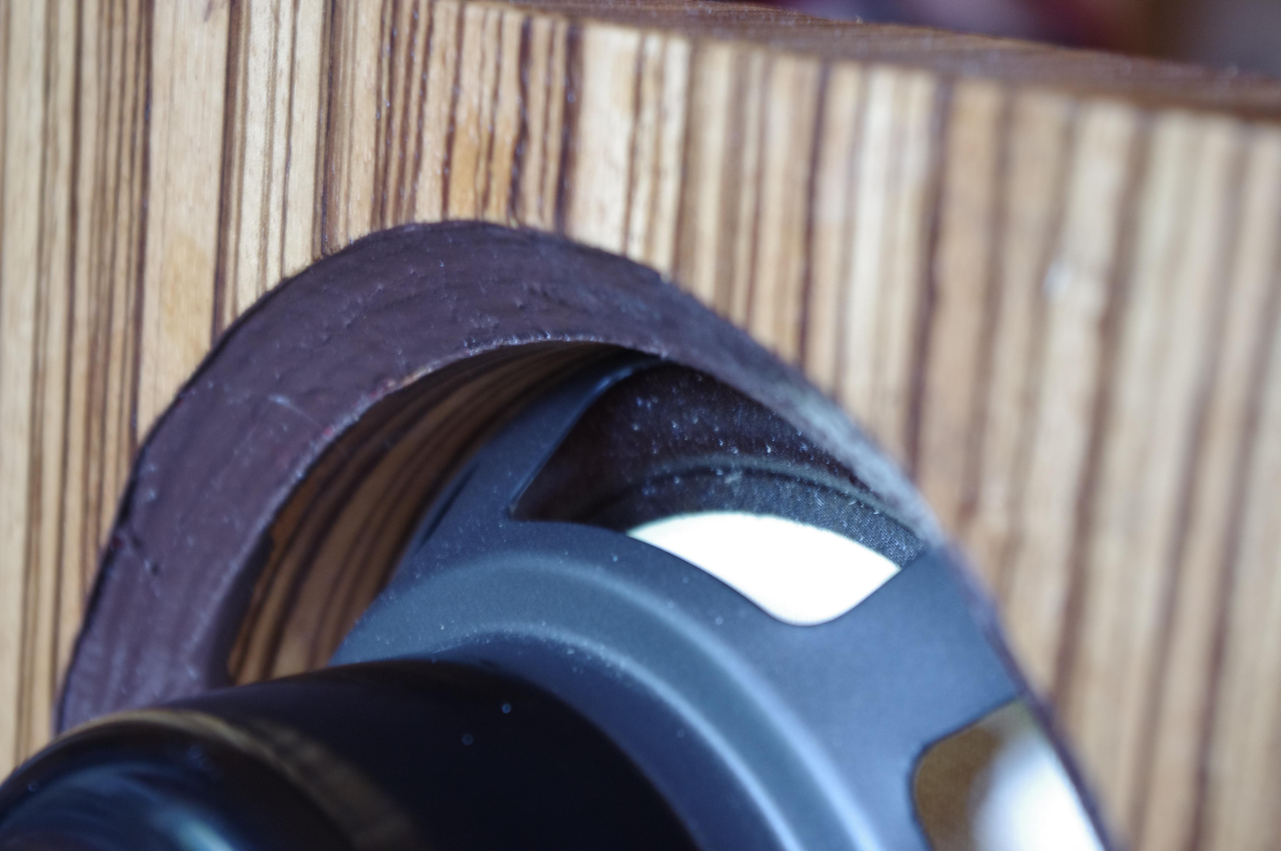

Actually I did chamfer..... but maybe not enough??
I painted that part brown because I couldn't figure out how to veneer that angle. Do I need to go deeper and/or wider? That is 2 pieces 3/4" ply glued together.

Ideally the champher starts where the basket opens up.
dave
Yes, exactly.
This is a good thing to know, especially with low mass full-range drivers where the resulting resonance can seriously disturb both the linear behavior of the driver, and its non-linear behavior (..and always in a negative fashion). Even most woofers should have this feature, but particularly full-range drivers and mids or dipole planar tweeters.
Sometimes the best method is a "lay-up" of 1/4 panels rather than one thick board so you can move the next successive layer of 1/4" board an inch or more away from the driver - increasing the opening (..and continue the "expansion" from there). Then you can use a router to angle those edges of each board. (..visually sort of an inversion of a Mayan Pyramid's "steps" with the rear opening getting wider and wider.)
It's probably fine as is. You chamfered. These guys will have you going for years with suggestions and opinions.
Hmm, having done this sort of thing with my FE166 ES-R's - the measurements were NOT in favor of even a *good* chamfer, it needed to be excellent to avoid problems.

Yes, but I notice Zaph only mentions chamfering on sub 4" drivers with large, obstructive magnets being used as woofers. He claims the airflow restriction causes problems (presumably in the bass where the airflow is the greatest).
The Fostex is being used here as a midrange and isn't venting right into the wall of the cutout like the little ScanSpeak does.
I know we are splitting hairs here, but I think there is less to be gained than you might think.
Then you would be wrong. 😉
The dominate resonance (created by the cavity) is above 1 kHz for even the 8" fostex - though it effects linear movement throughout all of its bandwidth. (..it makes the drivers VC move from side-to-side increasing non-linear distortion broad-band. In the case of the fostex drivers, the centering provided by the surround is extremely weak - and not good under the very best conditions, but made substantially worse with near-cavity resonance "jostling" the driver.)
