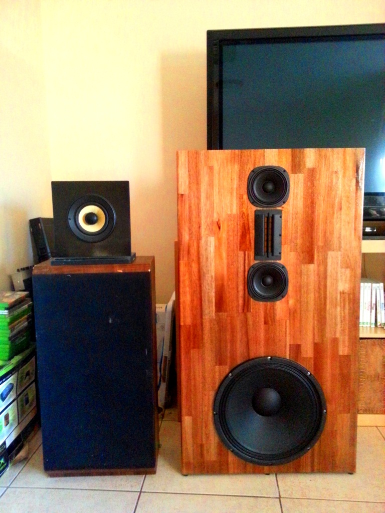

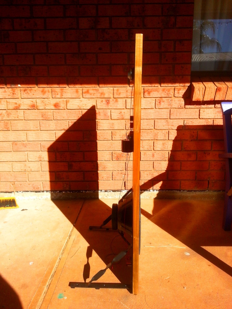

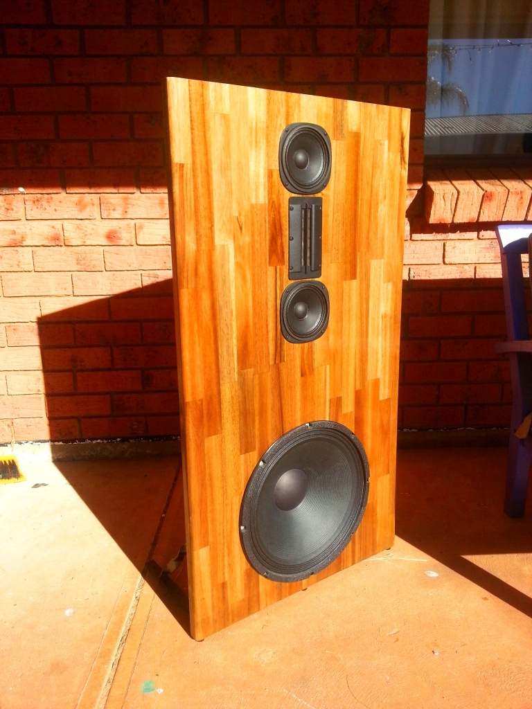

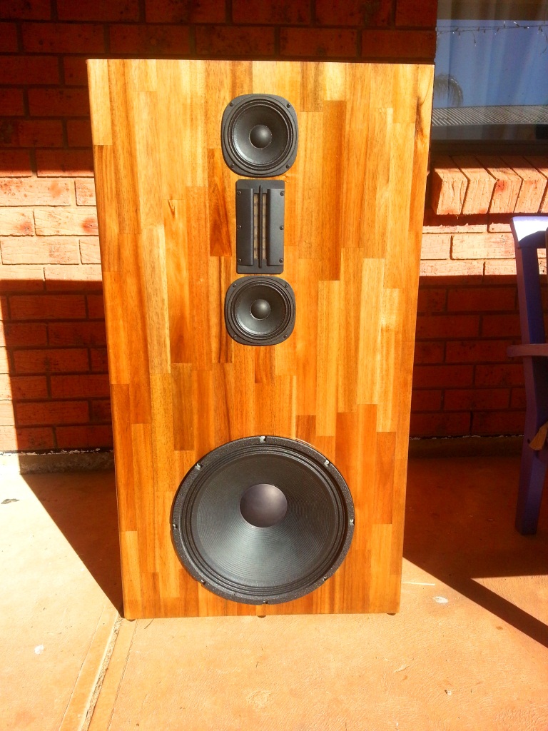

My old OBs were always a bit of a prototype and a compromise, I wanted to do it properly designed from scratch with new drivers. Eminence Beta15a with a 1st order 250hz low pass. wide range mids are a Celestian 5" buyout, super flat to 5kHz and subsequently have a band pass from 250hz to 5kHz. The highs are handled by a Dayton Audio PT2C-8 Planar Tweeter which for the money cannot be beat and outperforms ribbons 3 times its price. 2nd order 5kHz highpass on the PT2C-8. last photo is a shot of the old being replaced by the new.

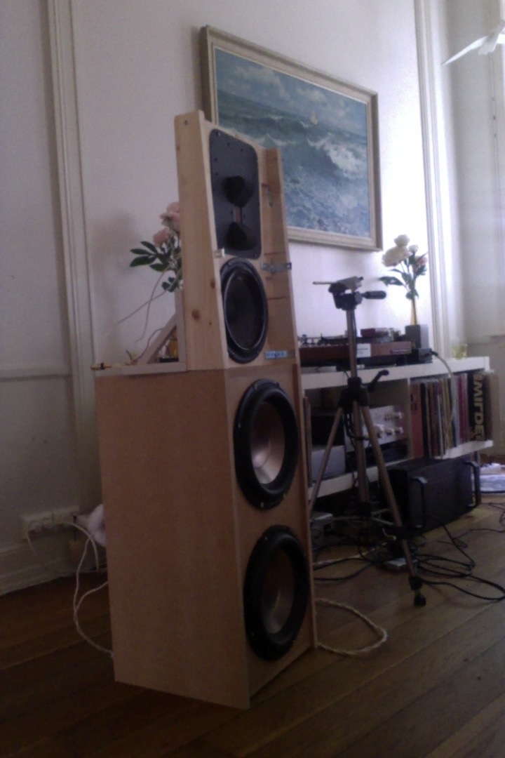

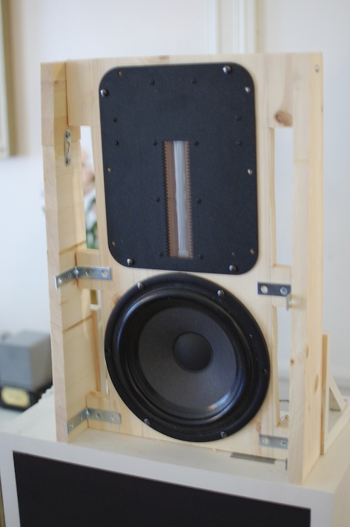

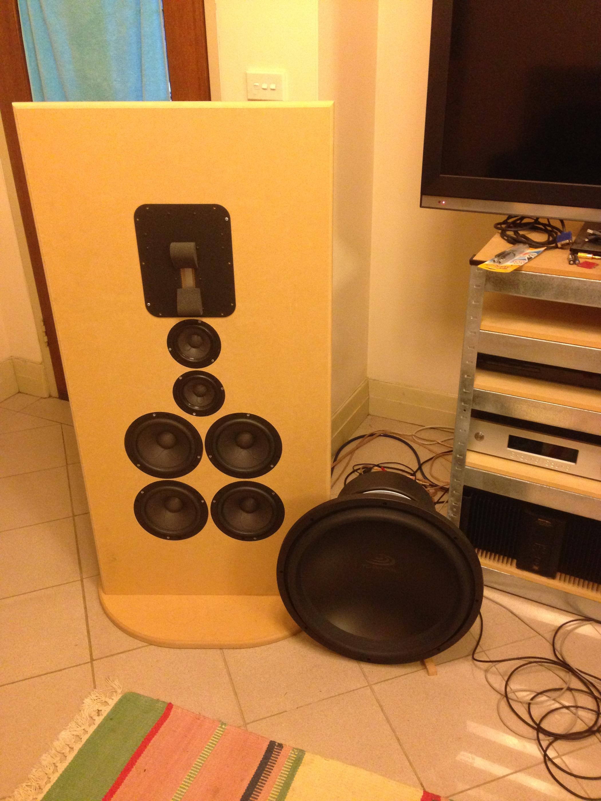

i'm also building a speaker using the RAAL dipole tweeter 🙂
right now i am working on the passive crossover between mid and tweeter, but even with a sub-optimal XO the tweeter sounds amazing! 😀
hopefully it wont be too long before i am happy with the XO and baffle shape and can start constructing the speaker properly.
