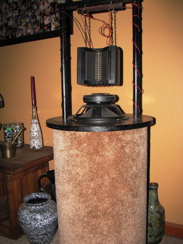

I would expect more designs to feature it, it's really a nice sounding tweeter..I very much enjoy mine.
Honestly, the big Heil is the only high frequency driver I like better, their price tag is the only thing keeping me from bringing a couple of them home.
Clearly you have never heard the RAAL dipoles... But they are a lot dearer still. The Heil is a far better tweeter for the money over the Neo3.

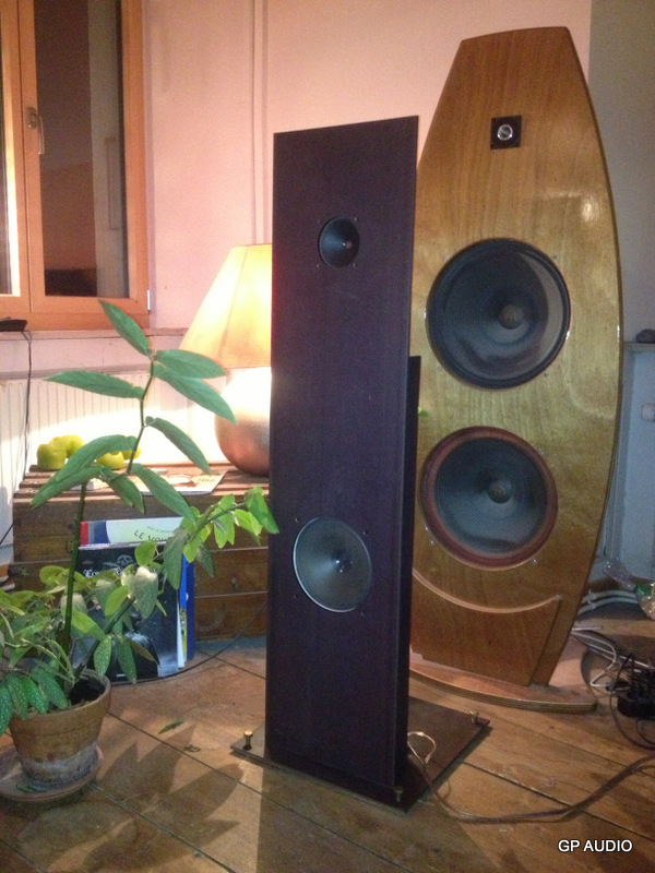

Finished my Open baffles in glass, 10mm.
Saba Green cones inside, driven with less then 1 watt from my 6EM7 SE amp.
Never heard anything purer then this!
Absolutely marvelous!!

i cut the saba tweeters (which are open at the back) at about 5khz, the low-mid runs all the way up.

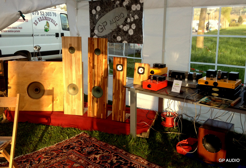

I build these Saba OB's to sell. Or at least I try.
So far, not many and no huge profit, just enough to keep the project going and buy a bottle of malt and a cigar sometimes :eek:

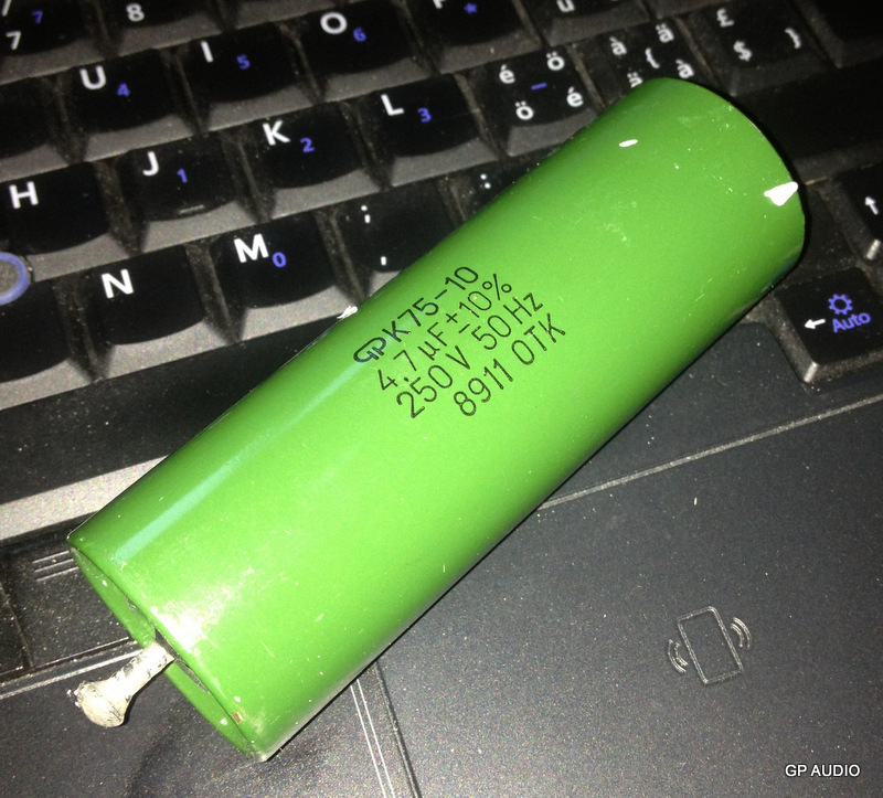

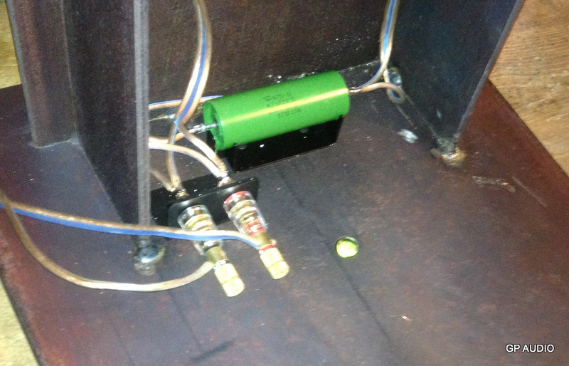

For all the "non" glass ones (wood or steel) I use a PIO from the russian army.
Sounds really nice and clean, it is mounted at the bottom where the terminals are.
They are too big and ugly (customers' point of view, not mine) to use in the glass ones.
There I use MKT's from Monacor.
I prefer the ugly ones...

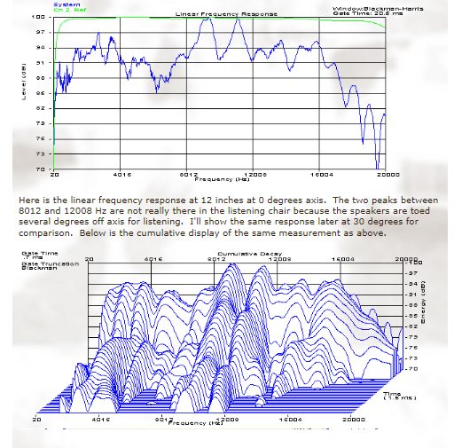

Nice woodwork but the price is too low, only 4000$/pair. Semi-nearfield (12") response is shown in a pdf - not impressive.
I don't really belive that hijacking some of backwave energy through a slot to a reflex chamber, and it's port openig on the backside of the panel really works. The pdfs tell of the development of the speaker in many words, that is nice:xfingers:
