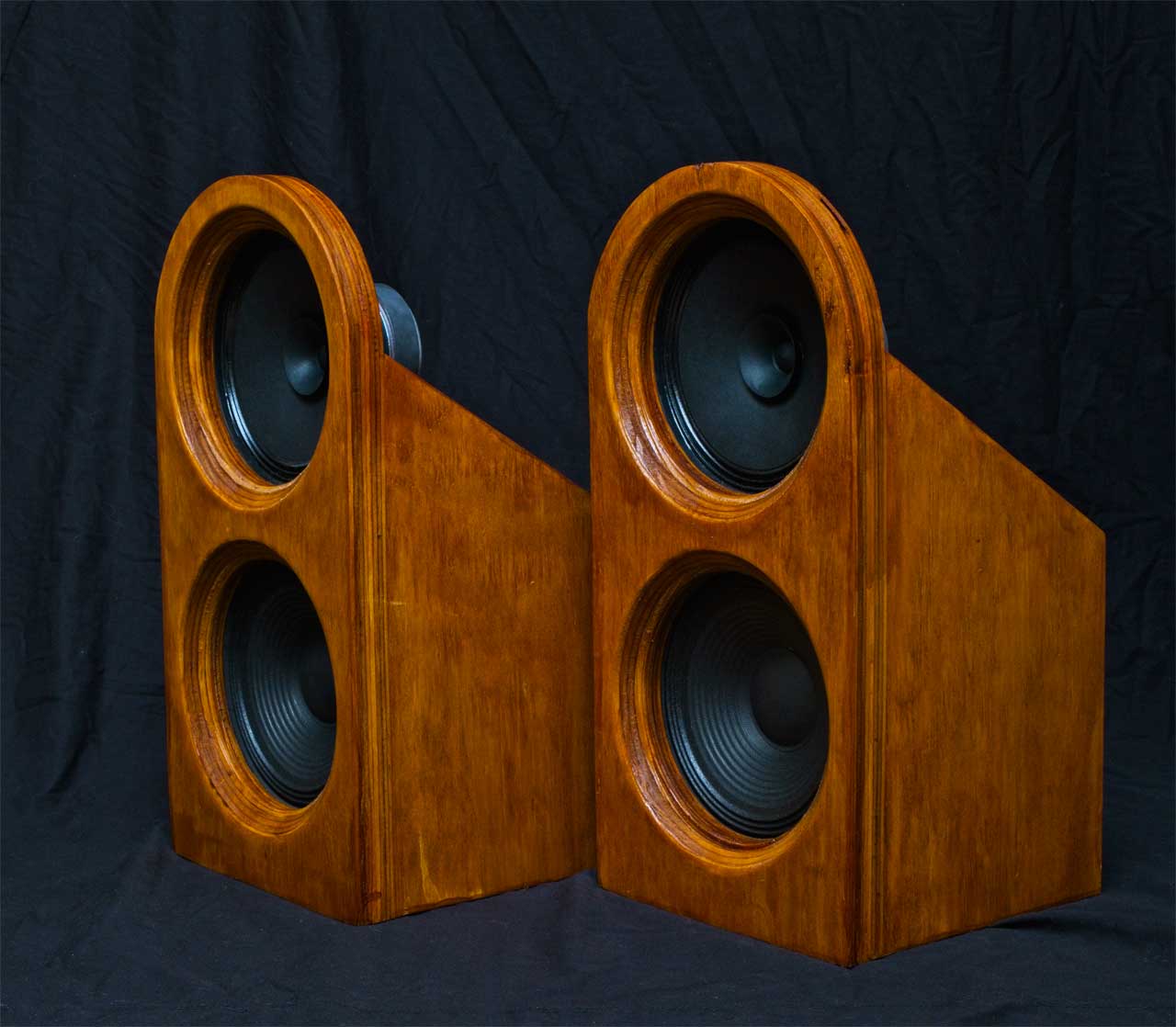

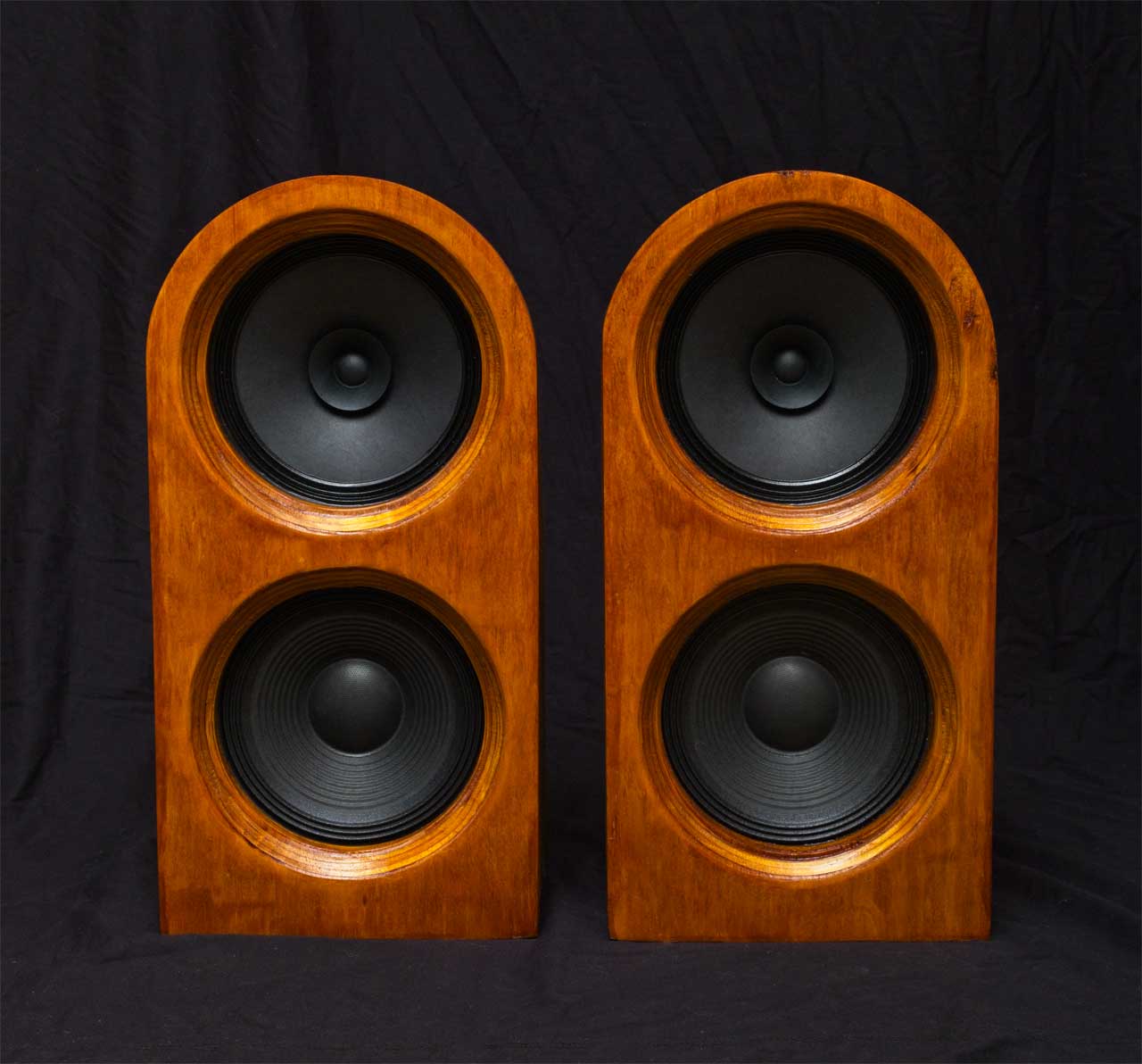

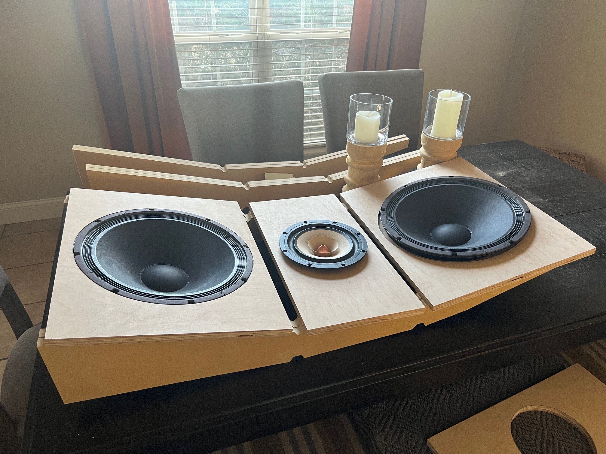

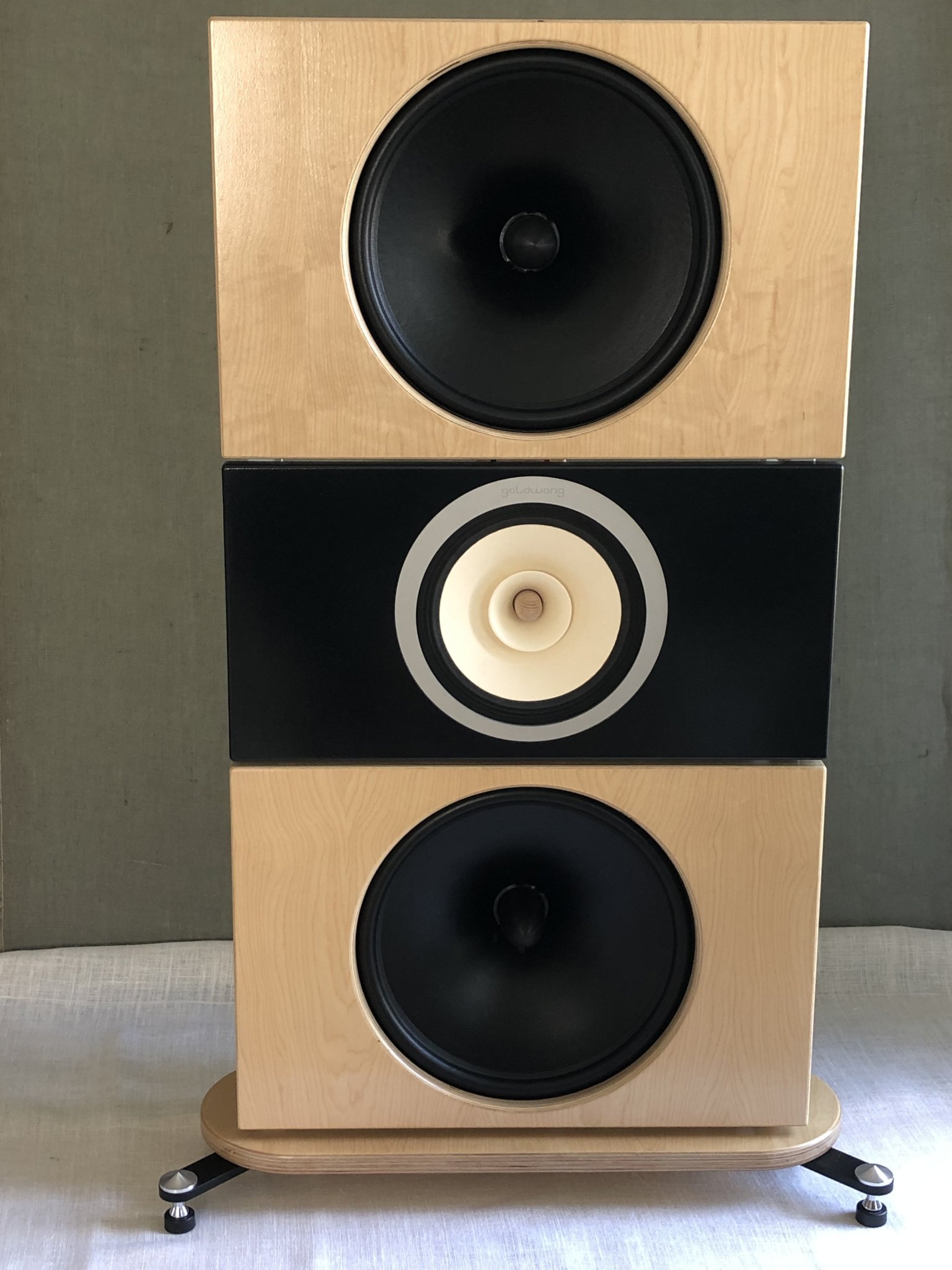

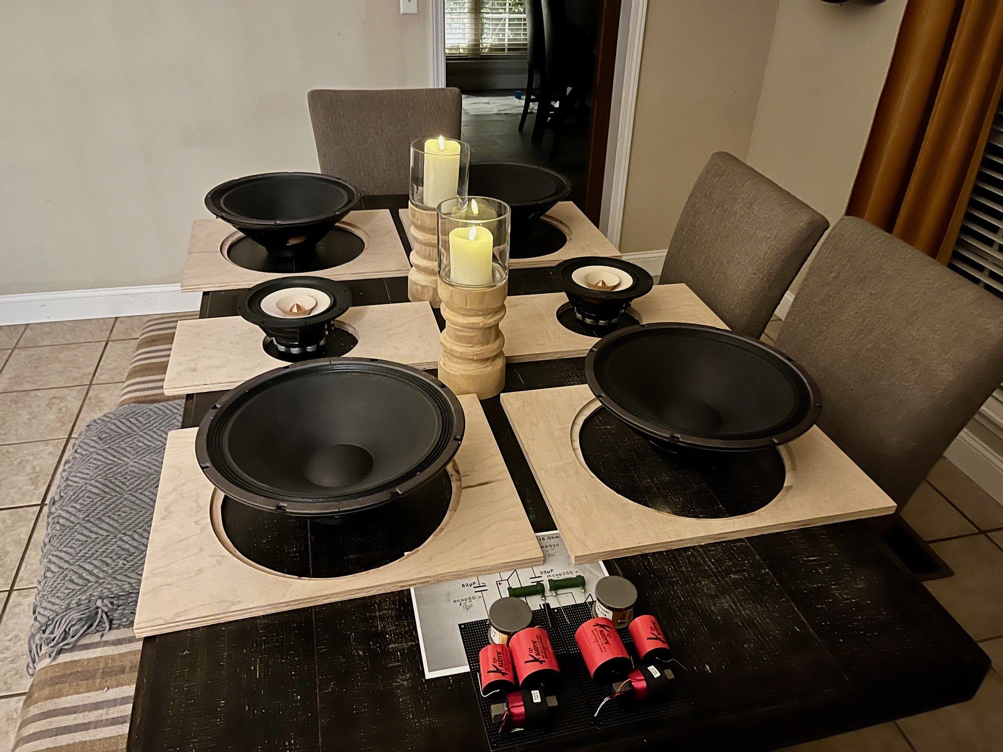

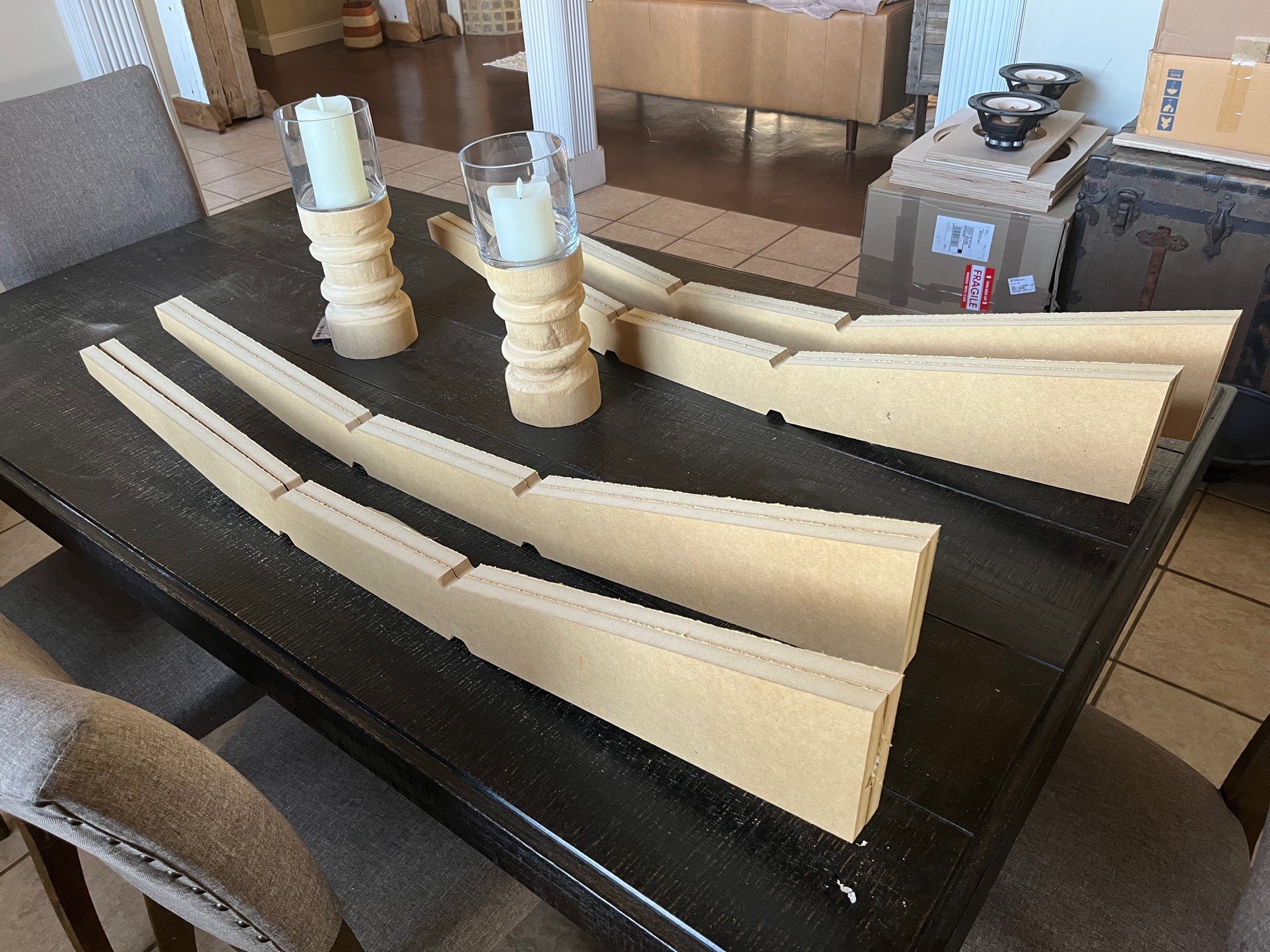

Getting close on a pair of OB's—needing to cut out the bases and attempt to assemble the crossovers. I'm considering a DSP to get them up and running, as this is my first attempt at building something like this. Thanks to everyone who has contributed to this thread, it's been very helpful!!

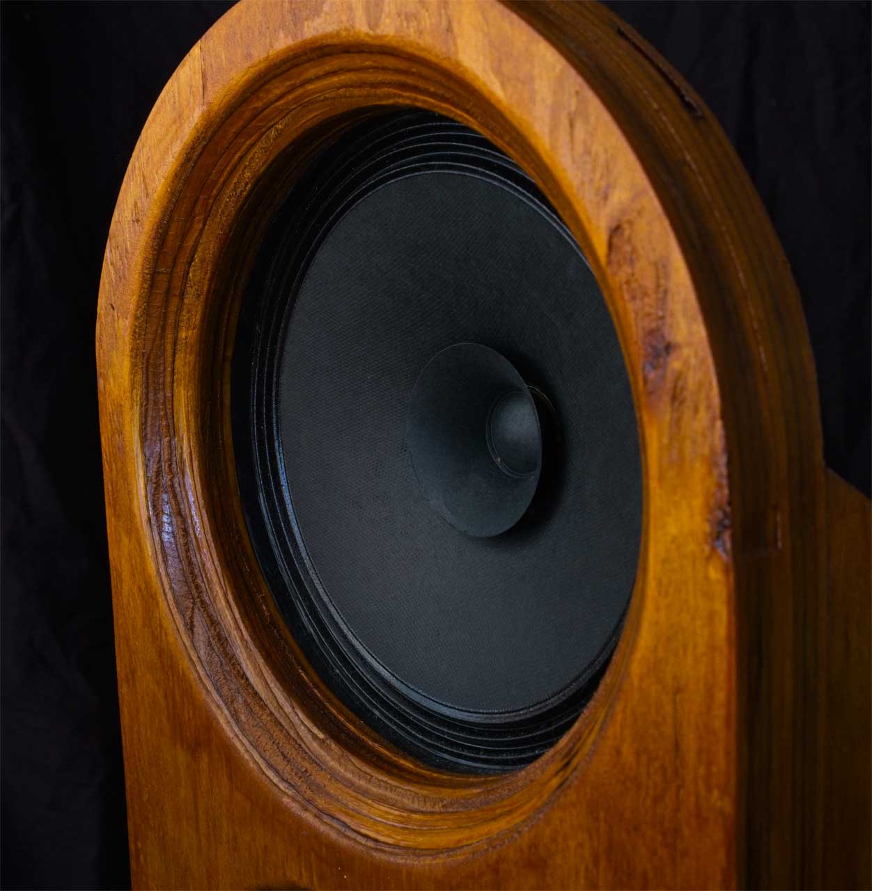

Nice PAP build @FastTimes and did you do flush mounting for the Eminence woofers? Seems like when I was following the SBAF thread it was recommended not to flush mount any of the drivers and specifically was told to mount the Eminence woofers from behind and the TB driver from the front as you can see in my build. Not sure how much of an effect this will do but I like the woofers mounted from behind and never heard them flush mounted.
Also curious to know how did you get the angled wings? Any specific dimensions or just an angle to make sure that the speakers do not tilt?
thanks
@manniraj - thanks. I did cut the Eminence baffles to flush mount them (It seems folks have mounted them both ways). I've got additional material to cut new baffles and be able to mount them from behind if needed. I was able to get a CNC file for the legs from another OB builder (similar to the classics). This is my first attempt at something like this, so I knew going in that I would have a learning curve. I'm ready to get them up and running!

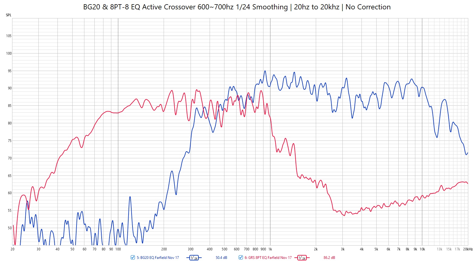

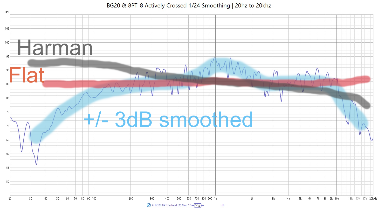

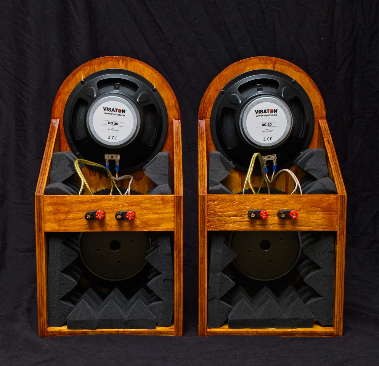

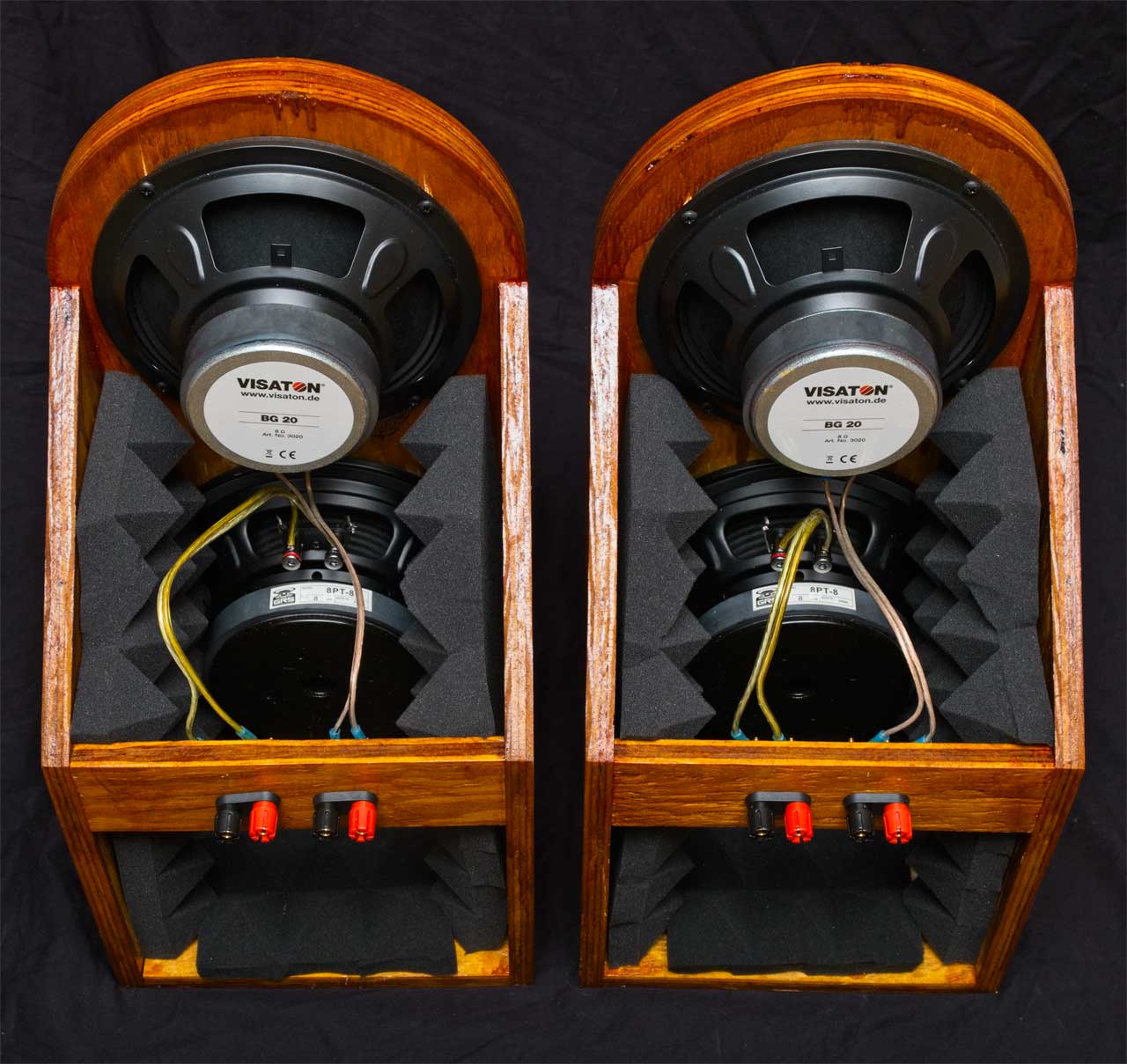

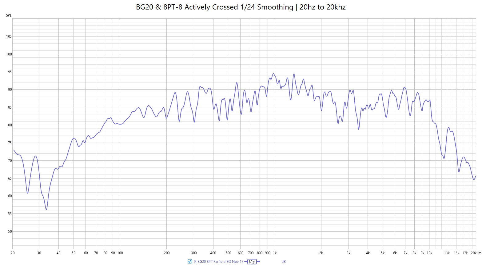

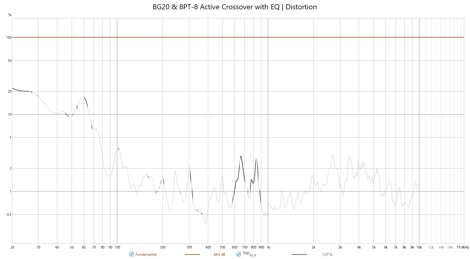

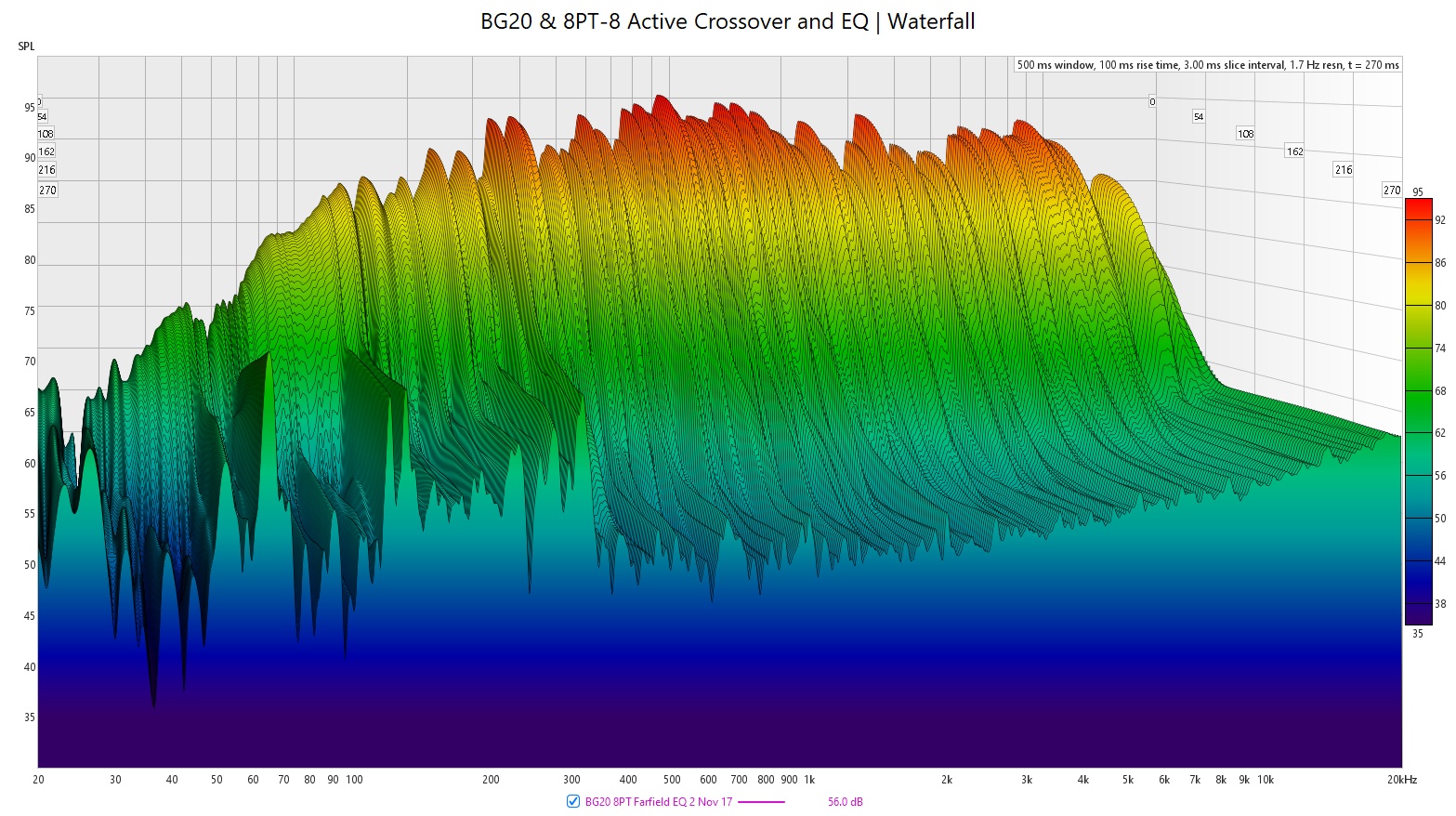

Finished some open baffle WAW 2 way loudspeakers. It was a spontaneous effort on a rainy day. I used a full range driver as the tweeter and mid, and a matched woofer for bass and mids. Crossed around 700hz currently. Fairly good output to 80hz or so right now. Sounds pretty good. Lots of issues but something to tinker on over time as a project. Using a Visaton BG20 as the tweeter and mid range overall wideband, and a GRS 8PT-8 woofer as the woofer support down into bass. I did this so that I could minimize cone breakup of the full range driver in its upper frequencies when also producing high excursion for low frequencies. The woofer instead does that and no more big bad cone breakup when it's turned up louder and boosted down low. Currently active crossover via DSP. Will eventually work on a passive, but its a big challenge. I worked a lot of "bad things" into this speaker. It will be my long term tinker project for a while... I worked in a lot of bad things by just winging it and doing a random build basically. Very little planning. So far, it sounds good, surprisingly, but only because active DSP is like a cheat code.

These OB's turned out great!
