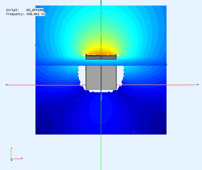

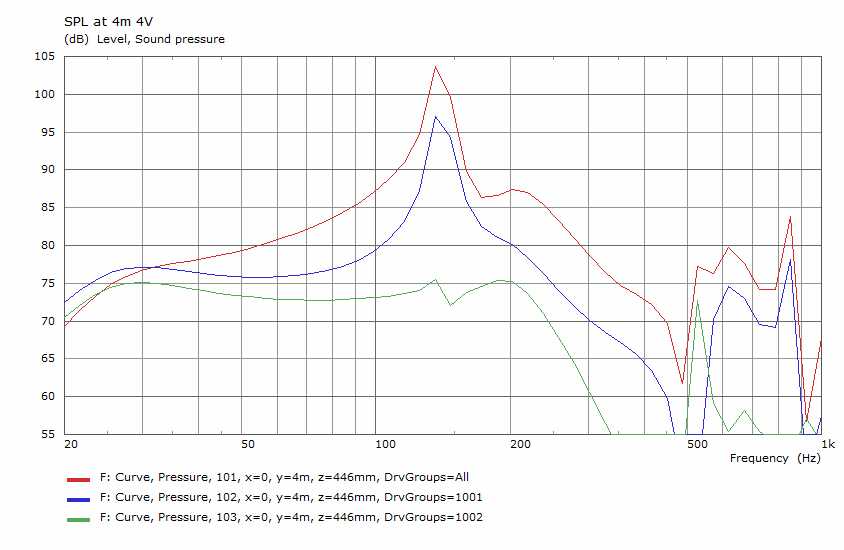

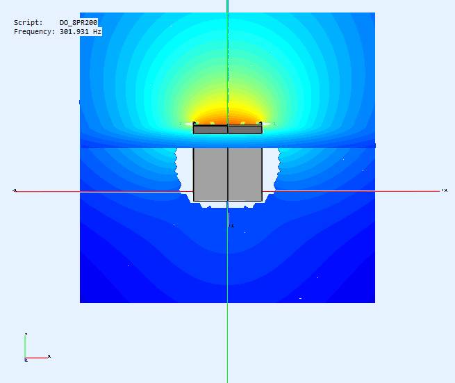

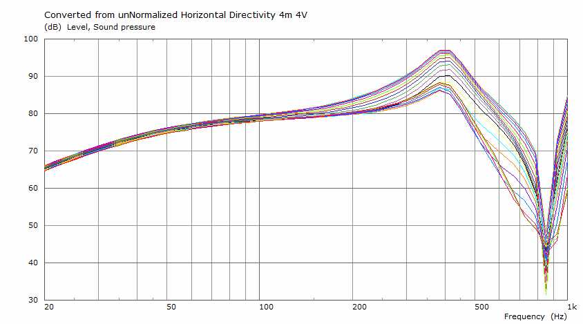

I just happened to have done ABEC sims of slot loaded dual opposed 8" woofers (8PR200) not too long ago. I made the slot 50mm high and just wide enough and deep enough to fit the driver. This was sealed however, not ripole.
There was a bandpass peak of about 8db at 300 Hz, which was very equalizable, Its easily usable beyond 400 Hz. I'm not sure how low you can go with 8NDL51s open baffle/ripole but it looks fine on the high end.
Here are some pictures from the sim

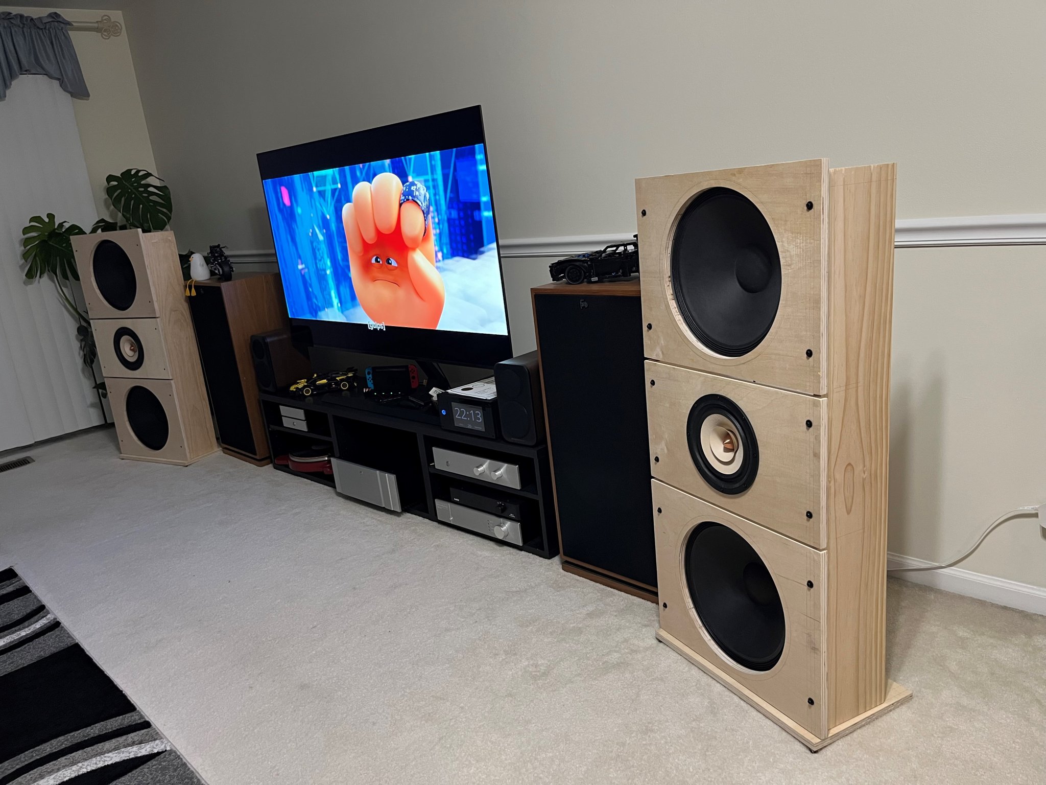

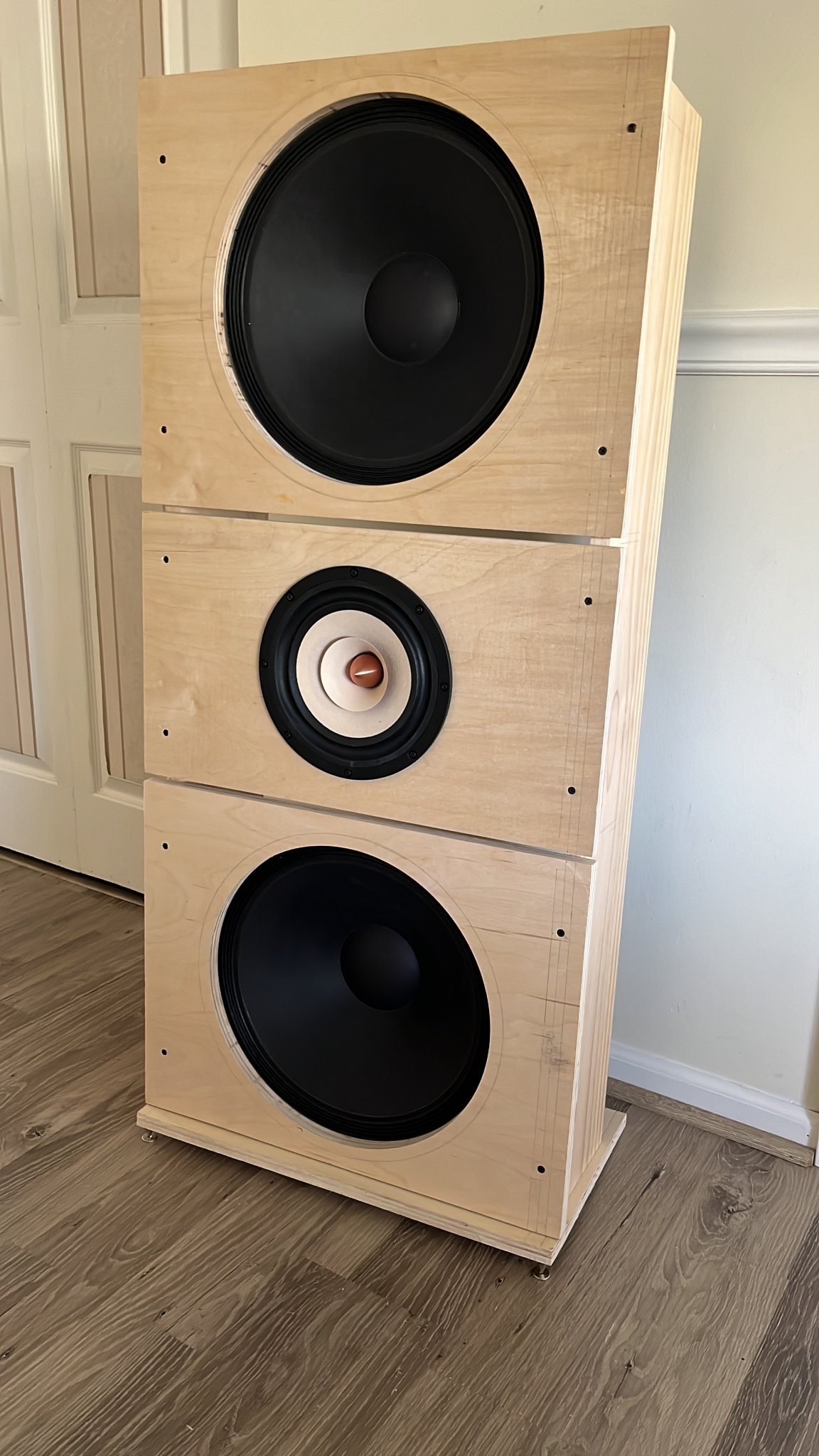

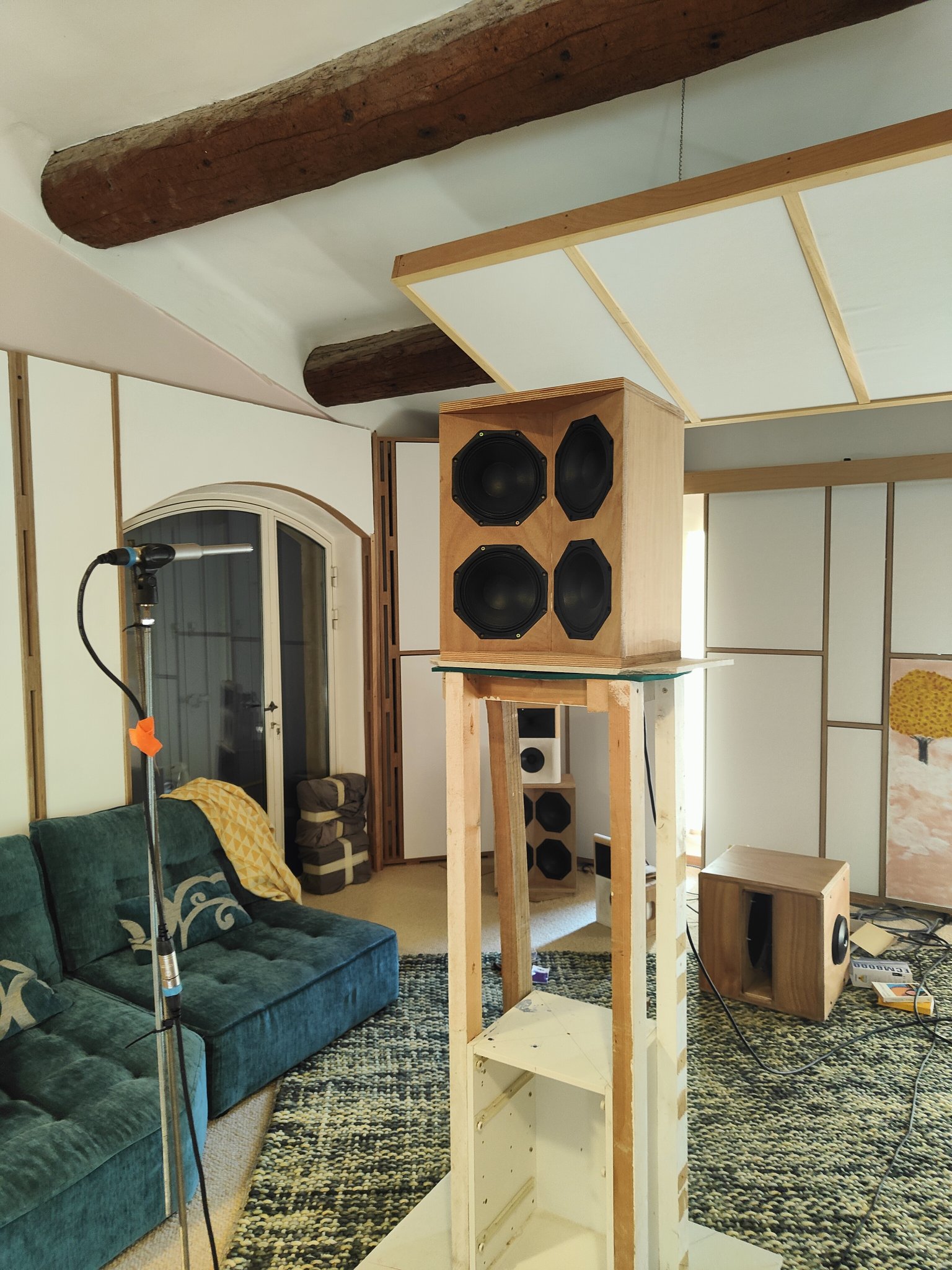

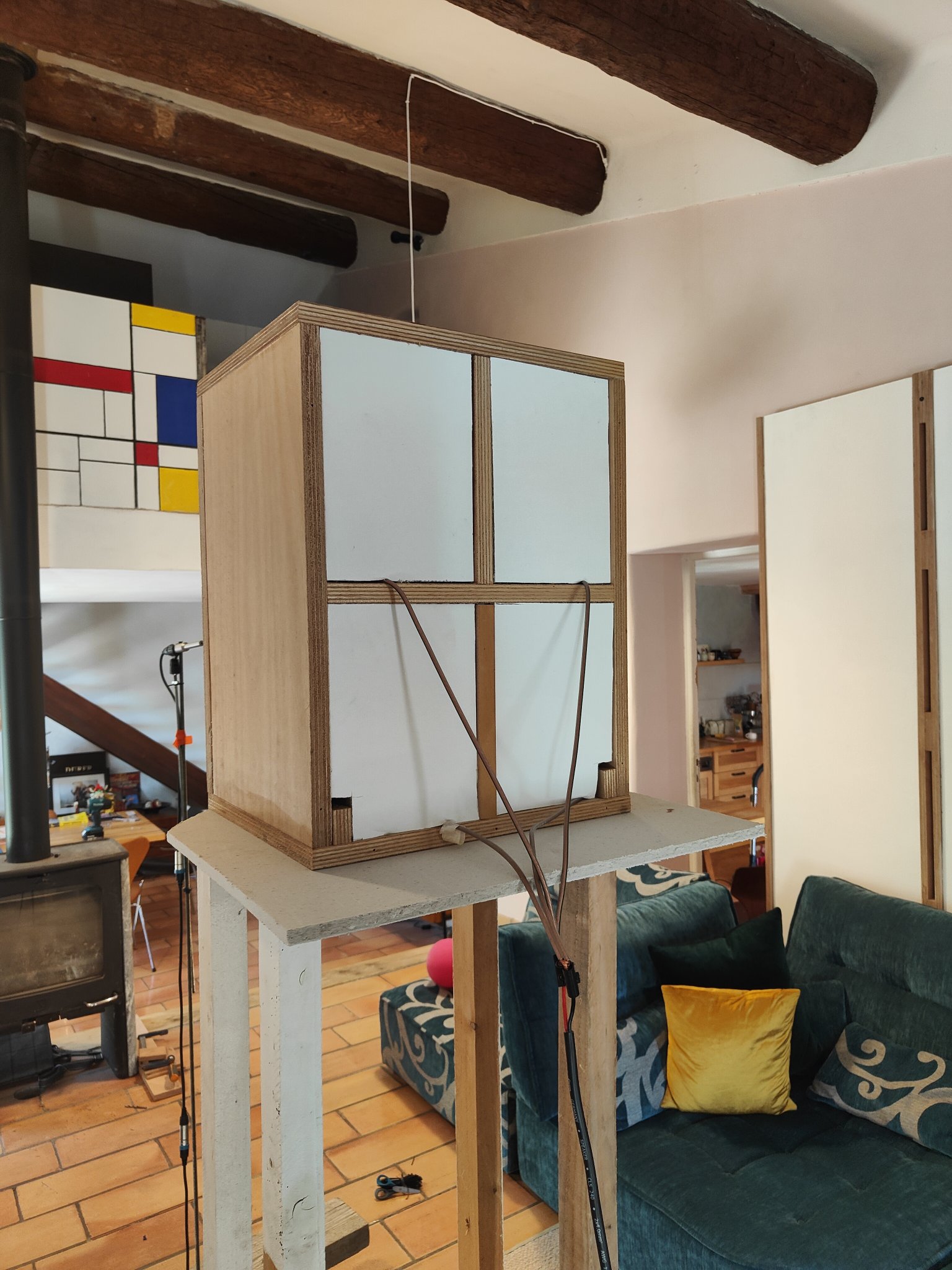

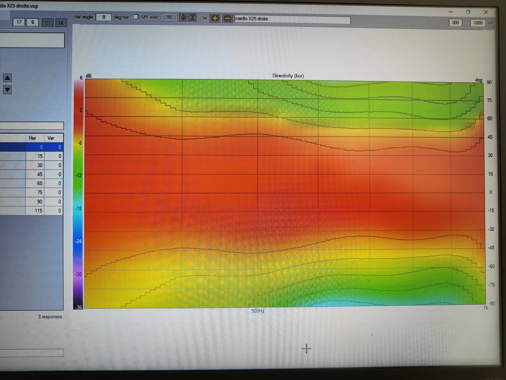

Hello,
I am very happy of the reactions here,
I think that the slot or every kind of dipole or ripple does not behave like a simple dipole, as written in pass article, the velocity of air in the slot is much higher than the one from behind.
I really like my ripple subwoofer for jazz and rock music as it excites the room less than a sealed woofer. If you go next room, you hear no bass at all...

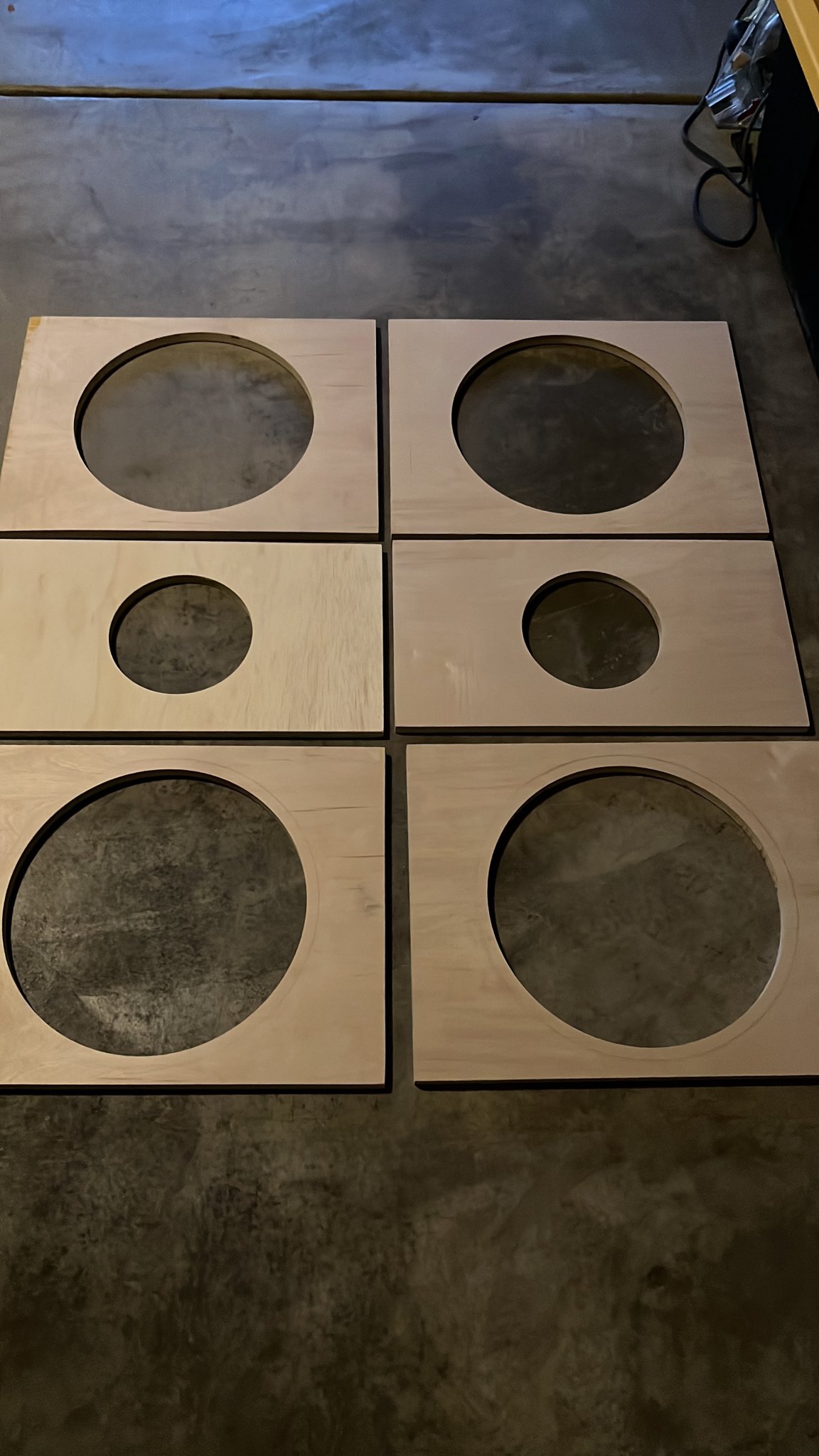

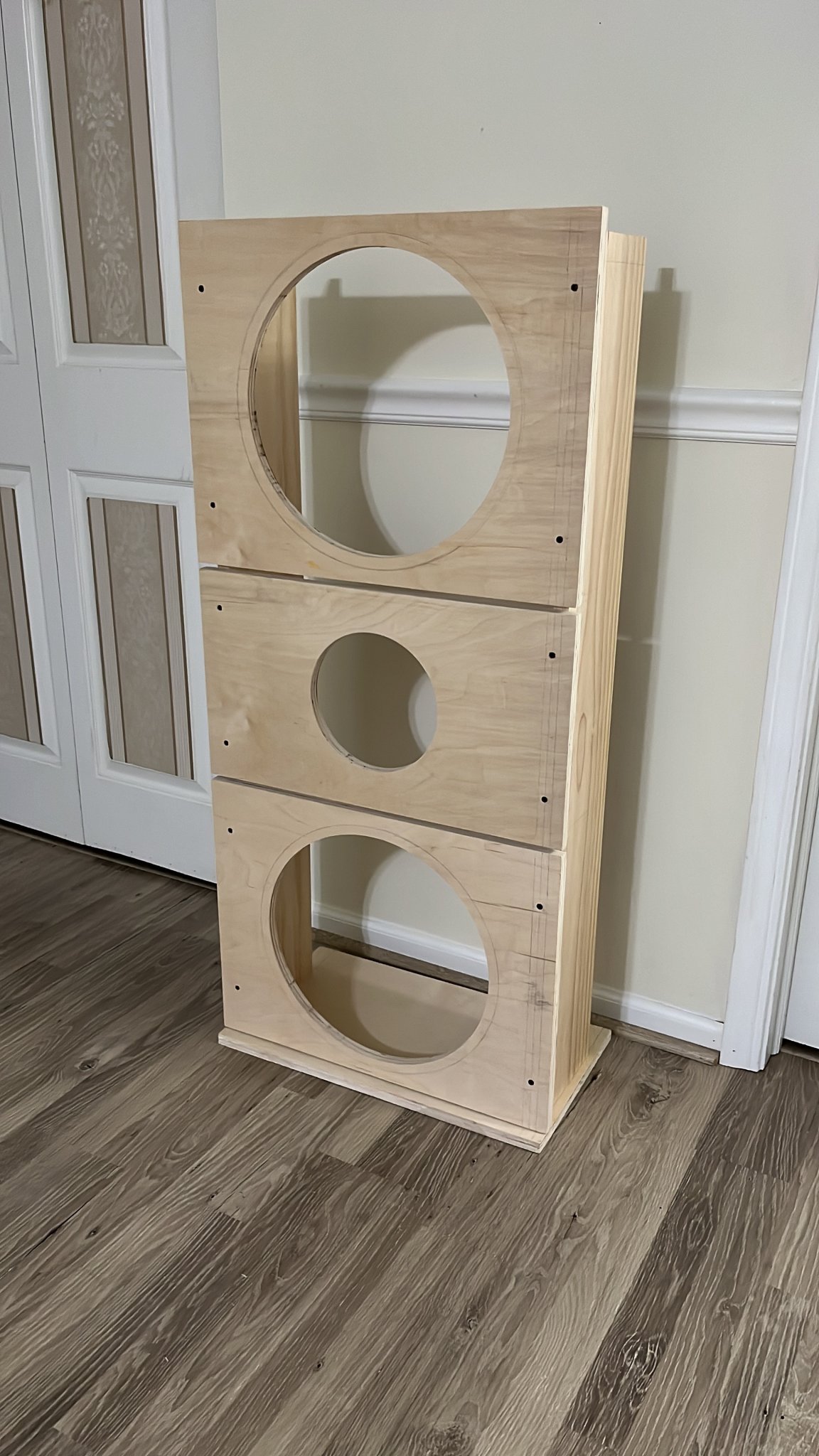

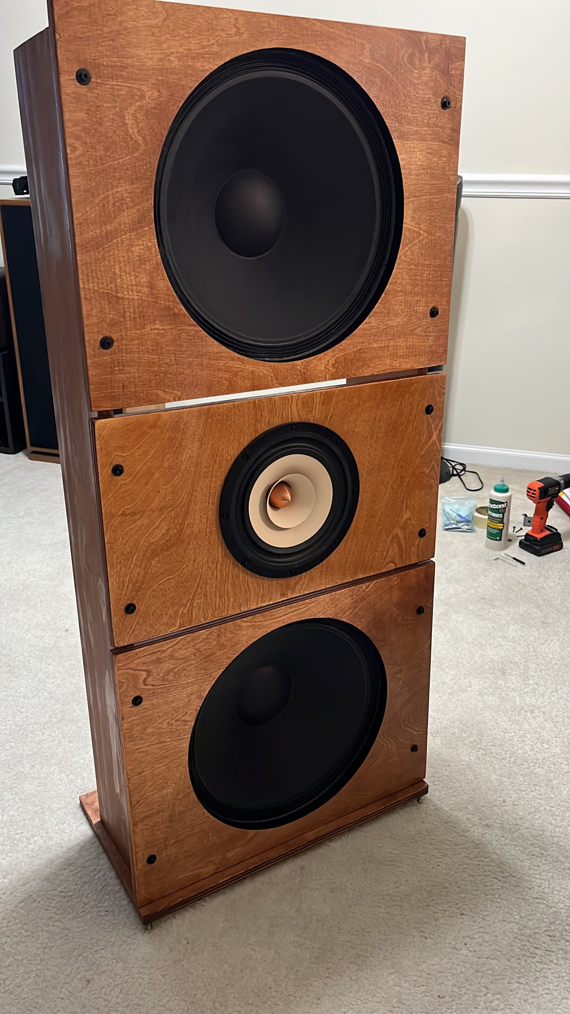

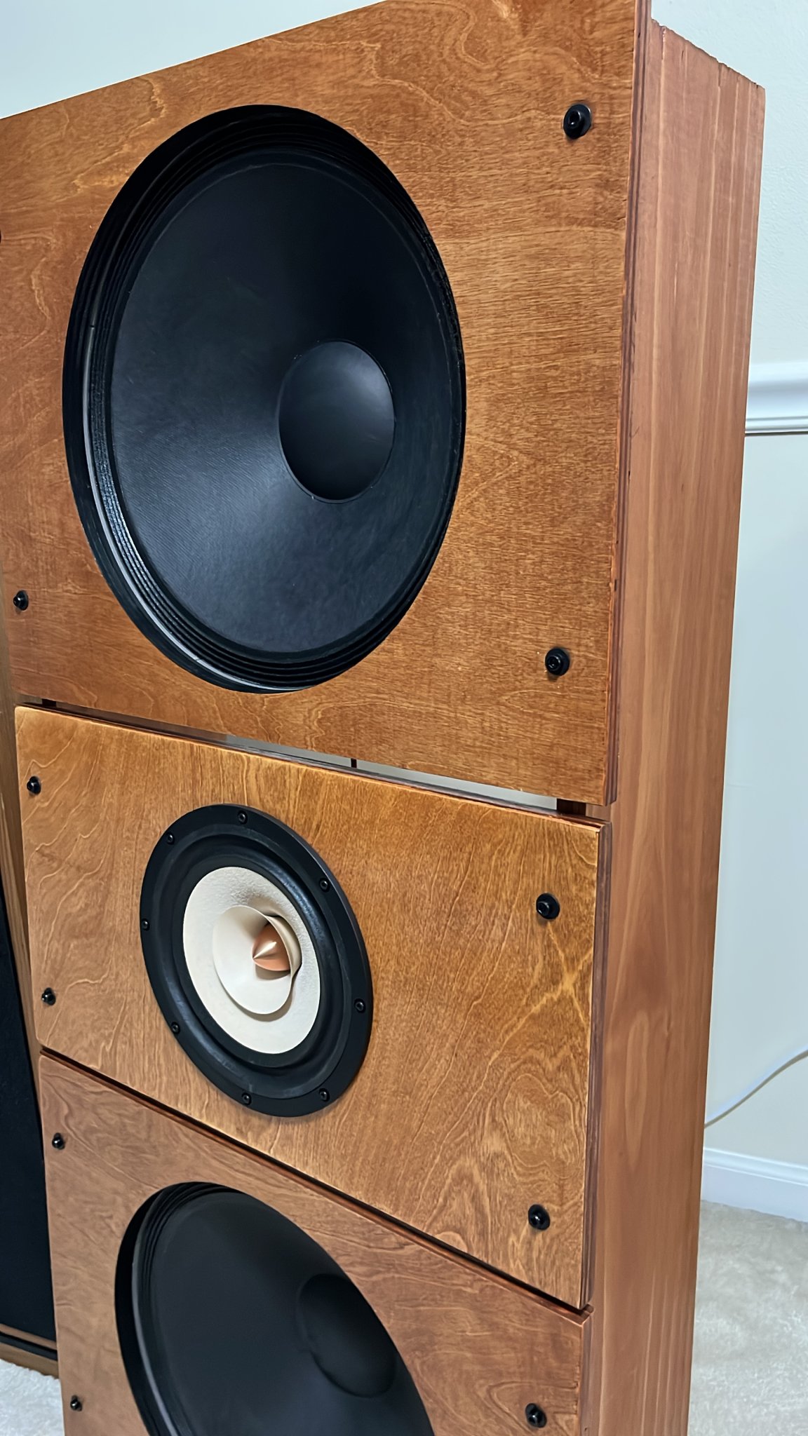

Now here is my design, I measured with the back sealed with 16cm of high density rockwool and without. Without is terrible, but this is not the design we are talking about...
I was worried about directivity at 500hz but it is ok
I just happened to have done ABEC sims of slot loaded dual opposed 8" woofers (8PR200) not too long ago. I made the slot 50mm high and just wide enough and deep enough to fit the driver. This was sealed however, not ripole.View attachment 1354621View attachment 1354622View attachment 1354623View attachment 1354624View attachment 1354625View attachment 1354626. There was a bandpass peak of about 8db at 300 Hz, which was very equalizable, Its easily usable beyond 400 Hz. I'm not sure how low you can go with 8NDL51s open baffle/ripole but it looks fine on the high end.
Thanks for your input, it is interesting,
I guess it is the same principle as Pass' project but with a sealed back not to loose too much energy.
I will buy scrap wood and start a funny prototype, I guess it is easy like a ripole, not like to one I made with 30 degree angle...
I like to seal the back with this high density rockwool, it helps avoiding sound box...
So the idea is to have a thin slot and do keep it not so deep to avoid noise and turbulence.
It could be fun if it worked because the design would be less wide than mine.
Maybe it would control directivity lower in frequency, mine behaves like a regular 15" driver...
Regards Greg
If you use two pairs with vertical slots, then the Vertical directivity will be determined by the spacing between the pairs and the Hdir will be determined by the width of the slot, and thus be very wide.
If you rotate so the slot is horizontal, then you get the Hdir of an 8" driver but you may have some sag due to gravity. You still get Vdir per the vertical spacing of the two pairs.

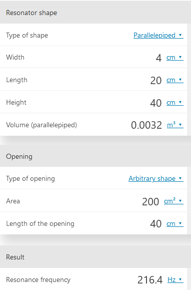

Hello,
Yes I cannot go into the active cardioid, it is too much work and it is very difficult to measure at these frequencies. In my room I can gate measurements at 4 or 5ms at best.
And I am already doing active 3 ways with a subwoofer (Ripole).
I am experimenting cardioid for the mids though.
So what I could do is try the Nelson Pass design but with a folded front baffle as sides. A kind of Ripole. I don't know if he did not have the resonance or if he had eq-ed it. I don't know if this would be a problem as the resonance is maybe not evenly distributed in the pattern, this could ruin the all constant directivity project.
A cavity of 4 by 20 by 40 would apparently give a 220 hz resonance frequency, like in your simulation.
Or because he used is project below 150hz, he didn't really care... And we are not talking about the thermodynamics limitations of the port itself...
It is not a lot of work to try it though. Most of the wood can be bought from scrap wood at the diy store.

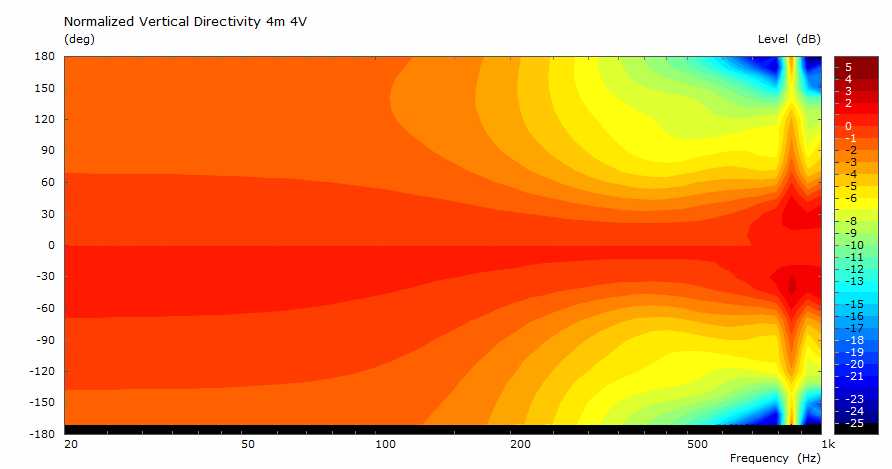

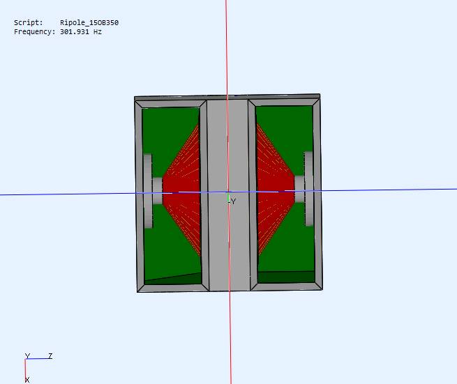

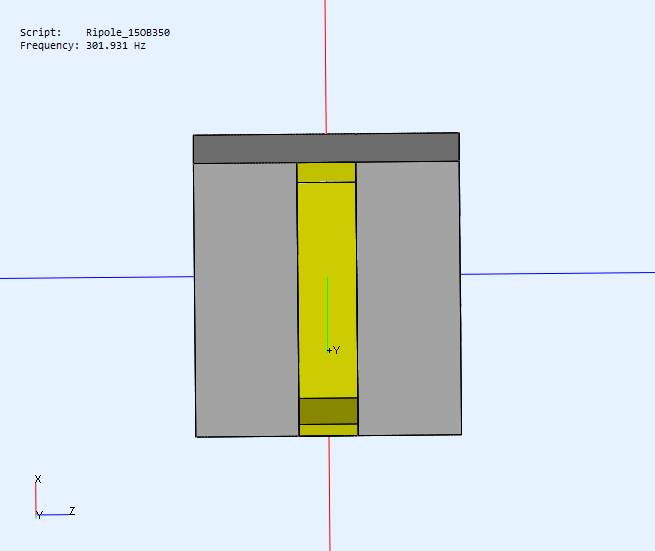

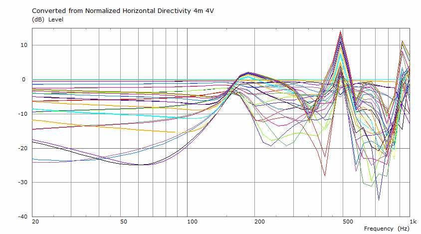

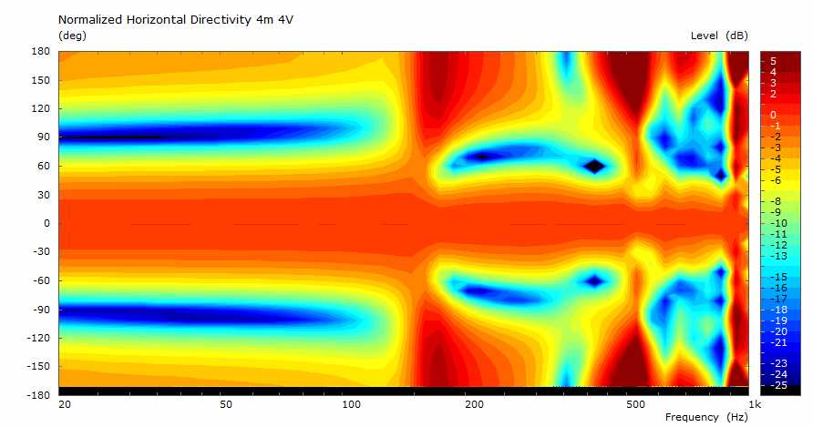

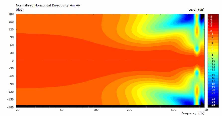

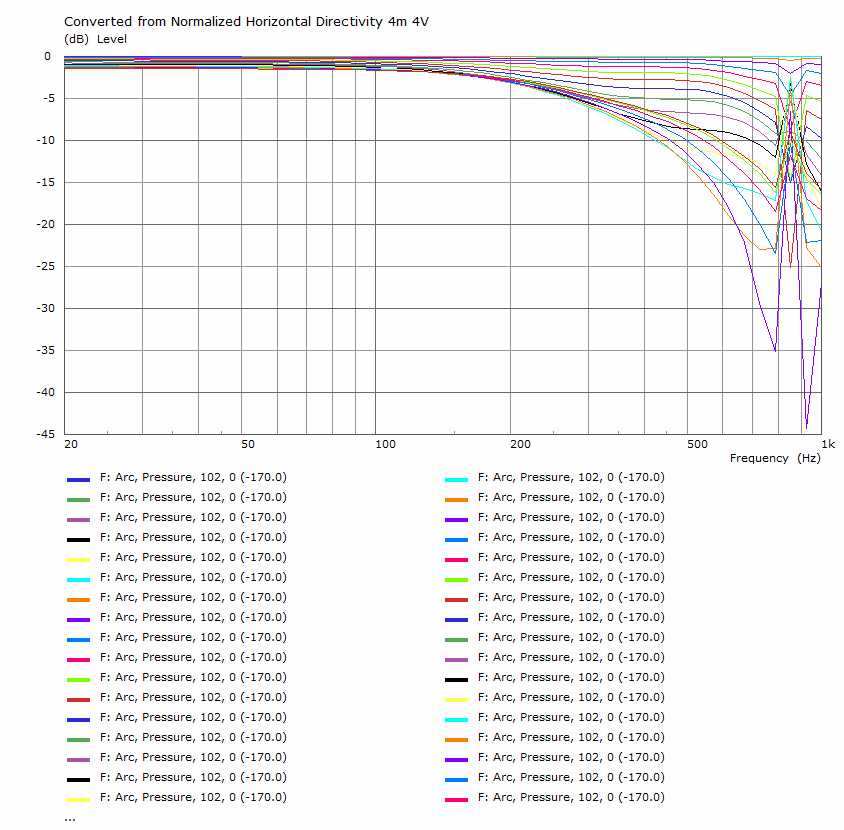

I did find an unfinished ripole simulation. I had abandoned it when the results were discouraging. I managed to clean it up and came to an understanding why ripoles are just used for subwoofers. In the slot loaded woofer, we get a bandpass peak that turns out to be equalizable and can use the woofer fairly high. If we open up the back wall of the slot loaded woofer to create ripole. We get that peaked response out the front but not the back so the dipole like response doesn't extend past the point where the response risess. You can see what happens in the graphs below. This sim is for a pair of 16OB350s. Even if scaled to 8", the response wouldn't be usable anywhere near asa high as you are aiming..
