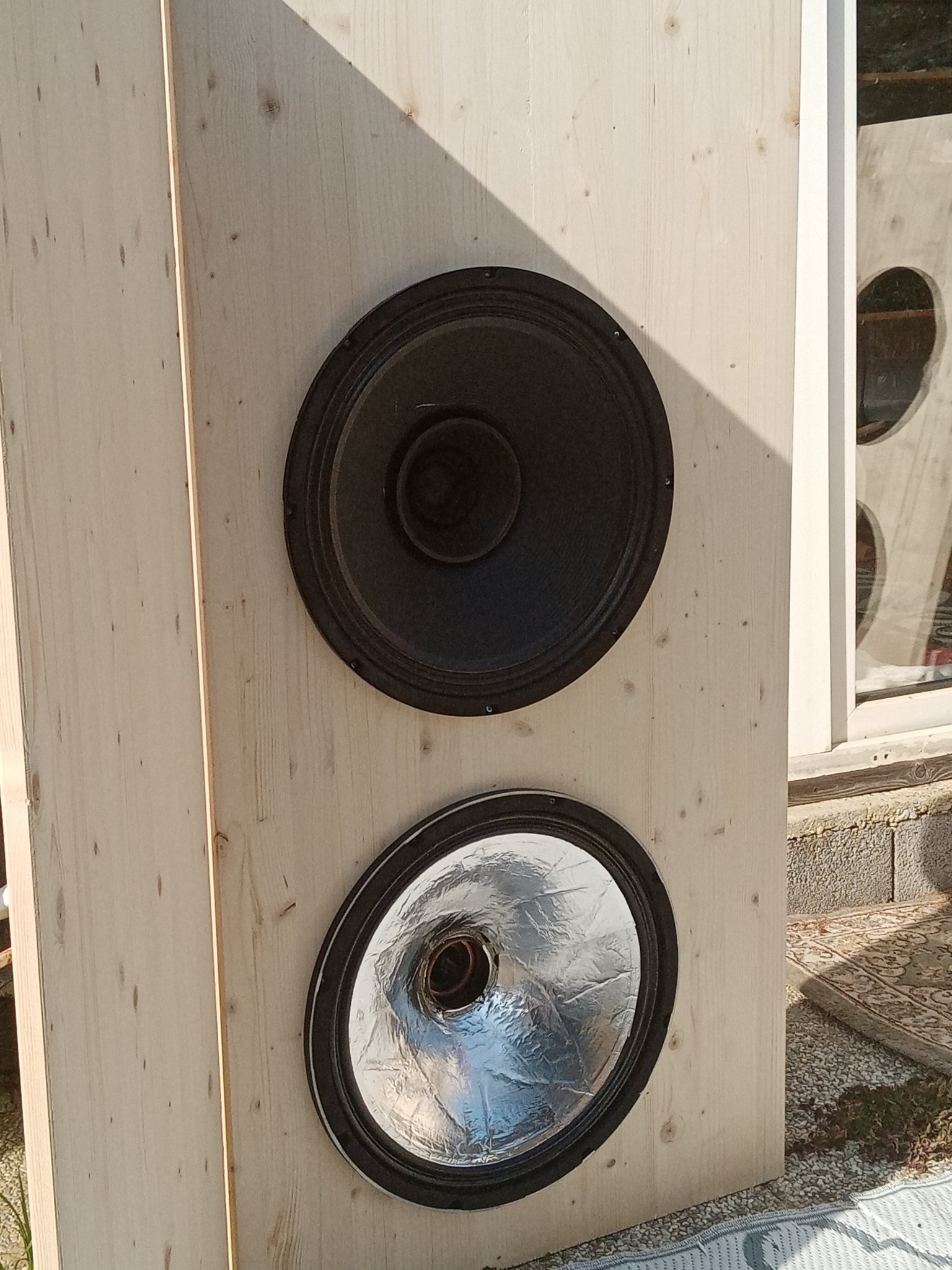

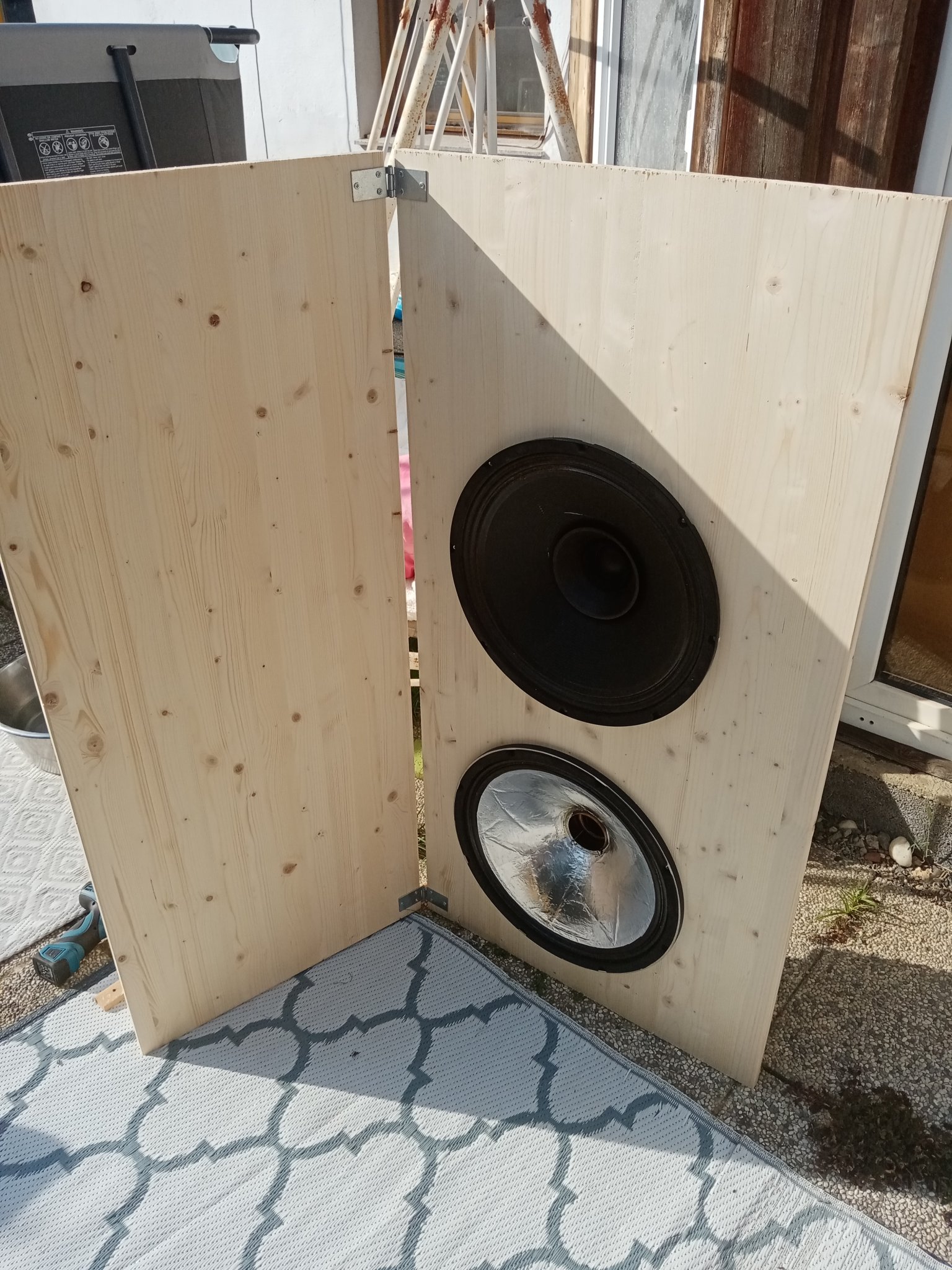

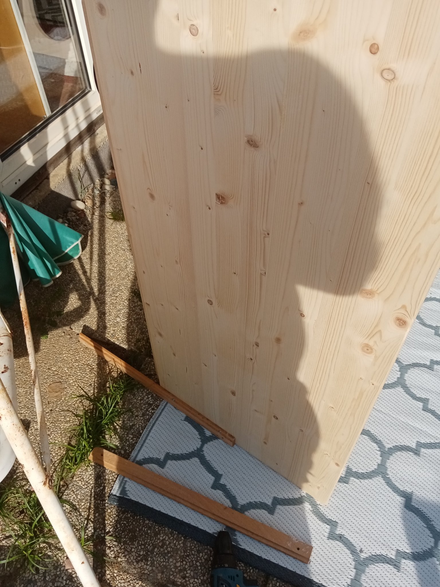

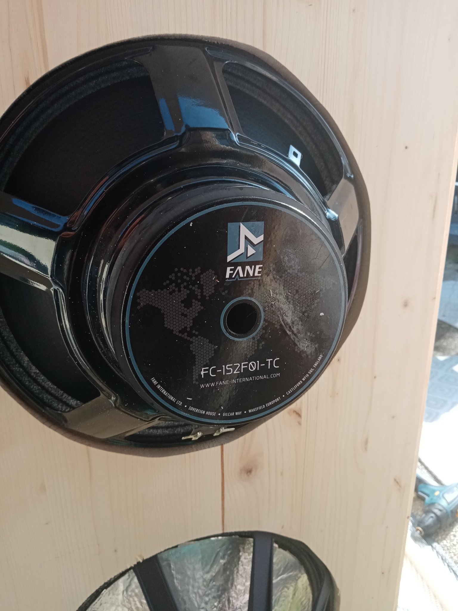

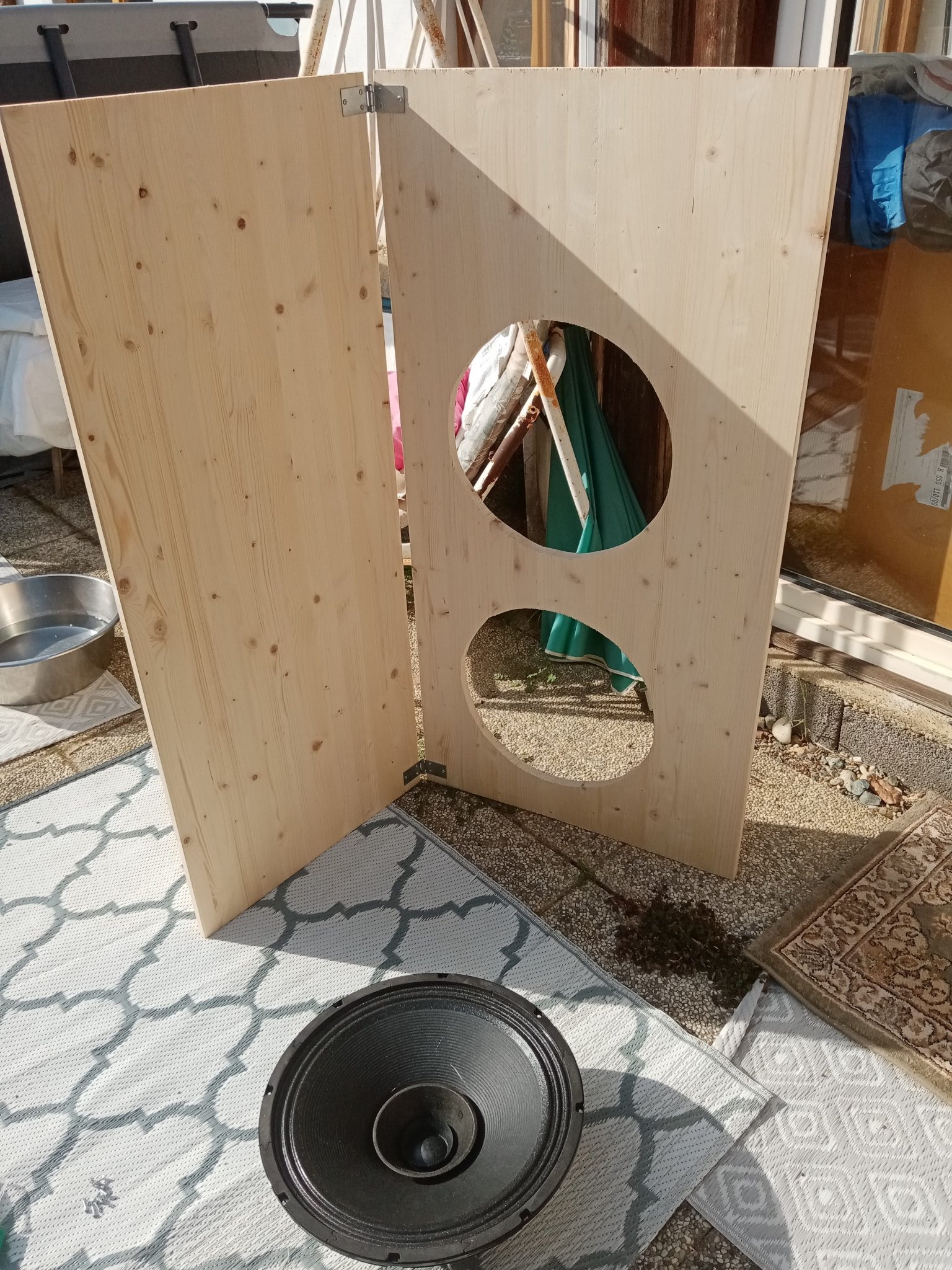

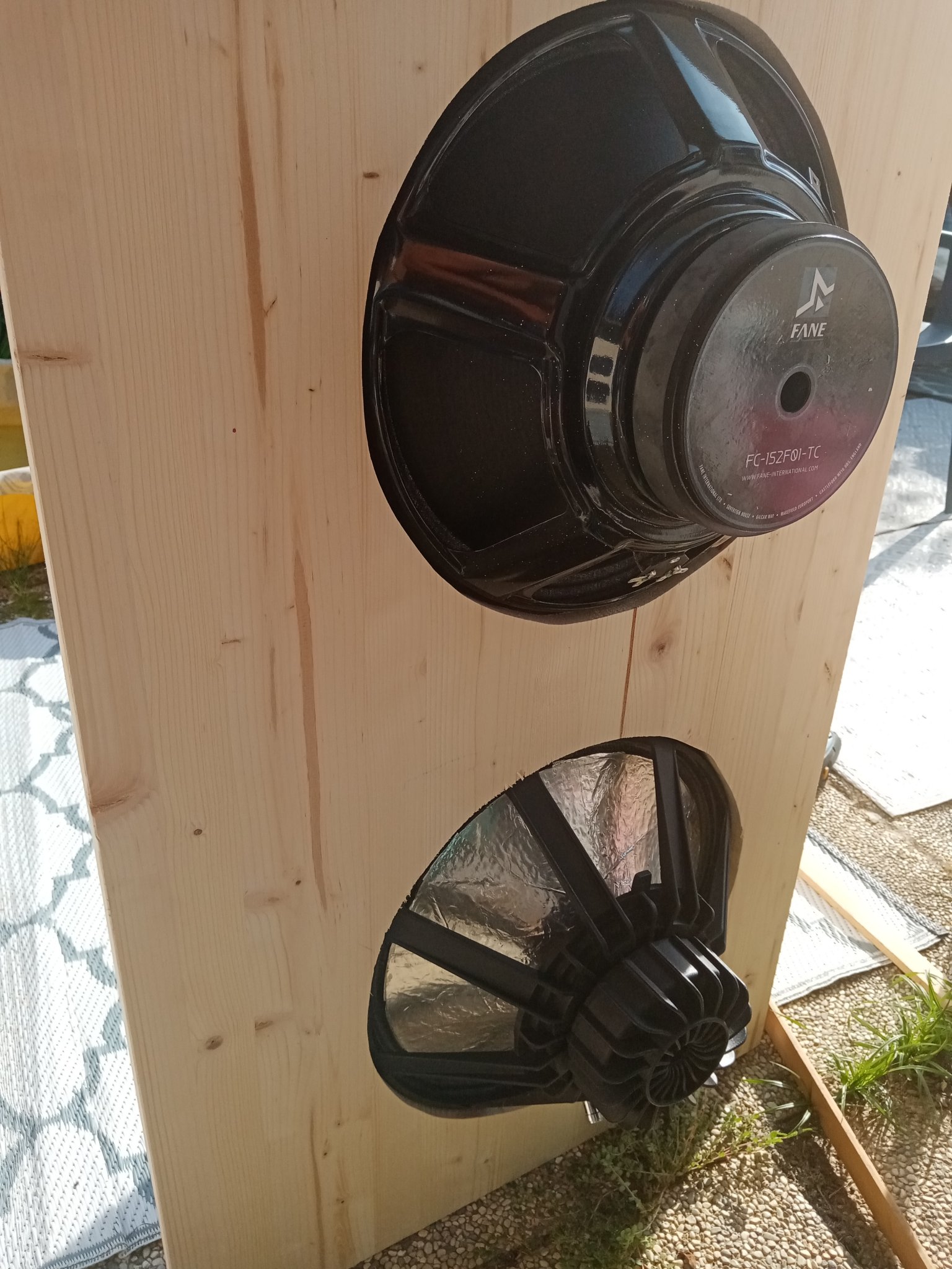

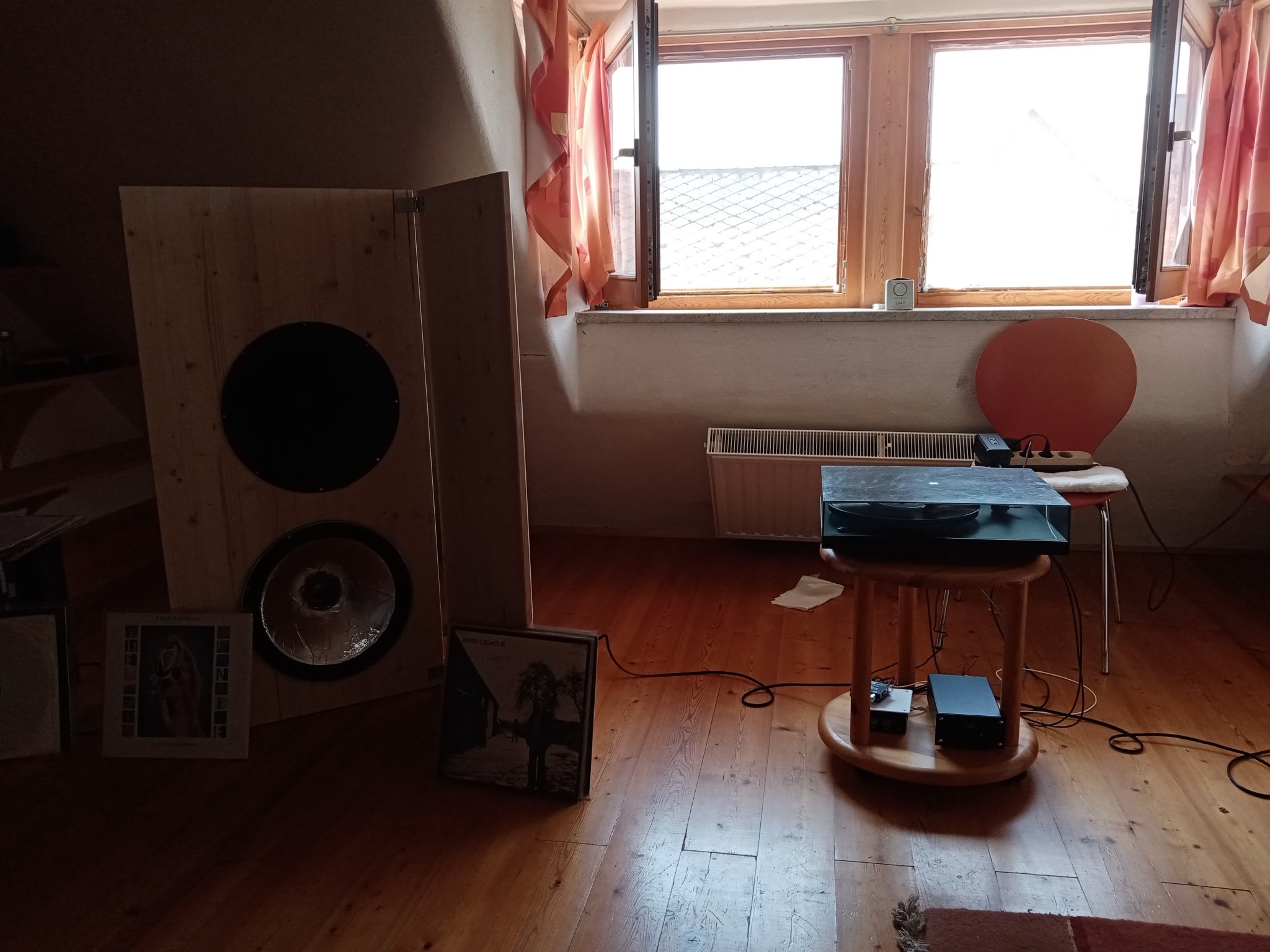

Here are some new Fotos of Fane 15-300tc with Rega Planar 3, Goldring 1042 and WBE Audio PhonoPre (with OPA627) and TDA2005 in current drive, Whuzi Audio Preamp (NE5532)

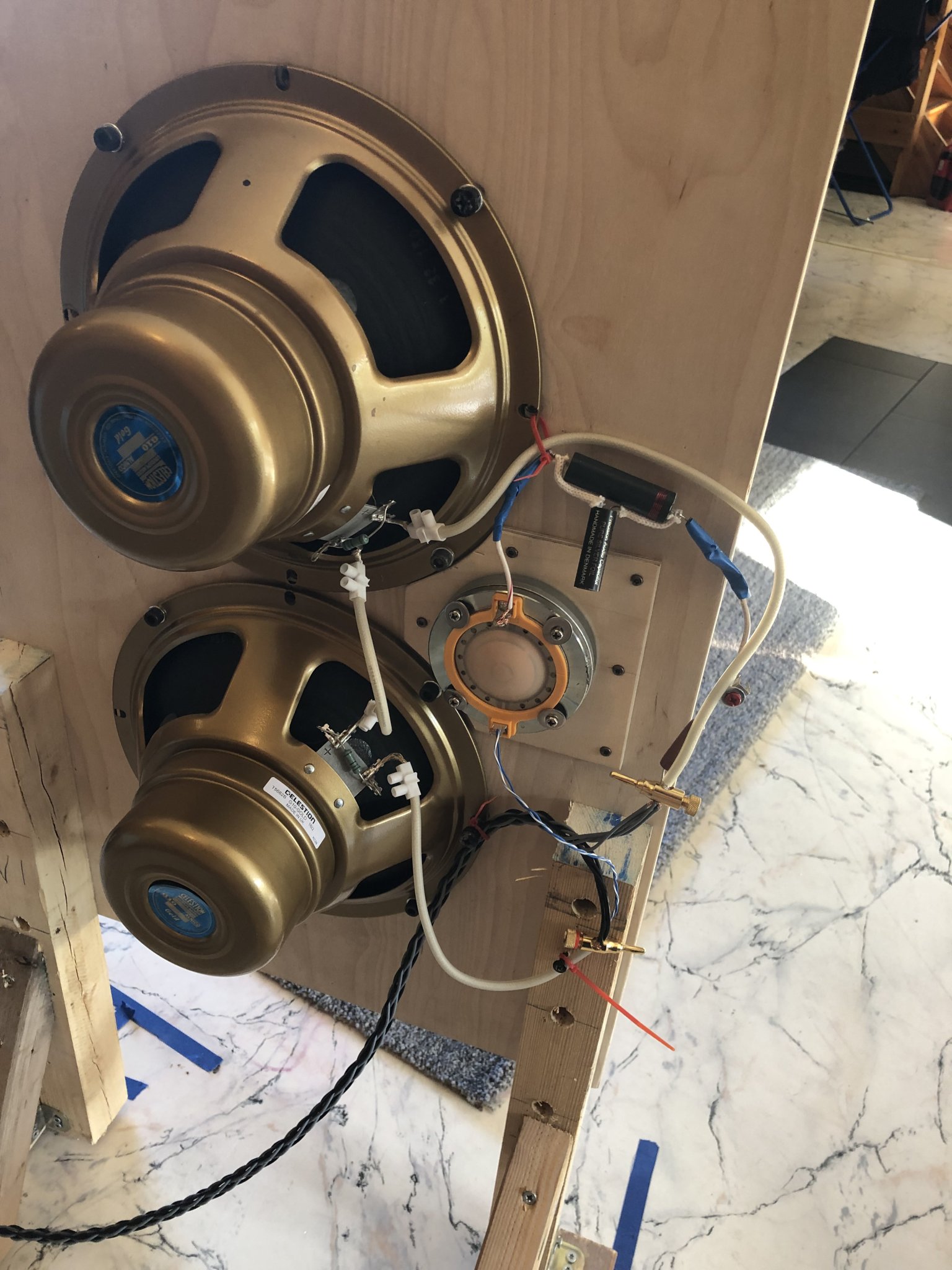

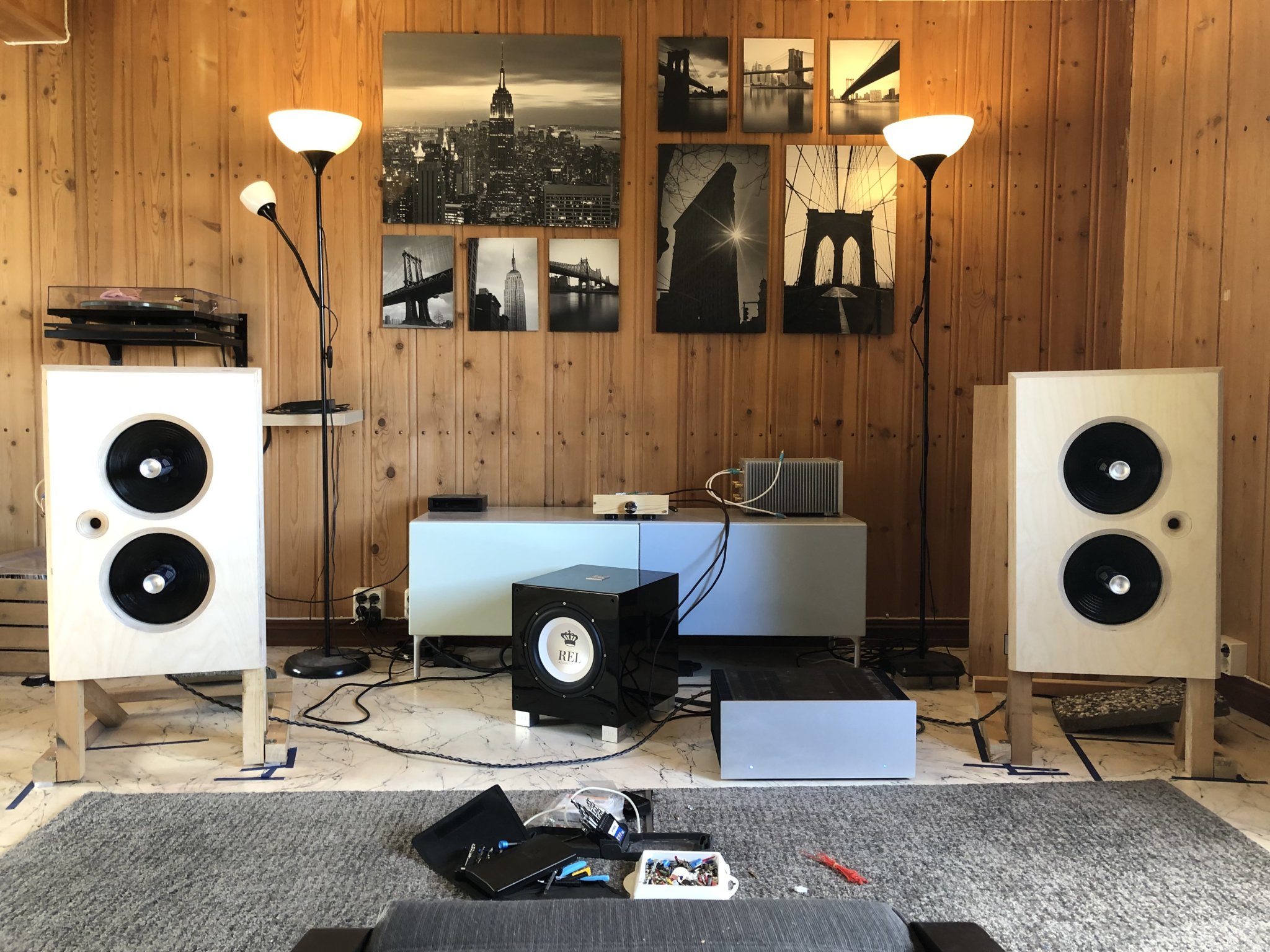

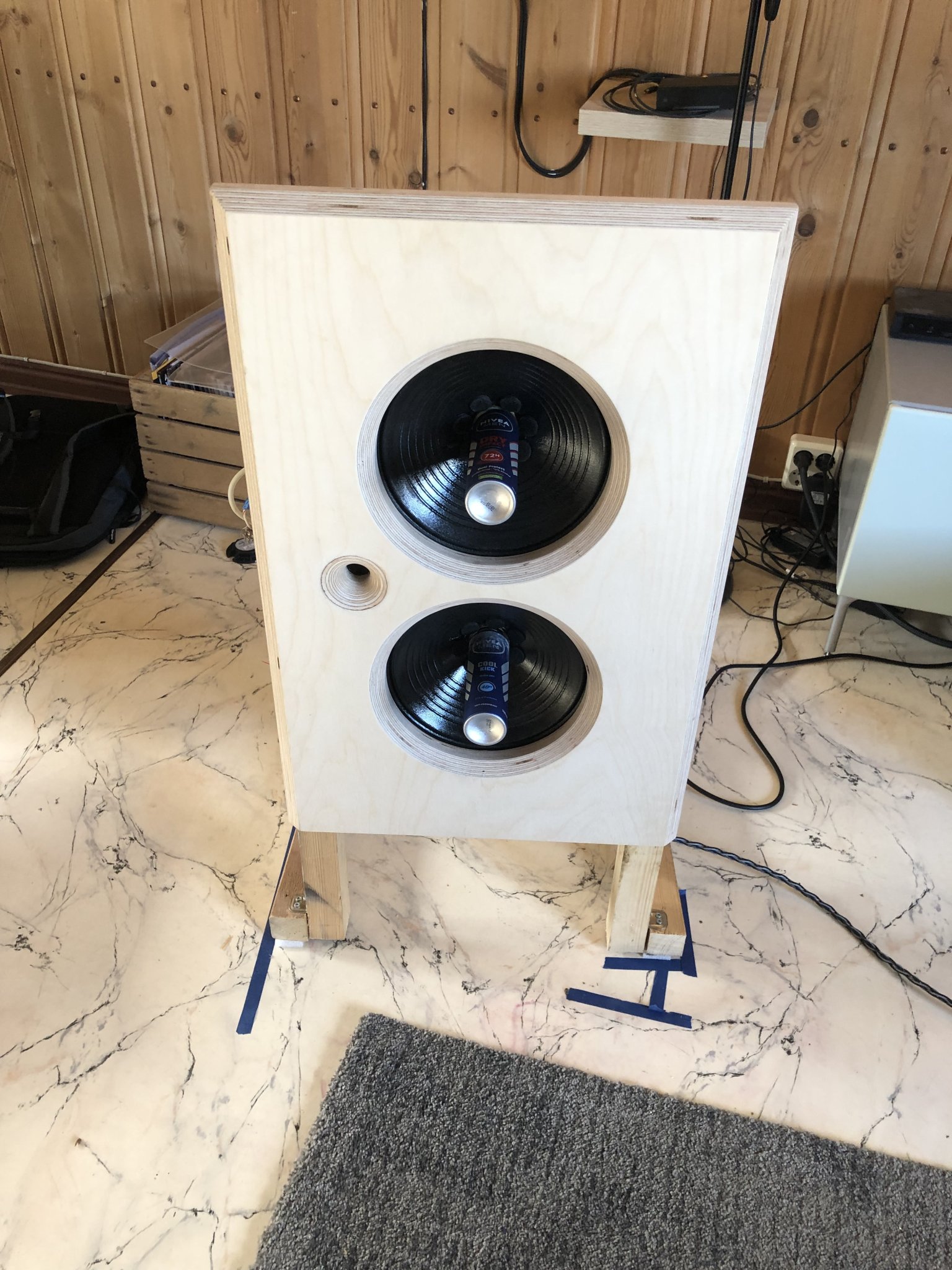

first open baffle in my home, doing some burn in on 4 celestion g10 gold, for a friend.
I’m calling them "Quattro Nivea Deo"

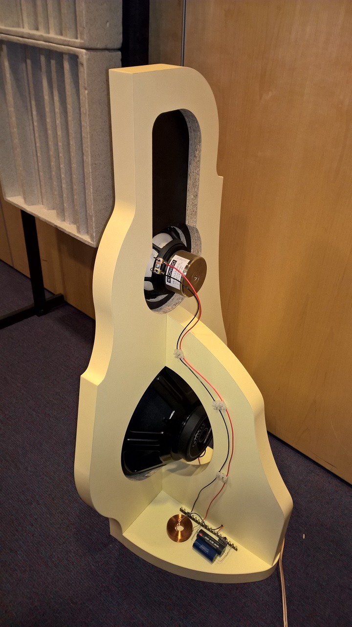

like your implementation.
looks a lot like bastanis approach
don't understand though the role of the parallel resistors, you lose a lot of dBs that way.
is that so you can have 8ohm impedance?
Is that a Sony VFET in the back? If so, maybe you should get a 6/24 crossover and bi-amp your OBs. 😎
Nivea Deo , are glued ??yes it's bastanis inspired and yes itˋs just to get the impedance down
db thats no problem 😀

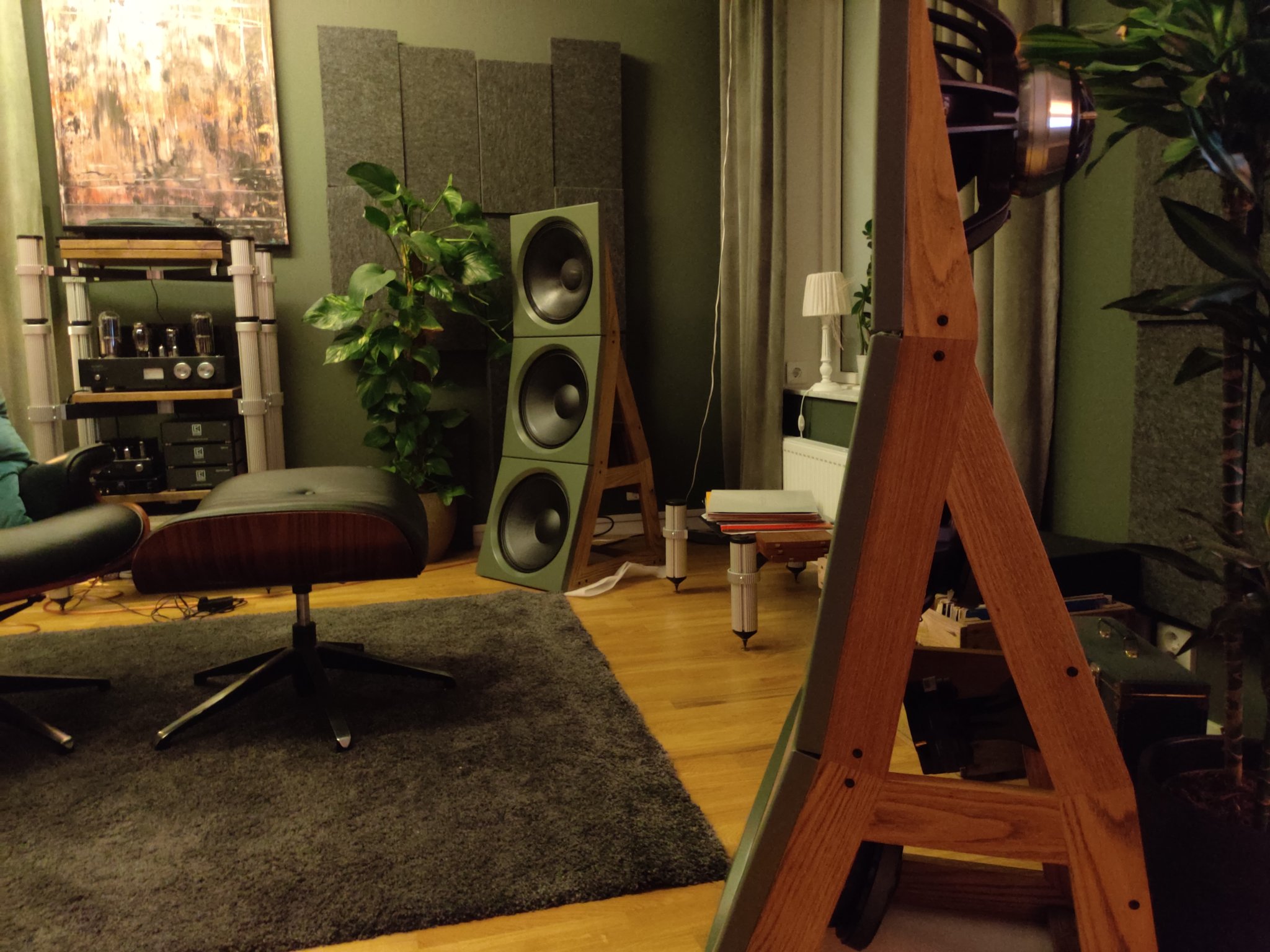

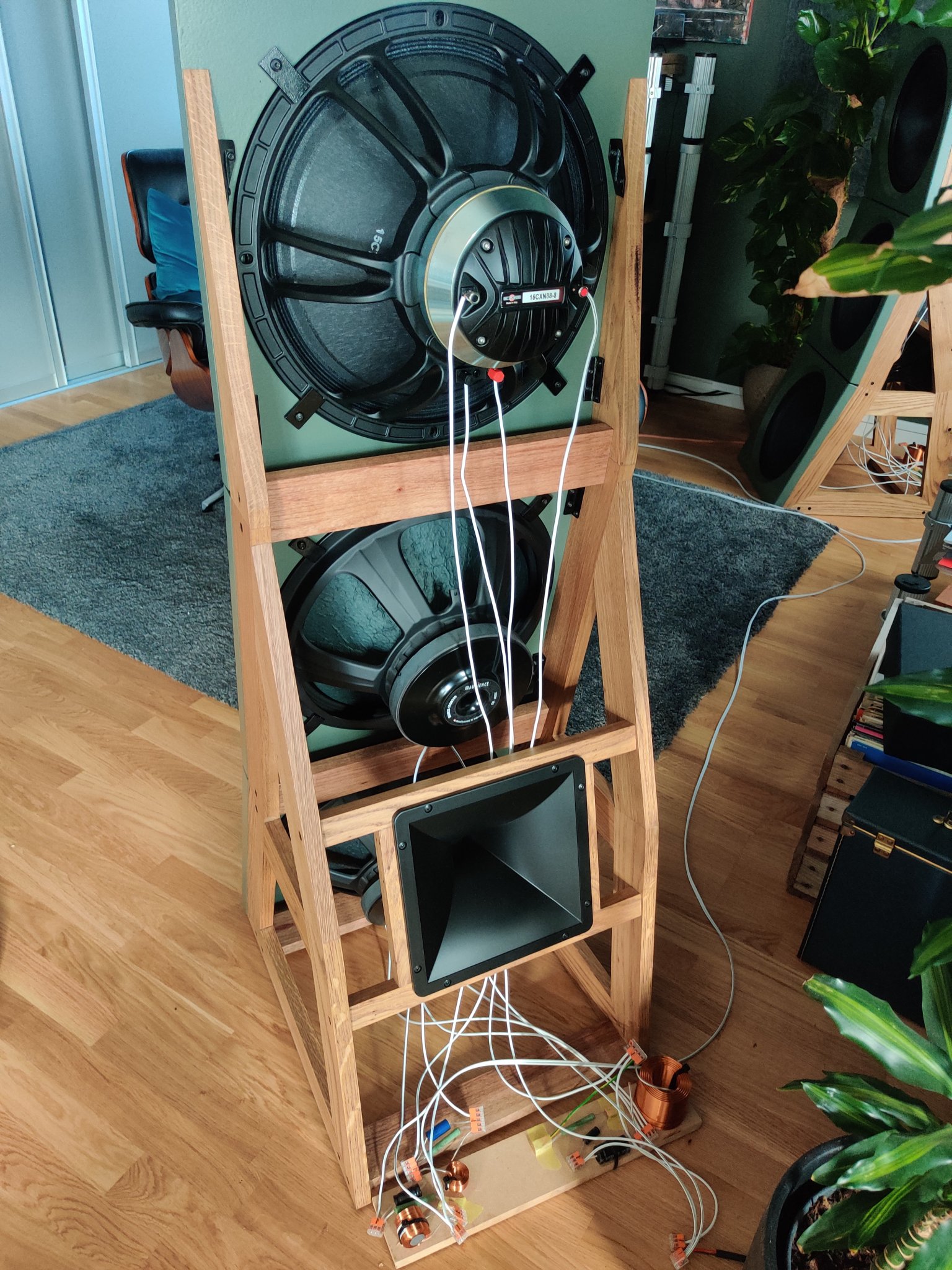

This is my version of Perry Marshalls "The Bitches Brew" open baffle. First real speaker project and I could not be more happy with the outcome. But as this is my first speaker I have built, if you have any technical questions please read the original designers notes here on the forum, he has uploaded a PDF with all info you could possibly want!
The crossovers and wiring is still not final, just so you know.
Kind Regards
Jakob P
Kind Regards
Jakob P
Excellent work Jakob! These look fantastic. I bet they sound fantastic too, I would love your comments about the sound.
@kd4ylq It looks to me like Jakob is using active crossovers and the passive that you see is only the small number of components needed to complete the design.
@Balthazarp it looks to me like you made a "pure dipole" rather than U-frame which means they start rolling off at around 80Hz rather than 50Hz, so they need a stronger bass boost than my original design. Depending on how loud you want to play your music, they may only go down to 30Hz or so.
Also, in my design I added a 6 ohm resistor to the front tweeter and increased the tweeter volume on the DSP. That raises the SPL of the rear tweeters which adds a little more spaciousness to the sound.
I have attached the MINIDSP FLEX8 CONFIGURATION FILE that I am currently using for these speakers. I use the Flex 8 now rather than the 2x4HD.
This is a beautiful design, congratulations!
The drivers are clamped down with 3mm steel pieces. You can see them clearly on the top woofer. I like the clean look from the front with no screws. Ah, I misread, the boards are secured by 4 30x30 L brackets that are 50mm long in 3mm steel. I thought about gluing for a cleaner look but I thought it would be nice to be able to modify or switch baffles more easily.Did you eschew the original biamp active DSP approach for any particular reason? how did you secure each driver baffle board to the support framework? Geart job! (I'll bet they sound awesome).
Right now I run them with the original crossover but I am using a c-dsp8x12 from minidsp instead of a 2x4hd, so no fir filters. But I have a 2x4 laying around so I am going to try that next. I have a bunch of spare amp laying around aswell so I might try a fully active version aswell.
As I said this is my first ever speakerbuild so I built it as the orginal plan (minus wings for the woofer) as a start. So I knew it would be a good start before experiment.
I absolutely love the sound. So dynamic, high detail but still soft and non fatigue. Super strong center image and wide Soundstage. The best speaker I have ever heard. I had a friend over and he said the same thing.Excellent work Jakob! These look fantastic. I bet they sound fantastic too, I would love your comments about the sound.
I was at a hifishop and listened to the Avantgarde trio system that retails at aprox 300k usd here in Sweden but both him and I thinks this sound better.
I am running a 24 db boost at 20hz, so a bit more than you. And I am running the woofers with a 2x22w tube amp and I only started to hear a little clipping after 5 hours of constant listening and maybe twice as many beers haha. So it's really not a problem. I live in an apartment so my neighbors are probably happy that I can't push the system more.
Are there FIR filters on the flex8? Or is there more advantages to having more dsp channels instead of fir?Excellent work Jakob! These look fantastic. I bet they sound fantastic too, I would love your comments about the sound.
I will have to build a pair of diffusers to place behind the speakers aswell before I try experimenting with rear tweeter levels.
