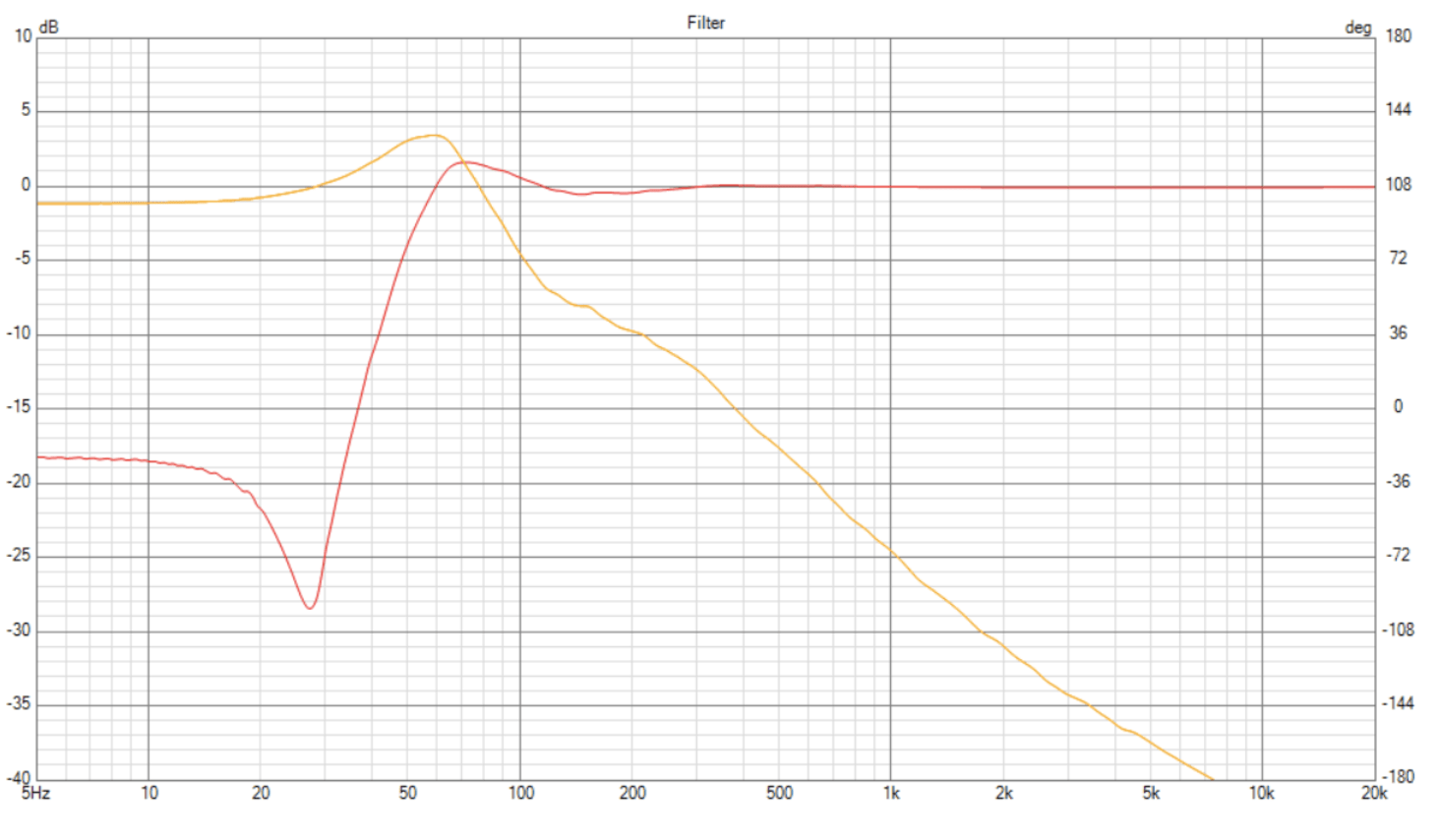

I am running a 24 db boost at 20hz, so a bit more than you. And I am running the woofers with a 2x22w tube amp and I only started to hear a little clipping after 5 hours of constant listening and maybe twice as many beers haha. So it's really not a problem. I live in an apartment so my neighbors are probably happy that I can't push the system more.

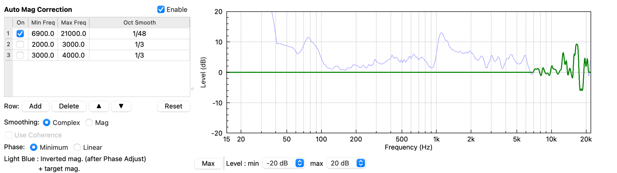

The MiniDSP 2x4HD has an FIR bank on each of the 4 output channels. I created a separate FIR filter for each of the woofers and tweeters.
The MiniDSP Flex8 has FIR on each of the 2 input channels, so it is more restricted. In the Flex8 version, I aligned the standard IIR filters so that the drivers are in correct time alignment. Then I added the FIR DSP as a final step. In the Eclipse FIR tool it looks like this:
This is one channel, the other channel has a slightly different amplitude curve because it is customized to each individual tweeter.
I have attached the Flex8 FIR correction file that generates the curve you see above and it should work on the Flex8. The Flex8 is better - the noise is at least 10dB lower, and the sound is clearer and more refined.

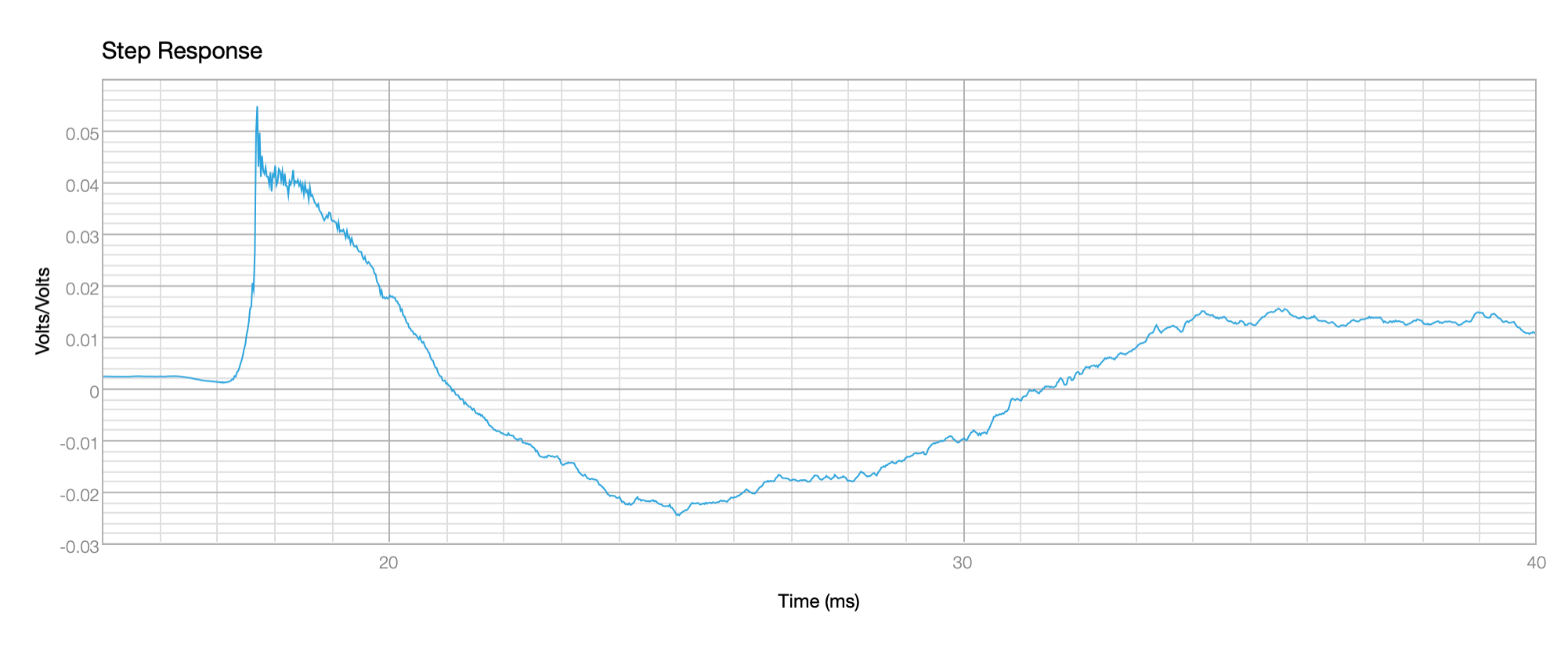

Very sophisticated filter. I was testing a little bit In vituixCAD about going with only one of the 15ob350 with the 15cxn and running the bottom woofer active to be able to put more power to it. But a new coil is almost as expensive as two new woofers and run them as pure subs.

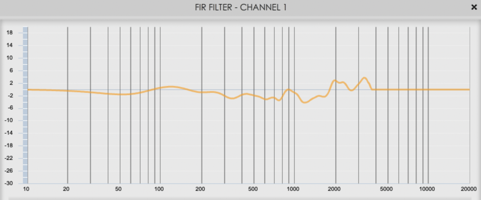

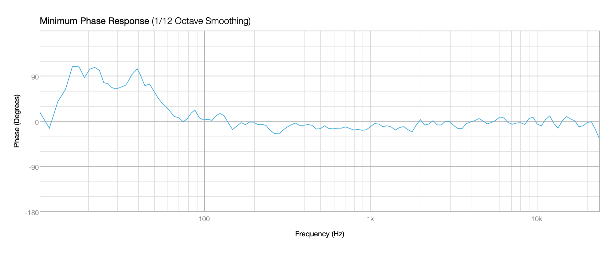

The 2021 Bitches Brew 2x4HD FIR files do a little amplitude correction and a lot of phase correction for the woofers, like this:

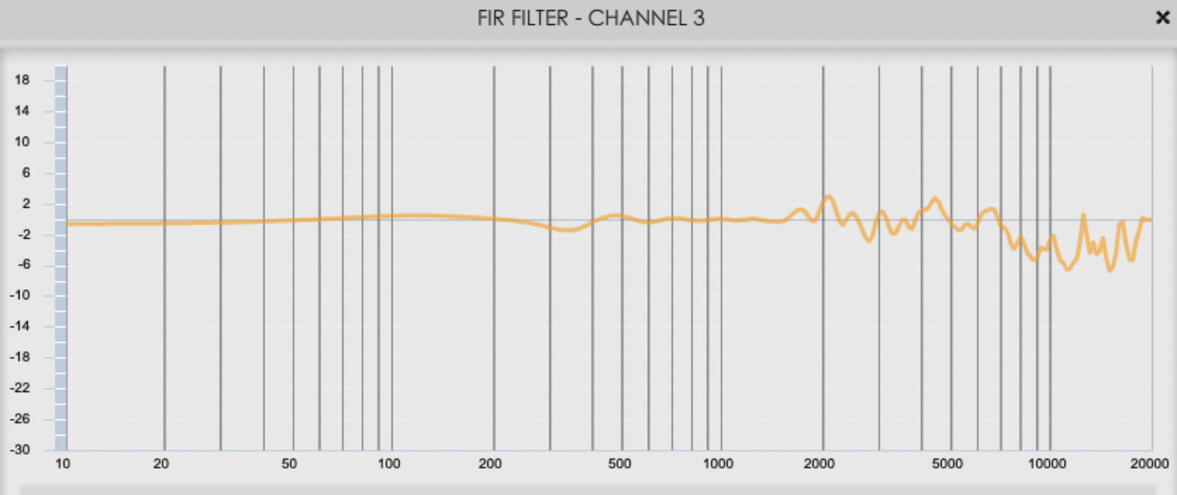

The Bitches Brew tweeter 2x4HD FIR files do mostly phase correction, and amplitude correction only in the top 3 octaves as you see here:
If you are not using any of the FIR filters then the design can still work fairly well, but you will have to 1) re-align the delay between the bass and treble sections, and 2) You may have to switch the tweeter polarity as well, I'm not sure; and 3) There will probably be some EQ you need to do.
It won't be linear phase without FIR.
I believe the system will image better and have more transparency with the FIR filters in place. I personally believe that linear phase and excellent impulse + step response is very important, it affects imaging, clarity and definition. Especially for percussion. This is the step response I measured in April 2023:
These curves were taken using the April 2023 configuration file attached, on the 2x4HD. The FIR files are embedded in this configuration file.
Note, as I've posted multiple configuration files at different times you need to pay close attention. The file here for example has the gain turned up on the tweeters (channels 3 & 4) because the woofer and tweeter amps had different gain settings. You should measure everything and make sure it's working in a way that makes sense to you.

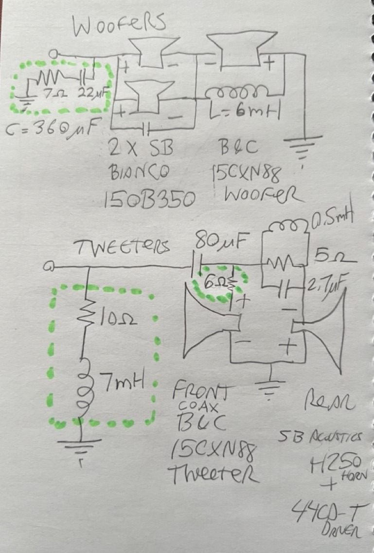

Congratulations on starting your build!!!
You need:
2 x 6mH inductors, I recommend the Goertz copper coil air core inductors:
https://www.madisoundspeakerstore.com/goertz-14-awg/goertz-cf6.0-14-awg-copper-foil-inductor/
Any kind is fine as long as it's air core and DC resistance is less than 0.75 ohm. I do not recommend iron core - not in a speaker design that's this uncompromising.
2 x 360uF capacitors, I recommend putting film and electrolytic capacitors in parallel to add up to 360uF. At least 100uF of the 360 should be film.
2 x 80uF film capacitors
2 x 2.7uF film capacitors
2 x 0.5mH inductors, any air core units are fine
2 x 5 ohm resistors 10 watt
2 x 6 ohm resistors 25 watt
Optional components for Zobel (circled in green):
2 x 7mH iron core inductors
2 x 10 ohm 25 watt resistors
2 x 7 ohm 10 watt resistors
2 x 22uF electrolytic capacitors
These flatten the impedance, which makes amplifiers behave better, especially tubes.
MiniDSP 2x4HD OR MiniDSP Flex Eight
The schematic is in my previous posts above.

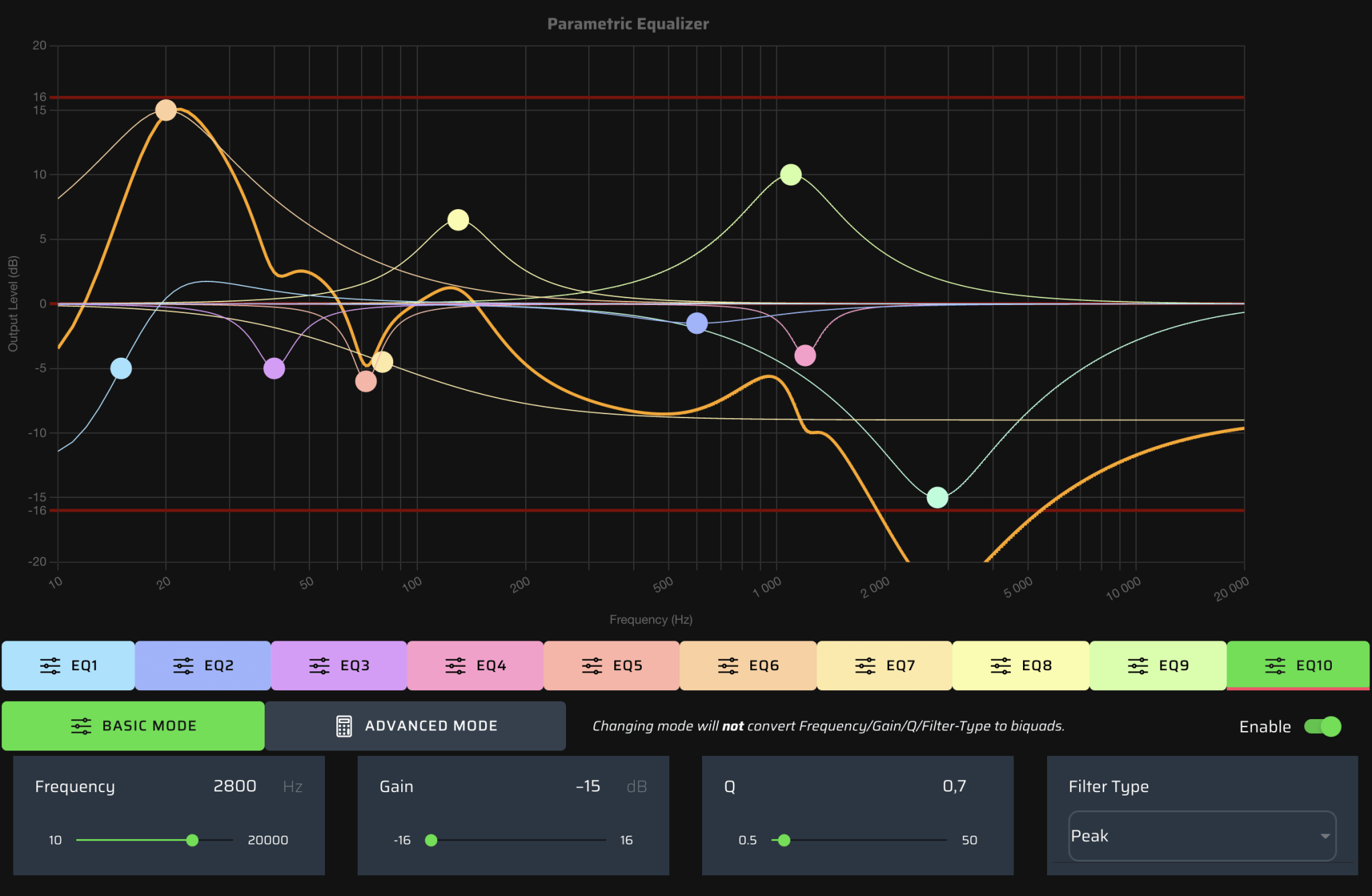

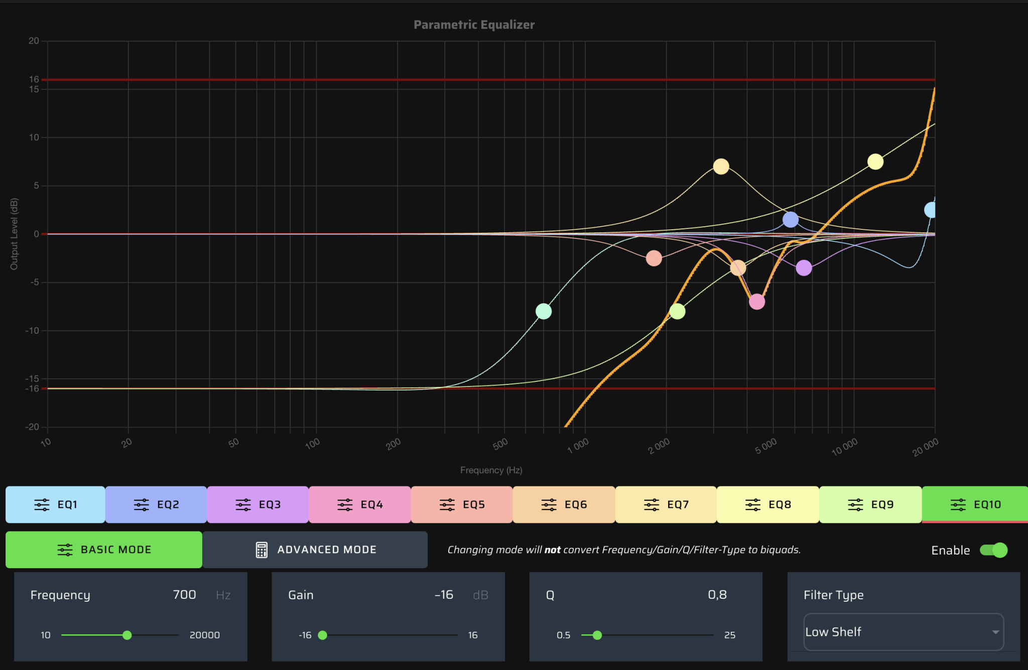

Hi!
I was meaning to respond a lot sooner to your post but I have been having fever all week and I'm still not back, but today I am at least standing up and walking around a little bit.
I was wondering a little why you are using the peq as lowpass/highpass instead of the traditional crossover section in the dsp software? Is it to have a little more control over the slopes or is there any other reason? I just think the woofer section looks wierd with response rising again in the woofer section.
I was also thinking about adding clear acrylic to cover the sides of the speaker to make it more similar to the original bitches brew, but still keep the open design. But the bass extension is still excellent in my application and listening levels. I use the Fletcher Munson compensation in my RME ADI-2 pro (digital out to dsp) to add a bit of extra db bass boost in lower volumes and to avoid clipping in my weak amp if I want to play a bit louder.
I had some other questions but my brain is not fully working, and I dont know if what I'm asking makes any sense.. I dont know how much we should discuss in this thread. Maybe better to take questions in direct messages.

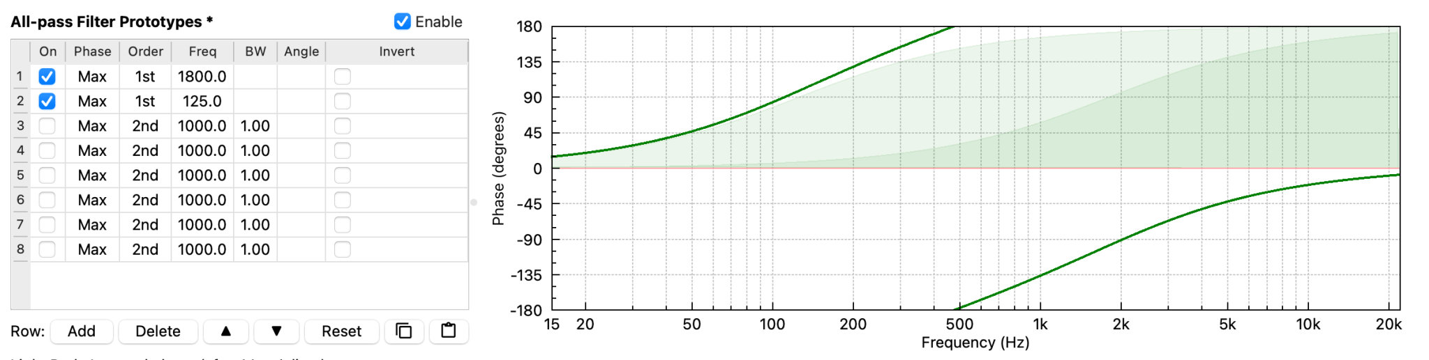

Jakob @Balthazarp Yes there is a very specific reason why I use shelf filters instead of standard filters. I explain some of that reasoning here:
https://www.diyaudio.com/community/...-pass-xovers-with-notch-shelf-filters.404415/
A shelf filter introduces HALF as much phase shift as a low pass or high pass filter.
So you're crossing over the 15CXN88 tweeter and we're looking at the range from 2KHz down to 500Hz where the level drops 20dB. A standard 12dB/octave filter would result in 270-360 degrees of ACOUSTIC phase shift. 18 or 24 would introduce even more. But my shelf filters will level out below 500Hz and introduce only 135-180 degrees phase shift.
I can't remember, I think I may have a 6dB/octave digital high pass filter on the 15CXN88 tweeter. For sure I have an 80uF capacitor between it and the amp. That adds 6dB/octave more protection. So the 20dB of shelf filtering is enough to do the job.
This makes the time alignment of everything much easier. Then at the end with FIR filters I only have to apply 360 degrees of very mild, well-behaved all pass filtering to make the entire system linear phase. With great impulse and step response.
So yes it's very unconventional but I think it's one of the reasons the system is so seamless and well integrated. It's impossible to identify the transition at the 1100Hz xover frequency and the blend at 110Hz is also very smooth and blends well.
