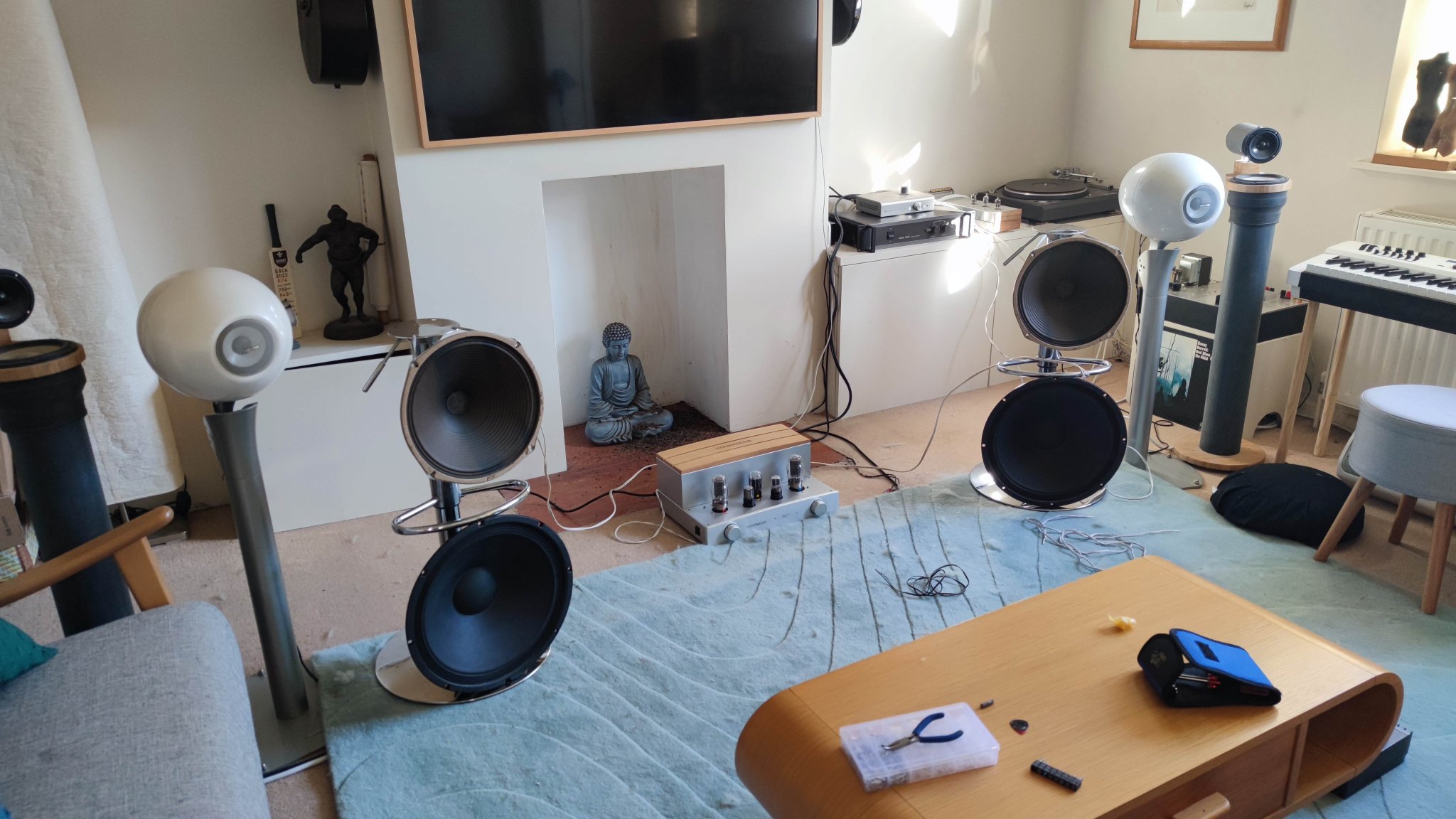

Thank you! The amazing thing is for a bodge up they work, and sound very ok. Sharpish and shouty in treble, lower mid hole I think.. and surprisingly there is some bass when I was expecting none. Very alive fast sound.
Now got to think about baffles. Was thinking of constructing a no baffle frame, but I'm now thinking a bit of baffle will help bring the lower mids and bass in. Might put some cardboard around speakers as is and see what happens..
Just sat on it some more... Stuck my head in front of both drivers... Then...
Bravely turned the 150W quad up to full whack, matching the full wack 2-3W of the Consenance, and the shout and treble sharpness has gone. The sound is strangely acceptably balanced. And still very fast and alive. Go figure.
This speaker design lark is easy peasy.. a bit of string, your two favourite chairs, bodge it up and give it large.
I just need a 300W Quad amp that goes up to 11.
#whoneedsxoversandbrains

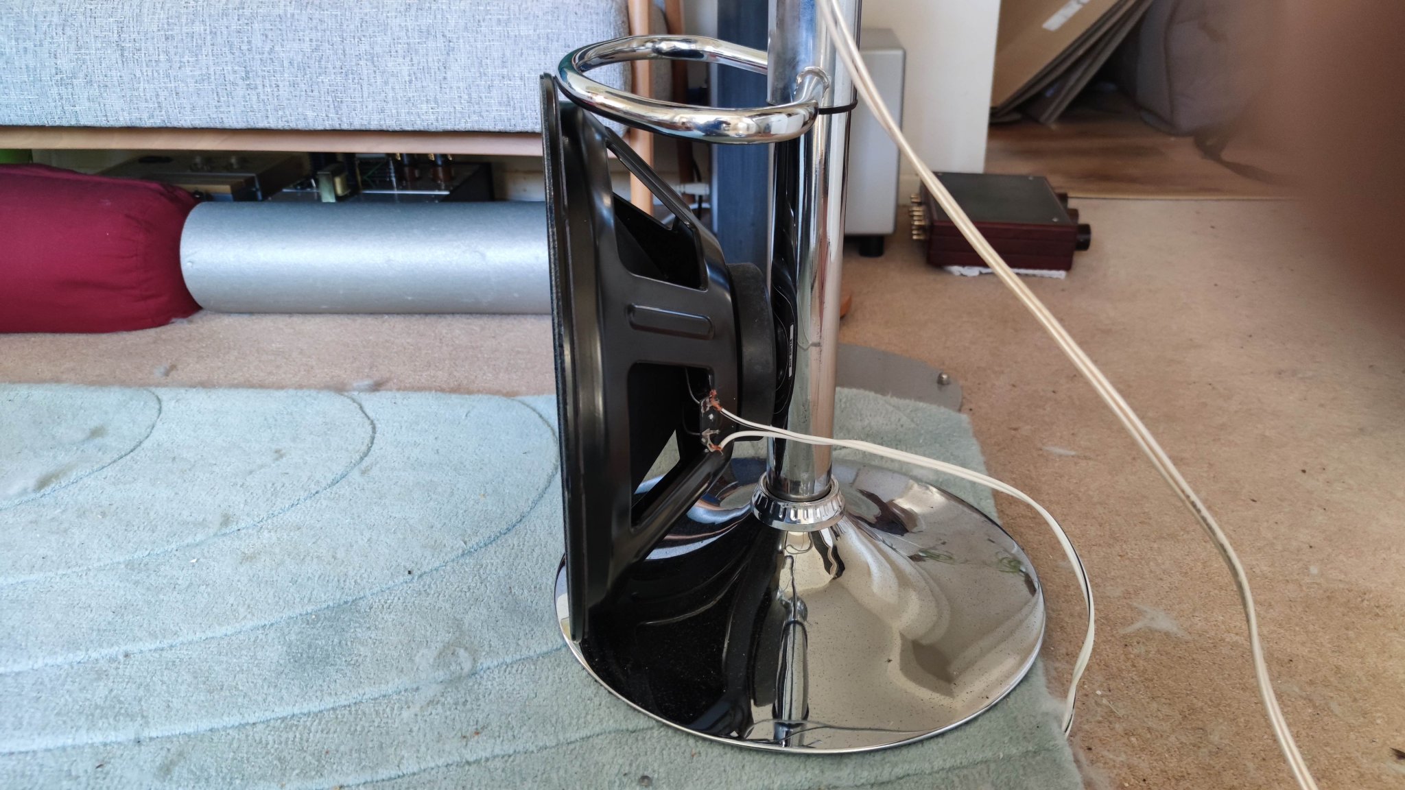

The saga continues... 2 bar stools off eBay and later..
Very pleasing aesthetically, and still just shoe laces to attach in the interests of consistent design/effort ethics🙂
Question... The alpha 15" is held on by magnetic attraction to the metal behind it. The full range also has a slight magnetic pull to the metal is against.. Is this ok?
I've googled searched, and the replies from this forum and others are very contradictory.
Thanks David
Haha lovely, and maybe you could even put the spheres on top?
Don’t know about demagnetization, but in the same case some time ago I added few inches of space between my motors and the steel pole/legs.
For the woofers maybe you could just reverse them? if they don’t play too high and if you like the look (I do).
(I kept some broken stools too, that look similar, being sure that one day I’ll build something of them. It’s cool to see them this way)

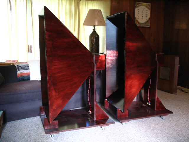

My folded open baffles. They are meant to take advantage of 360° vertical dipole cancellation for apartment living. Additionally, the baffles barely support driver output to 100 hz, which bass rolloff is steepened by highpassing my power amplifier inputs with a tiny capacitor in each channel input.
Deeper bass is supplied from an H Frame dual 12 inch driver bin.
I'm experimenting with speaker placement, no toe in, as the treated 12P drivers sound smoother to me off axis, and am trying out (again) some monopole wide dispersion tweeters, which may be turned towards me independently. There's just a single cap on each, with a -3db point of 20 kHz.
Sort of my take on two creators I always admired, Kreisel and Linkwitz.
