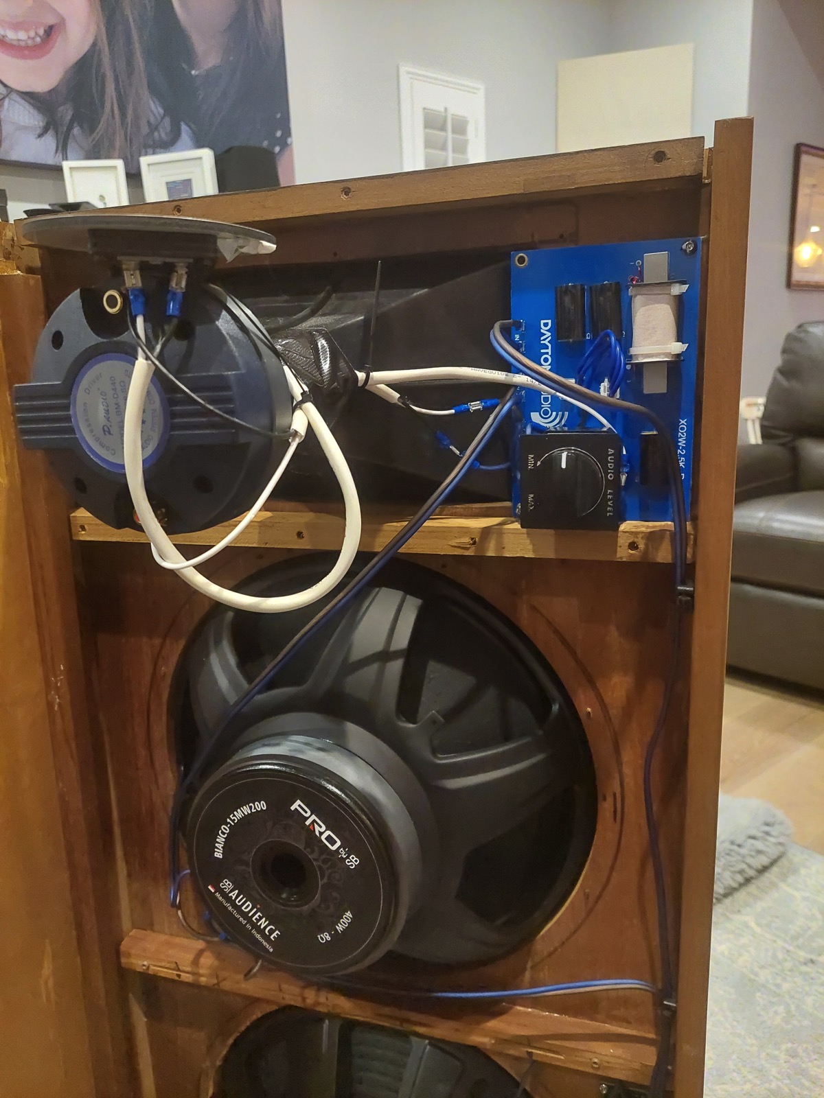

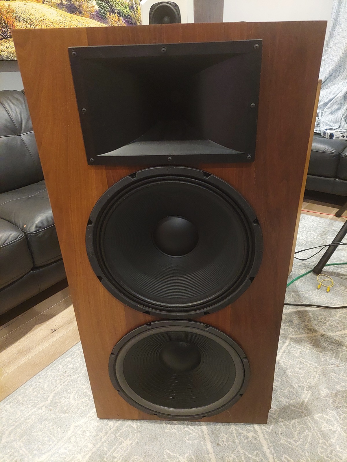

Table Stakes / 4 way OB project
Just broke in this pair of OB speakers, my first project. Sounds much better than anticipated.
Here are some details in case of interest.
1) Face is from joined IPE wood left over from a deck project. Very hard and beautiful wood. Braced in the middle and on all edges with 1-2" x 3/4" IPE strips.
2) Started with 2 x PE GRE-15 drivers. Wasn't impressed with the SQ so replaced one of them with the SB Bianco 15" from Madisound.
3) Tweeter is the obsolete (super cheap) P.Audio BMD-440 device, used very successfully in GR SuperV co-axial. This driver is stable above 2khz, but especially in the 6x8" horn wave guide, very shouty between 1-2khz.. 5-10db peak almost intolerable.
4) Put a PE 50w LPAD on it as well to dampen the BMD-440 (8 ohms @ 106db@1w).
5) After the LPAD, attenuated the with a 640uF axial capacitor from another project. Hat tip to Joseph Crowe.

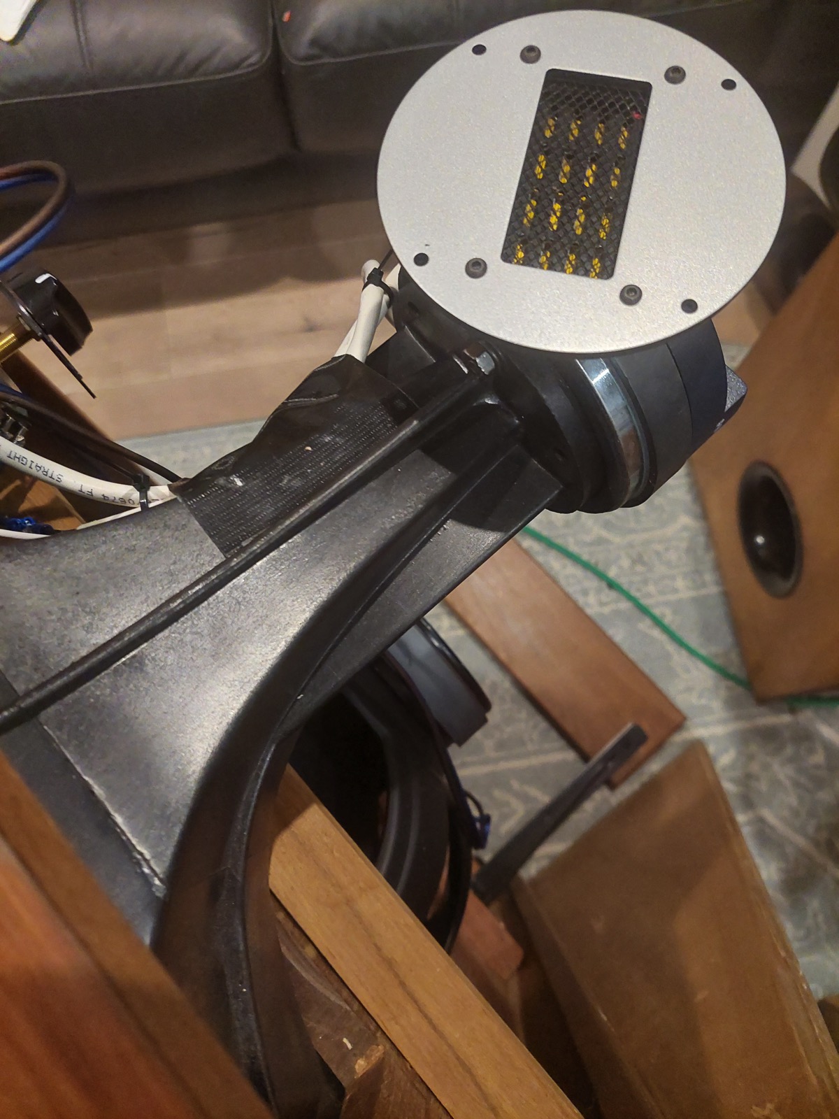

6) Running a parts-bin 40w (6 ohm) ribbon tweeter (93db@1w) magnetically coupled with the horn, facing up. Danny Richie says you want to put your super-tweeter, facing up on the same plane as the forward firing tweeter.
7) Crossover based on a stock 2.5khz PE unit.
8) Added a 300hz high-pass filter in front of the second woofer (the GRE15) so it provides only bass extension.
9) Running the dual tweeters and dual woofers in parallel, giving speaker a 4 ohm load.
9) Added small wing on one side to deepen the bass.

I guess you mean low pass on the woofer. For OB you would normally go for a too large coils in order to equalize the 6 dB loss. If you have calculated the filter for 300 hz, it will sound thin. You also need to measure. 4 Way without measuring is impossible.
It's a fair criticism. Indeed, my measurements did show that the 640uF cap sorts out the tweeter so it rolls off properly at cross-over... but...
1) I've found it difficult to get accurate bass measurements in my listening room. Yes, the idea was to make up for some of the 6db loss but the Bianco is 99db and the GRS 15PR-8 is around 87... so it's naive to think it's going to "keep up."
2) 15" is too large to cross at 2.5khz. It beams at the top of the midrange. Crossing at 1Khz to a different tweeter would be an improvement... but this tweeter won't do that.
Net-net, I think the rational plan here is to call it a day and appreciate the experiment. I've gone back to my AE boxed bass driver + ESS Heil AMT tweeter combo. Wow, it smokes...
