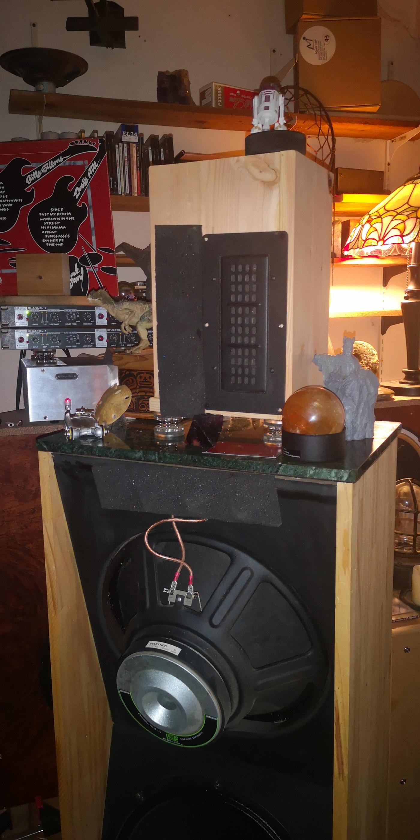

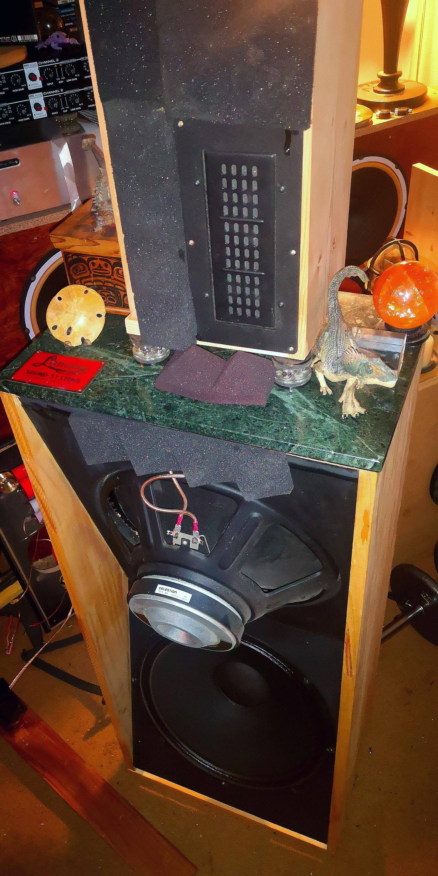

Taking your no baffle preference to heart. I did fold my baffle to minimize it's aspect facince me, for fewer reflections, and have added a little acousic foam to further reduce some room reflections towards me. It sounds much more like the plain Neo 8 mid-tweeter perched atop the woofers' W Frame.
Since I'm again crossing as low as 700 hertz at times, a little baffle support is needed for my preferences.
It shouldn't be enough, but I'm guessing the woofer structure below helps out a lot.
This is as large a baffle as I want to use up top.

I applied more open cell acoustic foam to the Neo 8 front baffle face.
The pretty large speakers image like champs now.
Got the idea partly from here when someone posted about a lossy woolen baffle, and an old Audio Ideas Guide Andrew Marshall product I read about many years ago, stick on foam oval rings called imagers, designed to surround tweeters.
This change to me has the benefits of an earlier try with no baffle, with the addition of more dense and even levels of frequencies within the passband of the Neo 8 drivers.
Plainly- I can't hear the crossover point between the dynamics and the planars.

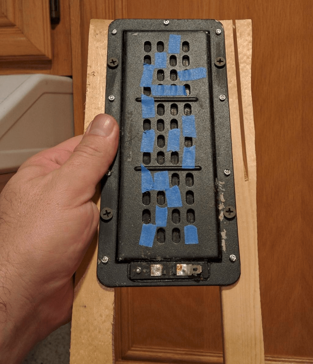

I've tried on my system a similar solution, with some felt strips in front and back of both neo8 and neo3, but then removed because the sound began to lack "air"... now I've try a different solution, closing some casual holes in the back of both neo8 and neo3 as you can see in the follwing picture (is not mine idea, I've copied it from the Thread "Phase Plug for Planars" by mister Patrick Bateman, found here https://www.diyaudio.com/community/threads/phase-plug-for-planars.303785/ :Third kick at loading
The new added foam baffle.
These solution seem to work very weel, the sound is much more smooth...

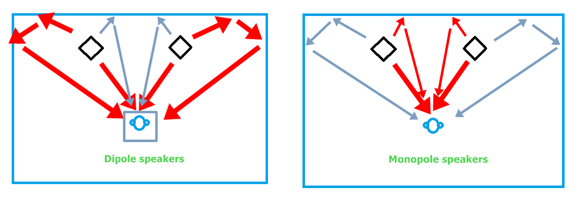

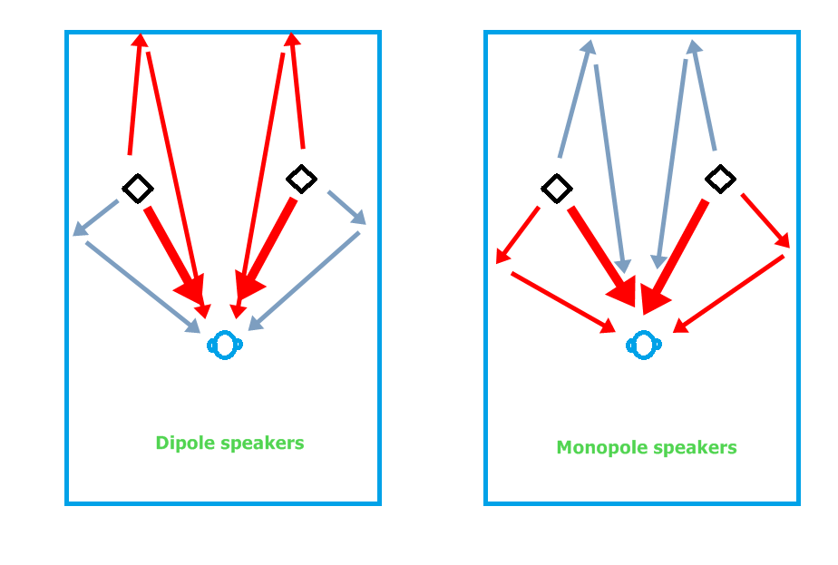

In general, dipoles to give their best, will need late backside soundwaves to get reflected to the room and the ears of the beholder! This means some open space and reflective surfaces. Turning speakers eg. 30deg inwards will help too. Corner placement doesn't work so well, reflections come too early to add "space" in sound.
please at least try a backside tweeter added. Room response will get smoother and total sound image more coherent. Been there, done that, before going to Neo3 dipole planar tweeter...
