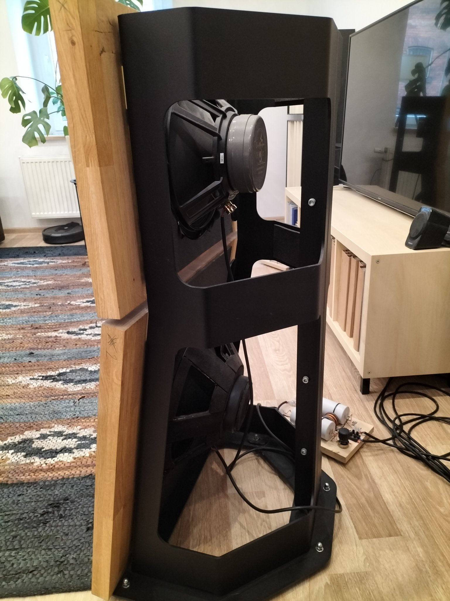

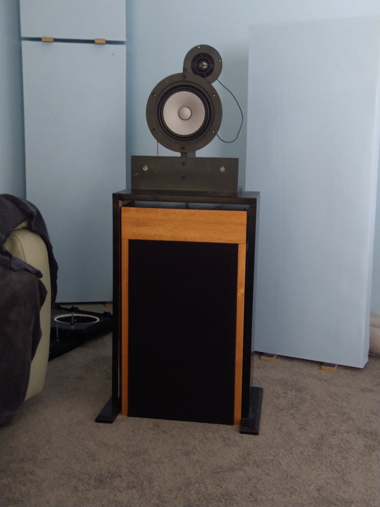

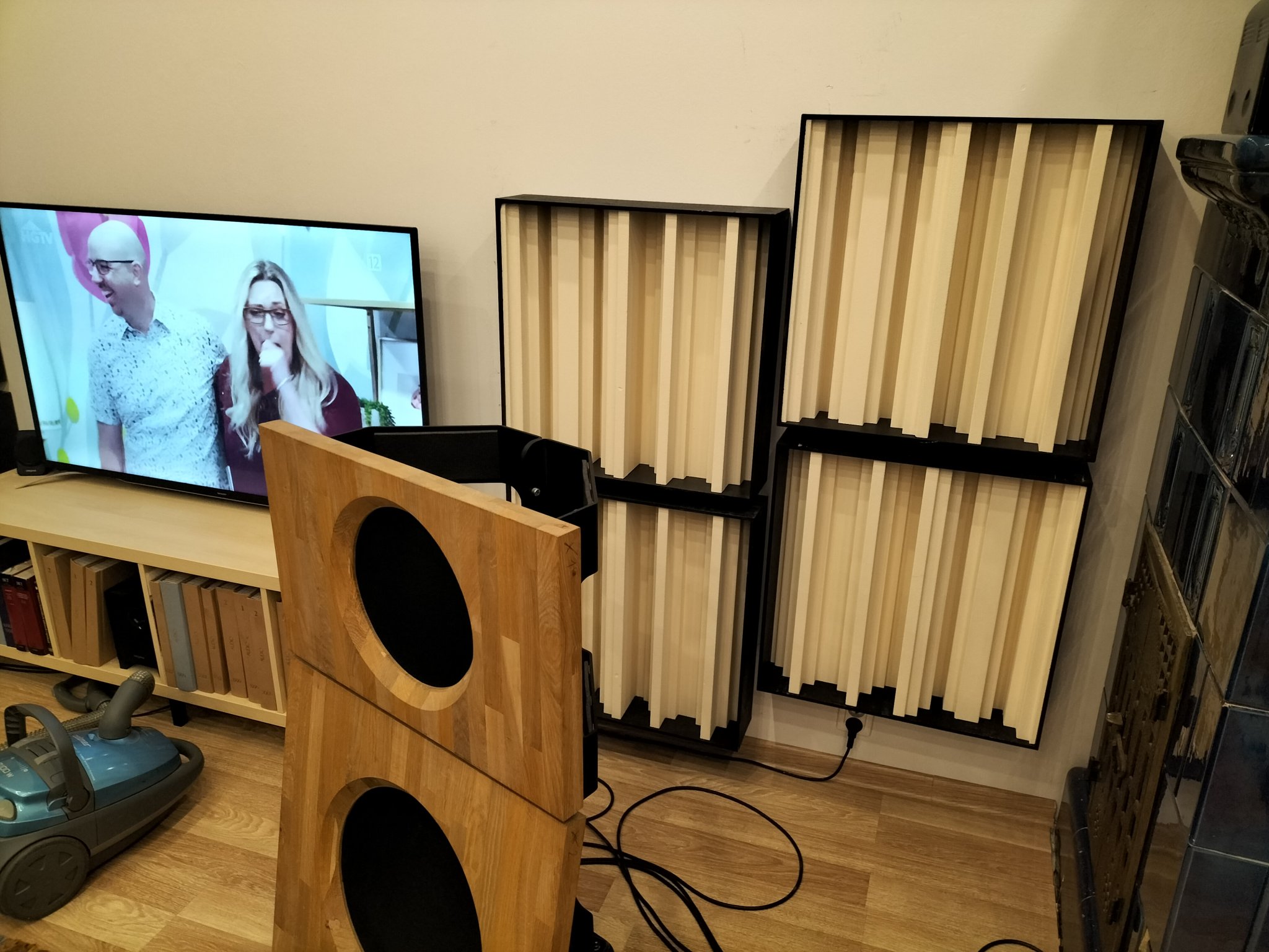

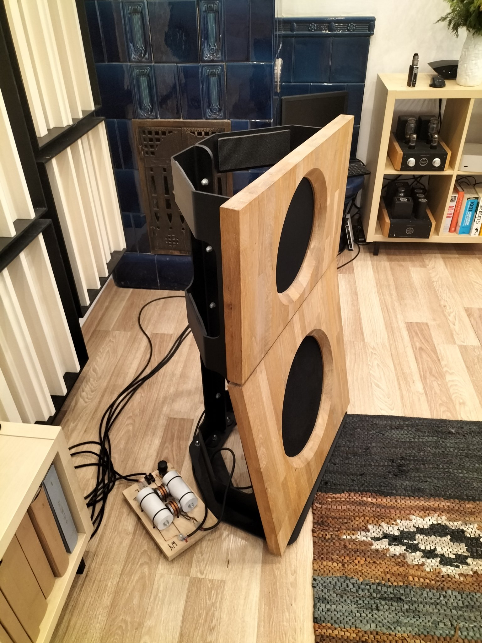

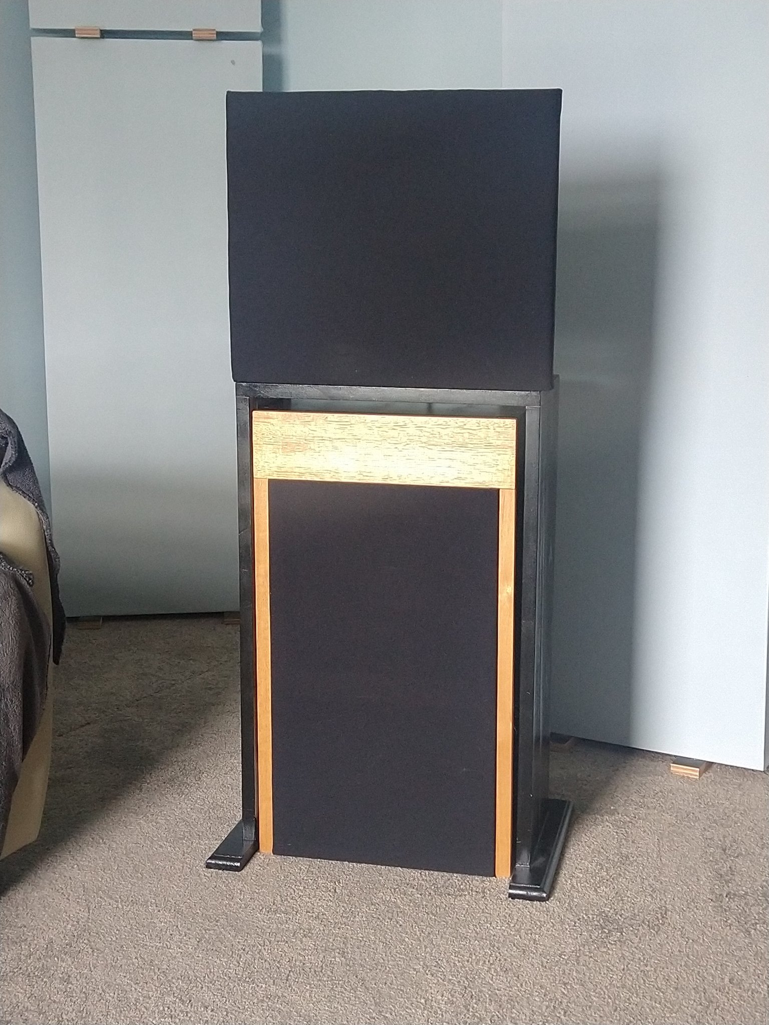

Been experimenting with baffleless. These use Mark Audio Alpair 12p, XO at 250Hz to 2x Visaton W300 woofers in a W frame.
Removing the 12p baffle improved imaging but added a hole in the frequency response between 225-500Hz as the 12p rolls off naturally at 500Hz so the XO was changed back to the DSP and some EQ added as well as a cheap tweeter I had in the parts bin.
This change has me thinking now about engineering totally baffleless OB's including the woofer. The conclusion is even the small baffle of the 12p was colouring the sound.

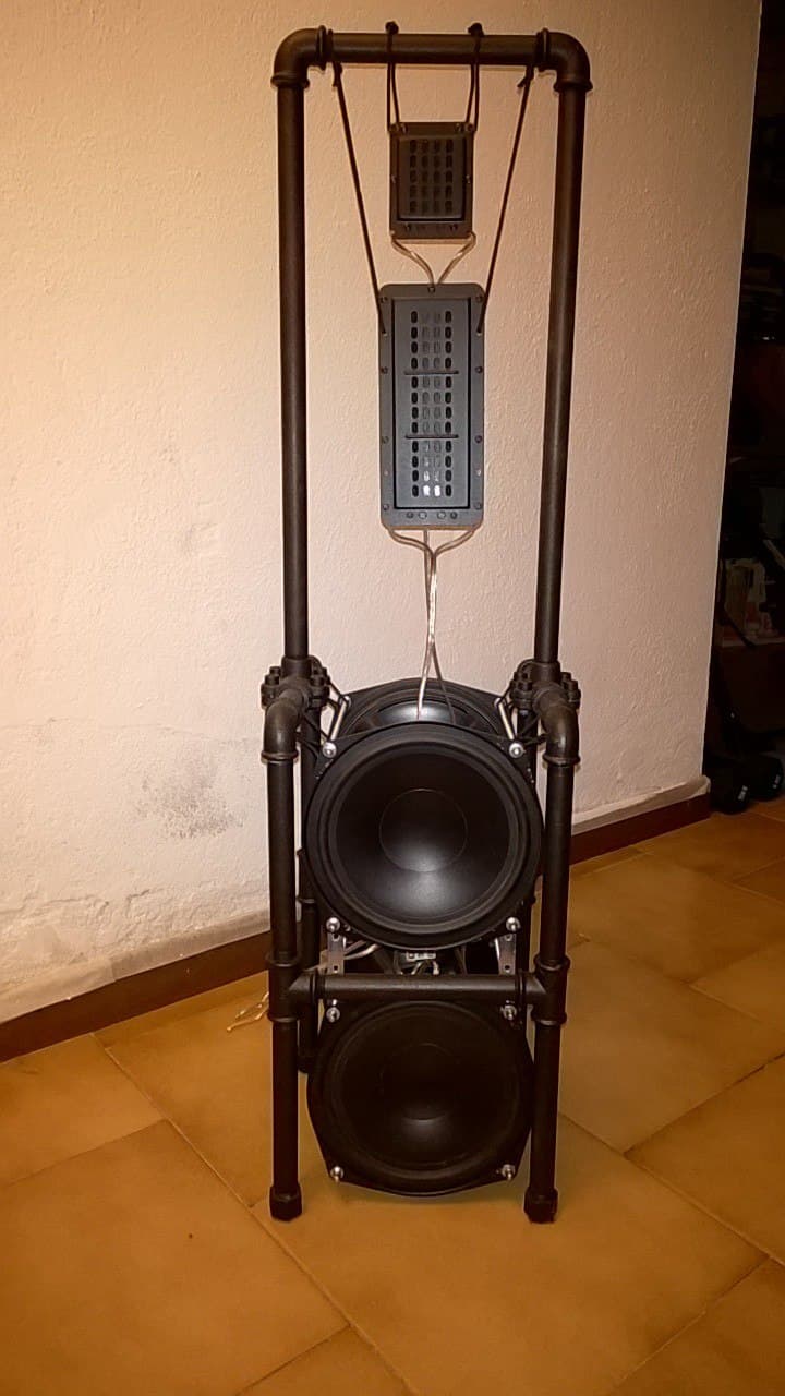

I've made a similir system, but with alpair 6P and 2 and then 4 visaton woofers WS 20 crossed at about 500Hz, but the 6P was too small to manage the power required for decent level without baffle and lack high frequency. Also the WS20 as no good power handling for low frequency, too much distortion, as so I've decide to invest for a definitive woofer (AE 15") and mid-tweeter (neo 8 and neo 3)...
Following an intermediate experiment with 4 visaton in quadrupole configuration:

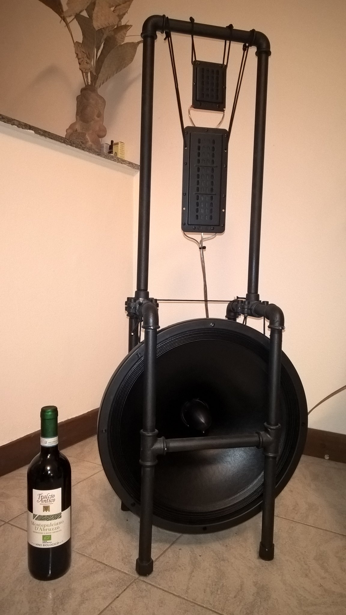

No, there isn't any hidden sub...infact they don't go as low as 30Hz! With 4 visaton I was able only to play music at moderate volume, otherwise the distorsion grows up very suddenly. The crossover was 800Hz for the visaton/neo8 and 7000Hz for the neo8/neo3.
Only with my last configuration with AE 15" dipole woofer I was able to play at higher volume and go down to 40Hz... :

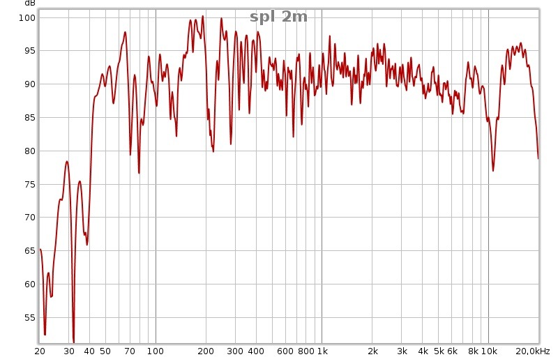

Here are a measure I was made in my living room at 2m from the neo8:
The crossover has now a notch filter on the neo, but the notch is too much and not well centered on the neo's 12kHz peak! I have to refine the crossover, perhaps in the next days...

Yes I agree, I heard a set of baffleless speakers a few weeks ago and the imaging was outstanding. The system I heard was a highly modded LP12 and the XO was DSP with EQ. Still it sounded awesome and has spurred me on to make baffleless speakers.
I use 2x Visaton W300 woofers per channel and these will be removed from the W frame to remove any potential reflections from the cabinets.
The DSP makes it easy to trial different XO frequencies and add some EQ. Although I try and EQ with driver choice and XO frequency, I am thinking this will not be possible with totally baffleless as the 300-500Hz band is very difficult to fill in without EQ.
I have infact the same issue with baffleless midrange: initially I'll try to cross them very low, about 300Hz, but with no good result: too much distortion at normal listening level. So I decide to cross them at 800Hz, where the lack of the baffle begin to appears, but for that reason is mandatory to have a good midrange from the woofer, that's why I decide to go for AE 15" woofers, they have a very very good mid range with very low distortion. I use them up to 1,5kHz and they sound absolutely good.

I am interested in details of this measurement. How much power did the AE15 need to make this SPL. What crossover are you using for AE 15" to the Neo 8
