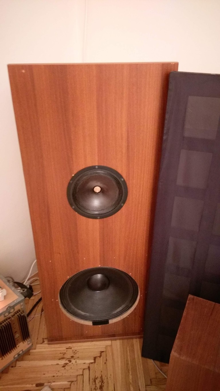

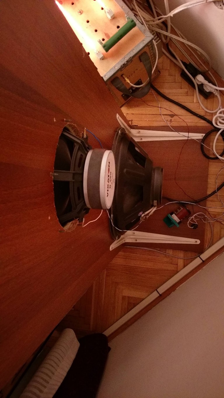

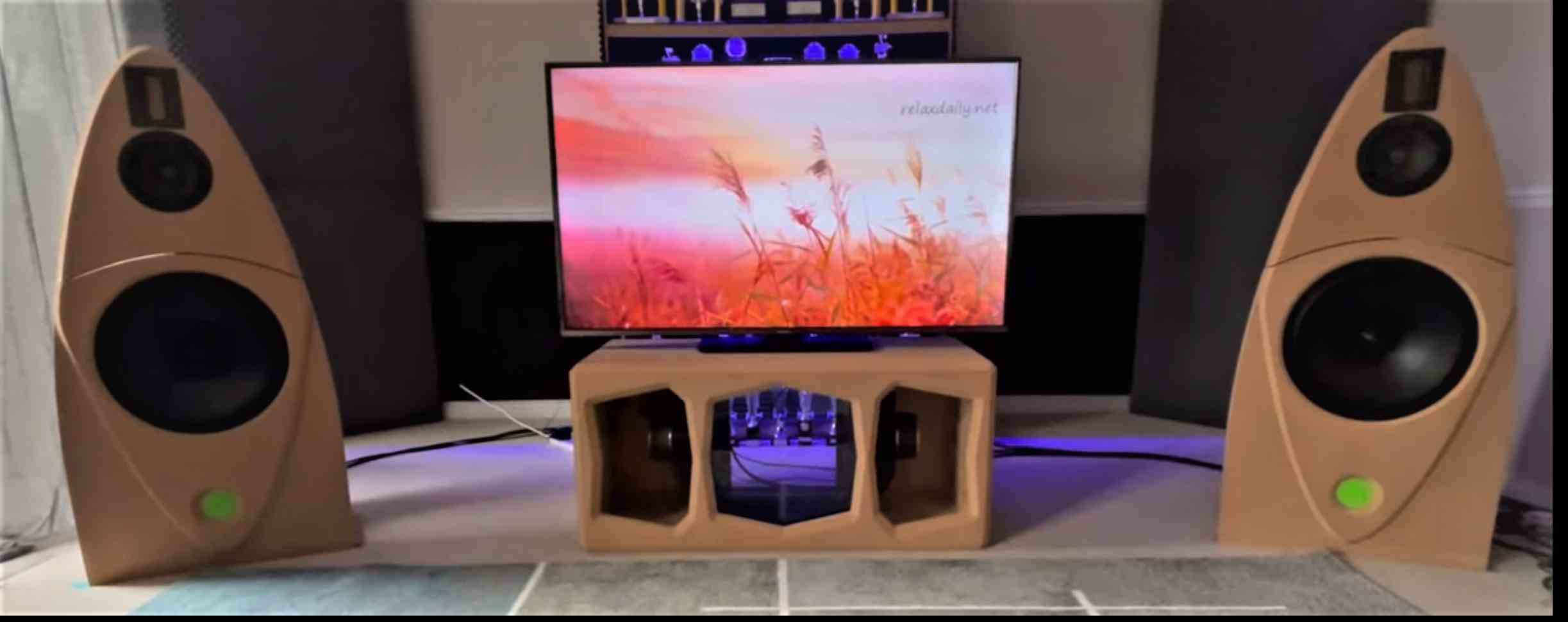

Here is my latest open baffle design/build.
Drivers are Beta15a, Seas U22 and Aurum Cantus G2si and there's a second tweeter on the rear as I prefer that to just a single front one.
My previous OB which was on a single, larger baffle used open-backed Mundorf AMT with Seas U18 and Alpha 15a and though I like the Alpha very much but the Beta does seem to sound cleaner. Overall the sound is very smooth, clean and transparent :cheerful::cheerful:

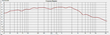

Very nice build and woodwork! And frequency response.
The octagonal U baffle around the 15" seems to be working very well. How deep is the "U side" measured at the middle point from one of the octagon sides? Eyeballing, about 8" between small baffle, octagonal frame, and back wings?
Nice way of hiding a relatively large baffle from non-audio eyes! 😀
Nice way of hiding a relatively large baffle from non-audio eyes! ��
Thanks. If I understand your question correctly the internal depth (front to back) of the octagonal sides is 6". The baffle is 1".

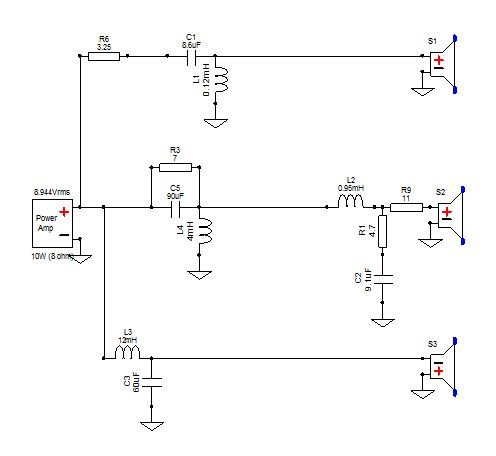

TimA,
Can you please share some details about the crossover?
I would like to know how did you manage to get satisfactory bass with a passive crossover and Beta15?

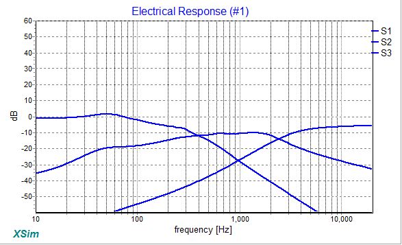

Here's the Xover. The electrical response in my original post shows the resultant bass contouring. Its possibly worth mentioning that the Beta cone has been treated with pva though I don't expect this has altered the bass performance significantly. My sub's roll in at 31 Hz with a 24dB/8ve slope and the bass is simply the best I've ever heard.

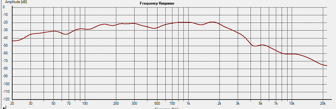

Here's the raw (smoothed) Beta 15 when measured at 1.5m and mounted in my octagonal O.B. Also the filter response.
The upward sloping filter response does a pretty good job in compensating for the downward sloping Beta 15 response. Slightly more compensation is possible if necessary by enlarging the shunt capacitor, at the expense of reduced efficiency of course.
