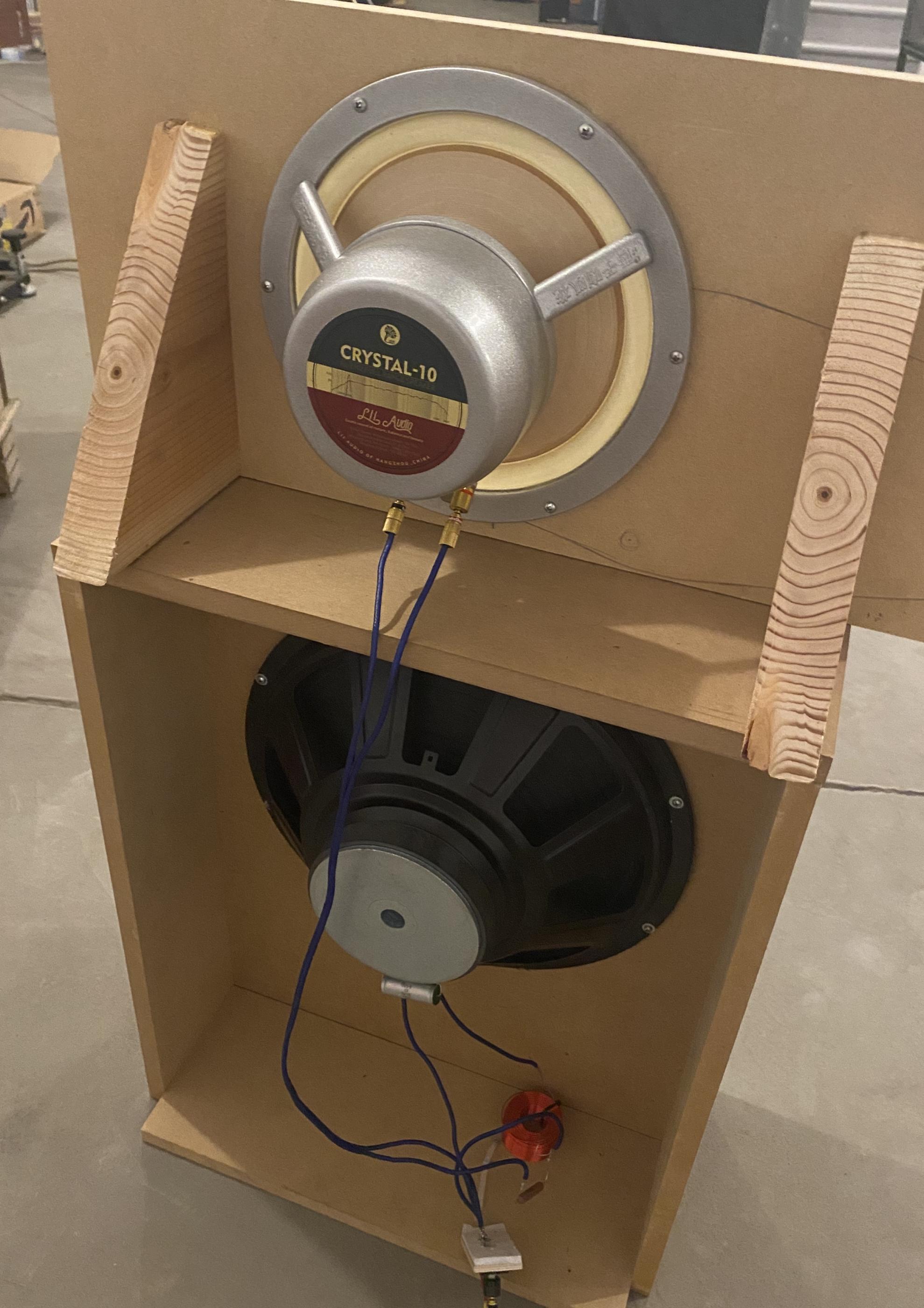

An update on my post #2810. I've swapped the Mini-K's out for some Lii Audio Crystal 10's on OB. So I'm all Open Baffle now! Loving the sound out of these paired with the GRS-15's. Planing on building a more permanent, solid wood baffle system with dual 15's on each side soon. I might even work on finishing the basement too. 😉 Stay tuned!
Hi Jwjarch,
May I have picture of your speaker from behind.
And what is crossover point. I do have Crystal 10 and try to find a minimal baffle size to get it down to 120Hz.
Thank you.

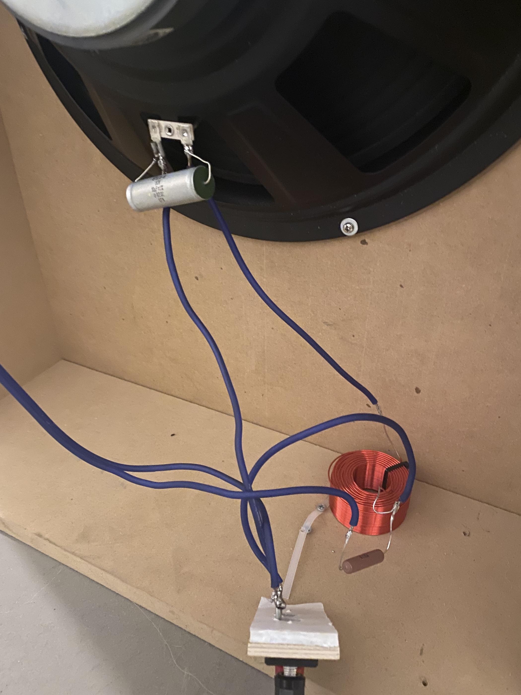

@bitinhvi - Here is the back of my baffles. These were very rushed and literally used scraps I had laying around the shop. I have to go back and check the LSim I did but I think the cross happens somewhere around 150hz. I have a 4mH inductor on the GRS15 along with a 10uf cap across the terminals to roll the highs off a little faster. The Crystal 10’s are knocked down a bit with a 15ohm Mills resistor. Sounds very balanced even in my 1,600 square foot open basement. I hope to do some quick measurements one of these days but my time has been stolen by building amps and preamps lately. Just finished a Pearl 2 and B1 Korg. Currently working on Zen Mod and EUVL J2 clones. 😀

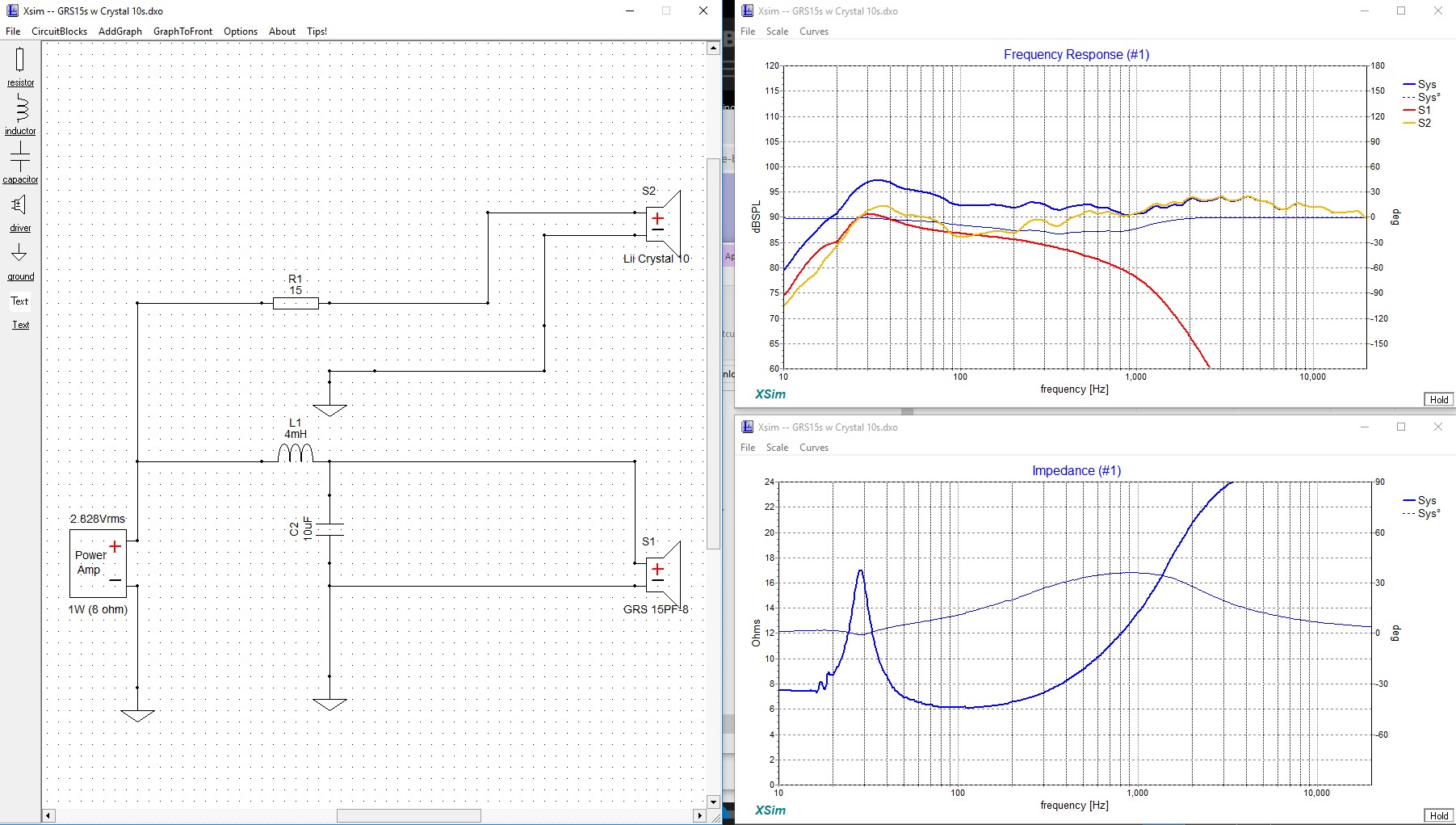

Here is my Xsim. The "crossover", if you can call it that, is at about 150hz. I didn't put a high pass on the Crystal 10's since they are reported to be able to handle lower frequencies and I think they probably roll off on their own on the baffles I put them in. For now everything seems to blend very well, although I will certainly experiment more in the future; after amp builds, and building a dedicated listening room. 😉

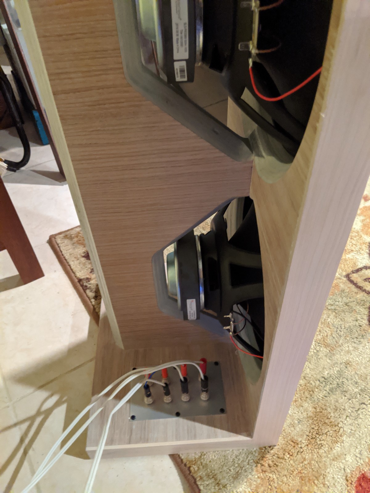

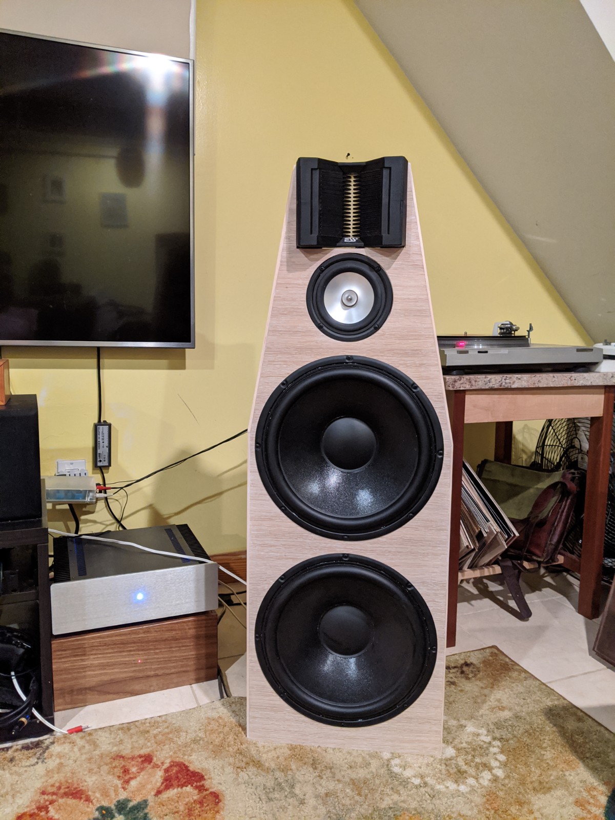

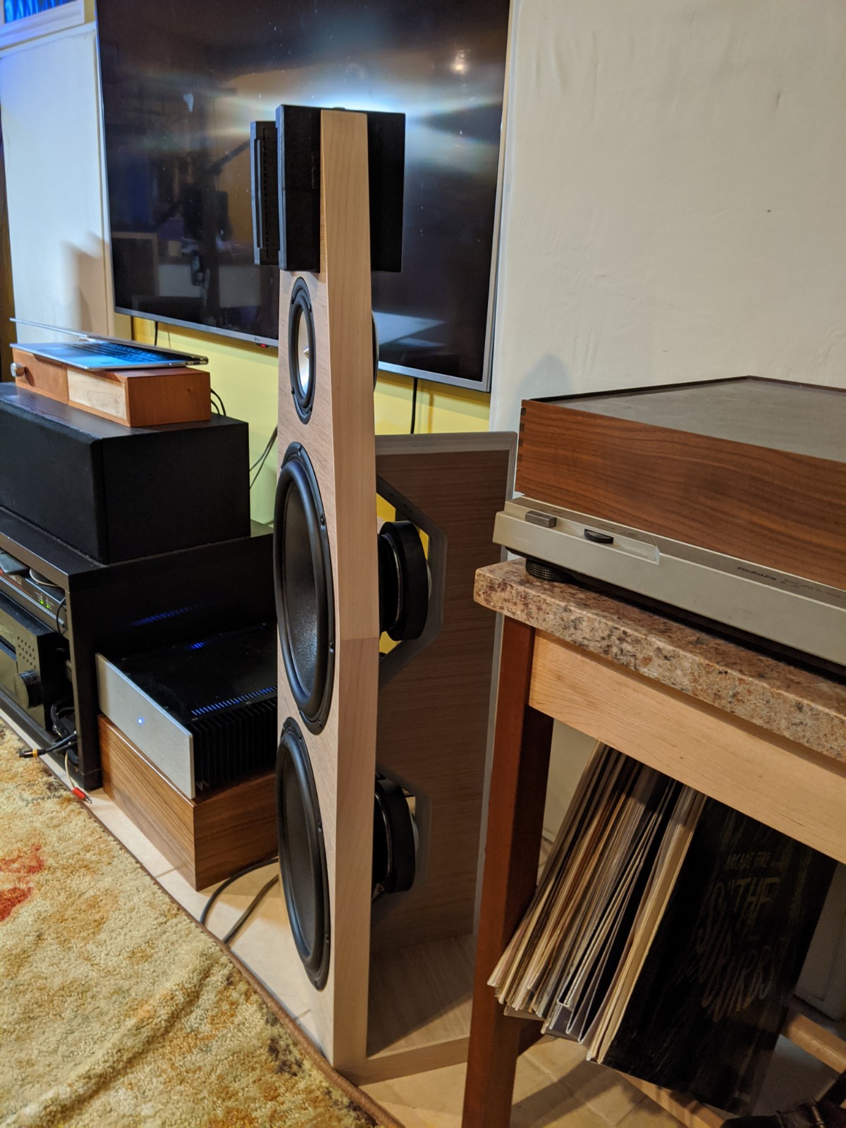

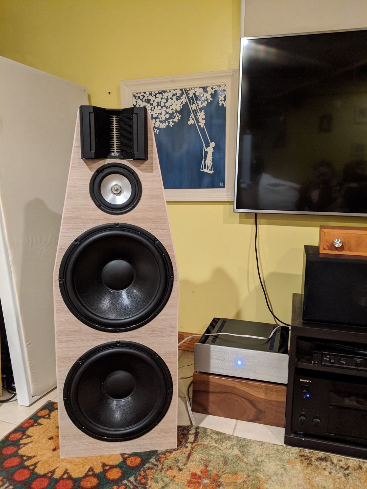

Finally done my latest OB
The drivers: Heil AMT II tweeters, zaph audio 5" mids, peerless sls 12" woofers. Crossed at 200 & 1200 with an active crossover by xkitz.com.
Amps: korg b1 Preamp, pass F5s for mid and highs and a Carver AB class I had around for the lows.
Baffle is rift sawn white oak 1.5" thick ply finished with liming wax and tung oil. I've just cast tinted gfrc bases but they are still curing.
Sounds great! Low end starts to slope around 60 but still very lively and responsive through the whole range. Might play with some low end boost using a balanced equalizer I have.

I think those dual 12" woofers can take a little low end boost without a hitch.
You should be able to reach 40Hz.
Try moving them as far away from the wall behind to find where it extends best

I put the equalizer in the signal path for the bass. Works like a charm!
