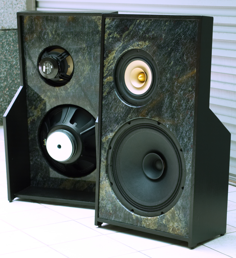

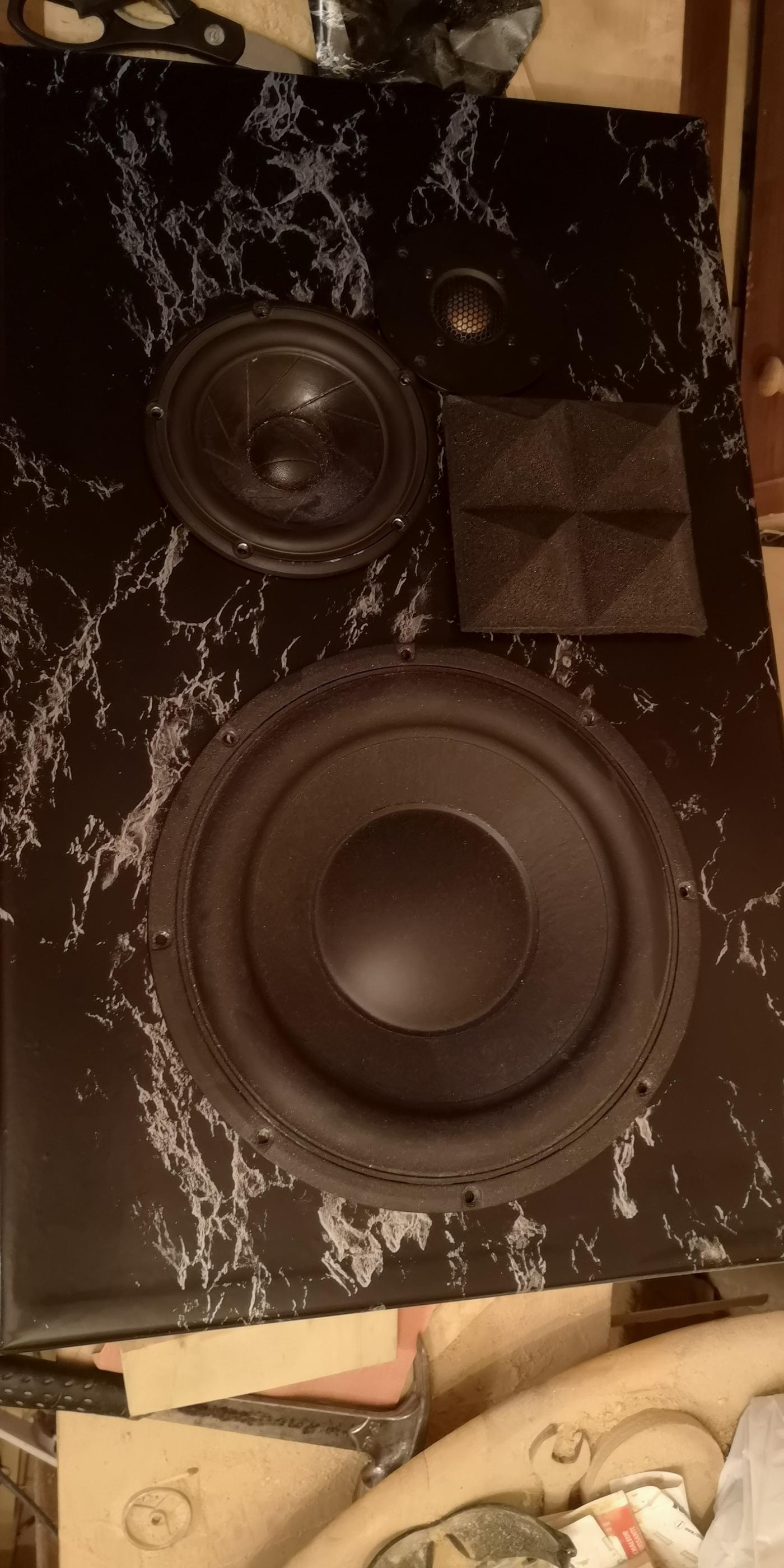

Playing with some really inexpensive faux black marble self adhesive sheets now. This one's almost ready for some wood trim.
The 15" is called indeed a full range, but it starts dropping at about 8kHz. It is crossed at 350Hz.
It was the highest Qts woofer I could get (0.8).
I had thought about doing a surgery to remove the whizzer on the big woofer, but I do like the visual of the two drivers having whizzers, although not contributing anything other than cosmetics with the big one.

That makes sense. But often when you have a big fullrange you need a short xmax, that's why I'm a bit surprised. But if you don't push the low end, you don't really need the xmax.

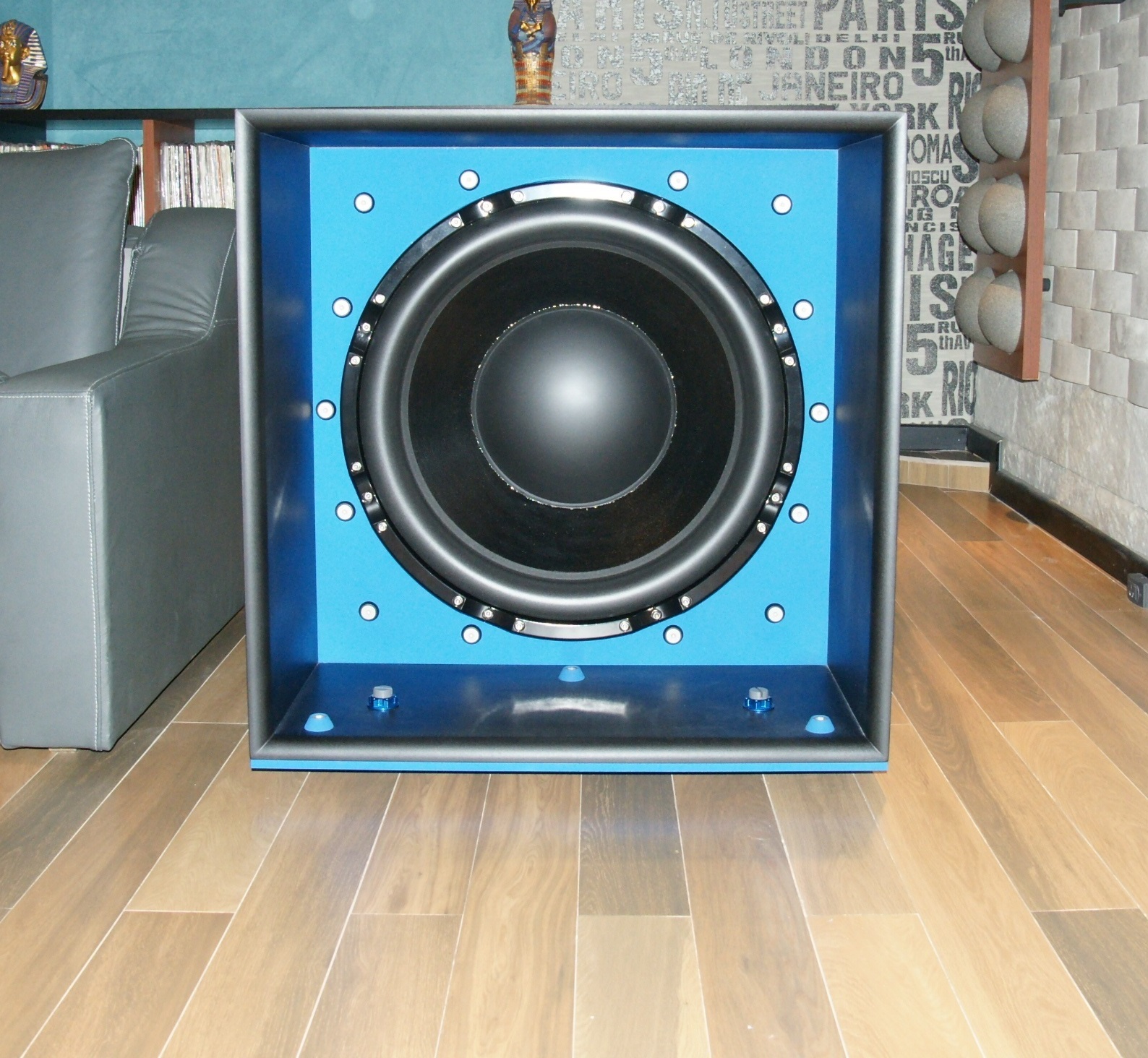

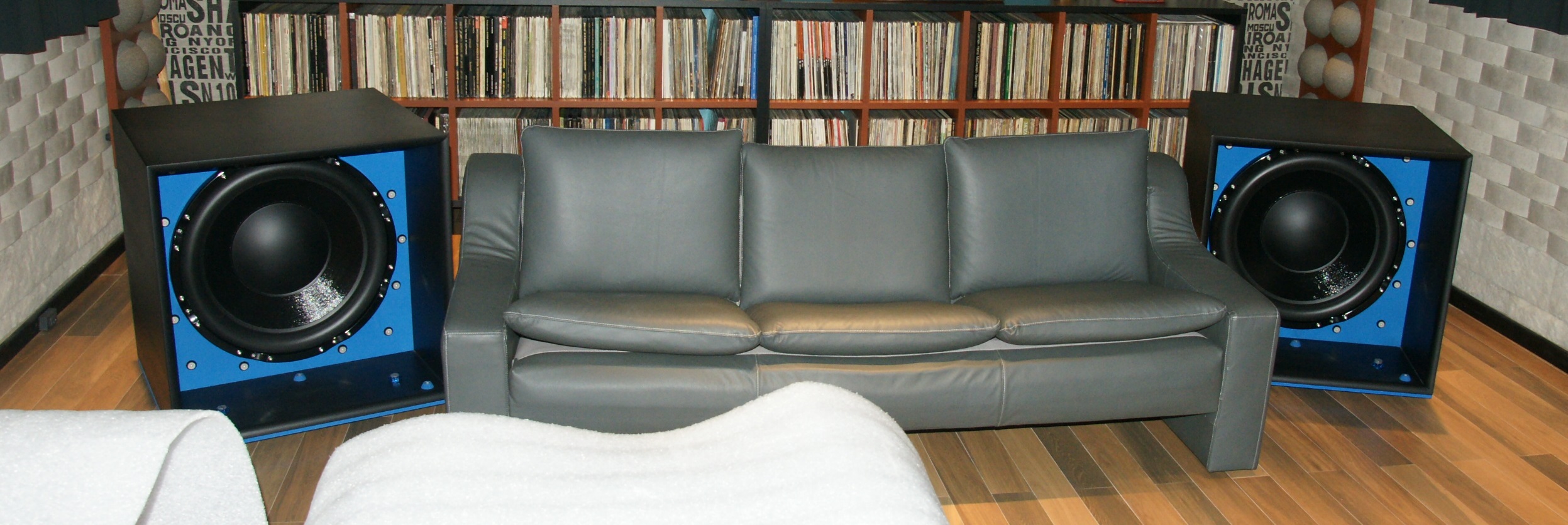

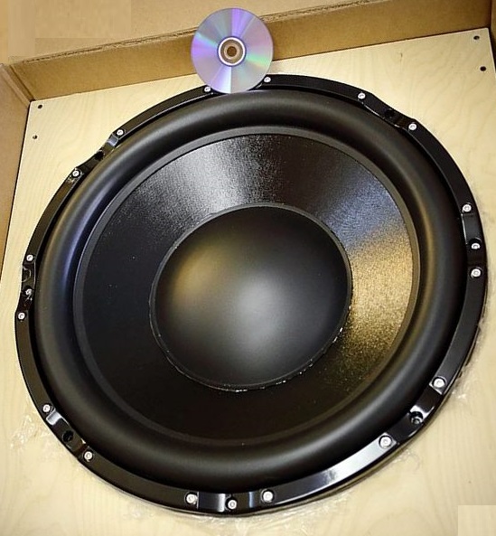

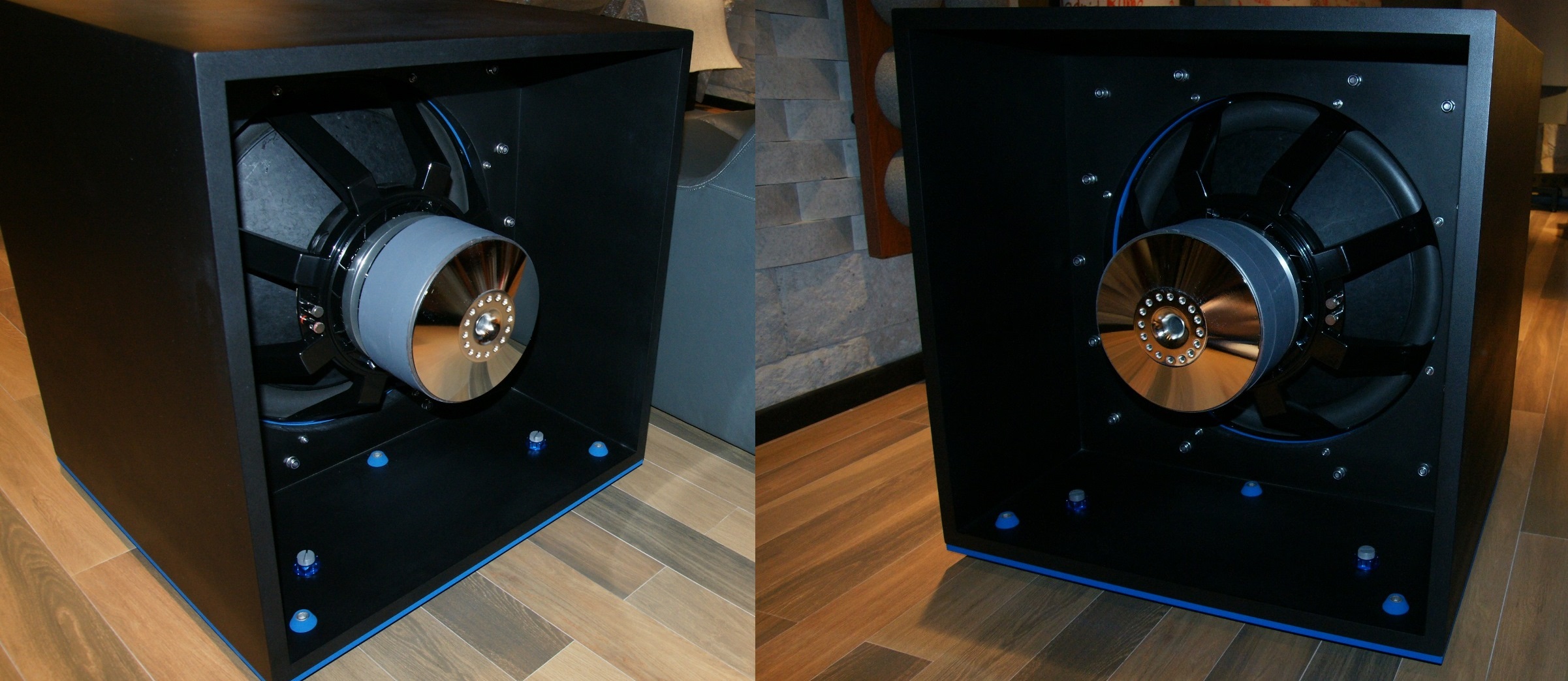

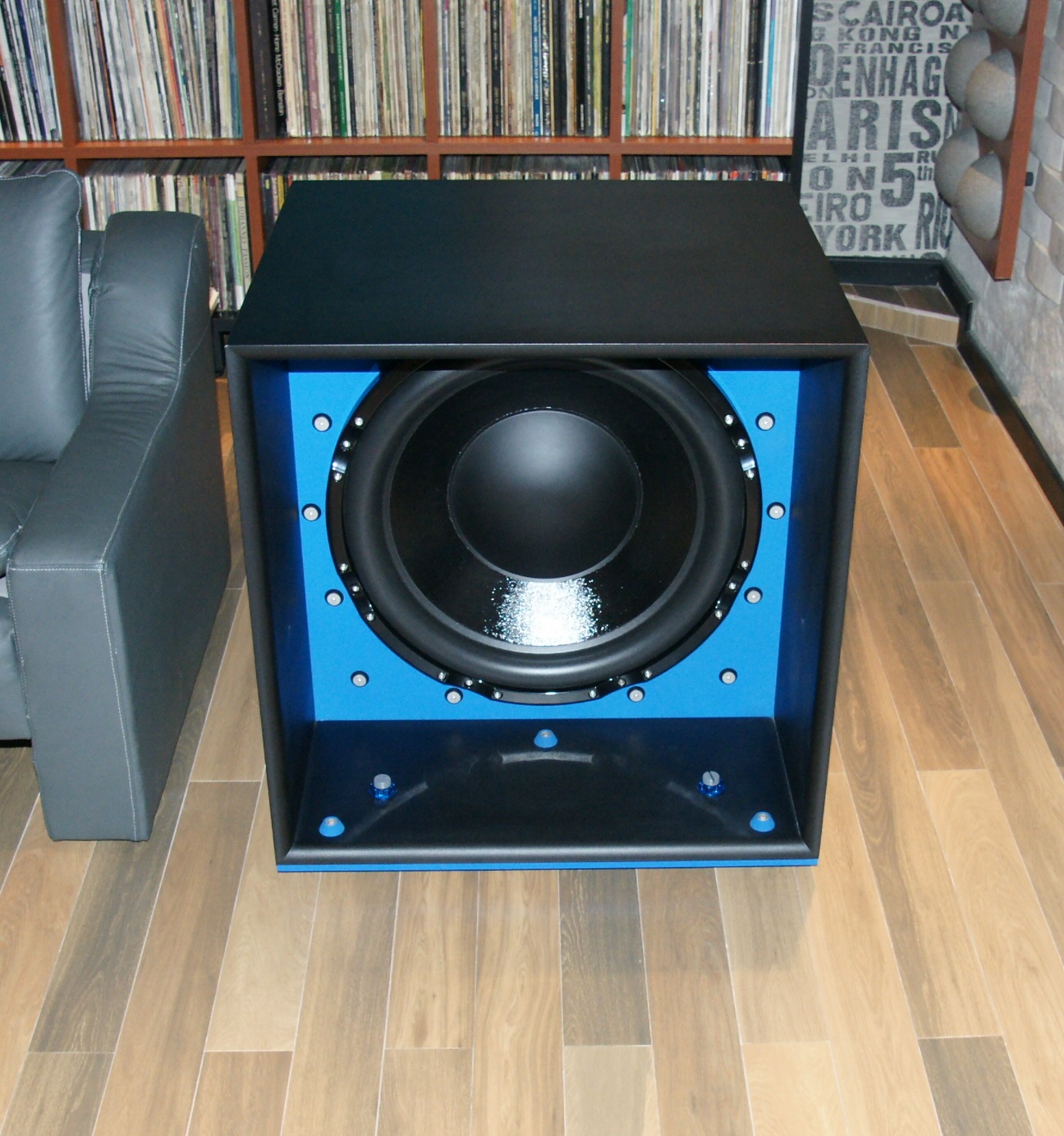

H-Frame Subs.
H-Frame 750mm cross section, 700mm dipole separation. Perimeter is MDF 25mm, center panel is MDF 30mm. Center panel joined and glued 10mm inside full perimeter then screwed. CNC'd inner metal T-Frame structure sandwiched to bottom and center panel MDF with M10 & M12 bolts using special wide washers and locking nuts. Bottom is 10mm 5083 alum., vertical panel is 1/2" steel. MDF and metals decoupled with teflon coated films. Two modules ready, another two assembling now, will be installed right behind the sofa in very near field. Driver used is 24" Stereo Integrity SH-24.
Still working in the connectors and other details.
The works of Linkwitz, Kreskovsky and this great thread helped me a lot.
Regards.
C.A.
