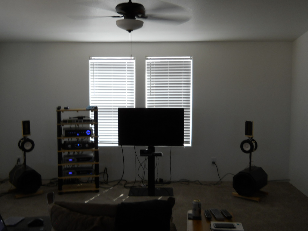

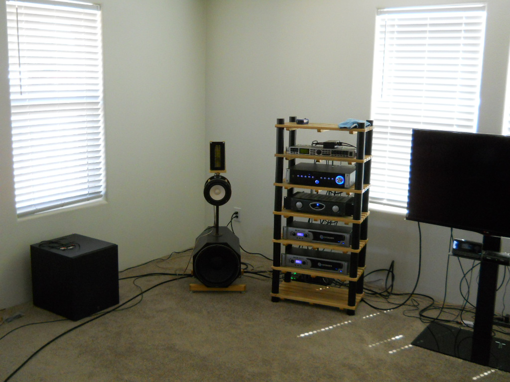

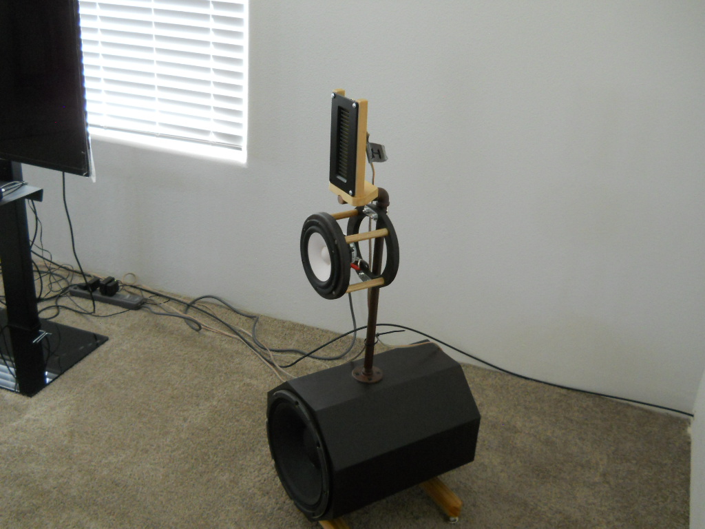

My Active OB System
I have been thinking about this design for some time (too long?) and I finally built it. I wanted to go active on my primary system that I use for TV and music. It is a 4 way system - subwoofer to 100 hz; woofer from 100 hz to 400 hz; mid-range from 400 hz to 2000 hz and tweeter above 2000 hz.
I have the following drivers:
o BIC F-12 Subwoofer
o Eminence 3012 Kappalite LF (I luv Neo drivers)
o Satori MW16PNW-4
o Dayton AMT Pro-4
Next upgrade is to replace tweeter with the Heil AMT. I will move the Dayton to my (under construction) garage system.

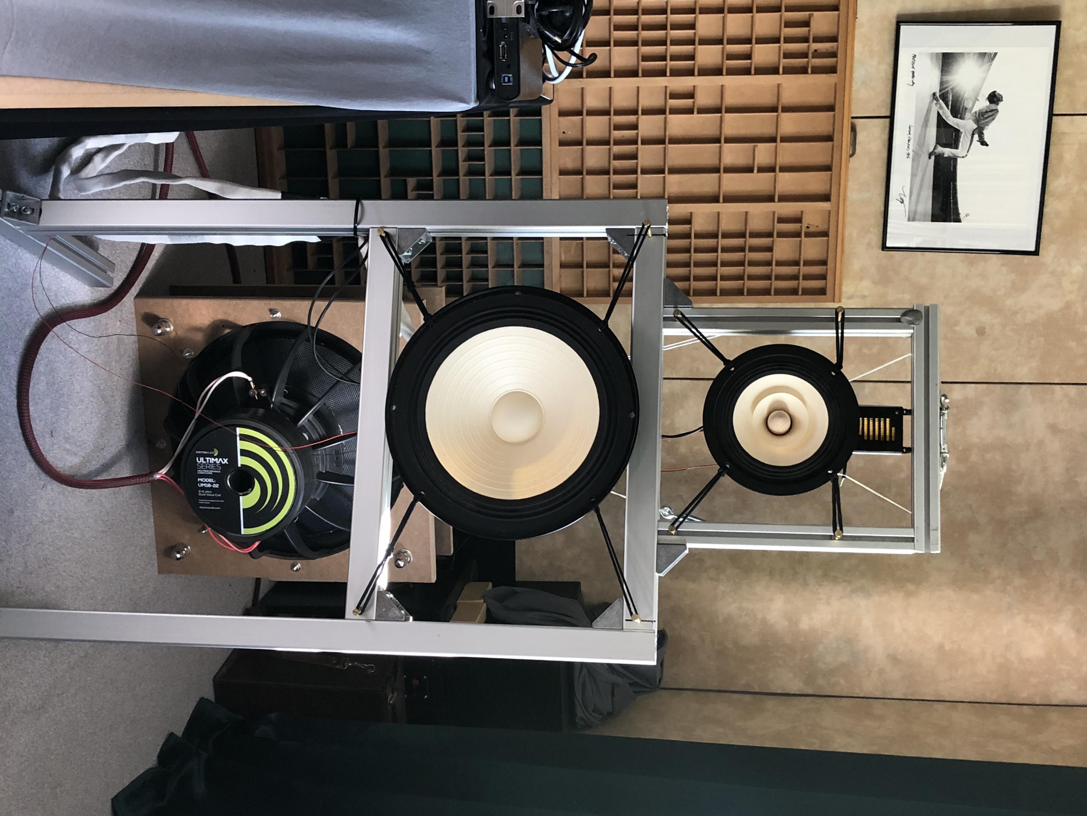

nice speakers rb132333,
some thoughts :
- I would guess you get resonances from the emminence 3012 while the tube is pretty deep, i think you might skip the complete tube - the 3012 is oke with 100-400hz i think
- are the acoustical centers of midwoofer and tweeter aligned vertically?

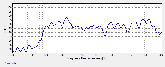

I did try to align the drivers. My room is 16' x 16' and open to the back. It certainly not the optimum room size for speakers. Here is a quick frequency response (1/12 octave smoothing) that I took at the listening position.
