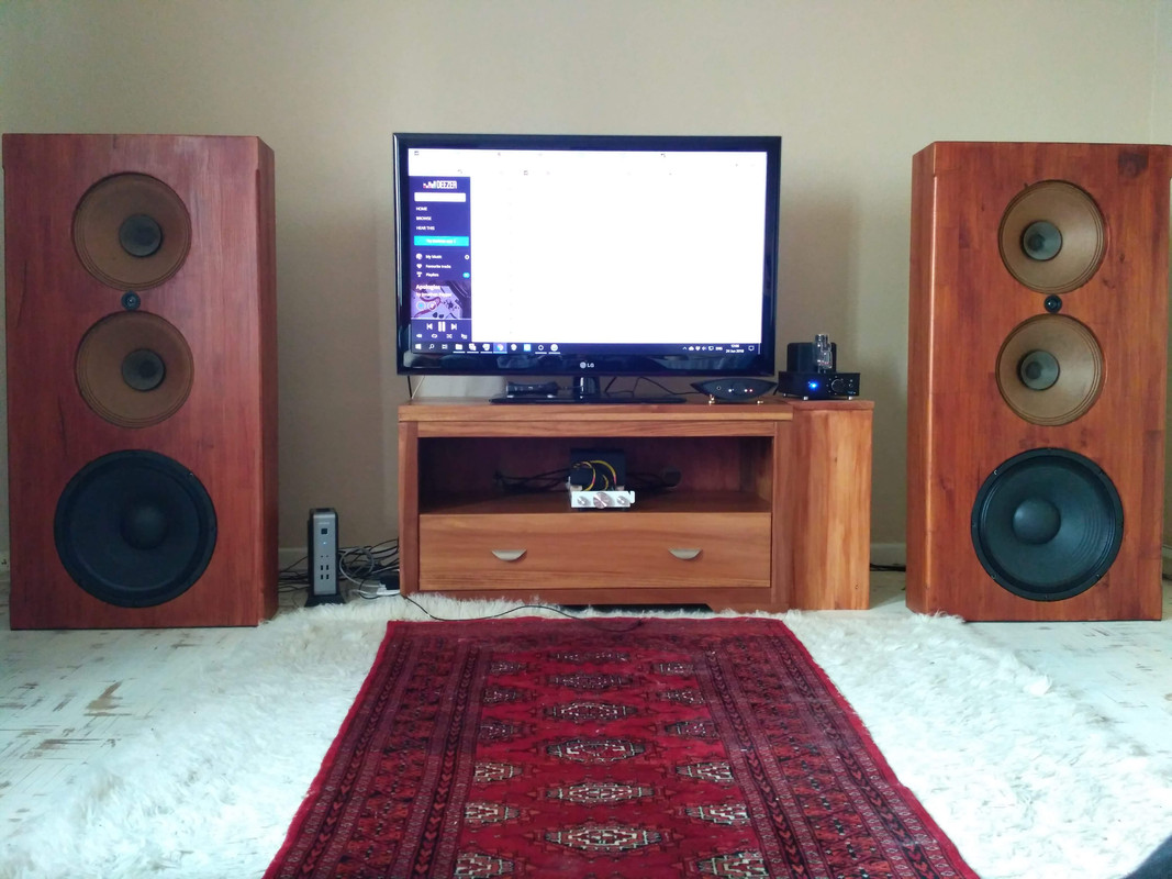

I didn't see a thread documenting your build. Did you start one? I'm especially interested in knowing how the EVA foam is cut and formed and where to source blocks large enough for an 18" woofer.
Hi WBS,
I didn´t start a thread yet, as interest seemed to be a little low. I can still do it - I have a few photos of the building process as well (and I hope that I haven´t got to do it again anytime soon...). Some changes have been done as well actually - I quitted the rear tweeter finally and have changed the filter a few times, now being back to a near standard 12/18dB parallel filter at 300Hz.
Getting the EVA took some time - I had a nice offer from Taiwan, but would have needed to order a whole container of the stuff... in the end, it turned out not that easy to get 100kg/m³ EVA in black in 1000x1000x40mm sheets, but finally I got them from Intec Foams in the UK. The sheets are then glued together with black epoxy.
Routing and sanding took a little while...
All the best
Mattes

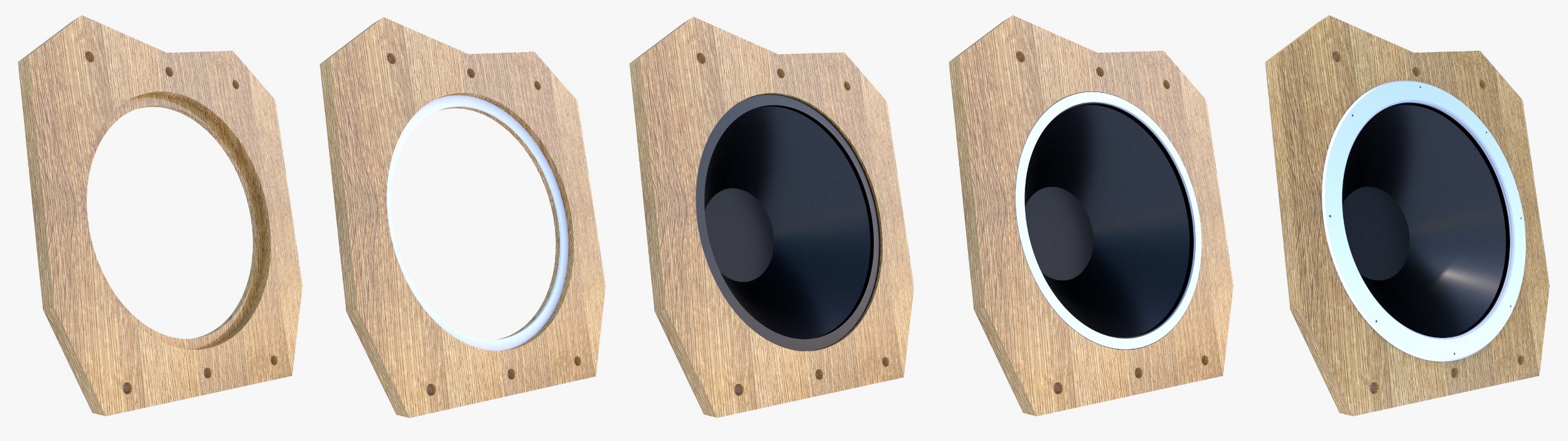

I believe in mounting drivers by their magnet, such that the baffle isn’t also a mounting surface ... greatly reduces vibration effects.
So far I have magnet mounted my tangband fullrange, it’s baffle no longer vibrates with the fullrange. Will be doing woofers next.

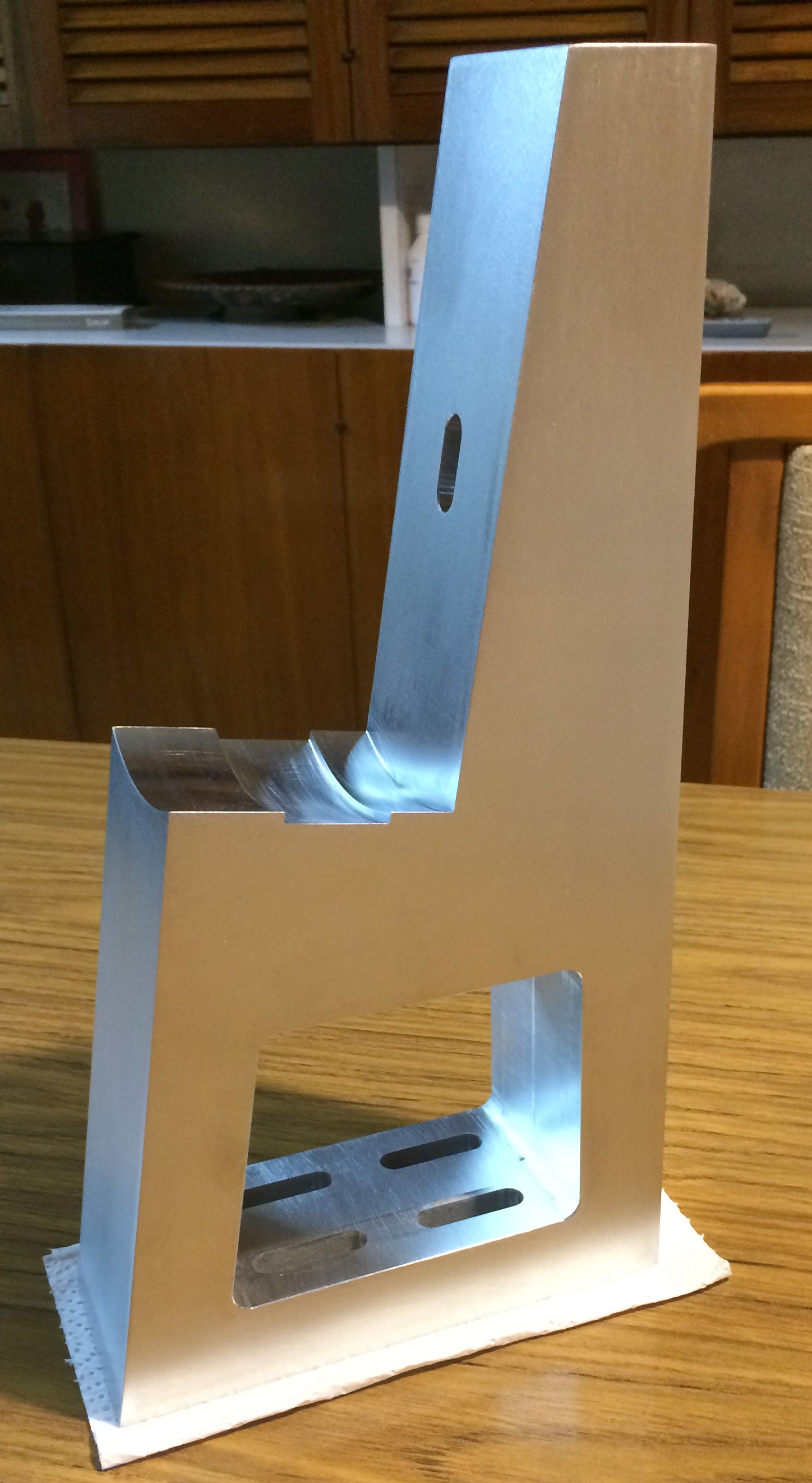

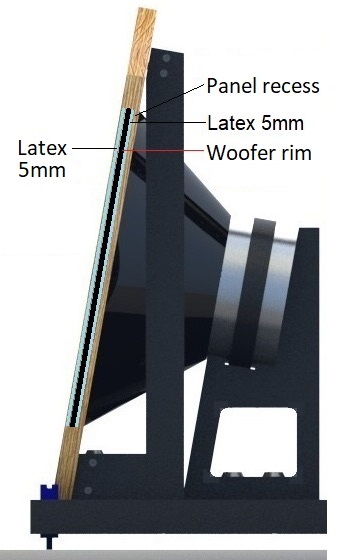

Can you describe exactly how you did this please? And how do you make it airtight where the driver meets the front baffle if it’s not attached to it?
In the case of a woofer it helps if the motor has a tapered hole as the AE Dipole-18 has (M10). Then you have to design some kind of support to bolt the woofer to it. With a light driver you can suspend it from the motor, with a heavy woofer I would recommend to rest the driver in the support, decoupling it with hard rubber or similar (I will use 2mm thick cork-rubber) and then fix it with a bolt.
As per the basket, air tight is relative, you cannot press the rim of the woofer too much, otherwise you will lose the effect of float it. I recommend natural latex foam, placed behind and in the front of the rim. Then you can avoid air short-circuit with a metal front ring (see for instance Daniel Hertz speakers).
It is important the support of the woofer has some front-to-back adjustment so you can position the rim of the woofer in the exact plane you need.
I made my support by CNC in solid aluminum. Using wood or other materials is possible but not so safe. The support of the woofer must be anchored to a solid platform, this is paramount. Mine weights 150kg.
I attach a rendered sequence how to prepare the front panel to hide and seal woofer rim.
Claudio.
Claudio.
