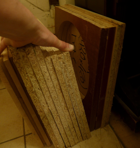

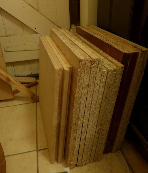

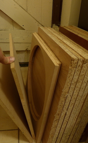

Anyways - made some major progress yesterday AND COMPLETED ALL THE INTERNAL BOX PANELS. -engineered wood to come when table saw arrives, bracing also needs doing, I ain't finished by a long shot-
I realised that I needed to make the thing taller.
AND COMPLETED ALL THE INTERNAL BOX PANELS. -engineered wood to come when table saw arrives, bracing also to be done, I ain't done by a long shot-
Well... Bigger - But that Inch thick baffle plate ain't getting remade any bigger - all that wood is very very used up.
So, with the help of the GF holding it in mocked-up form, I got some internal measurements.
Turned out, including my 12mm baffle reinforcement place (completely unnecessary haha) an the completely necessary 12mm upper reinforcement plate -They're DF subs remember- and leaving 5l for the driver, a little stingy based on the beefiness of that basket... I was heading for an internal volume of 49.8l before bracing etc.
I was aiming for about 53, so the bracing bought it down to about 51-52l.
To be fair on the thing, anything above 45l and i'd have been able to EQ, which i'm going to have to do anyway no matter what the size, but it pays to start with headroom eh.
So, My old side panels are scrap... Well, bracing material.
And I've decided to go for (inc driver internal displacement and the 12mm internal plates top & bottom) about 60l ish each.
Amazingly, that only involved increasing the height of each box by 24mm!! And if I got my maths wrong on that one, which is quite possible indeed, and now I think about it, quite likely?! It's the last of that wood I have though so it is what is is, and that just be what it is.
Base, without the engineered wood flooring = 420 x 420mm.
Height, again without the bla bla bla = 475mm.
I liked the idea of a cube, but I like the idea of sufficient internal volume more😀

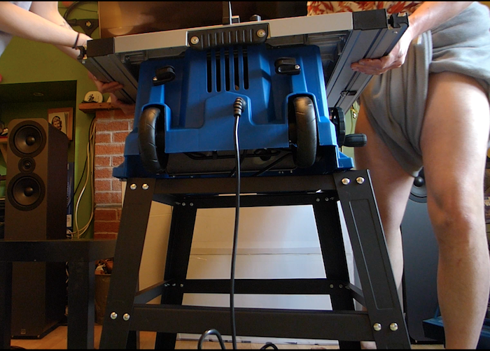

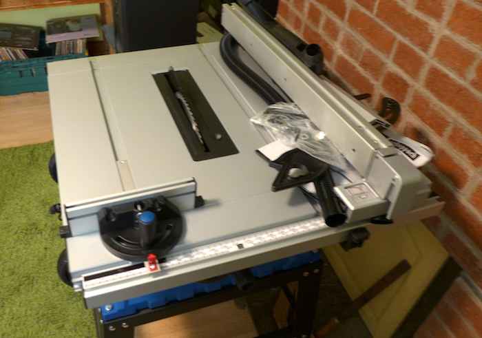

Not much to say except MY TABLE SAW ARRIVED AND IS NEARLY PUT TOGETHER!!!
No good pics of it yet, sorry.
Now all I have to do is clean up and paint the bottom and the feet (3/8 feet are UGLY with some sort plastic of veneer rot) and figure out how to put it all together including bracing.
Then I get to have fun with the saw making it look ultra classy with some 45° cuts😀

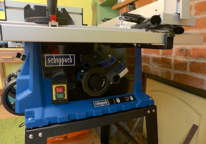

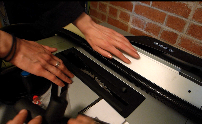

Anyways, just a couple pics of the saw, which I still haven't finished putting together, nor reading the instructions. Probably as the instructions seem designed to make things more (not less) complicated.
Anyways. Not a fancy saw by any means, but a couple steps up from the cheapest ones available at Screwfix, but nowhere near as nice as the £1k jobbies. It'll do me just fine I suspect.

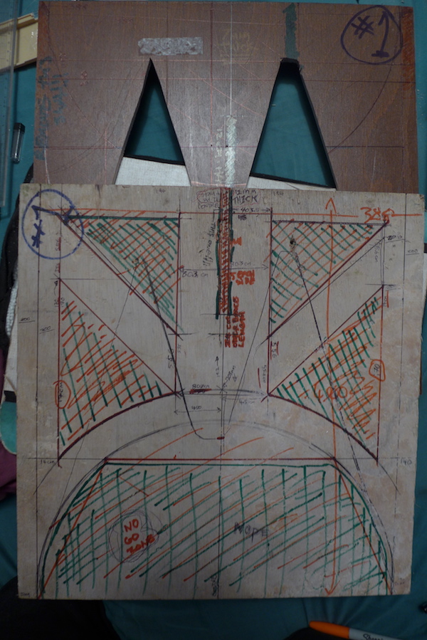

Decent progress this last weekend - got a 7.5mm really high quality bit of board - 580x462mm to somehow Tetris into two 400x388 braces for one direction. Then I got the 25mm baffle plates backed in the right place by the two 12mm MDF pieces. This was a TERROR. Bearing in mind these were the first pieces I cut out with my brand new haven't used one in years jigsaw... Yeah, they're ugly. I also somehow managed to balls one up, have to take it apart juuuuuuuust before the glue dried enough to risk ripping anything, and re-do it. You can see in the closeup pic, my mistake holes.
Then the Tetris brace plates. They're slightly asymmetrical because it worked better that way and who cares, they're brace plates - I'm lucky to have found any at all to be frank.
I have one more set of brace plates to work out, I call them the saviours. I found them in the back of the "shed" ages ago while looking for wood. Yesterday I see my GF with this piece of wood, about to cut it into a door for the greenhouse!!! I remember earmarking them for sub making instantly - 11mm very high quality plywood. Stiff as anything. I do whatever it takes to find the GF a replacement greenhouse door, and manage to get two 388x400 (my vertical internal dimensions) out of it. I could've got a third, but that wouldn't be fair to the other sub eh, plus it'll make some excellent additional bracing about the place - possibly to sure up the thiner stuff in some key areas.
I also have some offcuts of the 25mm beefy heavy baffle plate material to play with in corners etc.

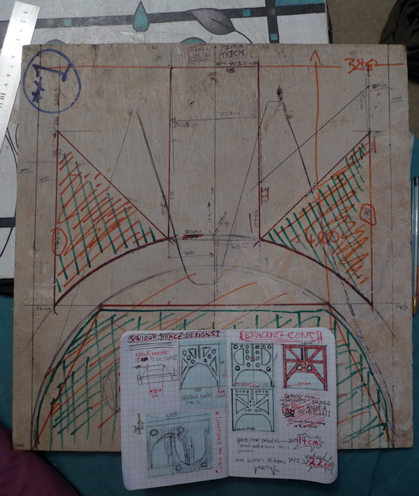

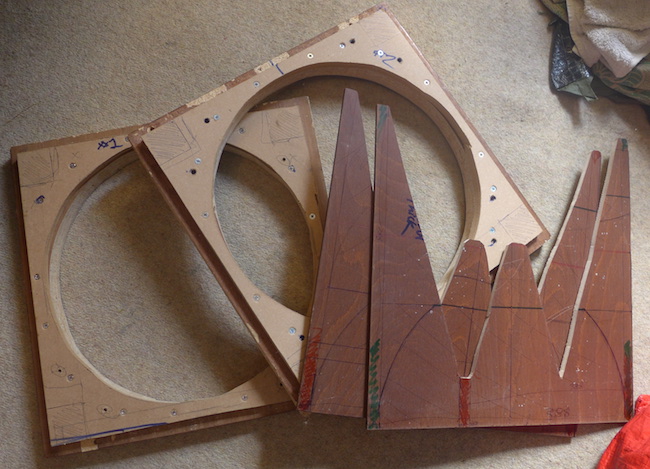

Almost made a major step today and put all the internal panels together(pic 1)...
That would have been so dam cool. the fit on 'em isn't great (pre table saw) but finally seeing a box, wow, yeah.. I'd have liked that. A lot. So far all I've done is measurements and the occasional semi mock balancing up of side panels on there with something holding it together (turns out, in that regard, a GF and a piece of string are about as useful as each other).

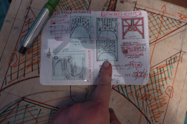

But then remembered I had one more brace to make for each sub, and having two panel bace on each sub while putting them together would make it a LOT easier to get 'em square, and that's rather important. So many steps in this lark before satisfaction!! I guess if I'd bought the table saw before this I'd be a long way further along.
My first job was measuring and realising that most all but one of the brace panels had one side (or 2 in one case) that was a mm or two too large. Table saw sorted that out quick enough, but it's always a faff carrying it from the living room to outside the front door.
I had a whole load of ideas. I chose third one (pic 2).
If anyone had told me there'd be this many numbers and divisions by 2 in this whole subwoofer building thing Id just have paid £600 for a BK 400XXL and and an antimode (pic 3)

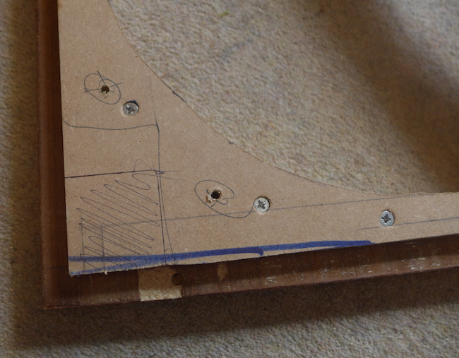

And finally, about 1 in the morning I finished the basics of the saviour brace (pic 4)
As you can see, the thinner brace is slightly asymmetrical in the middle bit. I think that's a byproduct of having to squeeze to out of one fairly small piece of wood. It won't matter, they'll slot together well enough.
Now I just have to copy all that to the other saviour brace, which should make it a lot easier to copy onto the other saviour brace with all the numbers on the board (YEH! - how you feelin'? - FINE! - ya feel alright?) so I guess it shouldn't be long until I can cut 'em out and start to make things look like boxes.
I might do a bit of work with the hole saw kit I borrowed on the saviour brace if it looks overkill, and on the top panel reinforcement panel too. It doesn't need 15mm of flooring, 16mm of reclaimed cupboard, then 12mm of MDF. That's 41mm thick up top!
Oh, and a bunch of corner braces, small corner wood batten things, maybe an angled brace thing joining the crossed braces together. Gotta be careful not to lose all my internal volume though. I guess that's where the hole saw comes in eh.
