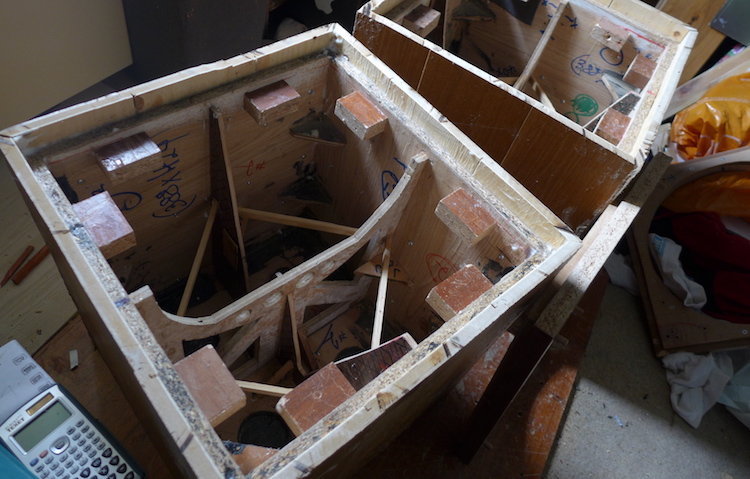

Braced teh brace. Fun times.

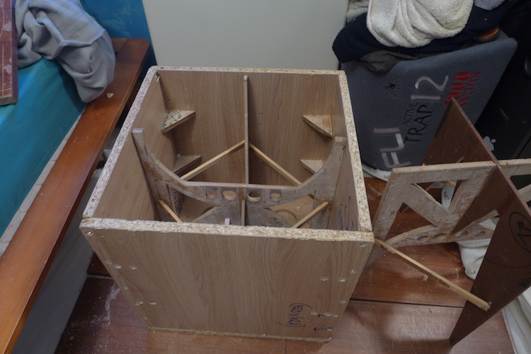

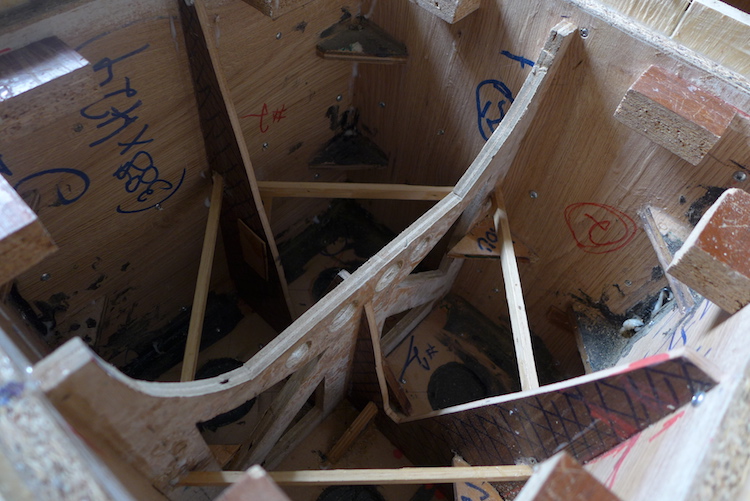

Made up one box.

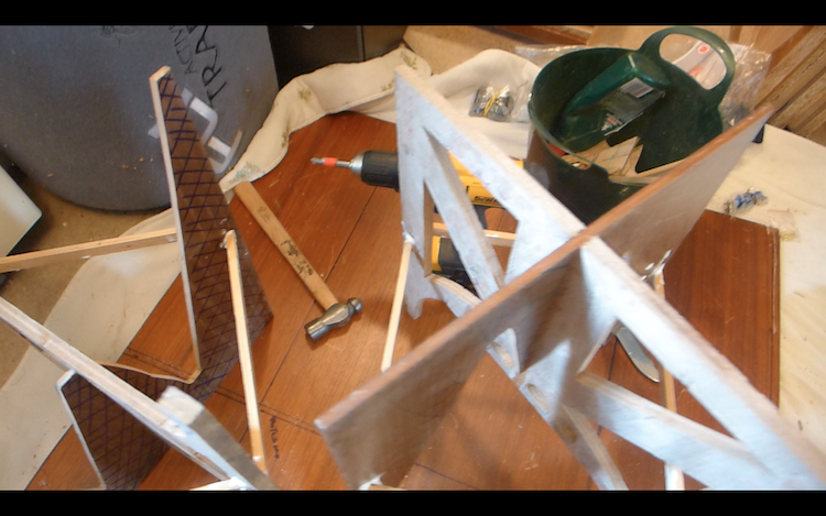

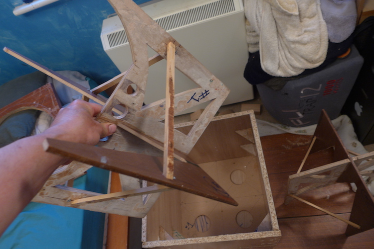

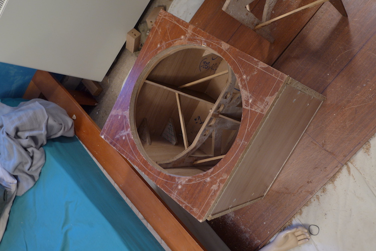

Took a while, but it always does teh first time. The interior brace is removable. 8 corner braces, 2 per edge. I'm probaby gonna have to do that to attach the 7mm internal braces.
Just about to make box 2, and with all the knowledge from box one (the guinea pig) this should go faster!
Oh and I braced my braces. Why? I don't know. Just seemed a good idea to have plenty stiffness.

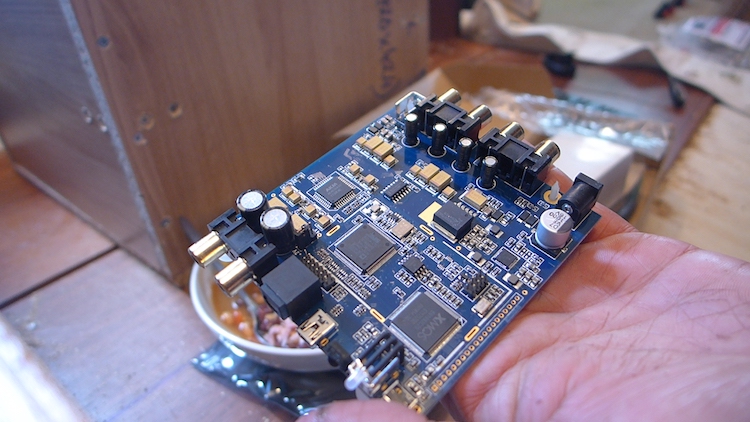

Oh and I also bought a miniDSP HD 😀
It's what I need in my room to have multiple setups for different speakers, full line level RCA outputs etc, all good. and learning and applying a function to all the extra buttons on my remote will be kinda cool😀

I would not bother making new boxes, they seem good enough for the intended use. They will be further strengthened when you glue(?) on the floorboards on the outside.
Just glue the braces and such together and you're good to go.

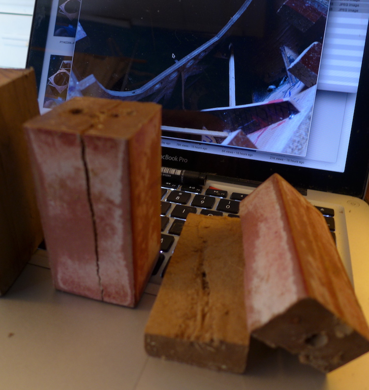

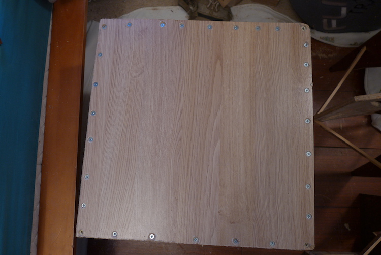

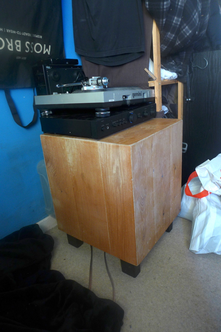

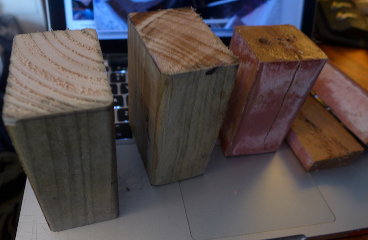

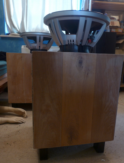

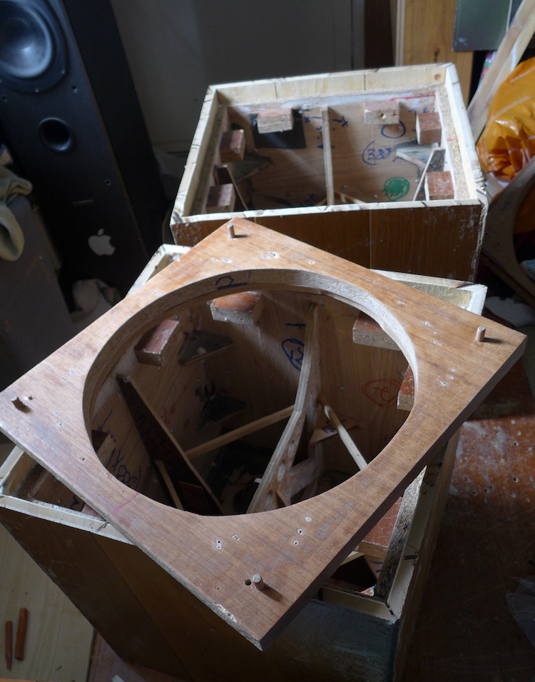

Have some pics of overcomplicated suboptimal boxes that vary from the plan quite a bit. Note the feet, even the good ones were useless so I got some pressure treated stuff from my mother (who' been adding things for us to her weekly shop so is about fairly regularly).
At least they may give you a bit of a WTF? giggle😀

Really, I just need to be better at woodworking, and work out things like how to 45° cut on the opposite side of the way the saw adjusts (fence and extension is on the right, saw tilts to the left). They're all hand sawn so MASSIVE imperfections there, And, well, everywhere else too now I think about it. Having the wrong materials too, yikes that complicated things!! All salvaged wood mid covid19 lockdown vs waiting a while and just buying thick mdf? I'd probably have made them in no time with the right materials and some KISS.
This speaker building thing will be a journey of, as you say, whittling away at the f*ups project by project until I'm more or less good enough to present a pair of speakers or single subwoofer and proudly say - I built them!
It'll be a while 😀
^Unfortunately these are a little too big to hide well!! Ahh, at least they'll be in my audio cave room rather than the living room or bedroom. Only I will be constantly reminded of my first project's ultra goofy construction, not the GF or anyone who comes over!!
I suspect when I smooth over corners with the sanding machine it'll start to look a little nicer. Still goofy/gappy/filled etc, but a little less obvious!!!

Got quite some work to do with the miniDSP 2x4HD. First off post sub output Then an experiment (perhaps an RCA splitter to make it a new input? No ideal).

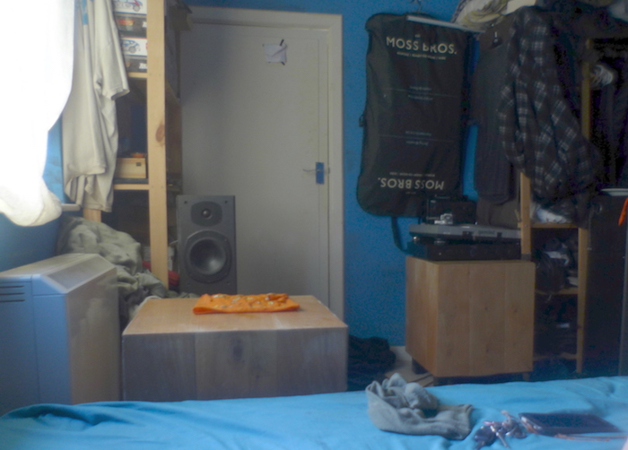

I don't know how exactly I'd measure the weight..... hangling luggage scales perhaps? They're HEAVEY. Today is my first full free day to mess about putting them somehwere other than the end of the bed (this room will no longer be a bedroom but a sort of audio / small projects workshop).

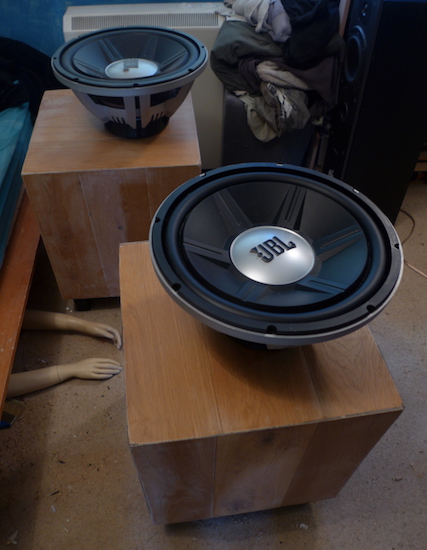

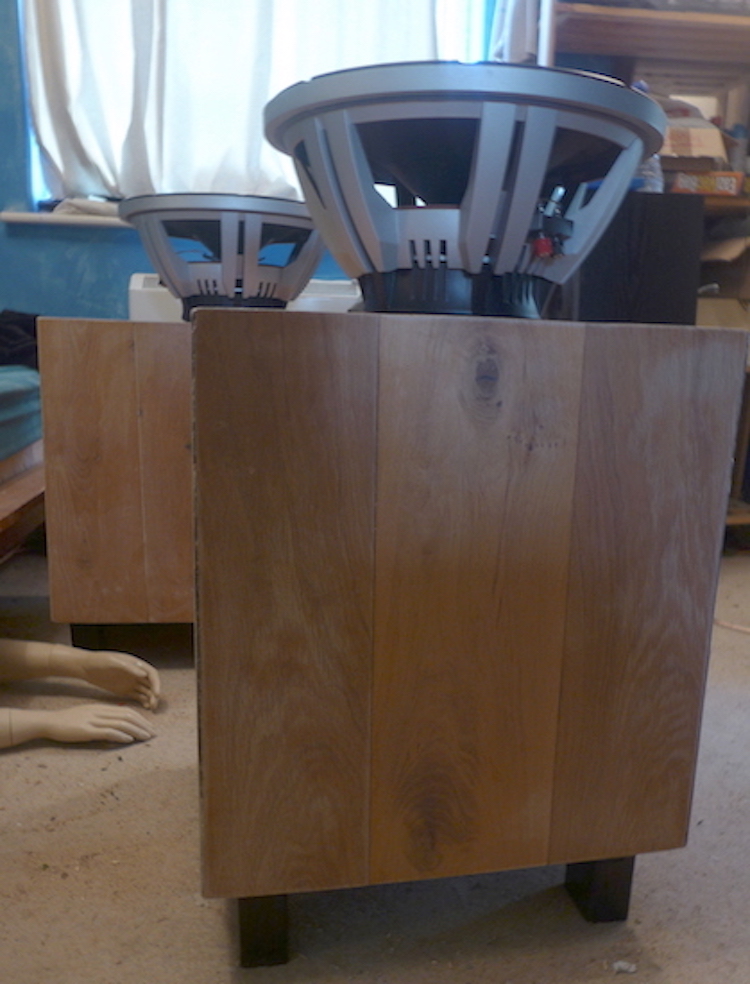

Just to thank everyone for their help, update folks that I did indeed create a pair of giant 15" subwoofers, and thank everyone for their help again!
miniDSP is still being tweaked but I'm gonna take that slow. Get used to the sound, mess about, get used to the sound, repeat. I'm getting there. Certainly so far I'm achieving the "didn't know there was a sub, sounds like it's coming from the mains" thing.
I'm using one as a pure 20-30hz room rumbler.... And the other (nearer) as reinforcement to my somewhat bass-light Monitor audio Bronze 2's (my first bookshelves, on sale, can't resist a bargain) slowly rolling off to 80hz ish. A smidge of old pillow stuffing in both.
The finish... Imperfect. Very imperfect. And they're HUGE. I've a couple bits and bobs to tart them up a bit though, so maybe they'll end up looking OK.
I feel like I'd rather like a smaller 8-10" woofer between the speakers to take care of the punchier stuff that the second sub is currently working on, and - If possible, run the two 15's off a single 400w channel. Is this possible?
