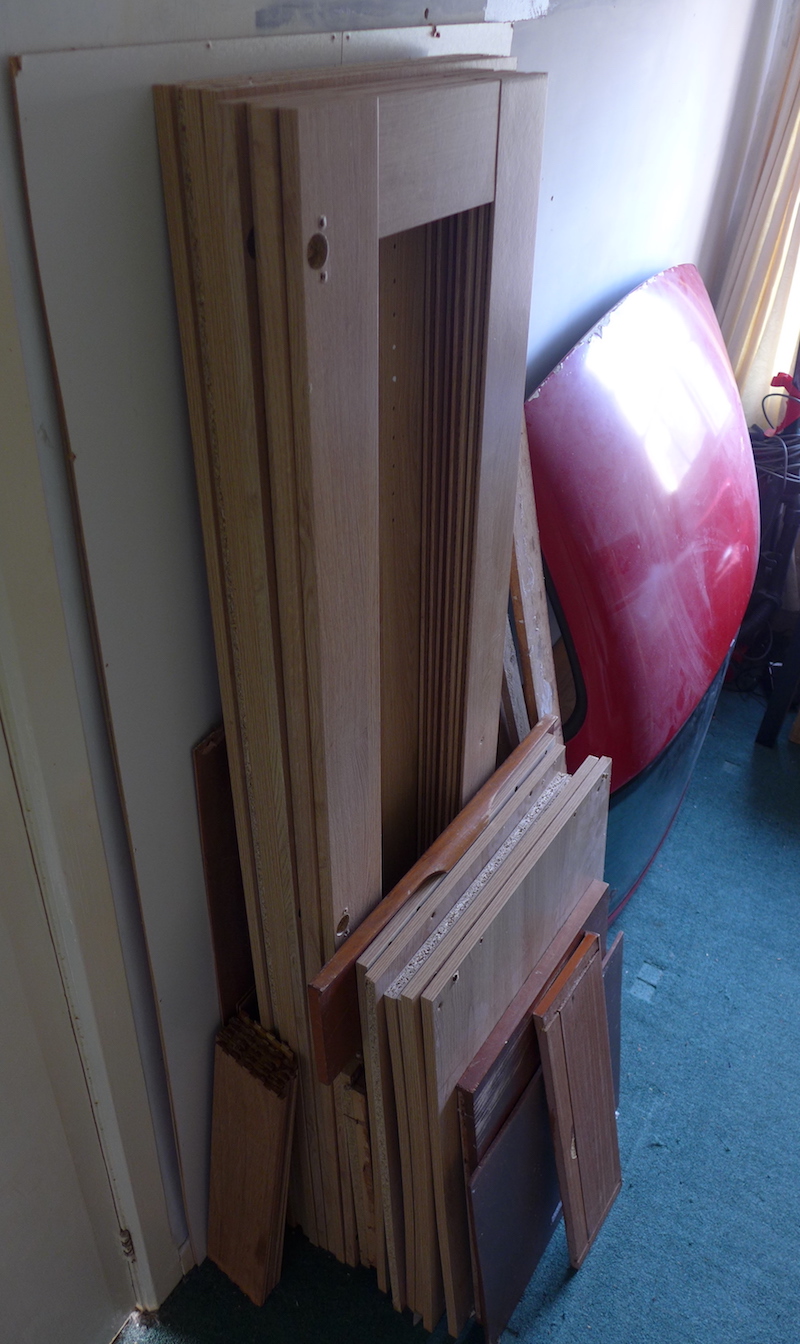

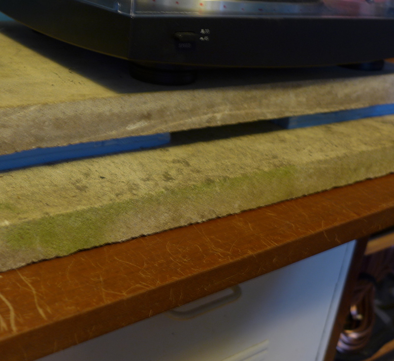

Some pics of what I'm working with here... I got my work cut out for me eh. I'll manage to scrounge some good stuff out of it though, but it'll be a right faff getting all those engineered floor pieces to line up and glue/screw on from the inside. Lucky I got a 15" hole to get the drill through eh
There's also a lovely 3m 25x70mm piece of very decent wood for battens and bracing etc.
Anyways, pics below:

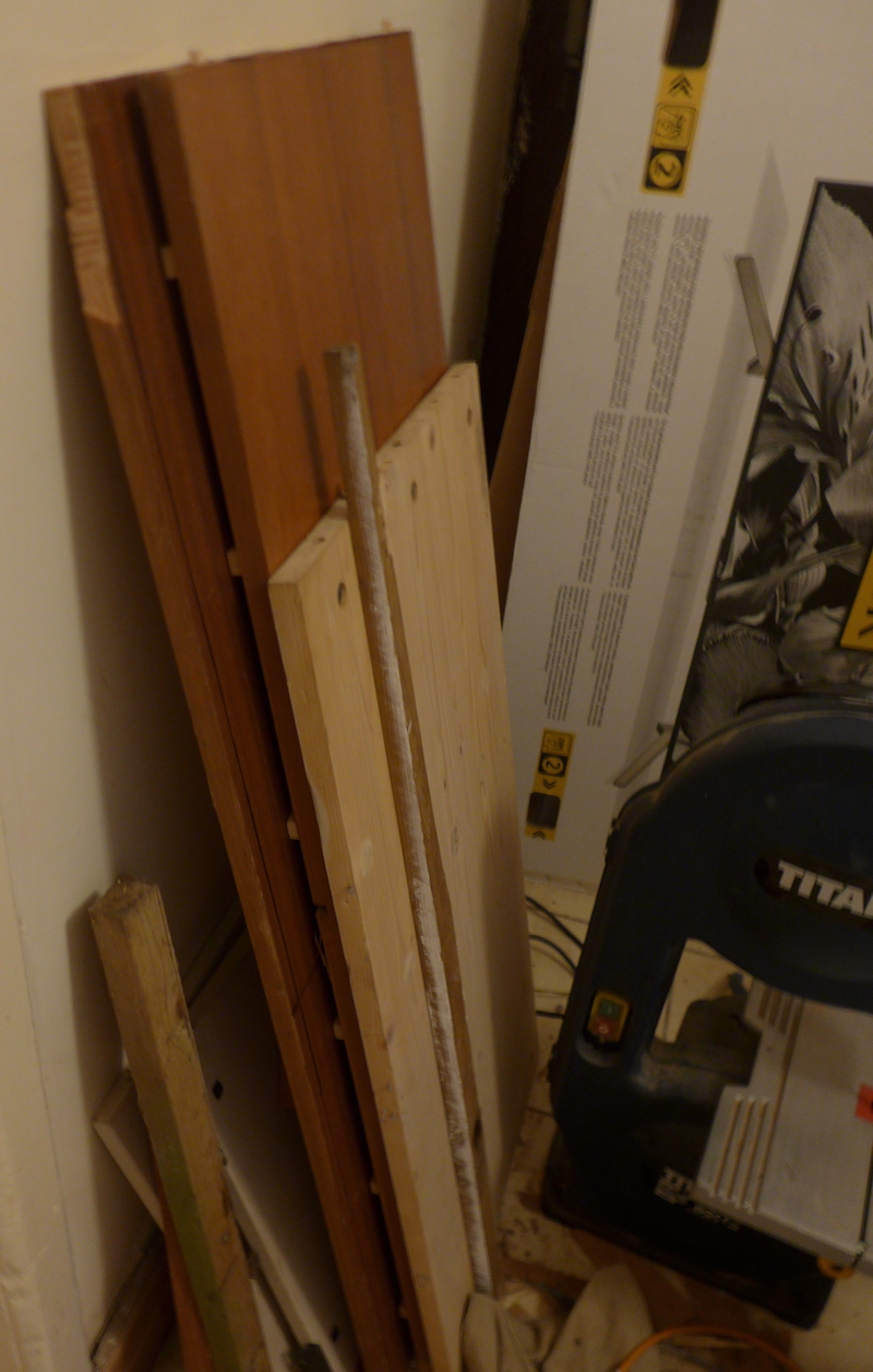

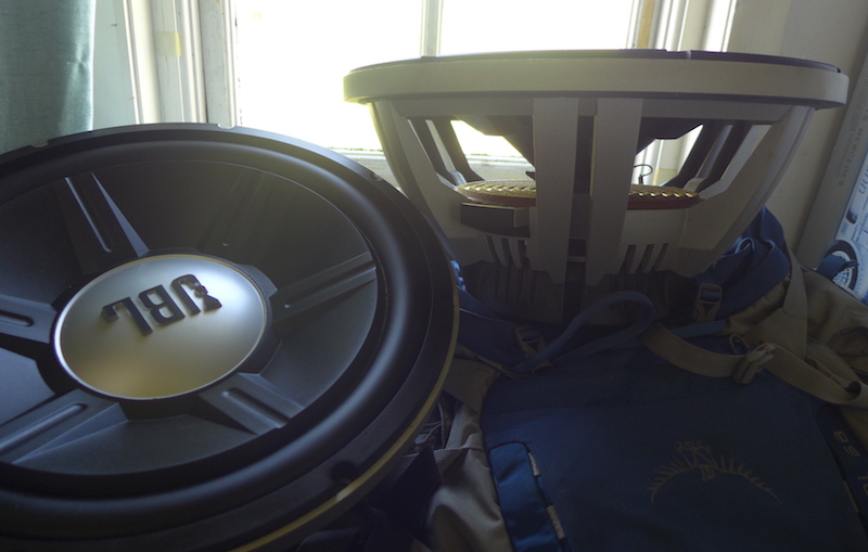

1: Drivers
2: The upstairs stash of wood (lots of batten material behind it)
3: The precious stuff protected. Name that roof and win, errrm, some automotive respect.

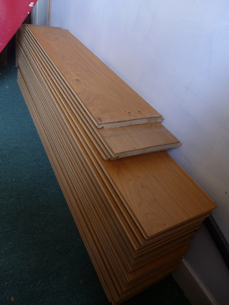

4: The precious stuff exposed. Loads of it. Enough to make two 55x55cm boxes according to my mother. Was a total hell to squeeze in an S2000 boot.

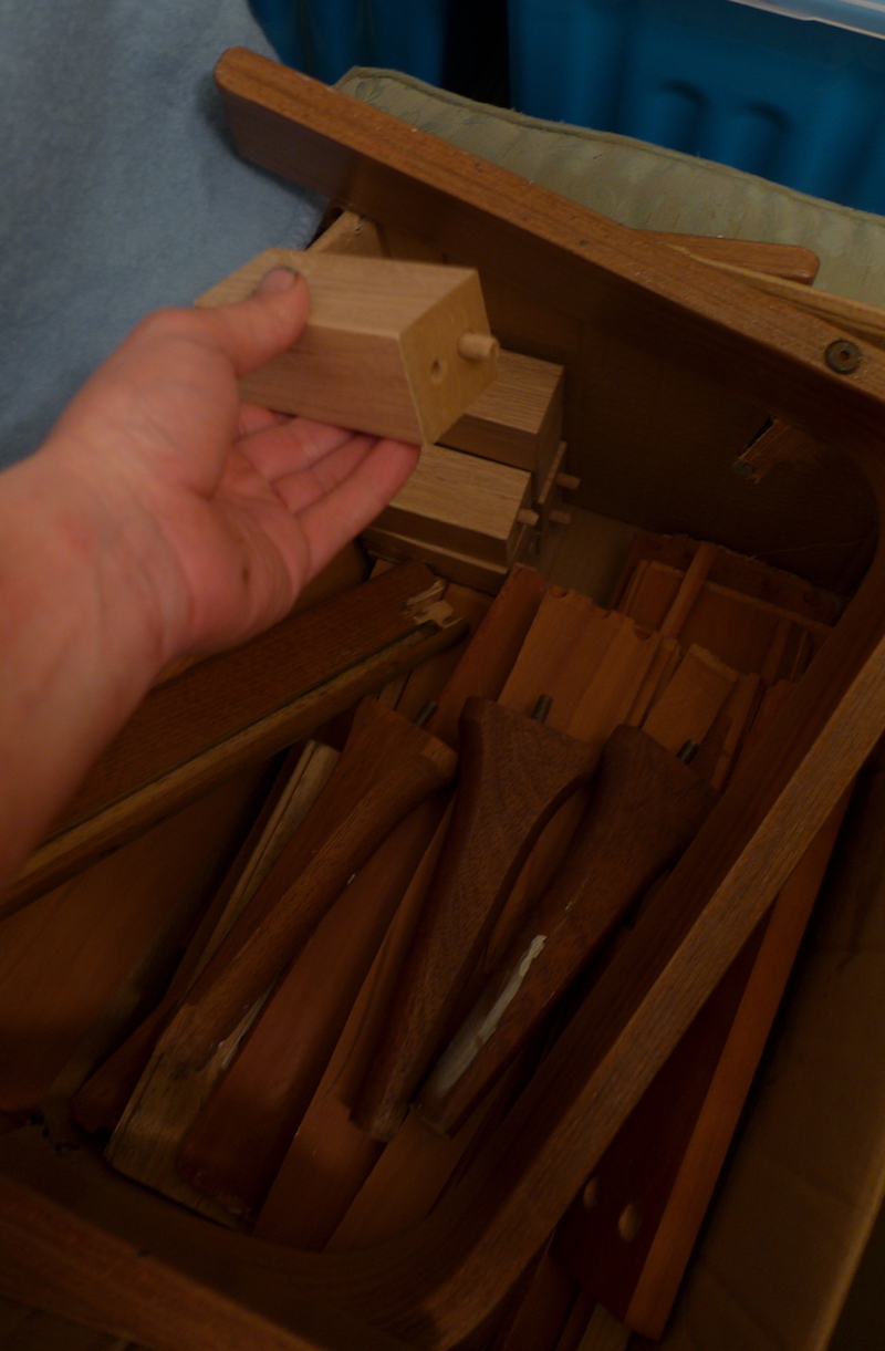

5: The measly downstairs stash. Some solid wood in there though.
6: A big sheet of 12mm MDF I bought when I thought I was making something else and hadn't been paid in a while. Should've got 16-20 eh. Ahh well, It'll have uses.

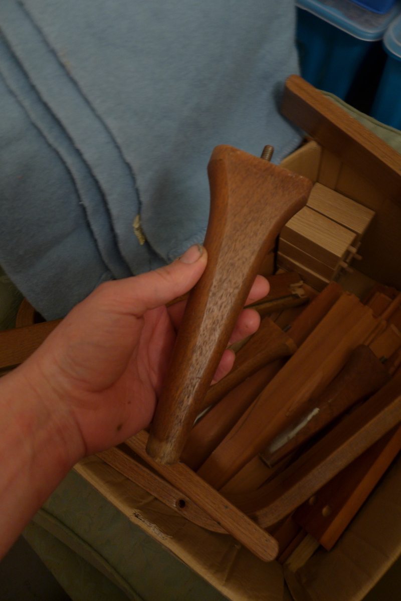

8: Got 8 of these sturdy enough with the right screws feet from somewhere.
9: A small part of me wants to use these (cut down a bit) for feet on one though. Tacky as hell.
10: The sturdiest bit of wood of them all I have a couple of them too (one is still on my GF's cupboard... Inch thick and did a great job of sitting under my record player and paving slabs to stop it skipping when i jump around near it.
1: Drivers

in the second to last picture your holding a wooden leg/foot. be careful using that, as it may not hold the weight, the timber may give way around the threaded stud area.
good luck
Yeah they're the feet from super 70's-80's chest of drawers I disassembled / smashed to bits. It's very unlikely I won't just use the rather conveniently perfect 8 other feet, but a little part of me thinks it would be hilarious to have a great big 15" sub box sitting on those, cut down bit. Sort of like The Rock in his wrestling pants, flexing hard, wearing a pair of brown 80's stilettos.
But don't worry, I'll use the much nicer looking 8x ready made perfect legs in the pic before (third to last).

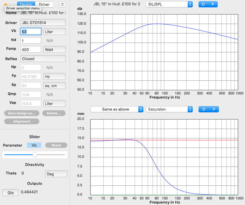

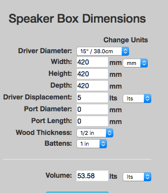

Fair bit of progress on this, in fits and starts. I'm aiming for the internal box to be about 53l as the driver hits xmax at around 51l, and by the time I'm done bracing the thing I (total guess) expect the volume to drop to about 50-51l ish. To be fair, I'm not that bothered as anything from 45-51 gets perfectly useable results when coupled with my miniDSP. And lets be honest, When am I ever going to be pushing the full 400w through the thing? Especially with a 2x4 miniDSP that only outputs 1v to the RCA's at the rear... To get the driver over xmax with only 200w going to it, I'd need a 100l box, with very little flattening of the frequency response curve.
Included is a pic of the 53l box as designed in SpeakerCalc, the only mac software I could find for this stuff, and not bad for beginner use. I expect hornsrep or one of the multitude of windows based programs would outperform it by MILES, but this little £8 app, with a developer who responded to an email RE: one of my speaker designs instantly crashing the software, while a replica of said design was fine telling me where to find the relevant file, how to fix it if I wanted to try myself, and to please send him a copy of the file so he can work out the bug and update the app... Well, that's just fine with me as a first time subwoofer builder. Highly recommended for basic speaker box calculations (and there's more in there I don't yet understand) on a mac. Many thanks to Jonathan Millen for designing this and taking my crash report so seriously. A good chap, a goo app. Hey, I'm a poet and had no idea!
So far, I'm aiming at 420mm (lol 420 blaze it - not really, those days are LONG behind me) cubed designs. I mean, they're already not cubed internally as I'm reinforcing the inside of the top plate and bottom baffle with a slice of 12mm MDF, so it's now already down to a smidge under 50l. I might borrow my boss's hole saw set to swiss cheese that top plate reinforcement to get the volume back up a little... After all, it's still got 16mm of engineered flooring to go on top and I will be bracing these bad-boys PLENTY.
Also included is a pic of speaker box volume calculator showing my workings.

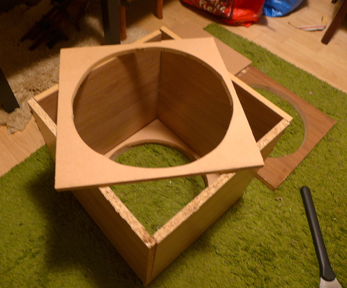

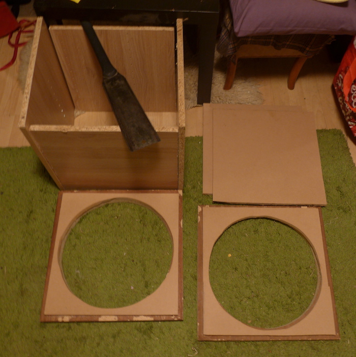

Wow, so I fell asleep half way through posting pics of where I'm up to... I'm absolutely exhausted lately.
Unfortunately "token expired" before I got the chance to copy/paste/post it, so gone. No great loss though. Here it is again. Temper your expectations... It's no work of art... Yet.
Pics:
1: Wood cut and ready for the inner box so far:
- 2x1" baffle chunks for the down firing woofers and feet.
- 2x12mm baffle chunk backers
- 2x top piece backers... Which I may go nuts on with a hole saw, old-school race car style. I'm going to be bracing the top and sides like crazy, and the reduction of 12mm they introduce reduces my internal volume by a surprising amount, IIRC.
- 4x16mm side panels to form the "box" of one speaker. Remember, these will be covered (glued and screwed) with engineered flooring of another 16mm, for a total of 32mm laminated/glued/screwed box walls.
2: A very structurally unsound mock-up of the side plates and baffle/backing in place. I will probably use some battens (right word, spelling?) at least partially (as wood allows) or triangular corner bracing on this stuff. It's in decent shape, fairly heavy, but I don't trust it like I trust the 1 inch baffle plate or the brand new 12mm MDF.
The Finished articles will be sanded then given a good coat of boiled linseed oil. They should, if I can learn carpentry fast enough, look quite beautiful.
One thing I'm struggling with is when to make and fasten in the bracing/battens/triangles. I'll need access to the inside, with a drill... which panen do I leave off while doing that? More to the point, I think I'm going to have to glue/screw the final fake solid oak wood flooring before I put all the bracing in, leaving me with a risk of tweaking something out of alignment. My gut says it has to be the baffle/backing plate... as I'll also need to secure the feet to that (access to where they go is already compromised) and if I make it right, and I hope I do, I can glue/screw that on last to a multi-layered selection of corner bracing - there's no space in the centre of the baffle for that.
Any thoughts on the matter, let me know. I really hope my table saw arrives before I have to start doing all this stuff, as precision straight and 45° cuts will be essential (ok maybe a smidge of diy wood filler here and there).
