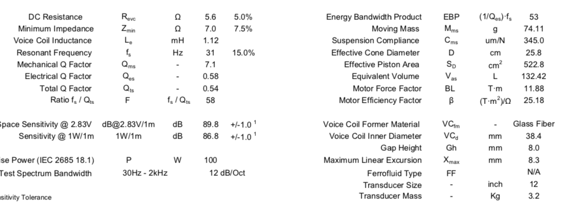

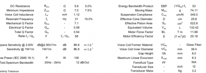

Falcon Acoustics have 12" Peerless SLS-315 drivers in stock at £76.74 with an Fs of 31hz (datasheet below) which could be a possibility. Their next cheapest 12" is way out of my price league so that's limited my options there.
